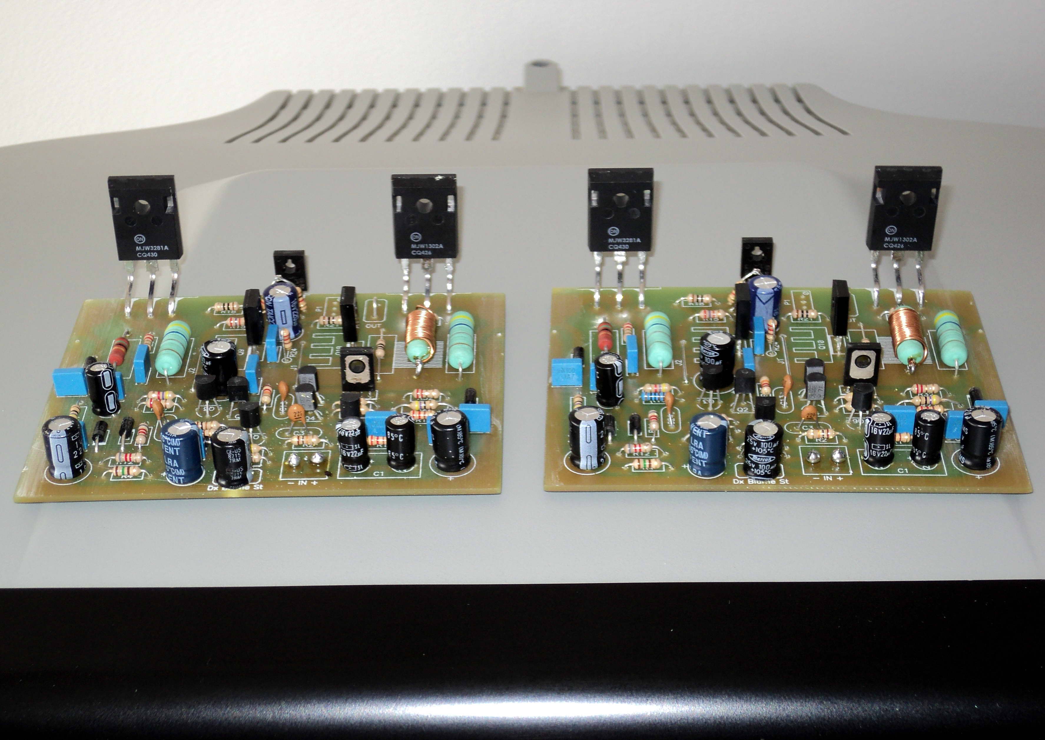

dear sir

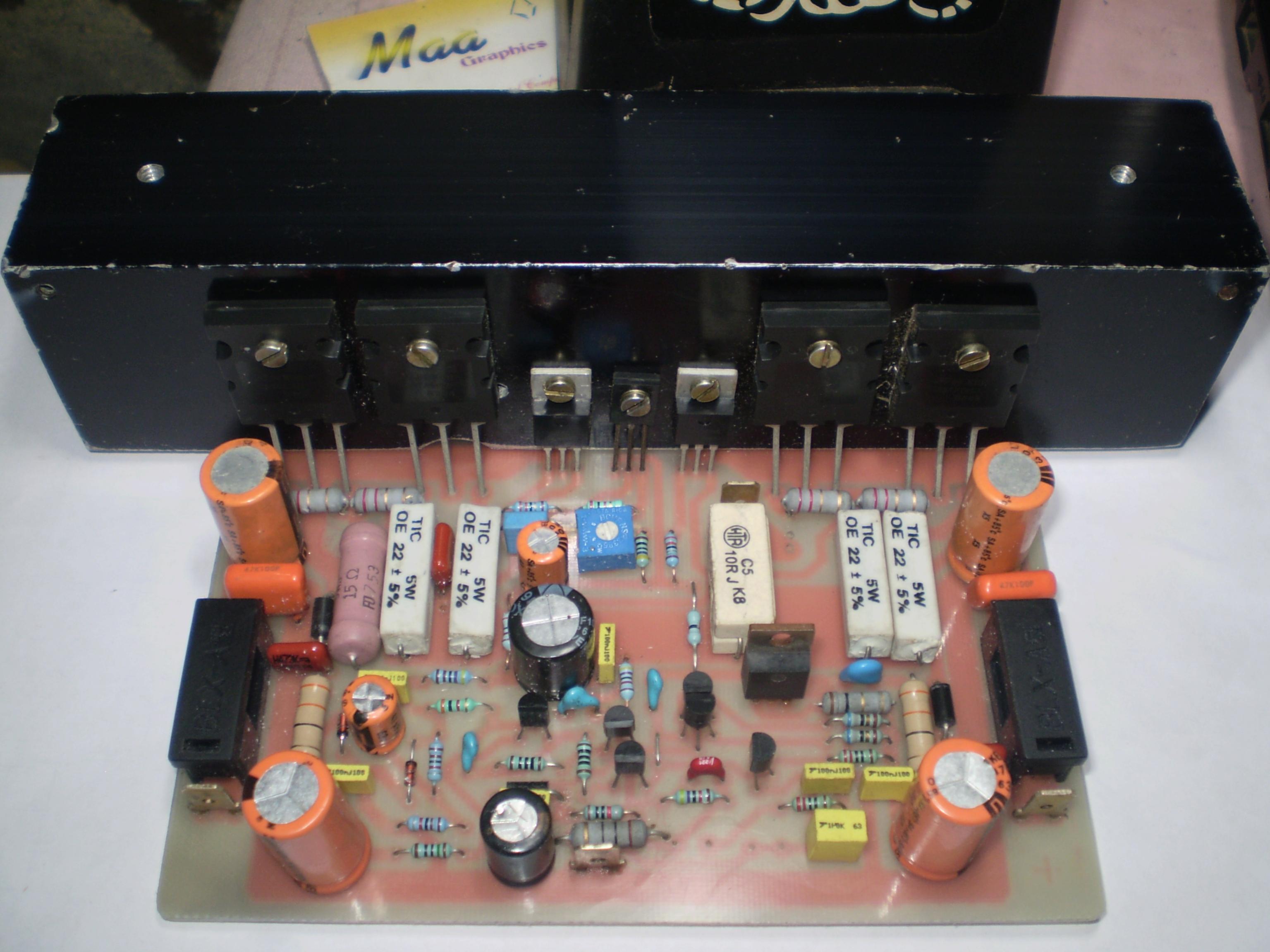

greetings have finished DX BLAME MKII SUPERCHARGED on home made
pcb can you please tell how to bias it voltage over 100 ohm 2 watt resistors
is it ok i have used 2sc5200 in output till i get orignal transistors will post
picture tomorrow
thanking you

greetings can you please tell me voltage over 100ohm 2 watt resistor
while setting amp sorry for bad picture camera battery not charged used my mobile

the standard requires a total quiescent current (Iq) of ~47mA. Passing this through 100r will develop 4.7Vdc.tell me voltage over 100ohm 2 watt resistor
while setting amp
The power dissipated in the 100r will be ~220mW while you are setting up the output bias current (Ib).
You do not need a 2W resistor.
However when you replace the fuse the supply rails will increase by that 4.7Vdc that is no longer dropped across the 100r.
When you increase the supply rail voltage, you will find that Ib and Iq have changed.
It would be better to measure the Iq through a 10r//10r//10r = 3r33 that would develop ~156mVdc, or use 3r3, or 3r6, or 3r9 250mW if you have some.
Better still is to measure the Ib at the output emitter resistors.

4.7 volts measured in these 100 ohms resistance extremes
This is the standard adjustment...you can increase till 10 volts if you want..but do not forget to bypass these resistances, using fuses to do that, after you finish your adjustment.

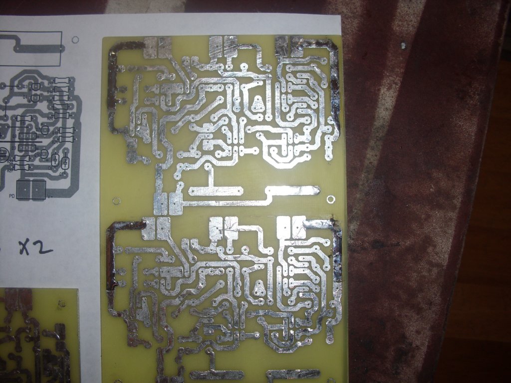

dear sir
greetings can you tell what acid is used for etching pcb along with ferric chloride powder is it muralic acid does it make process fastet and please ratio
of ferric chloride and acid as i use only ferric chloride takes long time

My preference is the ferric one
Muriatic acid is dangerous and need a expensive complementary material in combination.
I use to heat the ferric solution and to move it in waves along the board to be corroded...takes less than 3 minutes to etch.
I do not mix with Muriatic acid...i use only hot water mixed with the Ferric Chloride...solution is dark as Coca Cola.

You can also use Ammonium Persulphate as an alternative to yellow Ferric Chloride.

Hello
You can use a plastic tank with air bubble and a fish tank heater, and you put the the ferric solution and pcb into that tank, the air bubble and heat will accelerate the etching of the pcb.
Here is web pages about that:
DIY PCB Etching Tank | The Inner Qube
Build your own PCB bubble tank!
Bye

What material is that ?? 1/3 H2O2 (peroxide) + 2/3 muriatic 30% HCL , burn a board in 4 minutes. Not a DIY board , a perfect board (below) .. no pits or undercut. Gallon of muriatic and 10 bottles of peroxide cost 10$.. You can etch 50 amps with that or more. Just pour on limestone rock (gravel) to neutralize .. just don't breath fumes .. do it outside with the breeze at your back. 😀
The breeze at your back is important...these products are dangerous
to our health.
I am using Peroxide and Muriatic Acid too (have other name also) ...but the Peroxide, the strong one, is expensive here.
Brazilian postal system is delayed.... boards should arrive last wednesday and didn't..... because Christmas it is delayed....boards are being manufactured in São Paulo - Brasil.... we made contact with the company and they informed have already delivered....trouble is in the brazilian postal system overloaded because Christmas.
After pay pall, you will have to wait 15 days...time that will spend to these boards to travel to Australia.... and this is reasonable, as i have wait 2 monthes to receive things from Germany.
regards,
Carlos
to our health.
regards,
Carlos
- Are you ready to face strong emotions?.. Dx Blame MKII and the Supercharged release!
