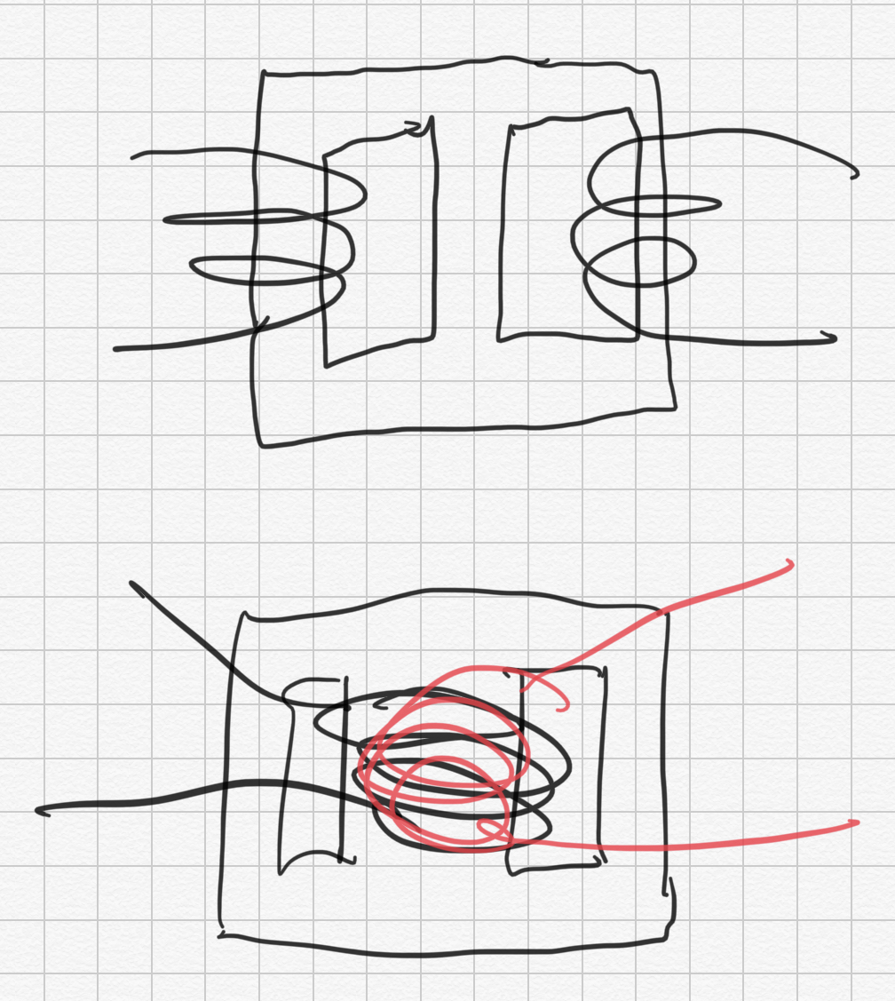

Note I said of the same order.
For EI’s wound on the opposite arms of the windows - typical for PCB mount types (see for example Piltron transformers) - the interwinding capacitance is indeed low. But for high power EI with secondary wound over the primary, the capacitance is hundreds of pF.
www.hifisonix.com
Joined 2003
Like this.

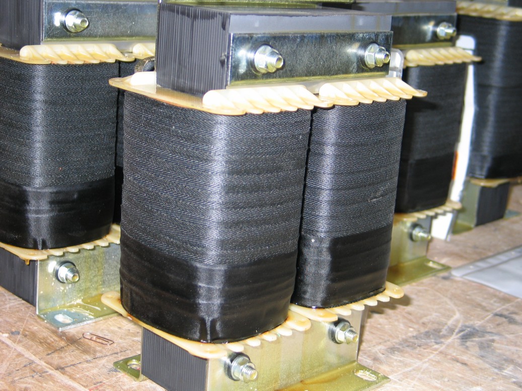

That's a senseless option when the right core material is apparently not available.
What does make sense is a UI core, which is the geometric (not electromagnetic!) equivalent to a single c-core.
Like this:
Seems your opinion doesn't count for much in these matters. They are supplied just like I showed and I’ve used them for hi-pot applications in industrial electronics.
