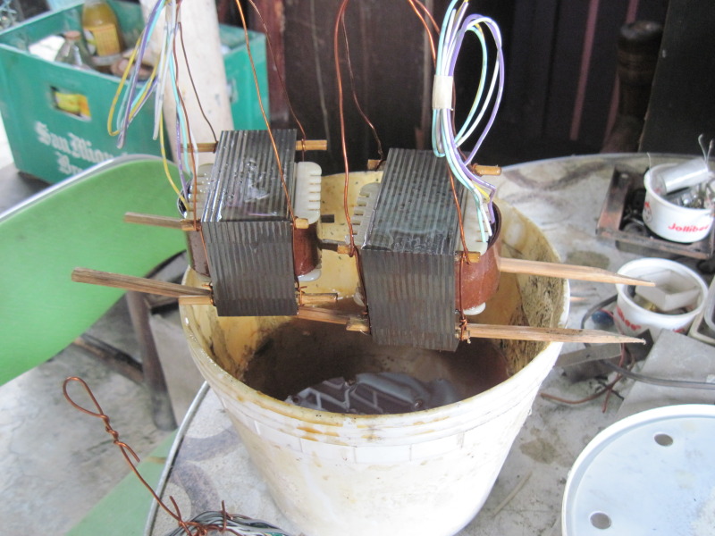

this is how i do it in my traffos...i completely submerge in varnish and soak for 30 minutes...

Varnishing is done to the industrial transformers, exposed to humidity etc. For in-house conditions with near constant temperature due to HVAC there is no point of doing it. It will not render IP20 part into IP40 one. Moreover varnish dissolves wire insulation and if the x_former of yours was not designed to be impregnated then so be it. Film wrap is PET. It provides some insulation as well as mechanical protection. DIYers often use paraffin or wax which could help with heat removal but do not bet on insulation enhancement - both may contain water and procedure is questionable at best without vacuum.
Stated like this it is blanket.
Risk of dissolving wire insulation depends on the properties of the varnish (polyurethane-, epoxy- or whatever based) and the properties of the wire unsulation (there are many different types each with their own specific properties).
never had any problem with magnet wire insulation coming off...not once...been doing traffos for more than 40 years now...
Where did I say bout insulation coming off? Wire is coated with lacquer and you impregnating it with the same. Even if it's not the case, varnish contains solvent which does damage the insulation, period. A lot of transformers are wound without interlayer insulation, especially toroidal.
In case of cherry picking: insulation can be different and there could be safe combinations. However industrial wires often have wrapped around insulation.
P.S. Doing power electronics for 42 years does not automatically mean that I am right or wrong.
