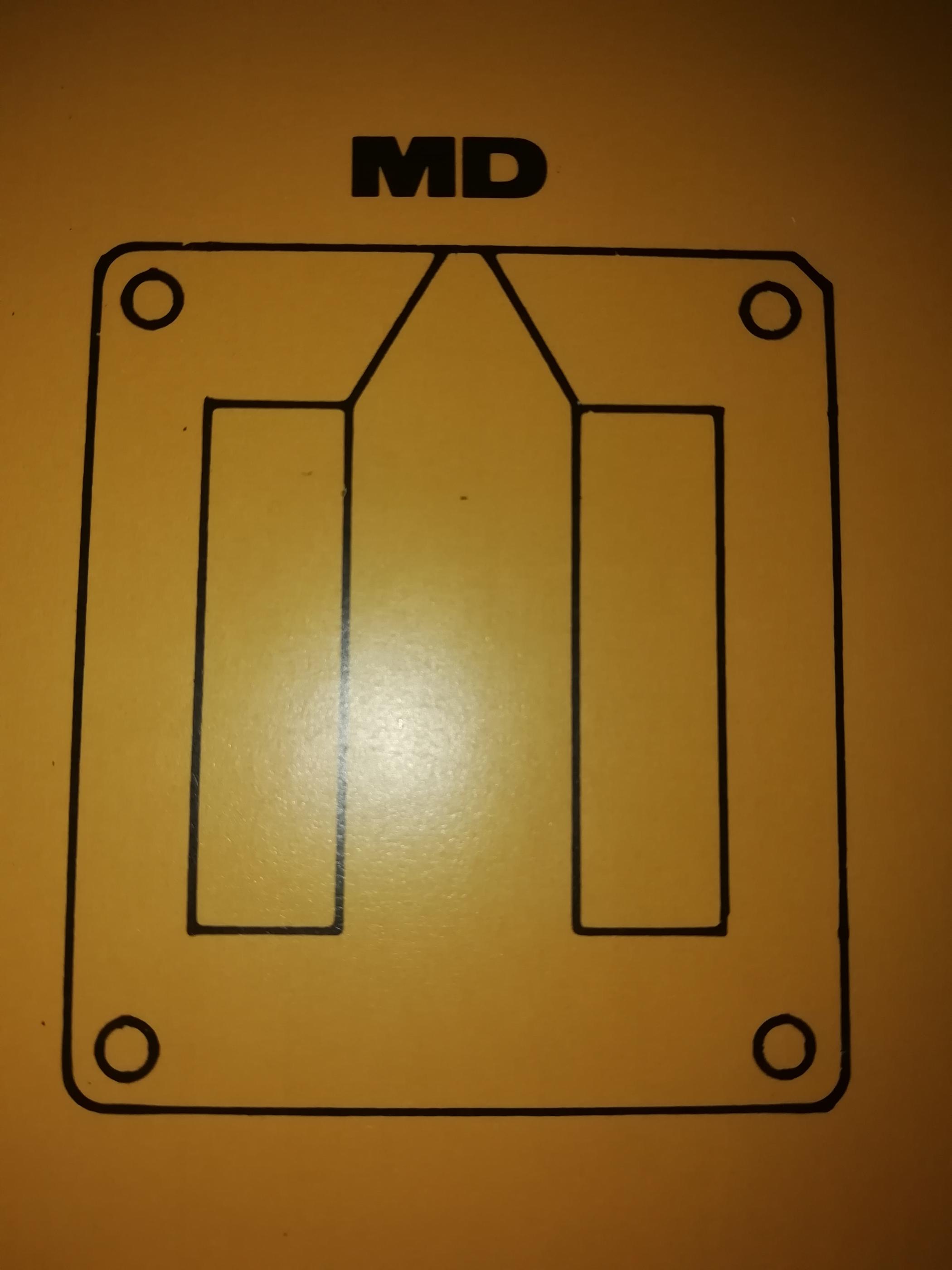

MD core transformer ? How it look ?
Exactly the same as EI transformer except that pieces of steel sheet are cut in the form of letters M and D.
Can you draw it please ?
It looks like this: (source: Waasner Elektro Blechteile)
So it is not a lossless geometry.
