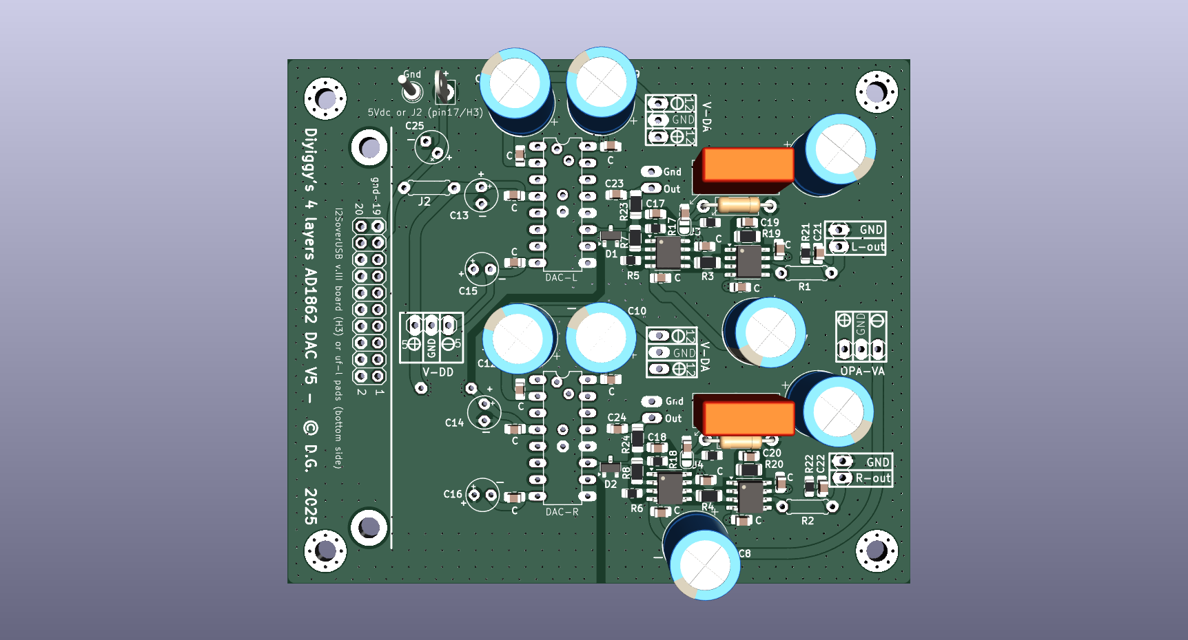

Stop the chineese kitchen DAC, Try the diyiggy Frenchyse (word-game) AD1862 + AD811 voiced during undred of listening tests : 30 euros the pcb (needs the logic front end though for the AD1862 : JLSOUNDS, Iancanada I2S to PCM, York, etc.
Inspired by the excellent work of Miro1360 on his 2 layers boards, I tried to make it the better I can with cheap in mind according european standard. We can't compete against chineese costs and 30 euros the already populated but at least I respect the human rigth as I am the worker here, lol ! ANd everyone is knowing the french cheese is the best ! 😆
Here what a cheap chineese never will : taking into acount the digital and analog current loops, avoid currents crossing, directing some into short loops playing on the layers and through hole parts pth isolation according the layers; matching impedance traces, reduce stray inductance and capacitance where it matters, trying dozen and dozen of passive parts to work on the last percents of sound improvment to voice the DAC, take the best practices of Vref design for the dac chips & adapted to the dac chip model for the layout; giving versatibility by allowing uf-connectors too for the digital input. Allowing the possibility of a buffer. Make the I/V stage versatile w/o sacrificing the layouting : the op amp for I/V can be op861(both R&C i/v smd or tht) or AD811 or classic VFA. Voltage follower op amp if needed (gain or buffer; to pilot a Muse volume chip for instance. And it has a direct curent output near the dac chip for wirering a tube I/V stage if not wanting op amps !

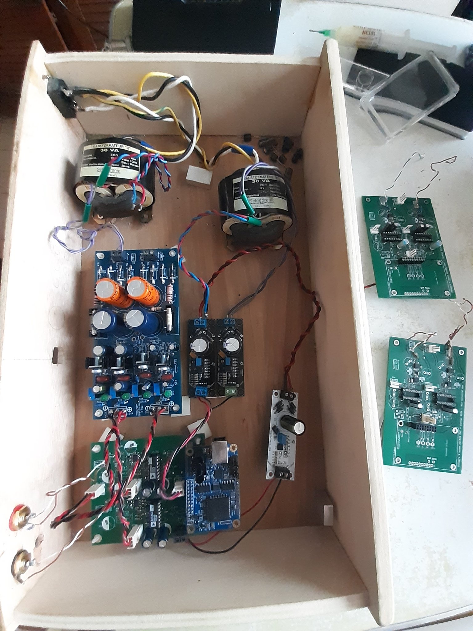

Took me 5 pcbs itterations and more than 2 years to make it good enough by my standard and road-map ! (on the picture 1 : V4 on table and V5 little green square board in the test box)
I also was inspired by Subbu and Jean-Paul work on a 9023 kit they made several years ago at democratic price.
Maybe I am biased but imo the quality difference is in the work in a kitchen made for monney and an enthusiast made in living room for really listened to it. (my standard is TDA1541A Taiwan sound from Rogic with moded output and digital front end with masterclock à la IanCanada or Andrea Mori). I think for the low price I have achieved something really nice to listen to with rythm and non fatiguing sound, snap, enough transparence, and voiced the best I can on acoustical instruents and voices.
Of course, a lot of diyers here achieves that goals already. The AD811 sounds good if voiced correctly (can be parodic and too much w/o care) but imo op861 voiced does as good (it's all about what is outside the chip too... what no chineese DAC from Ali can achieve)

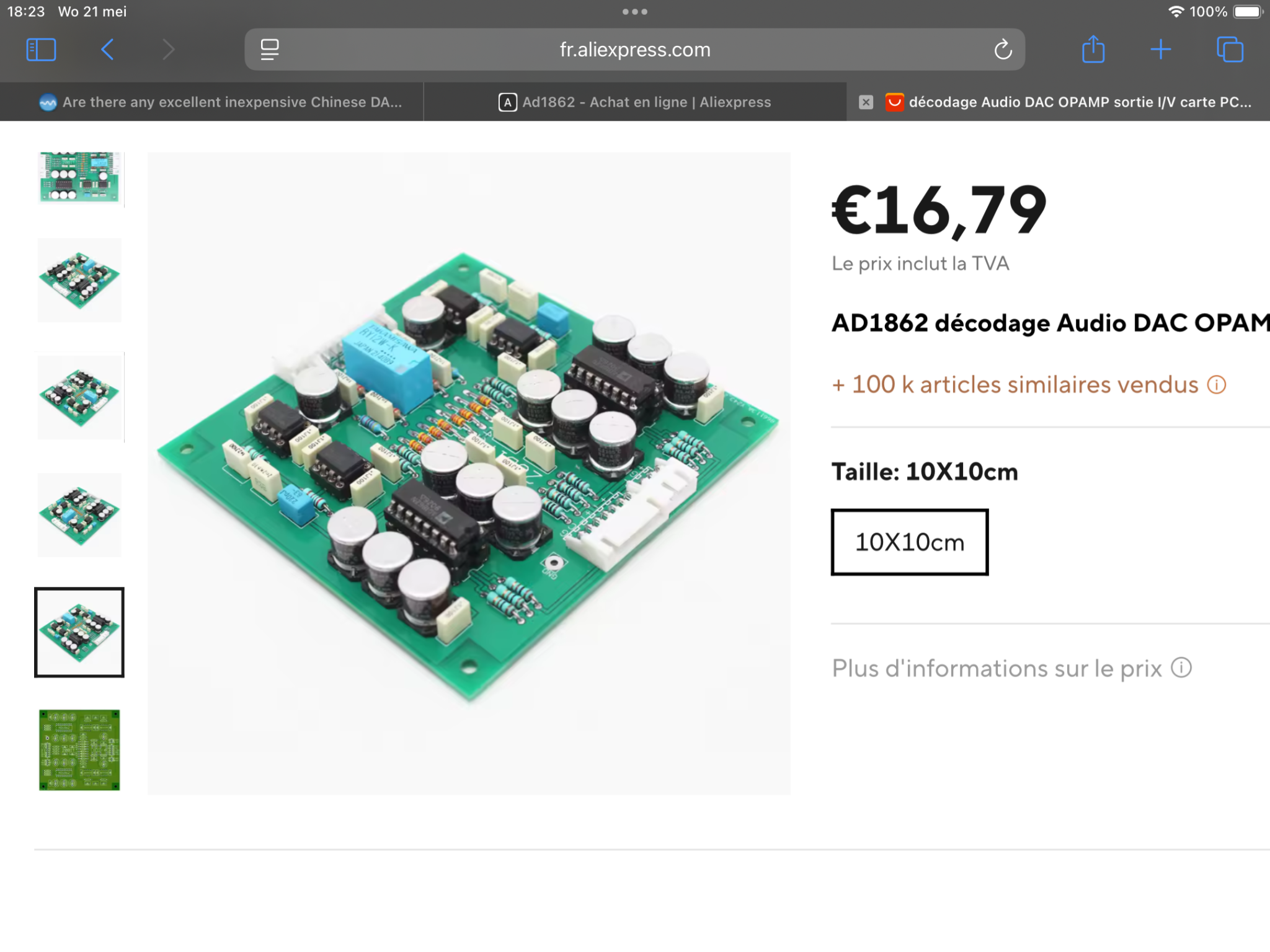

yeah it is NOS. And not chineese (I use to bougth of all those chip boards on Ebay then in Ali... Really doesn't sound like a good developped DAC. And even the chips look fake on the picture....
I have had an AD1865 dac with discrete toshiba SK30A and some nice Toshiba bipolars... sounds like a crap ! Thanks China !
Please do and be happy ! The music will be excellent because your rigth brain will believe you made a good deal ! 😉 . Yes socket is a good idea for fast op amps and false NE5532. What I like is the so called "ad1862" not only looks fake but they have two sockets ! Wonderfull bargain !

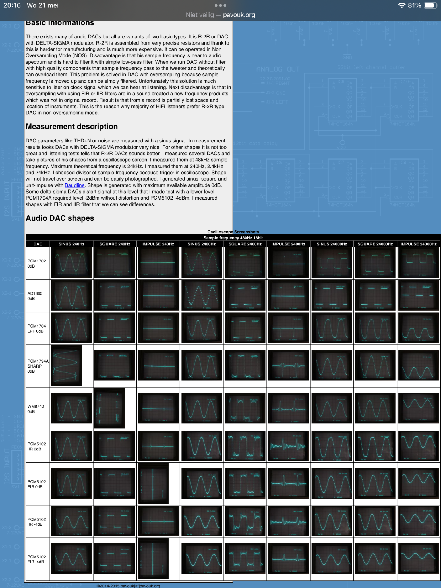

Must be generational, I don't often buy on Internet w/o having listened to it. Each timeI am disapointed. I only trust goodbrands or fanatics that spend time on their designs. Pavouk is okay btw. What will not give you that screen is experience. A PCM1704 24 bits oor a PCM58 doesn't sound better than an AD1862. A sigma Delta not the same than a PCM chips... It is also why I don't care of full SINAD god to choose a DAC like so many do with ASR and buying DAC on Internet without to know how it sounds.... A yes they all sounds the same, I have forgotten that ! 🤣🙄
