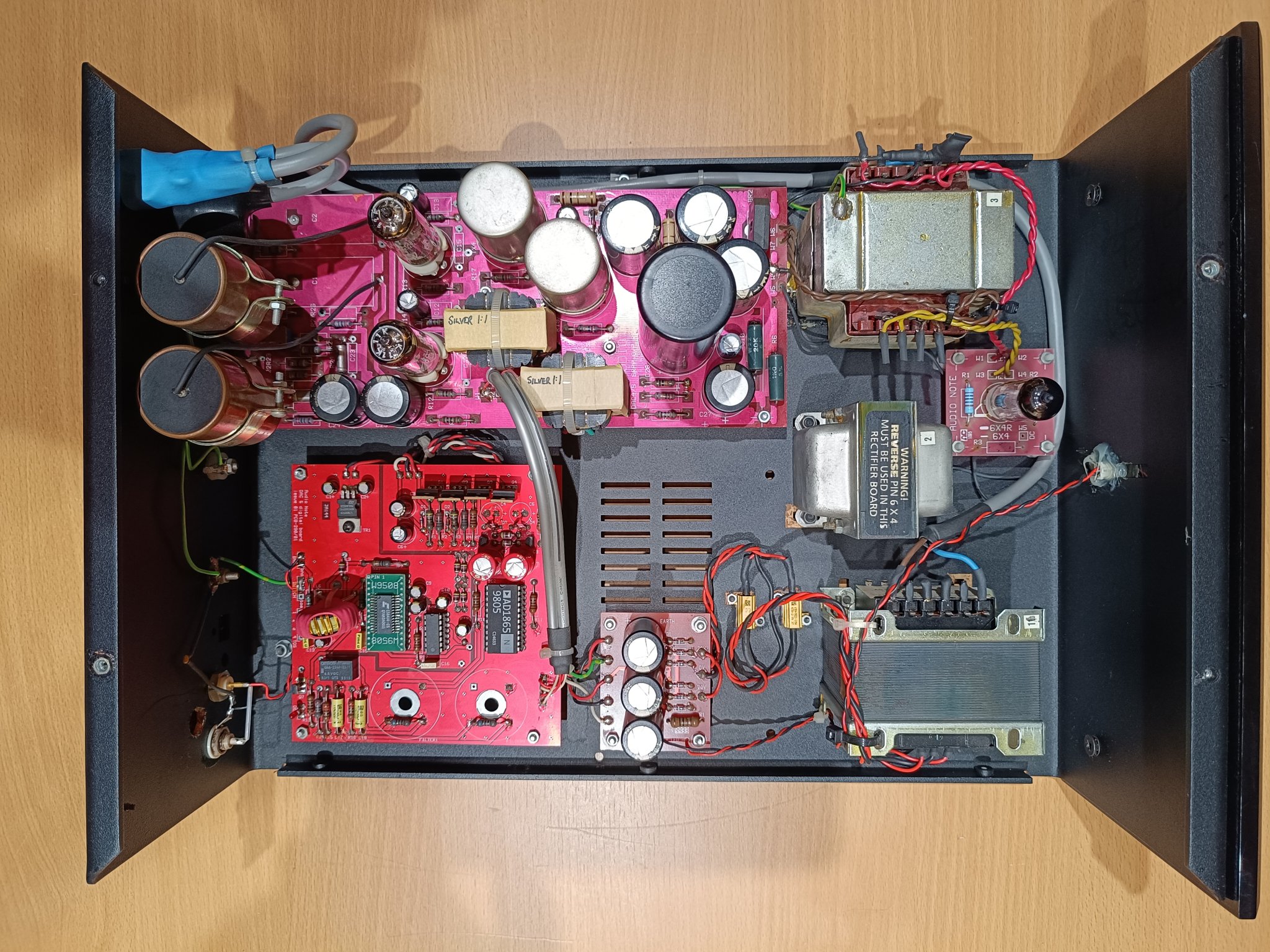

The bottleneck of most of the early Multibit CDPs is the the output section imo.
In 1995, this DAC embodied a step in the right direction:

Audio Note UK... I can see why each passive parts are there o the pcb, from the carbon comp resistor, to Ero mkt yellow cap, Jenzen copper output ones, BlackGate N serie near the dac chip (the did too with AD1862 I like better), Traffos, BG standard caps and over resistors.... parts matter and it is not cheap, although it can be because it is not always about exotic but the rigth part where it is needed according the rest of the active's... I have found in my DAC journey as enthusiast... There will be a guy at ASR will tell youu he can hear the disto of a 20R serie carbon film resistor and you live better with a Dale RN55, lol ! Yes for the numbers on the screen, wonder if those guys really listen to music... Okay nasty, can't resist !

Audio Note. Yes indeed, their parts are not necessarily nuts -well, they do have caps and what not- but it's the LABOR they use to listen and match things. I know for a fact because when one of my amps threw DC and blew the woofer from one of my little AN K/LX speakers, I had to have both woofers and a bunch of parts replaced in the crossovers... OK, so I did get the upgraded woofers, and the system sounds better, but. but, it co$$t some $eriou$ money and almost three months of time.

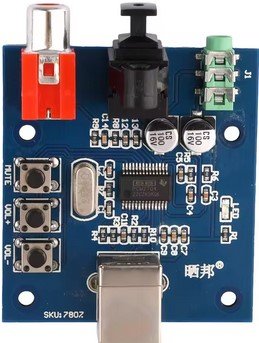

inexpensive DIY
I recently needed a cheap soundbar to connect to a TV box, I had absolutely no desire to invest money in it. I remembered an old cheap 5USD board with DAC PCM2704 (like at attach), powered it through a TPS7A2033, replaced a couple of capacitors, added an active oscillator and was surprised that even this crap can sound much more than it's price. The price of upgrade is less than DACs price, but the result is much bigger than the whole cost.
