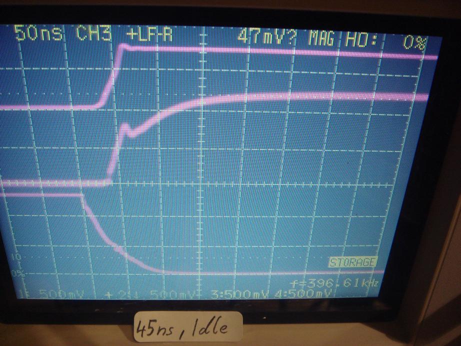

Mechanism of dead time distortion
In order to show the impact of dead time distortion a comparative measurement with original dead time setting (45ns) and
increased dead time setting (105ns) has been done.
Mechanism of dead time distortion:
A short dead time is used to ensure that upper and lower MosFets are never conductive at the same time.
During the dead time both MosFets are OFF. Consequently during dead time the voltage at the switching is not controlled by the switches, but can have any value limited only by the rails through the body diodes of the MosFets.
But even during dead time this voltage is not a random effect, but a deterministic result from the current in the inductor which charges (faster or slower or not at all) the capacitances of the snubber network and parasitic capacitances of the switches + layout.
Means during dead time the voltage of the switching node is massively depending on the load of the amplifier, instead of strictly follwing the HIGH/LOW decision of the modulator.

The second attachement and follwing show screen shots of the switching events:
Time base: 50ns / div
Upper trace: Switching node of half bridge vs neg rail, 50V / div
Mid trace: Vgs of the high side MosFet, 5V / div
Lower trace: Vgs of the low side MosFet, 5V / div
Screen Shot 1:
Dead time setting = 45ns. Idling amp.
Short after Vgs of the lower MosFet is low enough to turn OFF the MosFet,
the switching node starts to slope upwards. This is forced by the inductive ripple current of the filter.
At the time when Vgs of the upper MosFet reaches values, which turn it ON, the switching node is already close
to the upper rail and just the last 20V are pulled up hard by the MosFet.

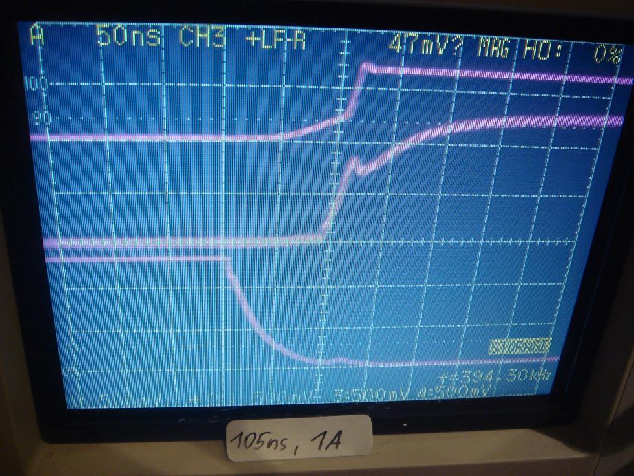

Screen Shot 6:
105ns, 1A output current (pointing from amp output to load)
the switching node starts to slope upwards. But even slower than in screen shot 5.
Now most of the sloping has to be forced by the upper MosFet.
Screen Shot 7:
After Vgs of the lower MosFet is low enough to turn OFF the MosFet,
the switching does not start sloping, but remains at the level of the neg rail during the entire dead time.
The 1.4A output current are larger that the peak of the 400kHz filter current ripple and now the current direction
in the filter choke does not force sloping anymore, but ties the switching node to the negative rail, where it gets clamped by the body diode of the lower MosFet.
After the dead time when the upper MosFet is being turned ON, it has to remove Qrr from the body diode and then pulls up the switching node. This situation of hard switching including Qrr removal is the most demanding situation for the switching stage and poorly designed class D amps often show heavy HF ringing. The CDA-224 is handling this perfectly fine.

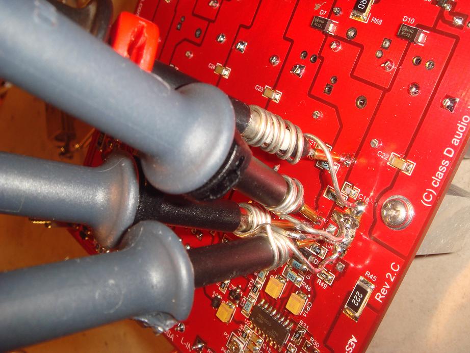

First attachment:
Photo of the CDA-224 with measurement Probes.

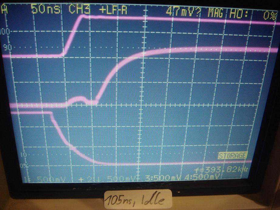

Screen Shot 1:

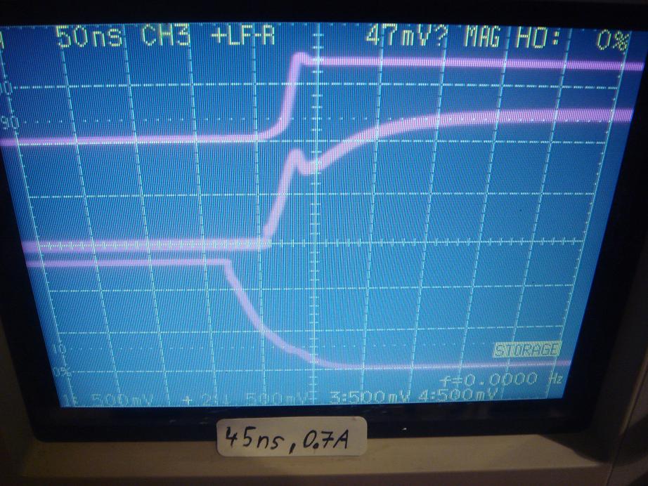

Screen Shot 2:
45ns, 0.7A output current (pointing from amp output to load)
the switching node starts to slope upwards. But much slower compared to the first screen shot,
because the 0.7A output current reduce the amount of available inductive current.

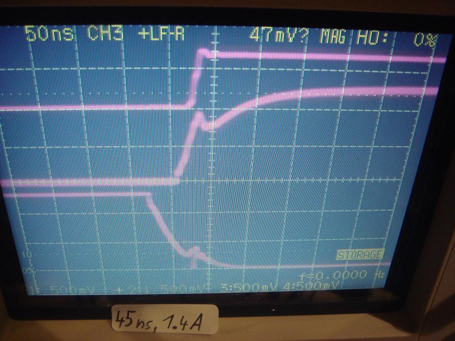

Screen Shot 3:
45ns, 1.4A output current (pointing from amp output to load)
Screen Shot 4:
Dead time setting = 105ns. Idling amp.
At the time when Vgs of the upper MosFet reaches values, which turn it ON, the switching node is already fully tied
to the upper rail.

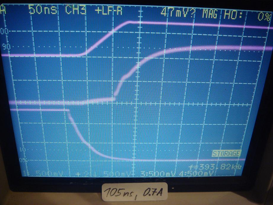

Screen Shot 5:
105ns, 0.7A output current (pointing from amp output to load)
the switching node starts to slope upwards. But much slower compared to screen shot 4,
Still the switching node just reaches the upper rail before the upper MosFet is being turned ON.

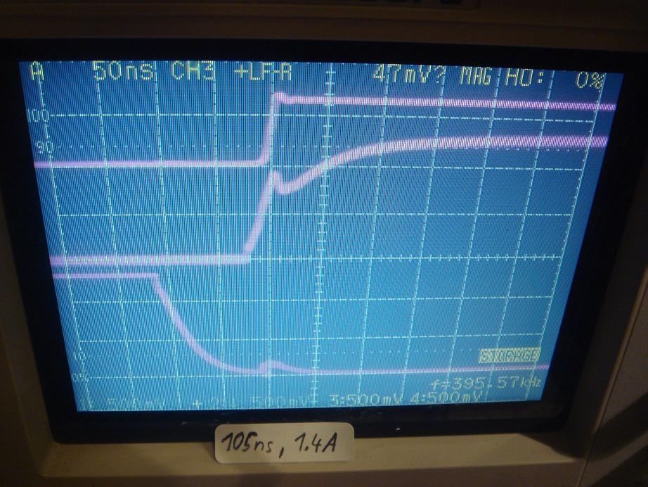

Screen Shot 6:
Screen Shot 7:

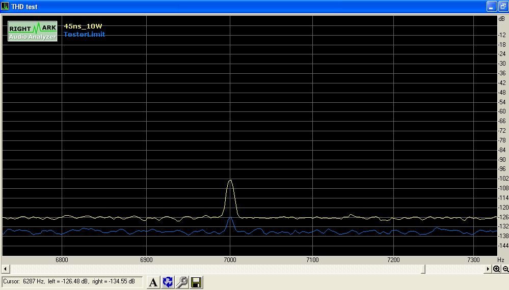

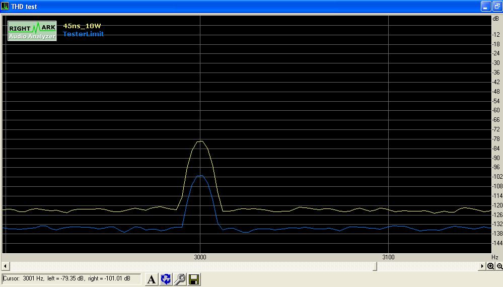

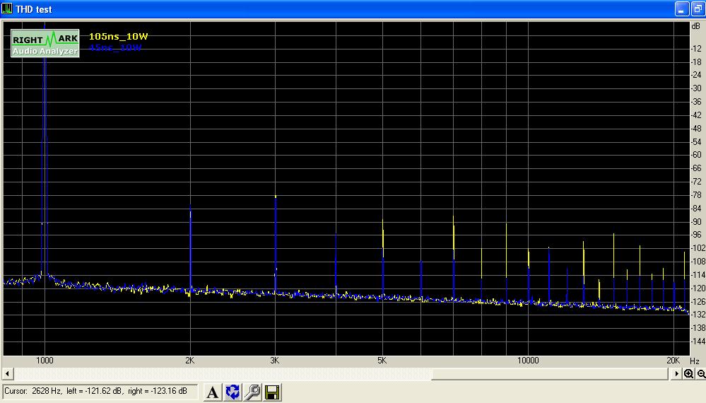

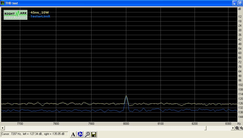

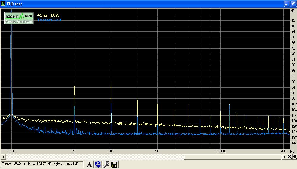

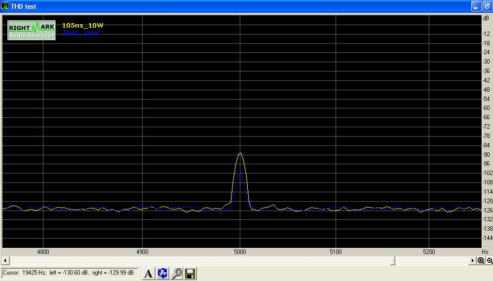

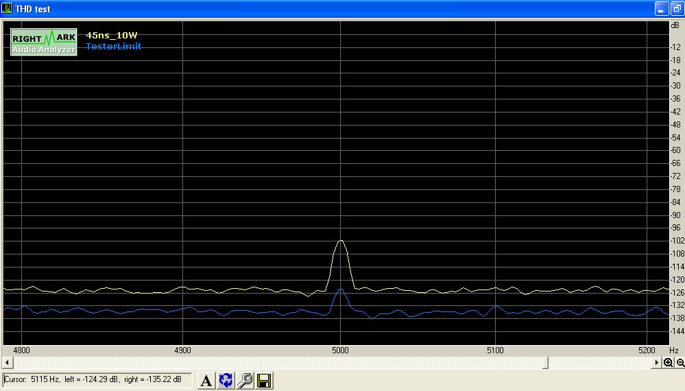

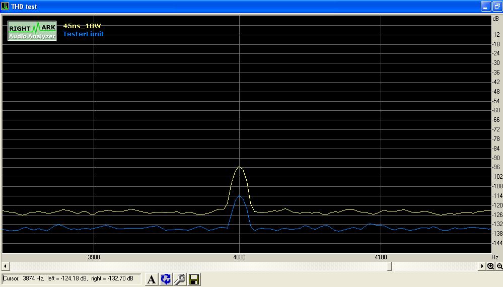

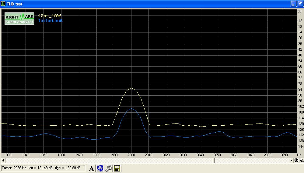

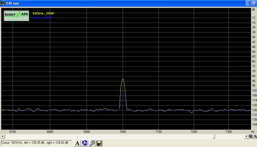

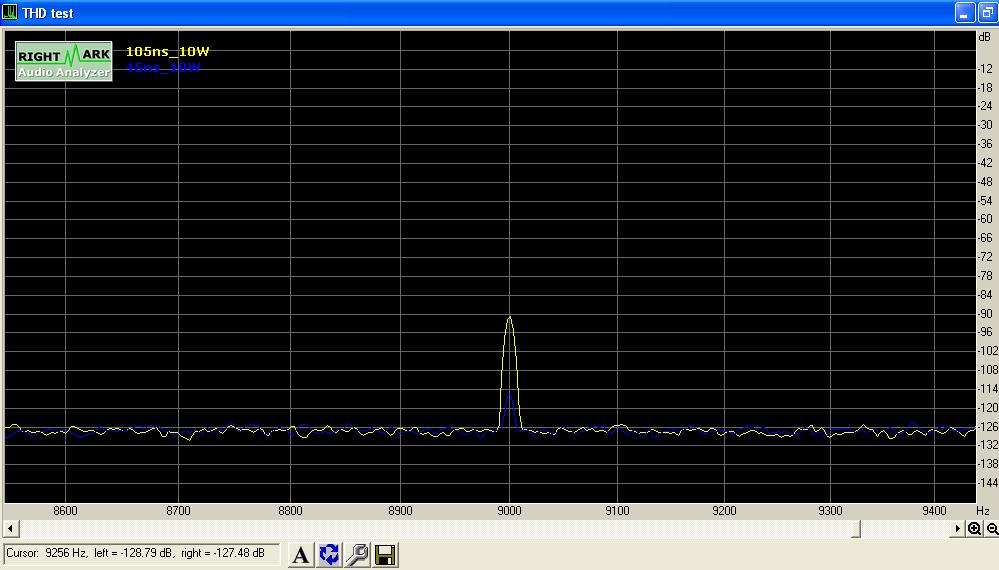

Consequences of dead time distortion
The mechanism of dead time distortion is leading to distortions, especially long dead time results in
an unpleasant broadband "splatter" of harmonics.
In case of the CDA-224 an increase of the dead time setting from 45ns to 105ns boosts up most of the
higher order harmonics by 10...15db. The 9th grows more than 20db....
The attached files show the comparison of the distortion spectrum with 45ns and 105ns, when driving a resitive 4R load with 10W.
First the full spectrum 1kHz..20kHz, then some zoomed details on 5th, 7th and 9th.
Such figures are not a specific short coming of this implementation - but the distortion mechanism is in the nature of half bridge / full bridge based class D amps with ordinary PWM modulator.
Obviously the precision in the control of the MosFets is a key topic for low distortion.

Markus, you might not have sent the right attachments with your last post, and I am curious to actually see the difference.
Hi Vac,
which kind of attachments would you have expected?
To me they are looking like intended.
All graphs show two lines, where the blue line is showing the spectrum with a dead time setting of 45ns and the yellow line is showing the spectrum with a dead time setting of 105ns.
Starting from 5th order the yellow peaks are significantly higher than the blue peaks, especially for the odd orders.
In numbers:
k5: -102db with 45ns but -89db with 105ns ==> worsening by enlarged dead time: 13db
k7: -103db with 45ns but -88db with 105ns ==> worsening by enlarged dead time: 15db
k9: -115db with 45ns but -91db with 105ns ==> worsening by enlarged dead time: 24db
In numbers:

By comparing posting #40 & #42 you can see, that the limits of the measurement system are proven clearly better than the unmodified original amp, except k8 & k11.
For reference I am attaching the direct comparison of the unmodified original amp (dead time setting 45ns) vs the test system.
...well, to me even the spectrum of the unmodified amp looks a little bit like spl... 😀 , but most amps do - and IMHO in the region of -100db this is not a catastrophy.What you do show is that using the amplifier as delivered there is no dead time induced "splatter" and any distortion components are more than 100dB down . . .
Furtheron if you can easily turn the moderate peaks into skyscrapers simply by increasing the dead time just a few ns then this is a nice visualisation that the mechanism of dead time distortion introduces a pretty unpleasant spectrum of distortion.
I am not saying that classD is bad, I am also not saying the CDA244 would be bad. IMHO the distortion figures of the CDA224 are pretty good.
I am just disagreeing that classD would inherently better than class AB, because of the absence cross over related high order harmonics.
Both technologies can be brought to reasonably low amount of high order harmonics, but both are suffering from unpleasant distortion effects which are related to the use of two power devices, whereoff one is needed to provide positive currents into the load while the other is needed to provide negative currents.
And I am saying that the classD technology is less mature than classAB, which leads to a larger spread of design quality in the market place.
