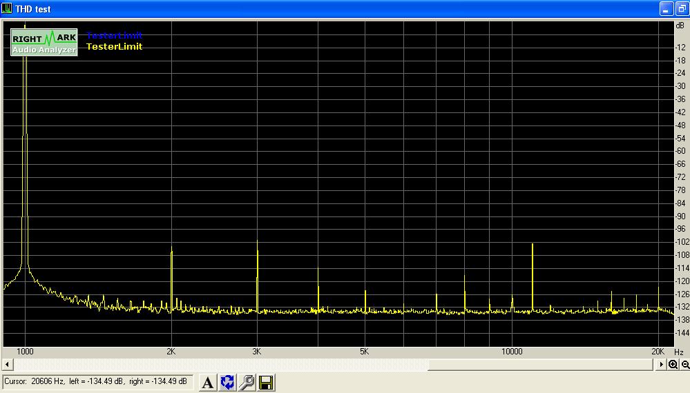

Pre filter feedback isn't ideal but I have seen quite a few designs with post filter feedback.
I certainly cant tell the difference between class AB and D so if there is distortion in class dit is so small as to be disregarded. At least for me.
The designer can be careful with deadtime and minimise it. I run my amps with 105nS of dead time and cant hear any distortion.
I guess the proof one way or another is a distortion tester.
I would guess that the distortion is too small to worry about.

I am afraid of an upcomnig discussion rgearding the detailed shape of my simulation vs Bruno's presentation....
But that's just a matter of parametrization.
Attached the result when we change the filter and the load to 10uH, 2uF, 2R.
Then it looks like in Bruno's presentation.
Feel free to play with parameters.

It is a good implementation of the reference design. It sounds good. Note the low input impedance, and the documented sensitivity to load impedance.So I ordered . . . the CDA-224 from class D Audio.
I look forward to seeing your measurements of "dead time distortion" at the amplifier output (after the filter), and an explanation of how you measured that distortion (and what it "sounds like").

Measurement Equipment
This post describes the test equipment, which I used for the measurements regarding deadtime distortion.
The scope measurements have been done with an IWATSU Storagescope TS-8500 with 500MHz bandwidth.
Scaling will differ from the display, because the used probes where 1:10 and 1:100.
Effective scaling will be written in the post with the screen shot.
The distortion measurements have been done with an USB sound card, Creative E-MU Tracker Pre.
A slight upgrade of the card: OP amps changed to OPA2134, which improved noise a little bit and keeps drive distortion low even at load impedances of a few hundreds Ohms.
The attached measurement in this post is showing the limitations of the sound card itself.
Obviously this cannot compete with an AP2, but the worst errors of the sound card are in the range of -100db,
which is easily good enough to show the dead time distortion.
In front of the sound card input a simple passive 3rd order low pass with bandwidth of approx. 20kHz has been used,
in order to avoid irritations from the 400kHz carrier of the class D amp.
