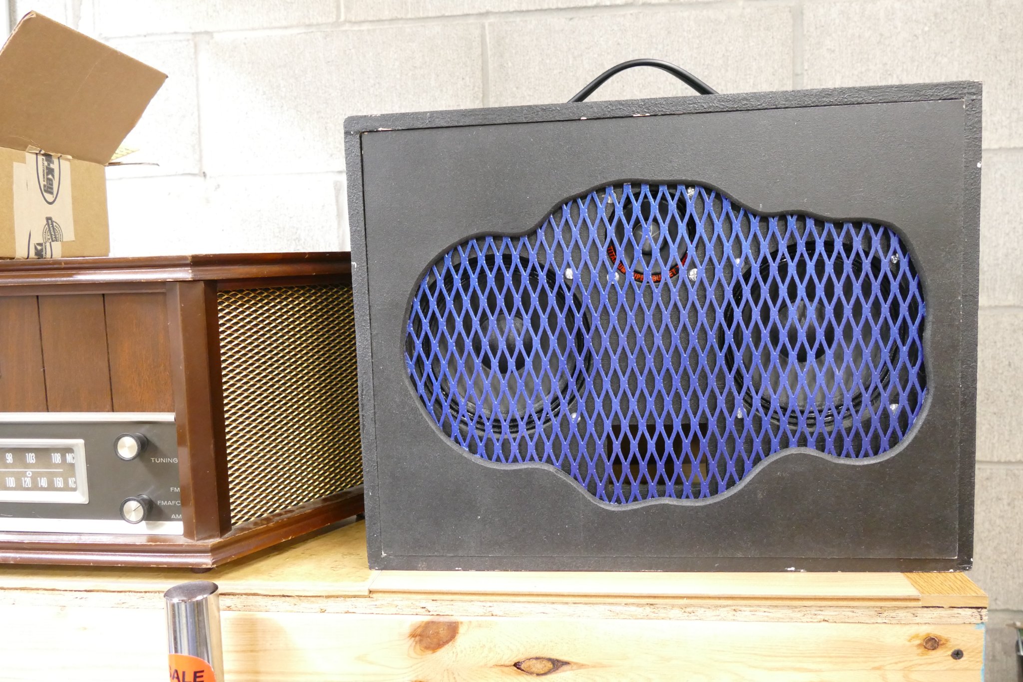

Almost 15 years ago I slapped together a pair of "test speaker" with one goal in mind. They needed to eat whatever I fed them without destruction and be made cheaply so that I wouldn't be too upset when I found their limits. This was during the time frame when I was extracting big power (125 to 250 WPC) from Pete's Big Red Board and I did not want to risk my Yamaha NS-10Ms. They were made with plywood that was "too thin" using a pair of 6 inch drivers that cost $22 each at the time (now $30). I added a bullet tweeter with an ON - OFF switch since I would play guitar through these and distorted guitar and tweeters are not friends. Shortly after making these speakers, I found myself doing the PA system for a friend's rock band at an outdoor show where they were fed by a 125 WPC version of the Engineers amp running at the edge of, and often into clipping for two days of near continuous use. "How do those little speakers get so loud?"
The poor speakers got to eat the full output of one of those discounted TI TPA 3255EVM boards until I thought that I had finally blown one of the drivers by playing bass guitar through it at full tilt to see how far I could launch a wad of paper that I stuffed into the port. Autopsy revealed no blown driver, I had just rattled the nuts that held the drivers loose. There are now two nuts on each driver. The speakers still work fine with the original drivers in them. I recently bought another pair for a bi-amplified guitar / bass amp project that will use an Eminence "450 watt RMS" driver for the low frequencies.
Oddly the Engineers Amp with no GNFB sounded quite good through these speakers. The class D TI EVB did not impress me with the same sound quality, but it was LOUD!

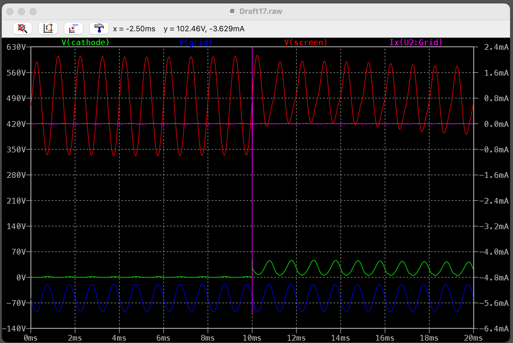

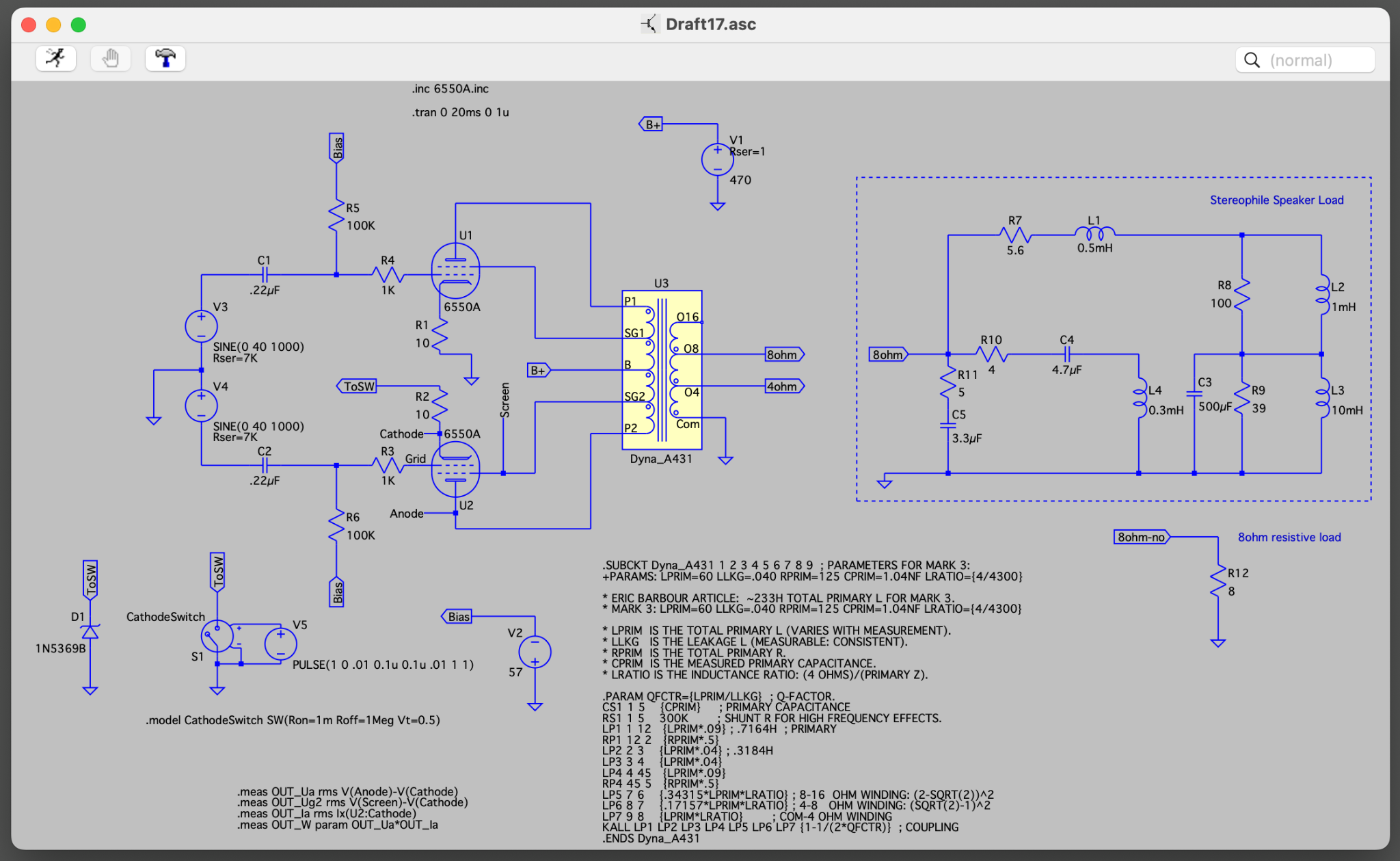

In the sim I added a switch that opened the cathode and it does look like the grid current goes up very briefly but it looks like it coming from the driver stage and is a function of it's output resistance. I did add a 51V zener across the switch to clamp the cathode voltage. I'm assuming when the fuse opens it's because the tube has runaway and the goal is to potentially save the output transformer. I think this would be the same scenario using a small wattage resistor as a fuse.
