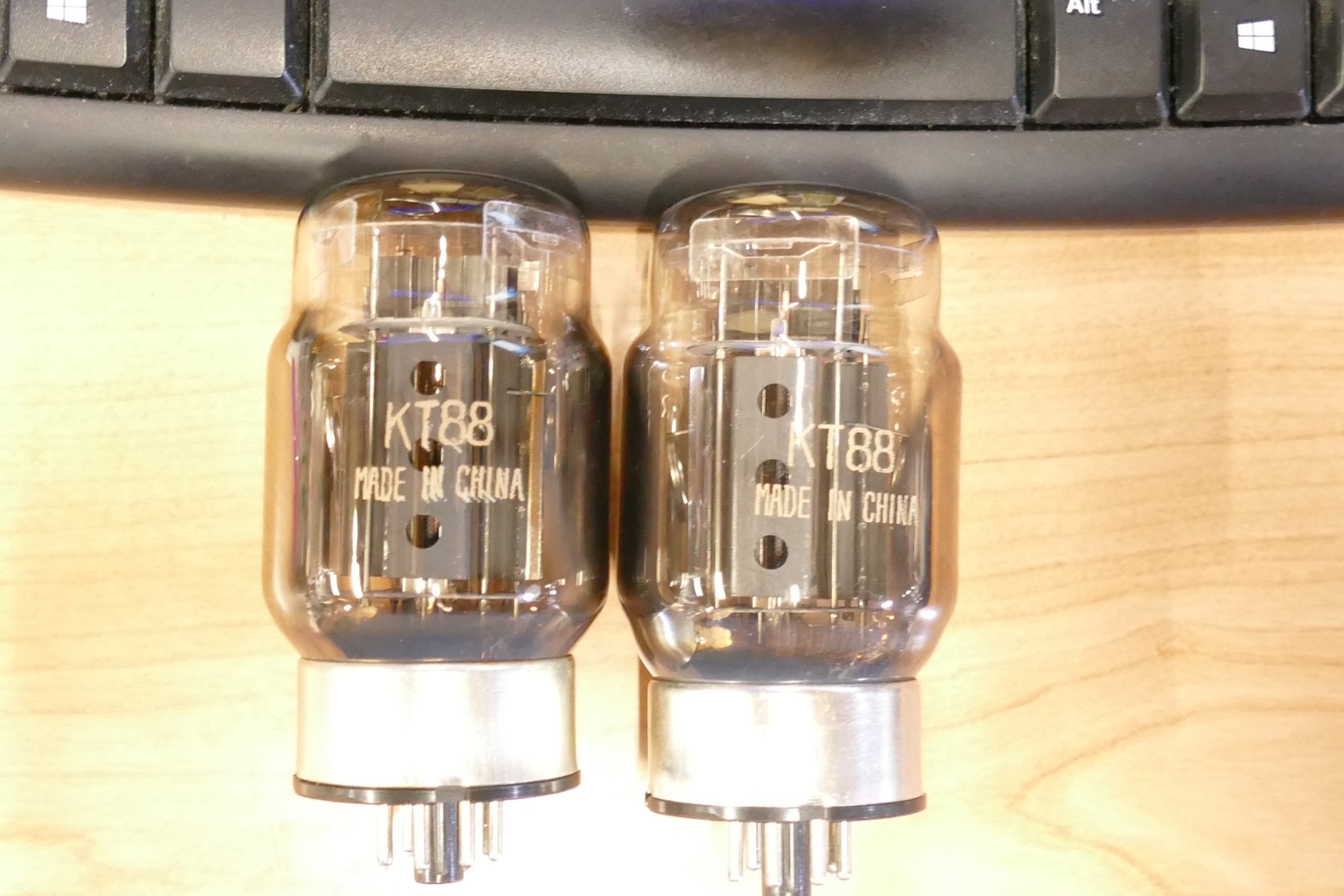

As baudouin0 mentions, Le fireworks display; back in the early 1980´s I was unwisely tempted into some of the first Chinese made KT88s that appeared by Western vendors, and sure enough I did experience the oriental fireworks display from them, and it was this aspect that made me "do anything" to protect the output stage vitals.

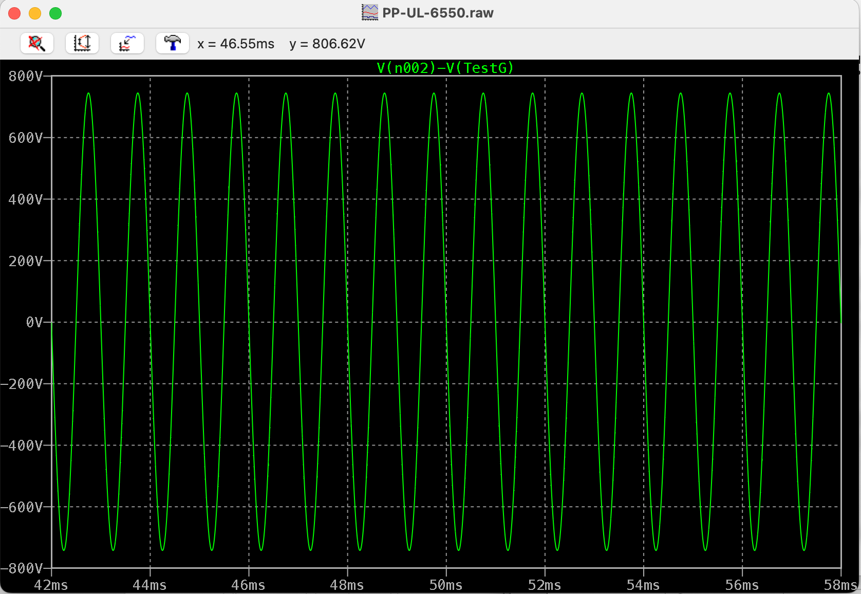

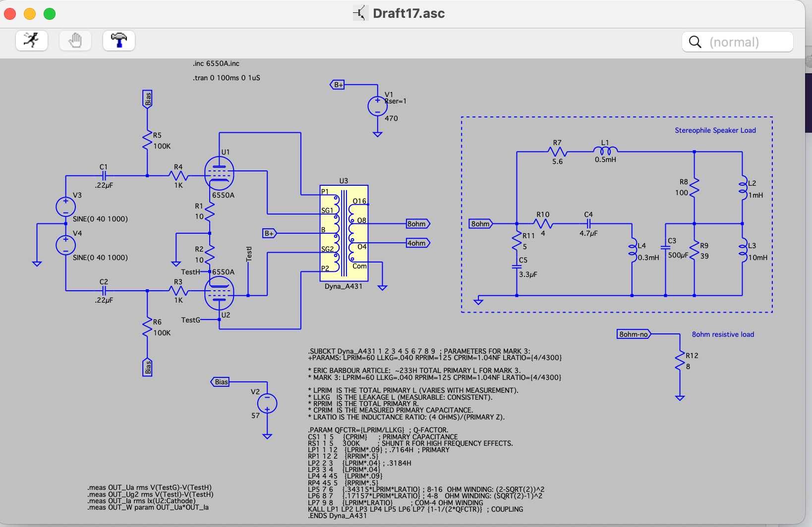

I did a quick sim of 470V B+ driving a pair of 6550s with a A431 to 60W into 8ohms - the peak to peak voltage is almost 1.5kV across the OPT primary. I think I'll be very cautious with any sort of B+ fusing, I think @trobbins suggestion of fusing the secondary CT of the power transformer is worth exploring. Modern power supplies can have a large amount of stored energy compared to stuff from the 50-60s due to large low ESR high voltage capacitors, in a fault that energy will go somewhere and maybe not where I expected - I think I have a new view: more is not necessarily better concerning PSU capacitance.
ESRC got a hundred of them in the mid 80's. After selling a few and having nearly ALL of them returned he sold me the remaining tubes real cheap, $2 or $3 each I think. This was the first time I ever saw a tube spark out on power up so violently that the glass broke! Most would red plate below 35 watts, some would hot spot at 20 to 25 watts of dissipation. I used some low buck guitar amp OPT's with these tubes but kept the power output to 35 WPC or less. Still over half the tubes would not live for more than a week of use. Now 40 years later I still have the two tubes that refused to die, and they were beaten hard in a 100 watt guitar amp running on about 500 volts. Really, two out of 100 isn't so bad? These tubes were being squeezed for all they had when there was a fireball on the bench. The OPT had burst into flames. Instantly I blamed the tubes but autopsy revealed that my test load made with four Radio Shack "noninductive 8 ohm audio load" resistors wired in series parallel on a heat sink had gone open. The tubes survived, the OPT was literally toast! I bought a pair of 8 ohm 500 watt resistors. Even I can't blow them up.
Can you elaborate on your sim please, as simple PP voltage would not exceed 2x 470V. Like Tubelab, I've been able to create conditions that force higher transient voltages than 2x B+, as a way of confirming the ease and benefit of soft-clipping those transients with a MOV across each half-primary winding - https://www.dalmura.com.au/static/Output transformer protection.pdf
In class B the Vpp across one half-primary reaches 2*((B+) - Vak, min).
The Vpp across the full primary is twice that value.
"Vak, min" is the plate to cathode drop at the peak plate current. It is somewhat increased by UL operation.
Assuming a minimum Vak of 90V, the full primary voltage would be 1520Vpp.

Simulating an amplifier with a resistive load, or even a simulated speaker load with a single tone sine wave will not give you the true picture
I agree George - I have a 4kV scope probe and a pair of 200W non-inductive resistors but I think I'd need to build a Stereophile speaker load to get close to measuring anything for real. I think @Rikaro is correct about class B but I'm not a EE and typically math challenged, I rely on LTspice to understand things.
