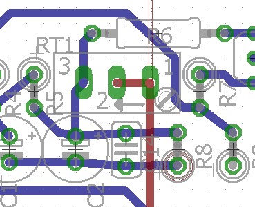

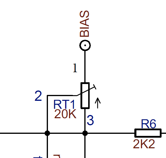

Hi Vincent,
I'm probably being really dumb here :eek: but I cannot in my head understand the mapping of the circuit from the schematic to the PCB.
Taking for example the variable trimmer pot RT1, let's say pin 1 is at the top and goes to Bias, pins 2 (middle variable one) and 3 are shorted together and go to R5, C2, C14, R6 and R8.
Looking at the Eagle PCB routing, the Bias pin 1 next to the pot screw is shorted with the middle pin 2. Pin 3 goes to R5, C2, C14...
So the PCB drawing shorts pins 1 and 2 whereas the schematic shorts pins 2 and 3.
Have I misunderstood something?
