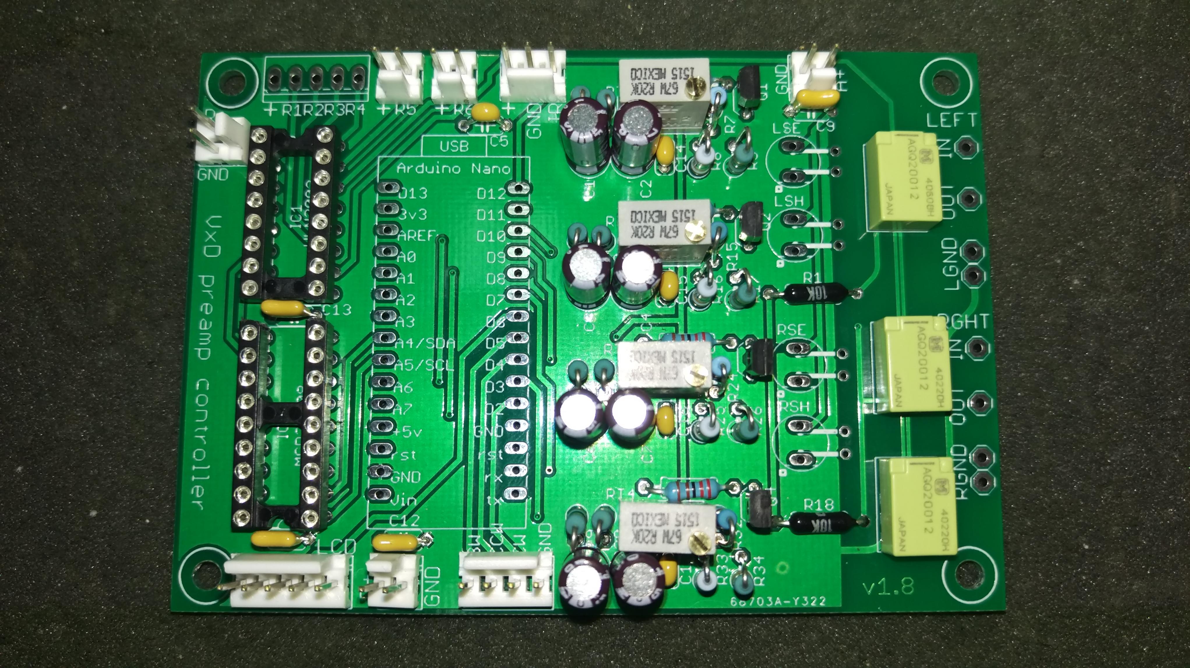

Can you check the schematics? I want to order PCB' s (without fourth board: needs from customers more options and features!)...
Wow, you put a lot of work in it!
Looks good.
You don't need diodes on relay coils (the ULN2003 has them inside).

Looks very good JPS! A few minor nit picking things :
1. I think the final result would look better if the encoder and the power switch were all located on the display centreline?
2. I think it would good if this could be put into standby using the remote. Is this possible? The display would need to be blanked and the LDRs set to lowest current to preserve them. Is this possible with the current design?

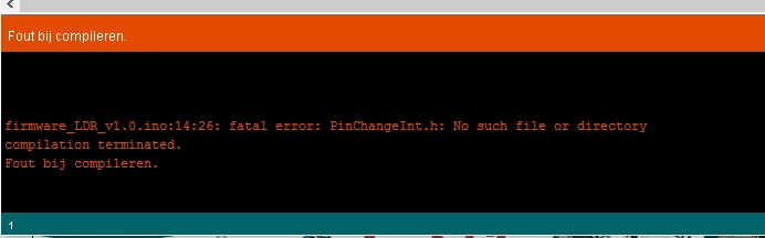

Hi Vincent,
I've tried to compile the code but without any success. I have loaded the PinChangeInterrupt library available to download, but when verifying, it complains:
Are there other customised / specific libraries that should be loaded?

Indeed, I forgot to mention the libraries.
Just copy the contents of this archive in the My Documents\Arduino\libraries folder, or follow the instructions here: https://www.arduino.cc/en/Guide/Libraries
