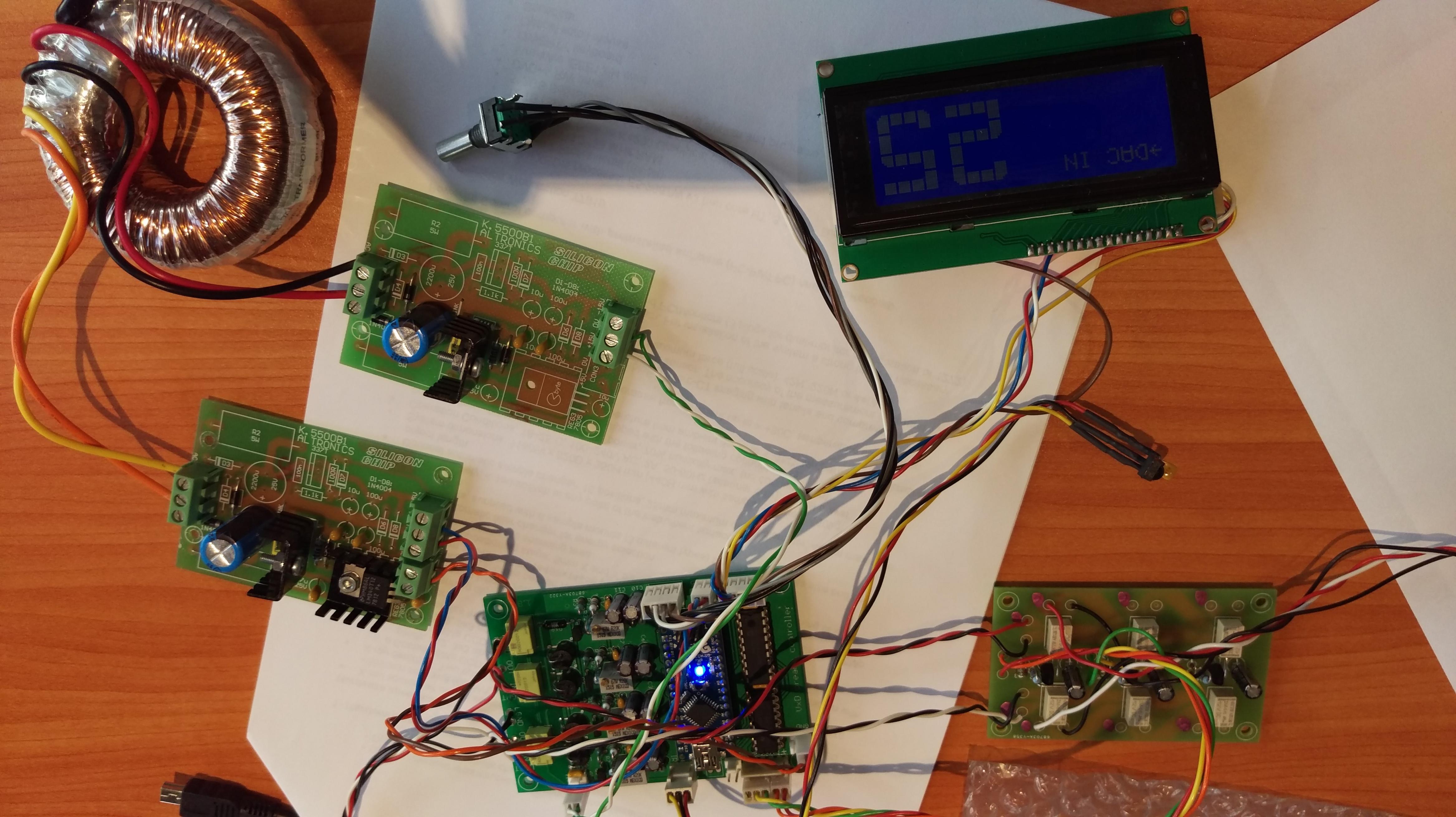

Calibration complete without any errors, it took approx 10 mins for this. i got default volume shown on display and tested by connecting attentuator to signal.
The sound was good however when i rotate encoder sometimes the volume not moving up/down and its stuck at a specific level. The response is very slow. Not sure whats causing this. The encoder am using is PEC11R-4220F-S0024 obtained from element14.
Not sure why, either. Mine is fluid and responsive.
If you can't find a hardware cause, you could try the debug mode to see how the rotary encoder is sending signals.
All is well. I figured out, its a loose GND on Rotary encoder causing misbehavior.
