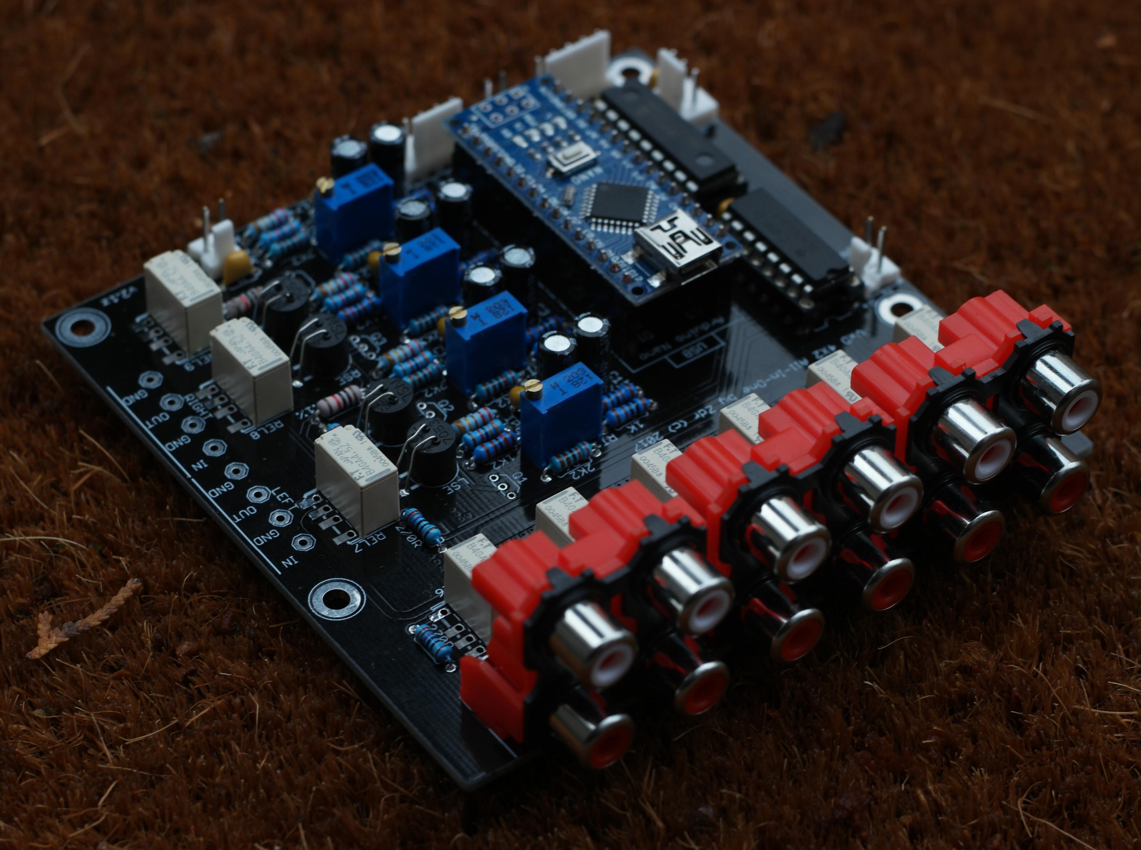

Latest All-In-One boards just arrived. They are now accepting RCA connectors directly on board, no more messy cables to RCA😉
That looks great!
The psu board from Vincent is compatible with your implementation?
Do you provide smd to through hole pcb for the FDV301N?
Both smd and through hole fets are accepted on board. Original PS works with the AIO PCB.The psu board from Vincent is compatible with your implementation?

Price is 45eur with 9 Omron relays on board plus shipping.Do you have pcb's available and what is the price ?
Where do you find those connectors ?
Ronny
Connectors used to be available on AliExpress, but I cannot find them any more. I ordered similar ones to see if they can fit. Otherwise I can include connectors I have with PCB on request.
