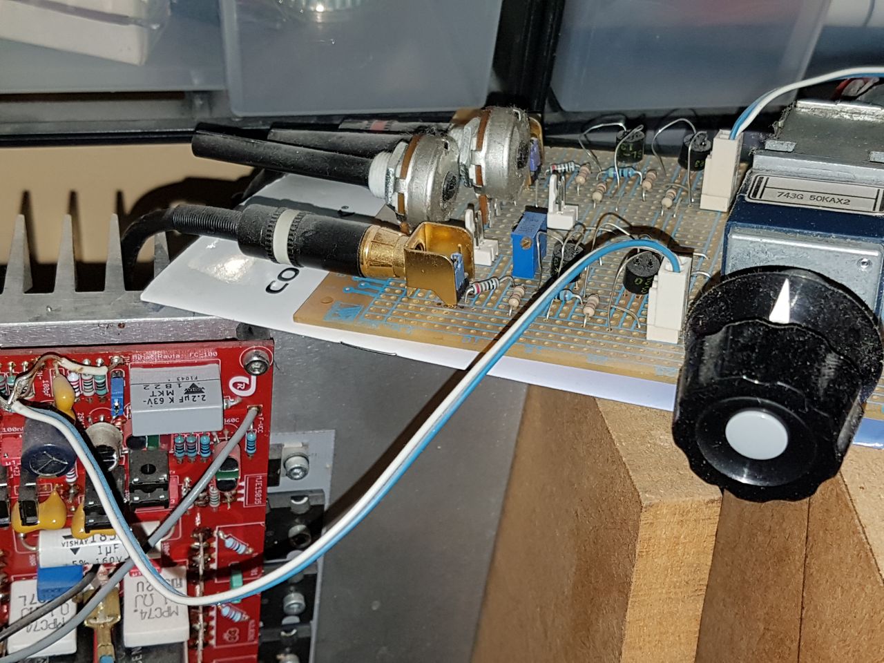

Thanks for the link. Unfortunately that one is too narrow to include all my controls (I have 5 buttons and the rotary encoder in addition to the LCD).
I ended up buying a grey plastic 2U rackmount chassis. I will fabricate a wood front panel (birch? beech? cherry?) while I continue development. I should be able to remake the front panel if I need to change something. The only challenge is lettering. Maybe down the road if/when the design becomes finalized I will get a custom chassis and front panel - those always look very professional.

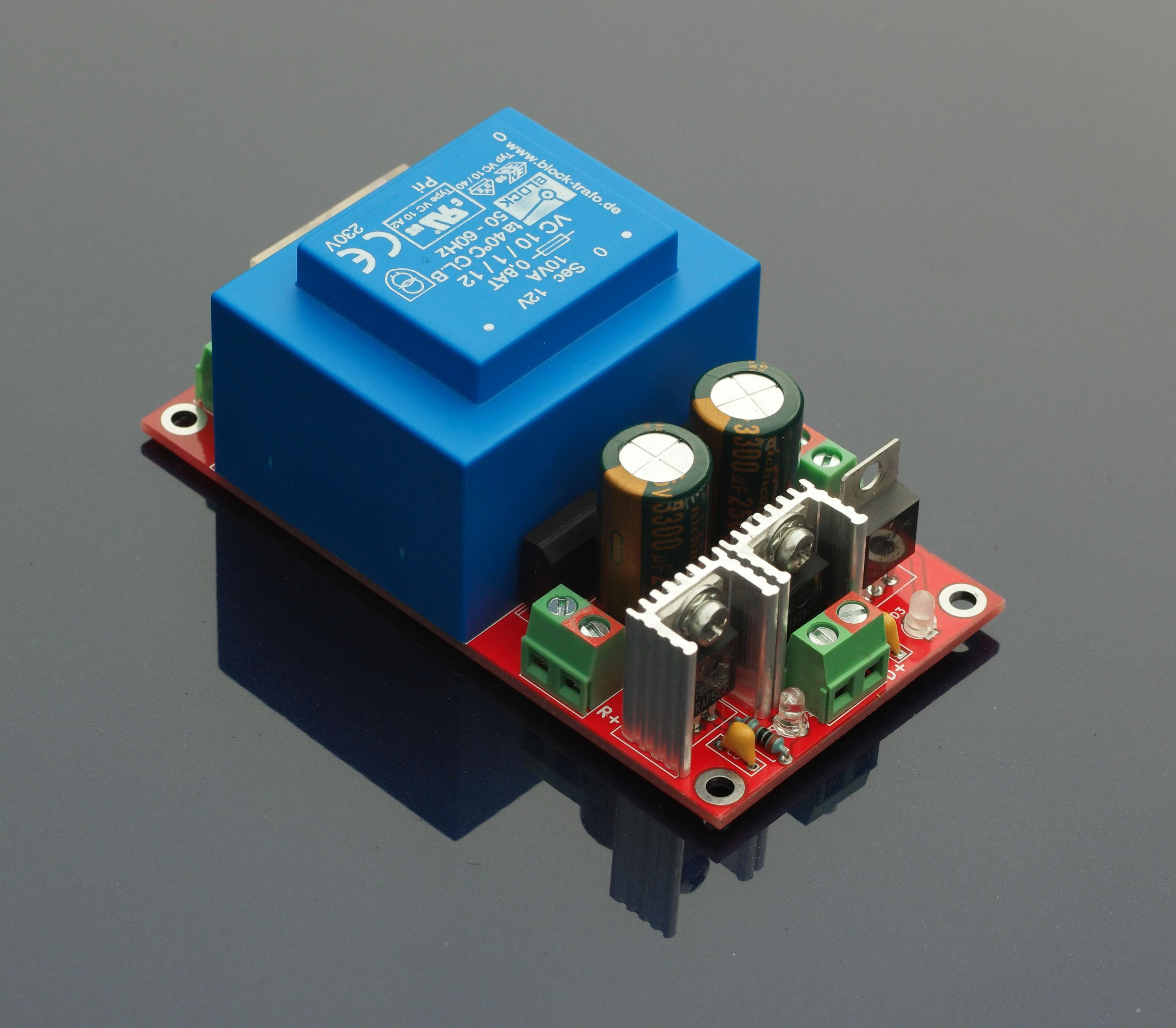

@zdr, I noticed the extra resistors R37, R36 on the new all in one layout. Given their placement, I am assuming that these are for i2c termination. Would 4.7k be an appropriate value for these? Thanks!
Yep, they are i2c pull-ups. 2k2 recommended, but 4k7 will do as well.@zdr, I noticed the extra resistors R37, R36 on the new all in one layout. Given their placement, I am assuming that these are for i2c termination. Would 4.7k be an appropriate value for these? Thanks!

I was not able to make remote work with Arduino IDE higher than 1.6.9. I did not put much effort either. If anyone had made this work with latest IDE, please do chime in.
I have made some slightly redesigned PS PCBs which have common ground for all voltages, since they were interconnected through controller board anyway. PCB can also take cheaper (220V only) EI48 Block trafos.
