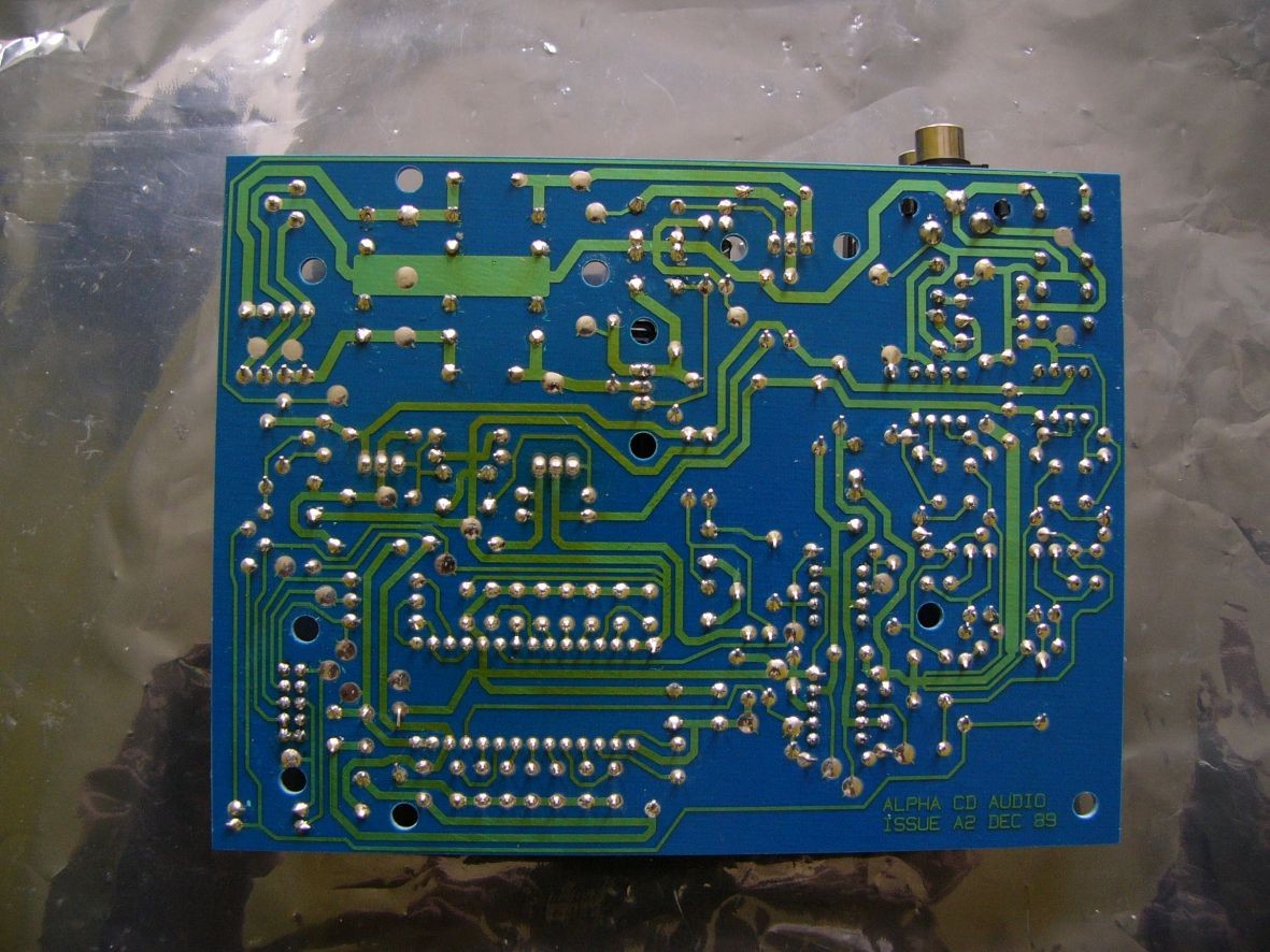

If you connect the std Alpha dark blue dac board to the plus model you'll find it does not work - I'll try and take some pics of the underside of the boards if you really want to see.
The TDA socket is a factory fit - the soldering is too good to have been a mod job.

Oh, and here are the undersides of both PCBs.

Interesting to see the plus. Definitely the end of model improvement just before launching the next model. I see they improved the quality of power cables to the DAC; they did away with the blue pcb - it really has weak traces; they optimized the main power supply filtering; and they really made some nice improvements to the layout of the underside with stronger ground traces and star grounding points. No wonder it got improved reviews.

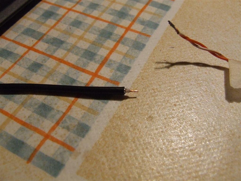

I ordered some small diameter coax to re-wire my clock lines as I think RF pollution may be causing my stoppages. I think twisted pair is ok for short lines but with all the wire trailing around my player it's asking for trouble to not use shielded coax. I can't remember if I said on here but I swapped my laser and whilst the player behaves differently there's still something thwarting its mission to play a track of music start to end.

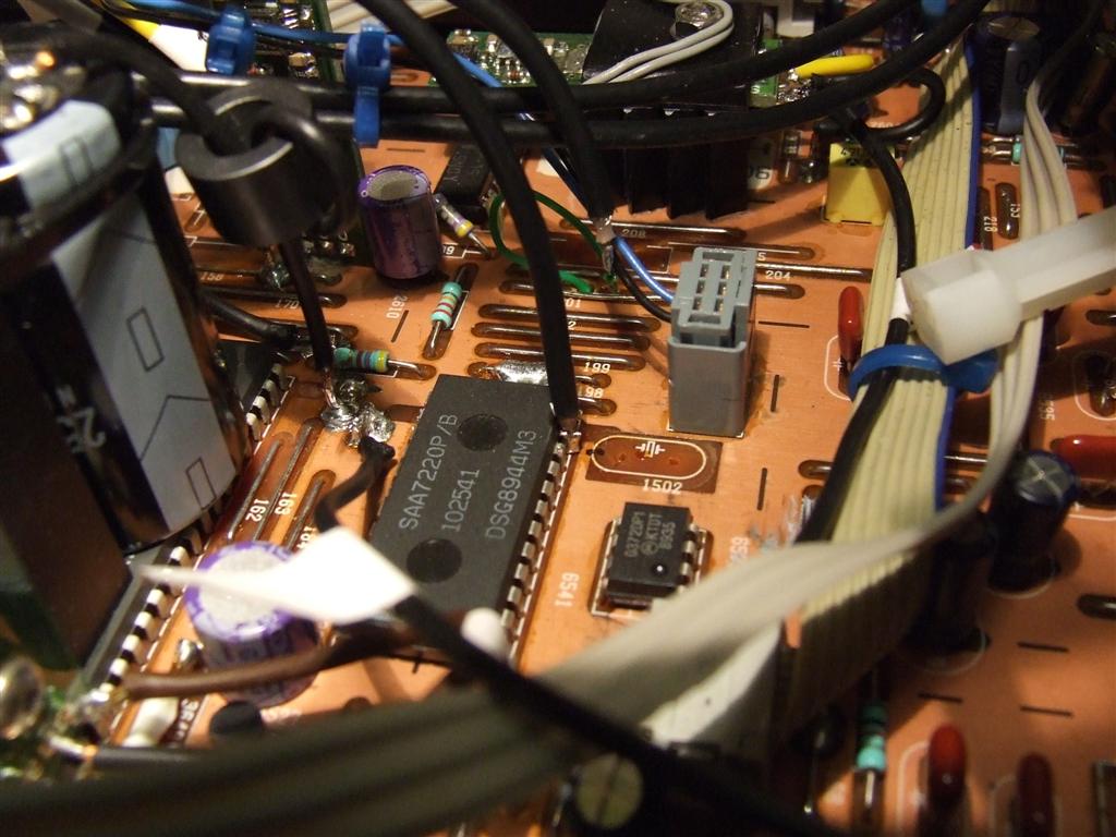

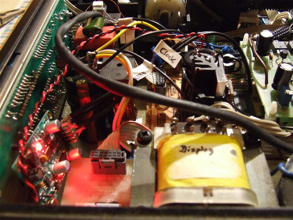

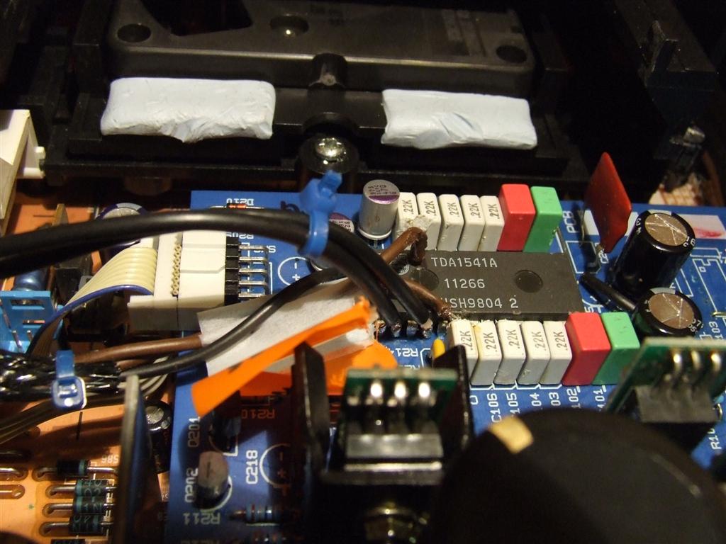

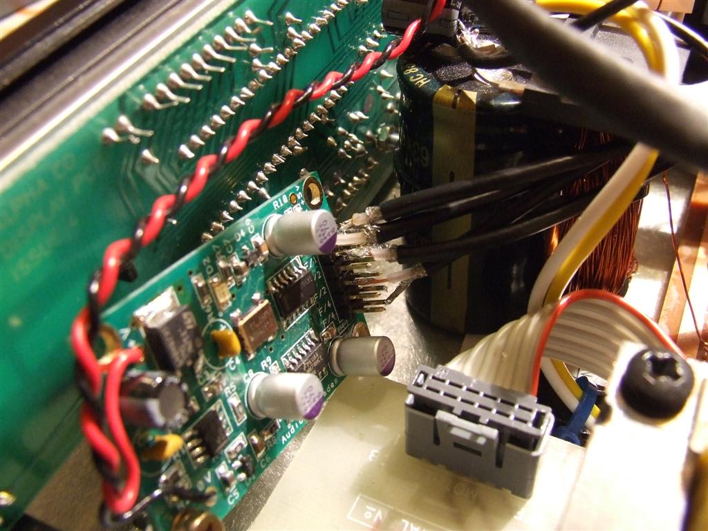

I finally put my mini coax in this evening, for all 4 re-clocked circuits: pins 2 & 4 on the DAC, decoder and digital filter. It was a bit of a pain to do being honest, but it is working. I don't yet know if it's fixed the cutting out problem but it's played the first CD almost all the way through and has yet to stutter or cut out once.
Obligatory pics attached.
