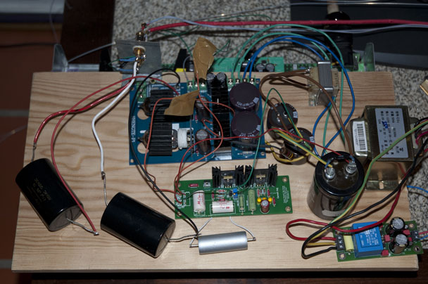

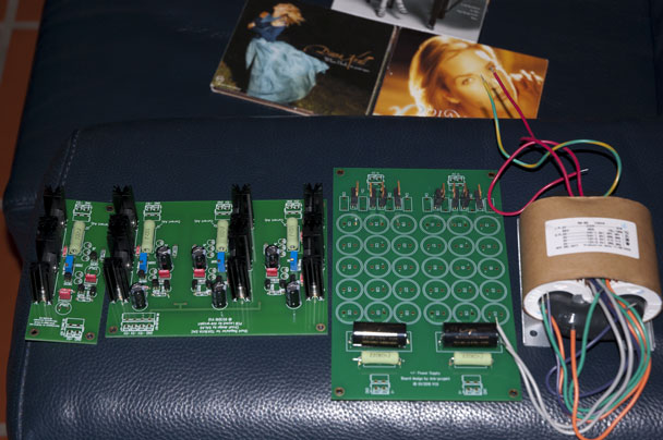

SRPP 6N2P-EV tube stage for I/V output (the best!)
Here some pics about my I/V srpp tube output stage.
It is not look nice but it sounds amazing!

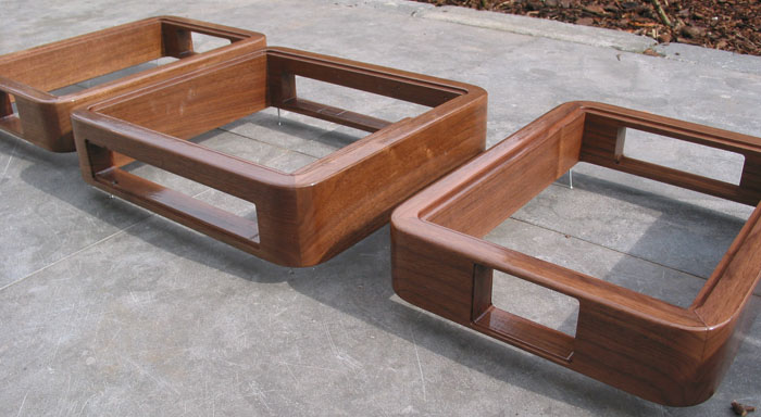

Make two wood boxes like these ones for Arcam Alpha:

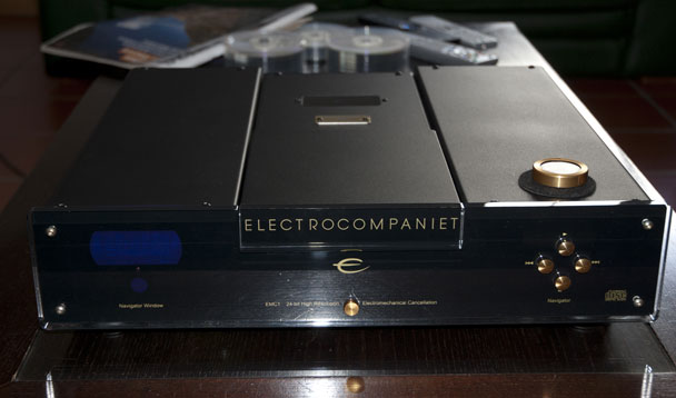

Sell my reference (until today, because the Arcam sound much more additive!) Electrocompaniet EMC1-UP player;
Read this: Electrocompaniet
