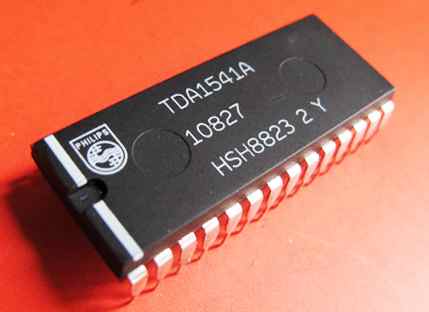

One more thing......Anyone tempted by the guy selling Single Crown TDA chips for £ 62.00 ?
I've been speaking to him and he tells me they are all pulled from boards ( they look like it too when observing the pins ) and are all tested to be open circuit on all pins.
The printing looks right too....I think
I'm no expert as you know but I've looked at literally hundreds this last few days just observing the different variations in font, ink type, positioning and colour density plus the explanations ( some on this site ) of where and how they were marked up and the reasons behind it.
Some of the fakes are laughable but some are actually quite good too - which is worrying.
I'm sorely tempted to have a shot at one of these as I have no problem getting my money back in these moments of madness.
The guys feedback is good - there's no mention of fakes, his Dual Crown sales have all had positive feedback comments left for him and he offers full refunds irrespective of the reasons.
His Dual Crown variants have been going for over £ 200 so they are off menu.

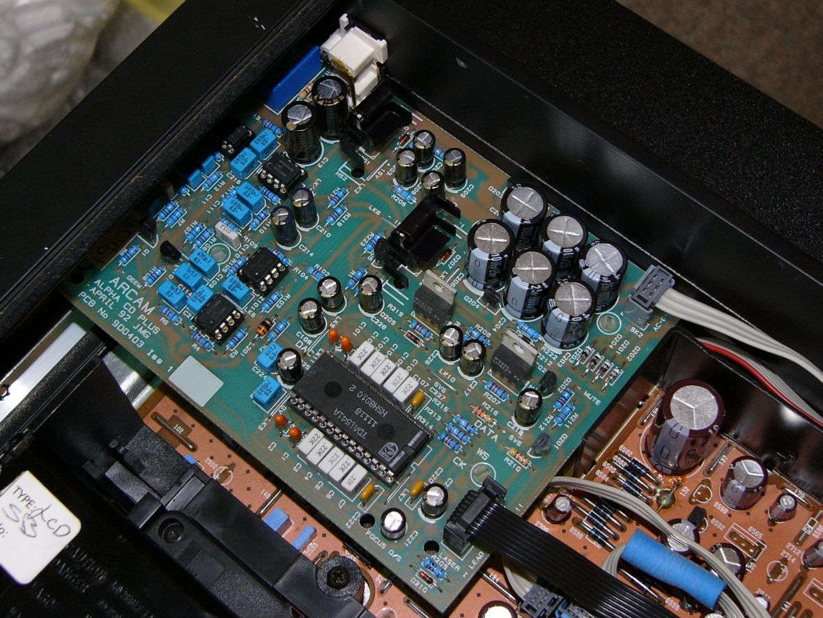

Bought a PLUS model a month or so ago and have just started changing things on the DAC board.
My previous effort whilst sounding lovely is a bit of a mess in so many ways.
Repaired tracks that I'd burnt the sh.. out of, wires all over the place without much thought and parts shoved in from the spares bucket with a ' that'll do mentality '
I now have my external power supply ready and it's so tidy inside that I thought I'd have one last go and apply the same tidy mind approach. Maybe spend a little extra on the right parts this time and see what happens.
So far so good, nice little gains - as to be expected with just DAC tweaks.
It's so ' shut in ' though next to my nice one and I'm enjoying hearing the effects of my previous work - the original really is completely night and day better at the moment - and so it should.
It all started to get interesting a couple of days ago whilst doing the new dac and decided to put in another standard old dac board so I had music.
Pressed play and the disc was just spinning fast.
On closer inspection the layout of a 92 Plus dac board is totally different in layout - the 10 pin signal plug for example is wired in a completely different way. There are additional components like BC547's and even an extra cap adjacent to one of the LM337's - I have two other standard machines from 89 so I can easily compare.
So, the Alpha Plus is not just a ' Plus ' due to a pair of Black Gates on the output - I found this quite strange tbh - why have Arcam done this I wonder.
The main board has fewer caps on it too but I suspect that'll be cost cutting.
I'll be filling the empty slots on this board when I get to it.

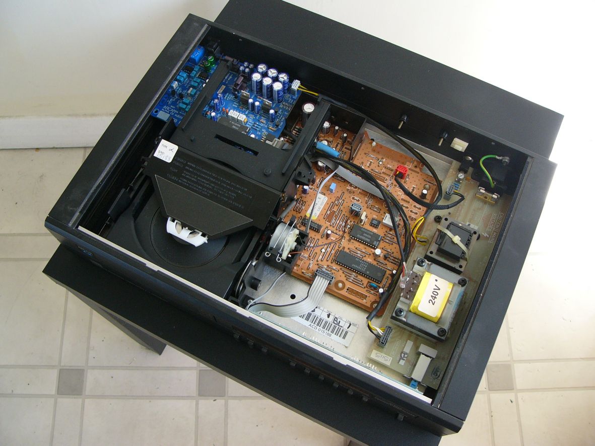

Back to the Plus :
I noticed the two transformers are a long way apart on the separate board - eliminates the buzzing if they are touching and maybe interference reduction ?
God knows.
The DAC board is a light green colour and is transparent held up to the light - no use in that then.
Finally the TDA is on it's own 28 pin socket so it can be removed....chip swapping anyone ?
Maybe they were going to fit S1 grade TDA's like the Delta 70-2 or give owners the option to do this later.
C227 cap is also a massive green one ( technical ! ) - or analogue ground cap
It was better than the standard Alpha in stock form apparently and was sold as the upgrade model but right now it sounds awful compared to what I've got right now.
That'll change !!
Still, it's quite fascinating and I've noticed the prices on E Bay are up to and sometimes over £100 - wonder whose buying these things - they'll be lurking here somewhere !

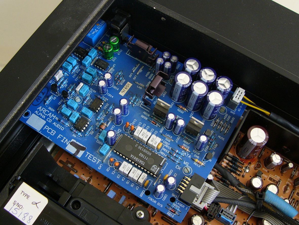

Yes, the layout between the two is completely different in the way that most things are in different places, but they are still laid out broadly the same, and the BoM only differs by a couple of capacitors. To me it's more of a revision than a new design. I'm not sure whether the 10 pin IDC headers on mine are wired differently, I'll check that. The service manual I have suggests they should be the same, both; 1) BCLK, 2) DEEM, 3) WCLK, 4) NC, 5) DATA, 6) MUTE, 7) GND, 8) NC, 9) GND or NC, 10) GND, except pin 9 which is only grounded on the +. Both of mine have the same number of BC547s, four of each, two for deemphasis, two to drive the muting relay. There are a pair of FST239 / FST240 as pre regulators on the +.
I'm pretty sure I put the socket in my plus, when I bought it the TDA1541A was soldered directly to the board.
