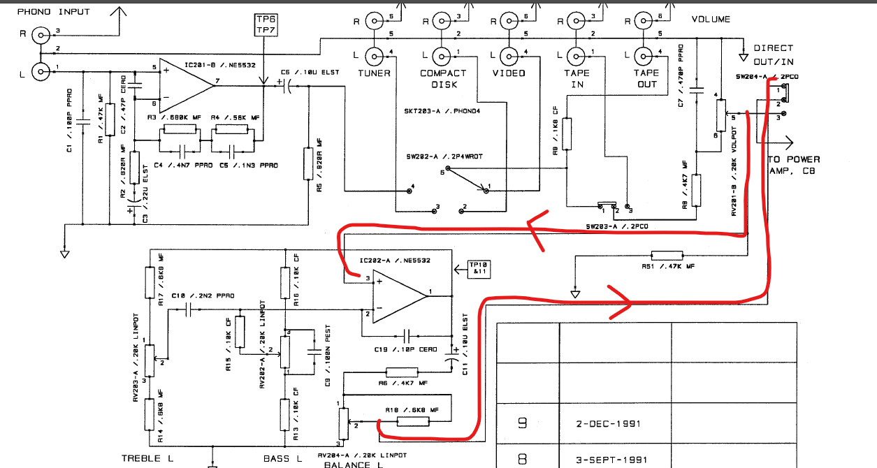

To save a new thread... I have one of these that works perfectly.... but only in 'direct', disengage this and all there is is some static noise, any pointers? an opamp? thanks
There is an opamp in circuit but it wouldn't be the first suspect tbh. It should be easy to find with a scope though. The audio goes from the volume pot wiper to the opamp no matter what mode is selected so you should be able to trace the audio into the tone stage.
The switch just selects either the opamp output (tone control) or straight from the volume pot. Check the supplies on the opamp and trace the signal to the opamp. Maybe the switch itself is duff.
