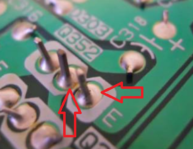

On that second image look really really closely at the middle leg of the transistor. Can you see the dark ring running around the leg where the solder is cracked. Stand back from the screen and it become clearer.
OK I just about see it i think. Really is very subtle stuff though that's why it's a little hard to grasp I think.
I will try to scrutinise as best I can but certainly can't guarantee that I will be able to pick up on all defects as clearly it relies on a lot of practice and experience. Needless to say I will persevere though because I am a dyed in the wool problem solver at heart 🙂
