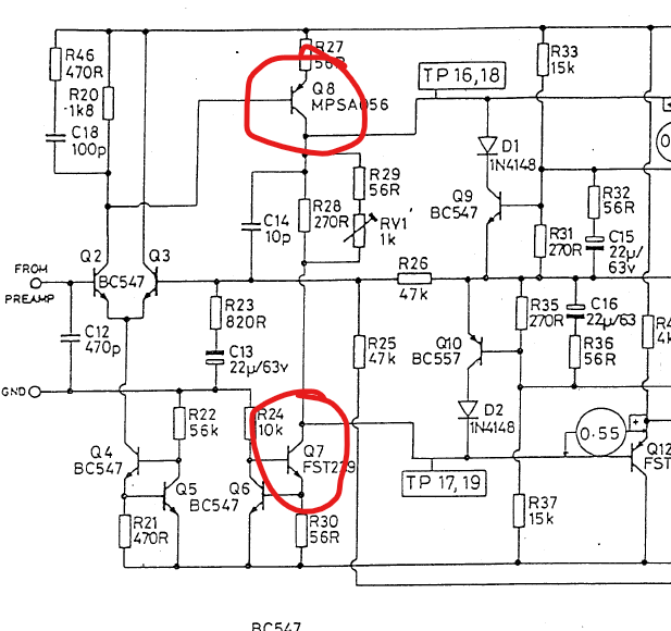

It might be easier and safer (we don't want any slips of the probe) to measure on D3 and D4 instead... look at the circuit and you will see they are the same points.
Next measure the voltage on the speaker fuse. That should be close to zero but won't be with your fault.
Switch the amp OFF and check those two 0.22 ohm resistors. You can test those in circuit but remember they are so low in value that your meter lead resistance will add to the result. You should see 0.4 ohm or lower for each.
Next we put the black lead of the meter on the speaker fuse (you can connect it to the positive speaker socket if the fuse is intact) and then we take four readings with the power on.
1/ To the base of the TIP3055. You should see approx +0.6 volts.
2/ To the base of the driver Q11. You should read approx +1.2 volts.
3/ To the base of the TIP2955. You should read approx -0.6V
4/ To the base of the driver Q12. You should read approx -1.2V

The Q12 reading seems to show a problem in that it implies that with -0.5V on the TIP2955 base and -1.55V on the driver base there is going to be just over 1V directly across the base/emitter junction of the driver.
That is to high and suggests that Q12 could be faulty.
It would be good to recheck that result and be certain and also to confirm it by doing a direct voltage measurement across B and E of that driver. Be extremely careful not to short any pins.
All the other voltages look OK.
What is surprising is that there doesn't appear to be any DC offset (high voltage on the fuseholder (as measured from ground) and that the output transistors and low value emitter resistors (R41 and R42) seem OK.

Looking at the schematic is the main circuitry side of the fuse socket the left side? I've assumed it is and rechecked measurements accordingly with the negative probe connected to that side. This gives a reading of -1V on Q12 and +1V on Q11.
With regards connecting directly across the base/emitter junction of Q12 is that simply a case of one probe on the base and the other on the emitter?

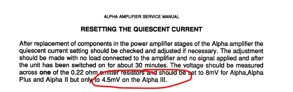

The important checks on any amp are that the speaker feed is at zero volts (and which you say it is) and also that the bias current is correct. That is calculated from the volt drop across the 0.22 ohm resistors and should be no higher than 4.5 millivolts on the Alpha III. So very low.
I would be wary tbh that all is well... although it worth testing it and checking it does perform OK at this point in time. If it does then I might suggest that the always hot running transistors are replaced as a matter of course (that is Q7 and Q8) although you should look very closely for dries on these as well.
These are the two that run hot and this is the quiescent current check procedure. Its normal for the current to be all over the place until the amp is thermally stable and up to temperature.
