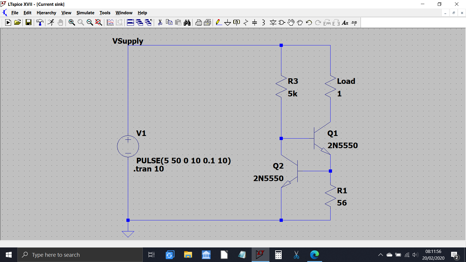

This is how the BD139 works in your amp.
The BD139 transistor is turned on (in this simulation) by R3.
As soon as the voltage across the 56 ohm reaches around 0.6 volts the second transistor turns on and begins to 'clamp' the BD139 base voltage which prevents the current rising further.

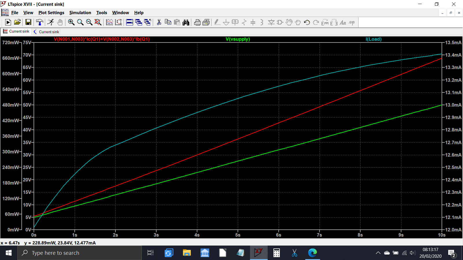

Look at the scales. The voltage goes from 5 to 50 volts. The current only changes by a milliamp or so over most of the voltage change.
The power dissipation is also shown and you can see it increases with increasing voltage dropped across the device.
