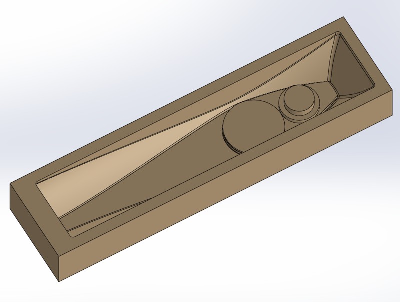

Hey folks,
I'm waiting on about 90kgs worth of lead that will be used to damp the interior walls of the Apollo cabinets but in the meantime I've been busy creating lots of tool paths for the 3 baffles used in the One.10, 20 and 30 models.
They'll be machined out of 100mm PU high density modelling block and serve as the master from which a silicone rubber mould will be made. Why go to all this effort? Well it will allow for some pretty wild experimentation with casting materials. I'm going to start off with a high density PU resin mixed with aluminium trihydroxide filler for extra mass, using this combination its possible to create a composite with a density similar to corian(around 1700kg/m^3) but without the huge price tag and hassle of laminating many 12mm sheets to build up the final thickness. I'll see how that performs but really anything is possible including concrete and epoxy with a wide range of fillers or reinforcement. Really excited about that part.
Extending this technique to the cabinet portions and not just the baffles would be something I'd like to do eventually too. It'd allow for some creative ways of tackling internal reflections. Probably the biggest advantage of casting the enclosure would come from it being formed from a single block of material with no joints. A nice side effect is you can go to town on the styling too.
Anyway that's a ways off and I'm going to focus on the baffles first. Here's the first half of the mould created from the master.

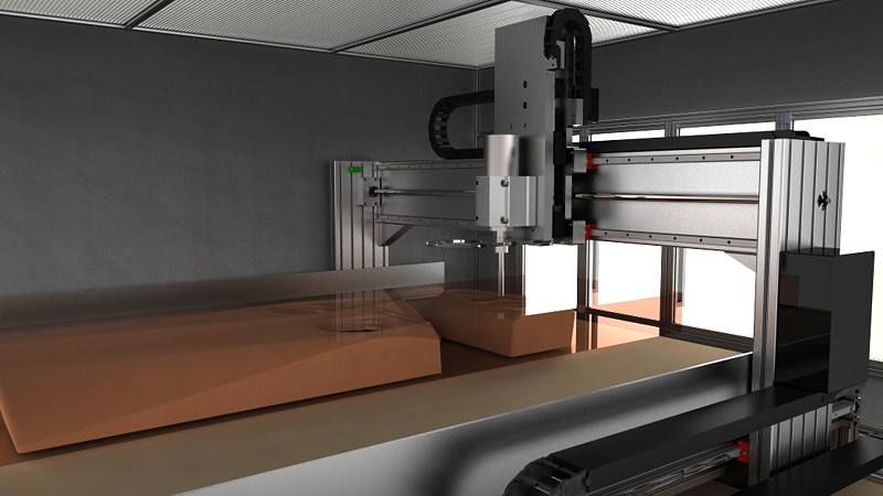

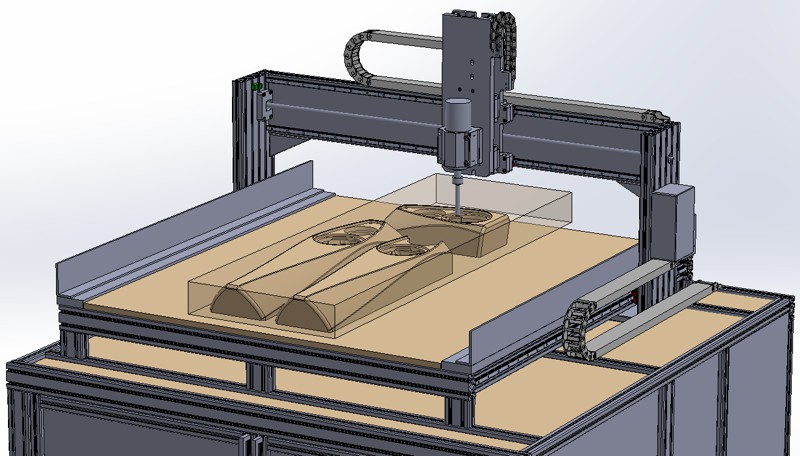

One very handy feature of an integrated CAD/CAM package is the ability to create a model of the CNC and this can be used to check for clearance and collisions with hold down parts such as clamps and screws. I wouldn't say its fool proof but the simulation does let you see problems before they happen for real.

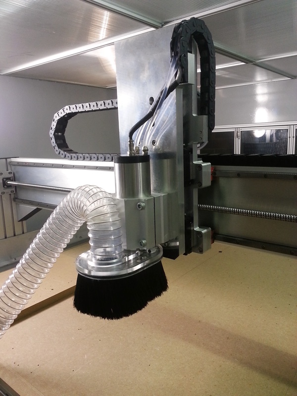

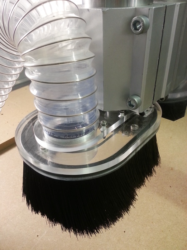

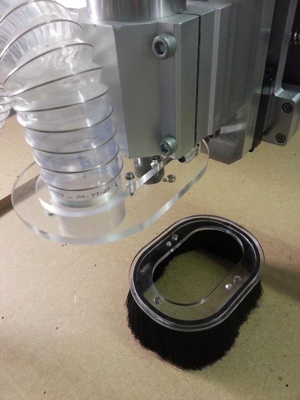

Had another go at making a dust shoe and after picking up some cast acrylic this attempt came out much better. A week or so ago I did try to cut the same parts out of extruded acrylic and that stuff melted no matter what I did. Lesson learned - go with cast if the finish quality matters.
Watch your static build-up with that Ant. When I first set up something like that I noticed it was arcing small sparks to the router body after a while!
Now I have a cable connected to the metal wire in the hose, which is then earthed.
Cheers. The spindle casing is earthed so I'll run a wire to that.
Good point about the ground wire. I've read a few articles about people using plastic for dust collection without grounding that lead to fires in the shop. Not something most people think about but it does happen.

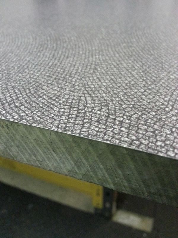

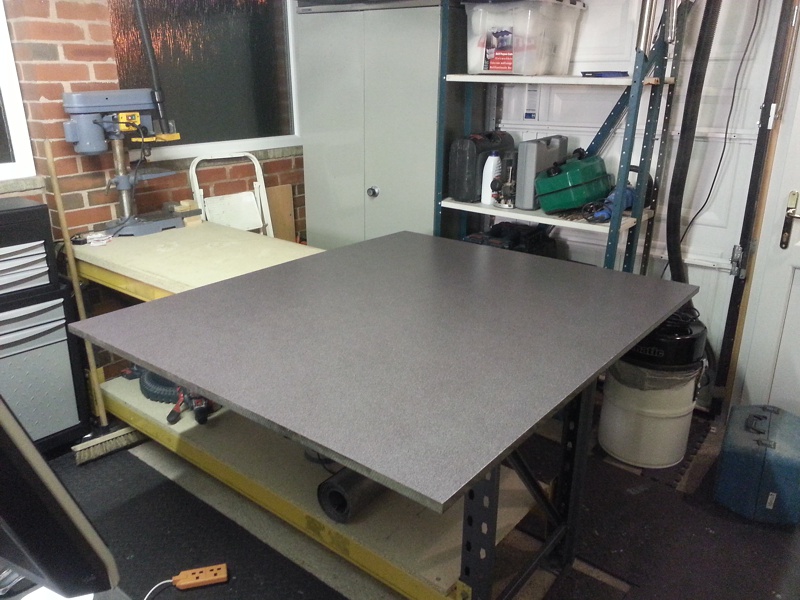

Not normally worth posting about replacing the bed but I picked up a sheet of Trespa Athlon from a friend and have to say this is makes a great bed. Plenty of mass(about twice as heavy as MDF on a like for like basis), well damped against vibration, dimensionally stable, tough and still easy to drill and set up fixtures. The construction is a fibre reinforced resin with a laminated finish. I've had a quick go with an offcut made when sizing the sheet to fit the bed and it machines really nicely.
Aside from making a good bed all this has got me thinking it'd be ideal for speaker construction. I got this sheet for nothing and I'm not sure on pricing but I'll find out.

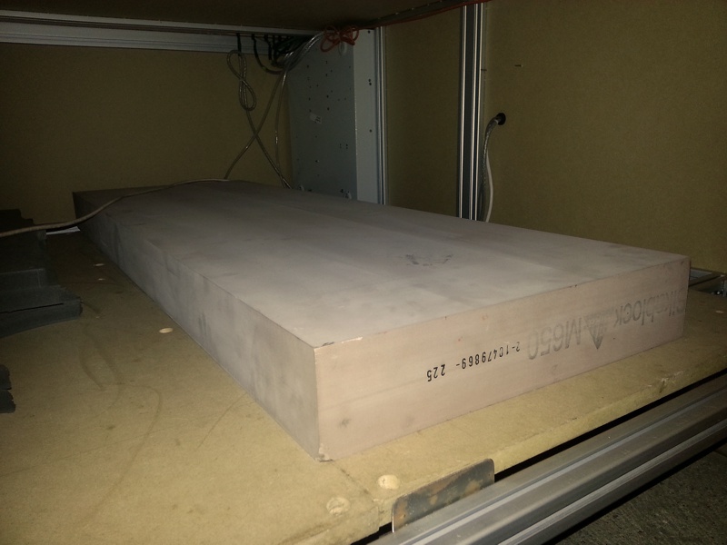

My modelling board arrived today. Weighs a ton! The masters for the baffles will be coming out of this soon.
If that modelling board is the same material I got hold of (offcuts from a CNC company near where I used to work) you'll love machining it. It cuts like butter, creates chips not dust, and you get incredibly sharp, clean edges that require little or no finishing. It will dent, so needs handling with a bit of care, but is great for prototypes and mold making.
