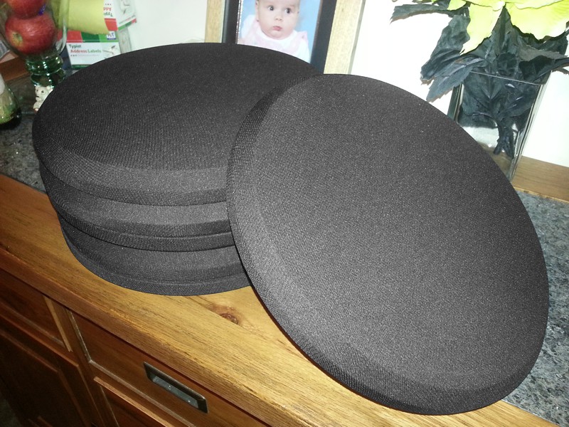

Is the baffle made out of corian?
Thanks and yes they're corian.

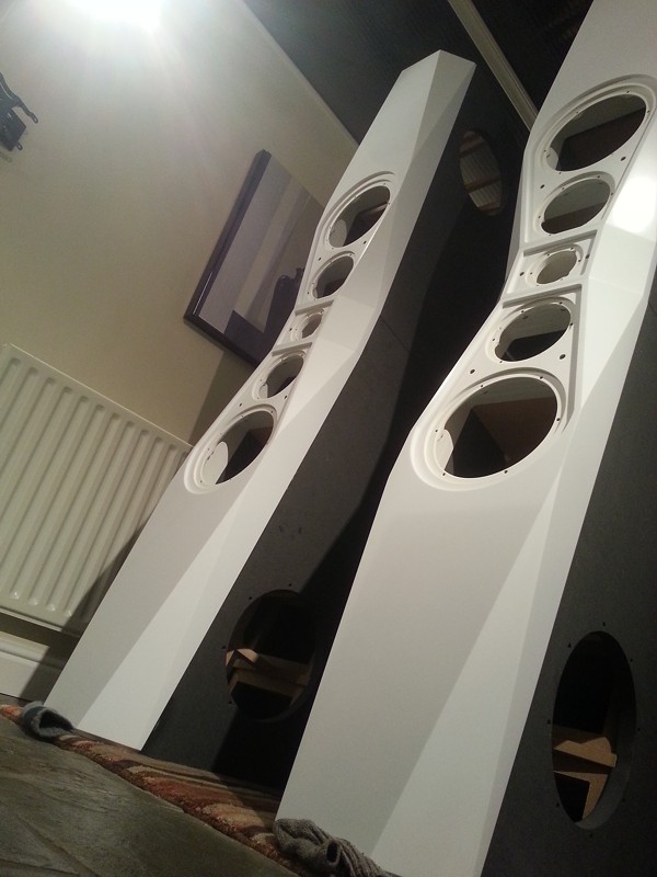

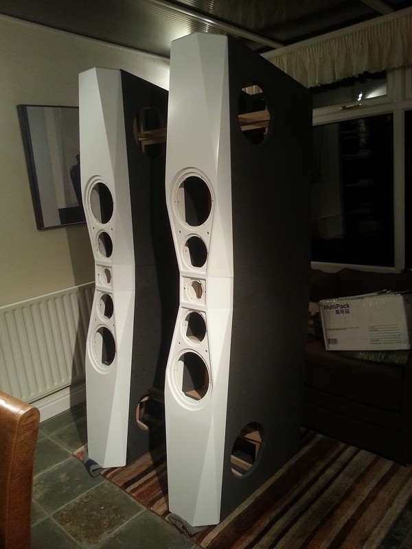

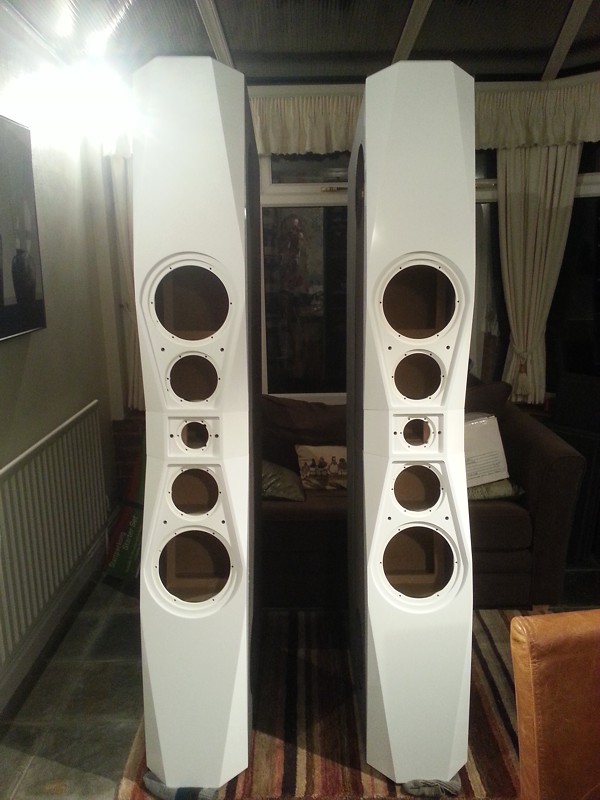

A few shots of the pair. Already started gluing but have decided not to use the CNC again until I've got some extraction and a dust shoe on there because the ultra fine particles created when cutting the valcromat are finding their way into all the bearings of the machine. Spent a day flushing out all the rubbish with fresh grease and cleaning every inch - not much fun!
CNC all clean and one of the cabinets clamped up whilst waiting for the glue to dry.

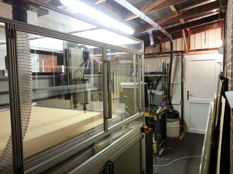

Its not pulling the dust as well as I'd like but I realised this when installing it. I did have a more grand extraction system planned but as the cnc started to show more and more problems my dust extraction budget disappeared! So this was put together on a shoe string. I did opt for a vacuum extractor with triple filtration since these filter down to 0.5micron at virtually 100% efficiency so none of the fine stuff is coming back out in to the workshop. Despite its lack of power for the CNC it has a couple of saving graces, one its extremely quiet and two it works very well for power tools.
And yes the enclosure is sealed where possible. I took all the lexan panels out and lined the edges with closed cell foam to help with that. Even without a dust shoe virtually nothing escapes when cutting and the are doors closed.
Would love the space to be able to put an enclosure around mine!
I'm using just the motor+impellor unit from this (it's the bit right at the bottom): Fox F50-843 Dust Extractor (3hp): Amazon.co.uk: DIY & Tools
It all comes apart very easily, and the unit pulls a huge amount of air. It's more of a low hum than the wail of a vac, so no too offensive in noise terms. Great for dust extraction; though I'm using the equivalent of 6" ducting to keep the losses low.

I see you've mentioned about dust on the bearings. Are they pillow blocks on linear rails? If so, they should have wipers inside so should be OK.
The rails are fine. They have wipers as you say but the ball screws don't and dust sticks to the screw and then enters the ball nut. Its only a problem on the X for me as the others are concealed.
