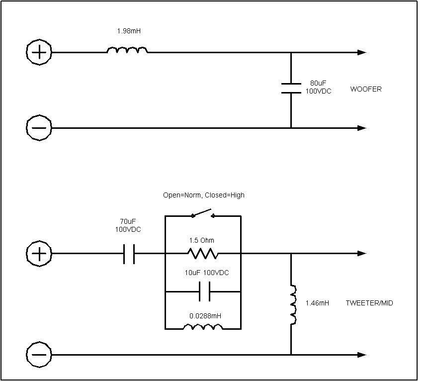

Here's one pic I took, it appears to be stock crossover and looks like original parts when compared to pics I found on the internet. I will swap the binding posts back to originals at some point.

I like the sound of the old stock loose hand wound coils an cap......The North Ceek is a New Crossover.....Not just new parts

Can give some insite on the Crossover.... an is this called A trap...
that the switch bypasses? .....
So that the M-T only sees the 70mf.....an what dose a trap do?.....
too me sounds like it roll the M-T down to blind...but the bass can get a littel out of wak-heavy....with the trap in.....noml..

Just put your own crossover togather...new coils an caps wire......but keep the all stock board!
