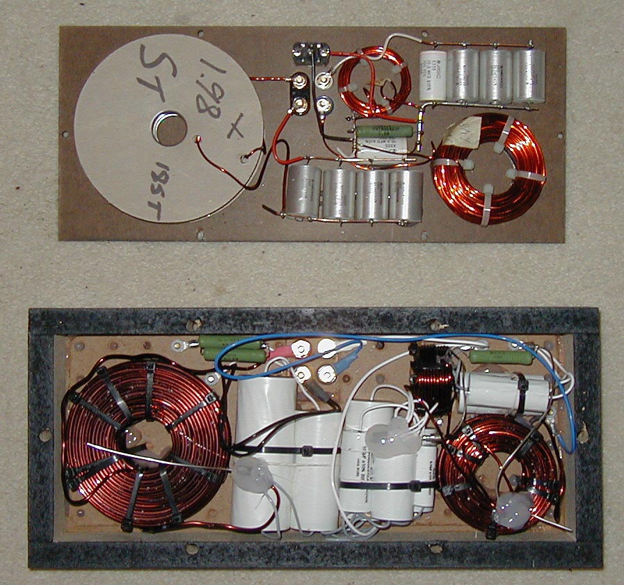

Centaurs..... crossover go here for the pic......wont lode here...for me
http://www.integracoustics.com/MUG/MUG/tweaks/apogee/centaur_xo.jpg
Only fried 26" mid-tweeter i have saw...... were on two diff pr of......Centaurs...

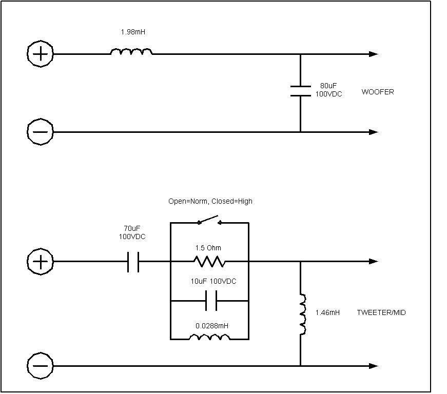

Wonder WHY.......thay move the sall coil.......2.8mh....it the frist thing the mid-tweeter sees............. look like it would not get safty this way.....
Look on the stage ...the smaller coil.....0.0288mh.....is in the trap after the 70mf cap caps??...........can anyone say why?
I have been think i would put the stage cross setup in the Centaur...There is NO mid-tweeter Move Ment in the Minors........an some mods i have put on the stages has got more output an less movement........less movement give better sound...........Long Live Apogees.....

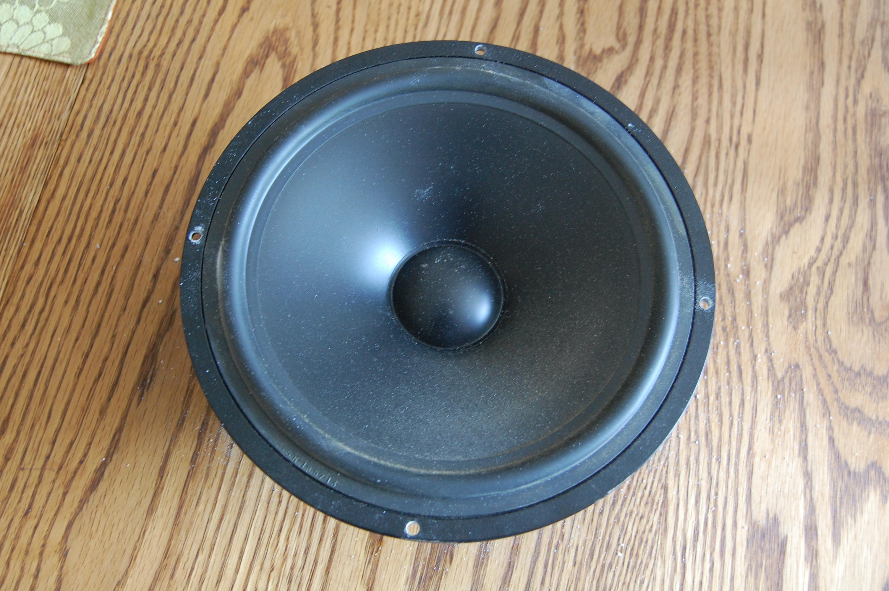

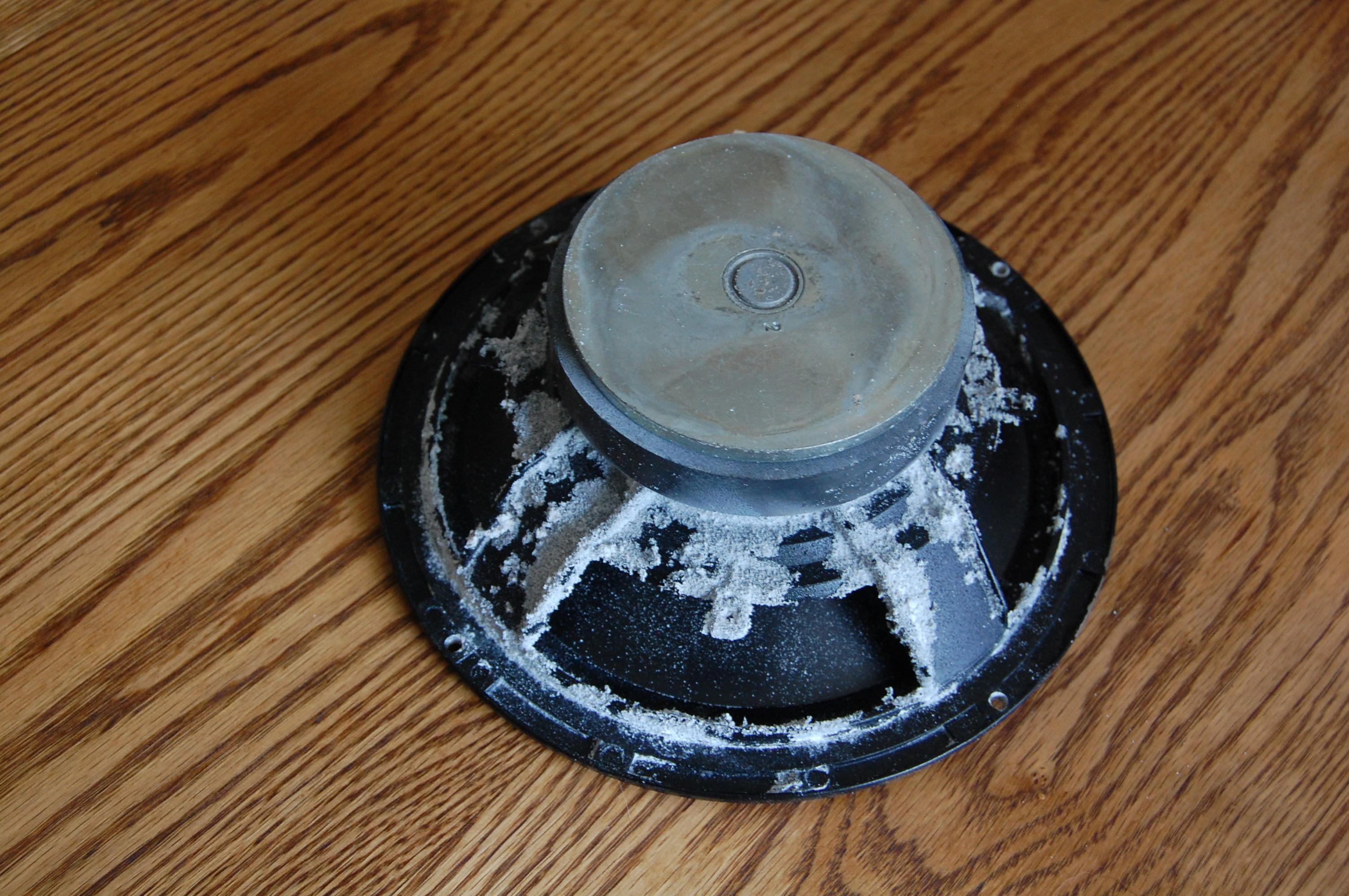

I just pulled the Vifa woofer from my Centaur. First time the grille has been removed!
Plenty of white powdery corrosion on the spiders, but the terminal strip is covered in corrosion. Some powder has fallen to the back of the voice coil.

Here are a couple of pics of one of the original Vifa woofers. The other one isn't quite as badly corroded.
I bought the speakers new in Atlanta in 1991 and this is the first time that the grilles have been removed.
Considering this is a (very well) sealed enclosure, I am very surprised to find this level of corrosion on the frames. I believe they are cast magnesium. I live in a sub-tropical climate, have several pairs of speakers, some in ported cabinets, some just naked in storage and none of them exhibit any corrosion at all. The others are either cast aluminum or steel frames, but some dating back to 1960s.
The only time that the Centaurs were close to a salt environment is when they were built in MA. Maybe a little packet of silica gel might have been appropriate at installation.
Sonically, the Vifas seem OK, but in the meantime, while I try to clean them, I have installed 6.5" Peerless Nomex woofers with the aid of MDF adapters that I fabricated to mount them in the existing 8" speaker hole, suitably gasketed. I must say they sound pretty darn good, crossed and equalized at 800Hz with the minidsp. They fall a little short in the bass department, but not by much. I get a fair amount of room gain at about 40Hz, but I think I may put a subwoofer or two into the system and see how it does.
Anyone have any theories about this amount of corrosion?

Wow..........i have seen this before....i was in the Audio bizz....1980s90s....are the two woffer the same?.........mostur got into the the poly fill......an was trapet in the box........Maybe...knowone well ever know for sure....

The other woofer is not quite as bad. Good point about the trapped moisture at assembly.
The damage is done now, but I think I will take out all stuffing of the cabinets and let it stay in the air conditioned room for a while before I reassemble. After more listening with the smaller woofers, I think that the originals are better, and there is a lot to be said about leaving the passive crossovers in. Back to square one- again.

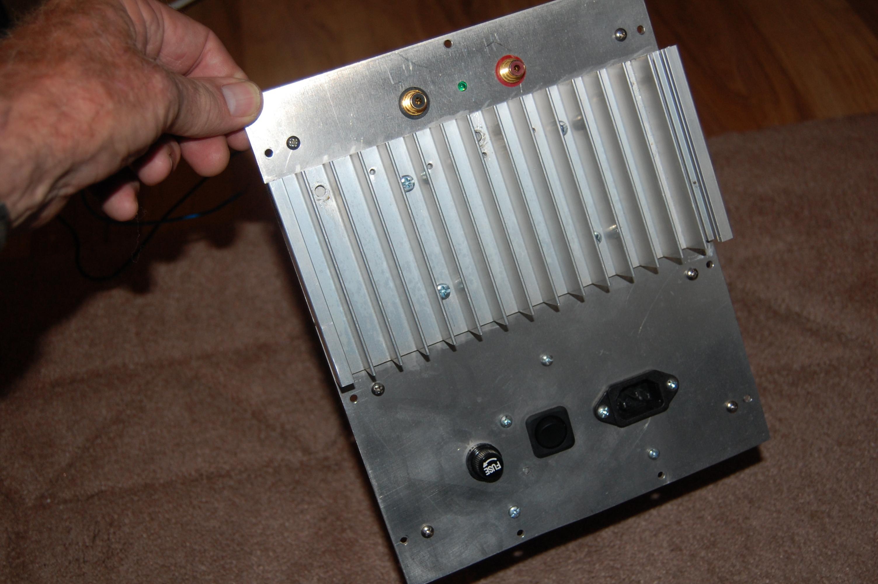

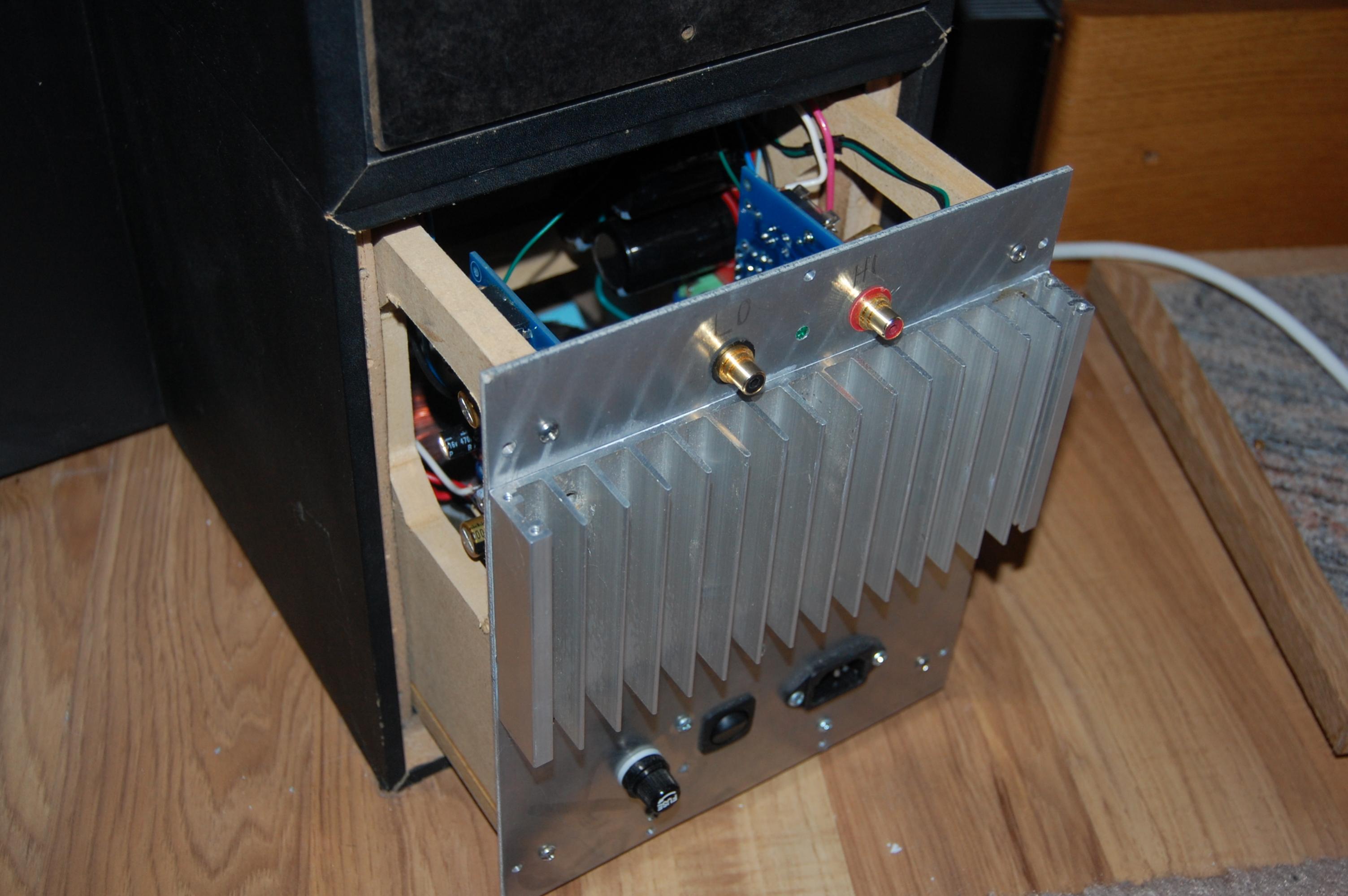

Symasym amps
Here are a couple of pics of one of the Symasym amps I built into the Centaur stands. I initially biamped them but, though "different" than with the passive crossovers, not sure I would say "better".
I've put the passives back in now and have cleaned the Vifa drivers. Presently playing through my F5 clone. Very smooth, but they do lack dynamics in the lower octaves. Still my reference for silky coherence though. I was amazed at how much stuffing is in the enclosures.
