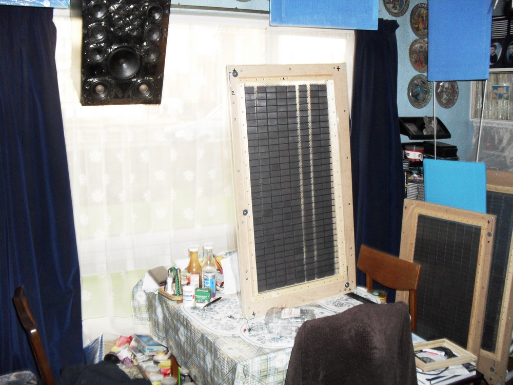

I have built over 60 easy diaphragms which are a doddle in comparison to the apogees. Mine do not require complicated crossovers etc. I have even built 2 full range planar headphones. Which sound wonderful.

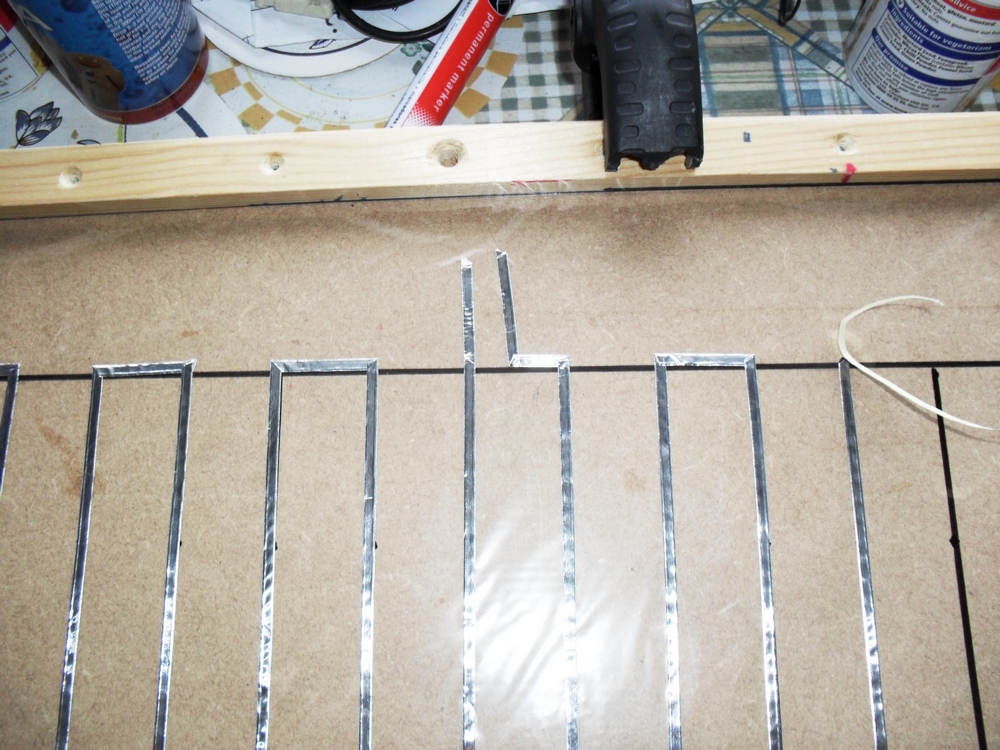

It would be quite easy to fit a different diaphragm to the Apogee family, using mylar and alu foil. You wouldn't need all the tools and the silicon etc. They would be a lot cheaper than the ones you have to buy, about £5 each. If I had one of the apogees stripped, It would be simple to get it up and running and very cheap.But I don't have any broken Apogees. It would be an interesting exercise, as I am running out of interesting jobs, apart from the headphone rebuilds. I also have to rebuild a pair of small 16" x 12" FRP which are noisy, I know what the problem is, now I have heard the consequences, and felt it.You live and learn, which I have over the years, which is part of life when you don't have any qualifications or difficult maths.
If someone could mark all the magnets, holes, diaphragm cutout etc. On some Mylar or whatever (minimum 6 um, although I would prefer 12 um), putting 4 + signs on it corresponding to 4 + signs on the Apogee frame, to set the relative positions of all the markings in black permanent ink. When complete it could be sent to me. I could then stick the alu foil in the correct position. Then return it to you. You could then fit it to the frame, not using any glue as such, so it can be removed as necessary.If anybody thinks this is viable or a good idea, give it a go or not!! It's up to you. Certainly a lot cheaper than buying the diaphragms from sellers of such. Bass panels, although others could work as well ,hopefully! The impedance or resistance of the diaphragm should be stated as well.

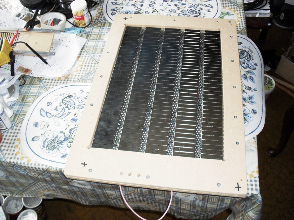

There are no + signs on the Apogee, this is something I use when I build my diaphragms (over 60). This helps to align my diaphragms, when I fix them in position. I only build full range diaphragms, and do not corrugate any of them!. You could use the alignment marks if convenient, my + marks align vertically and horizontally. Which is more helpful when the diaphragm is very wide and long. It makes it easier for me, equivalent to the alignment marks on Apogees and others.
Henry, Whats the centre distance of the magnet rows on the full range? How does the flat panel sound compare to the corrugated panel? Is there much bass loss and resonance issues? What you using> mylar or kapton? are you tensioning the ribbon using the original system or using a fixed method? Is your DS depth still as original? picking your brain here cause I'm sick of my failure rates. Al

I'm afraid you have got the wrong end of the stick. I have no APOGEES whatsoever, I was referring to my own full range planar builds, which I have built over 60 over the last 20 or more years. I was referring to someone making a mylar copy of an APOGEE layout, and sending it to me so I can make one of my diaphragms to fit the relevant diaphragm cutout. Using my method of diaphragm build. I have had no problems with the flat panels using mylar and alu tape. When I tension the diaphragm I use my fingers to pull the mylar into position and get rid of the creases etc. Using a wood frame and screws. The APOGEES already have a frame round the cutout. You could use this with my diaphragm. The copy if you send one must be accurate and includes all the relevant positions marked out in permanent pen.

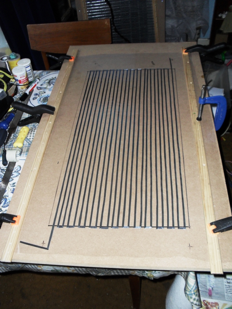

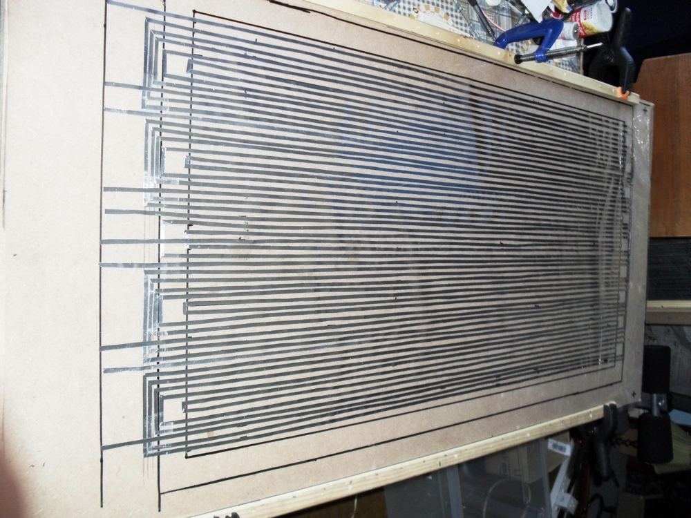

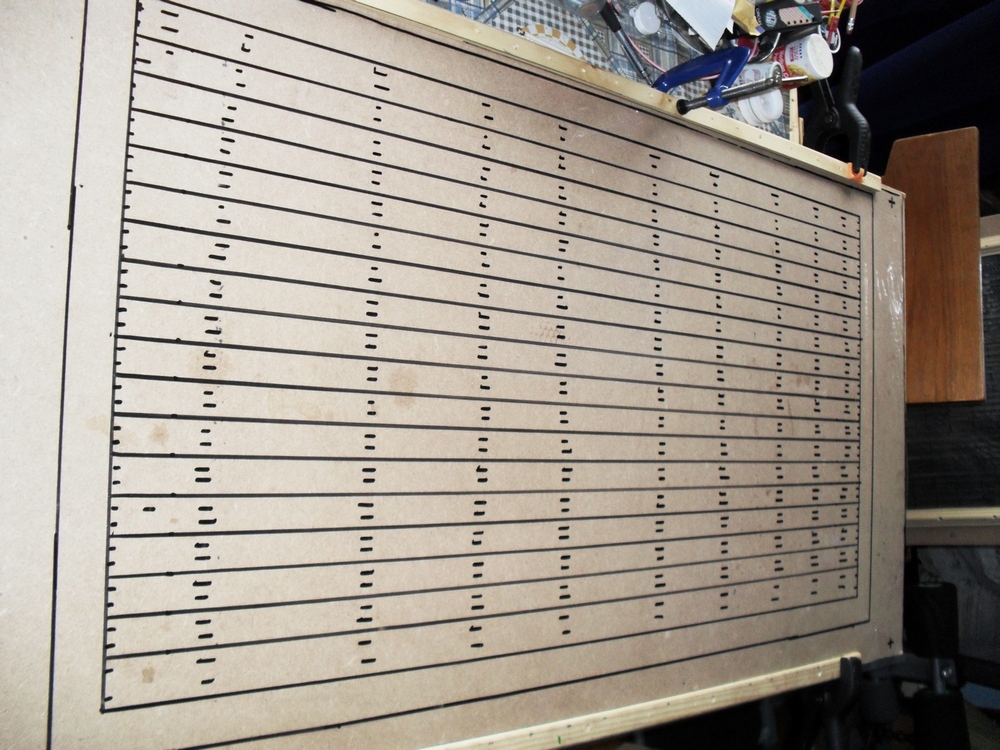

diaphragm markings before putting tape on using + markings

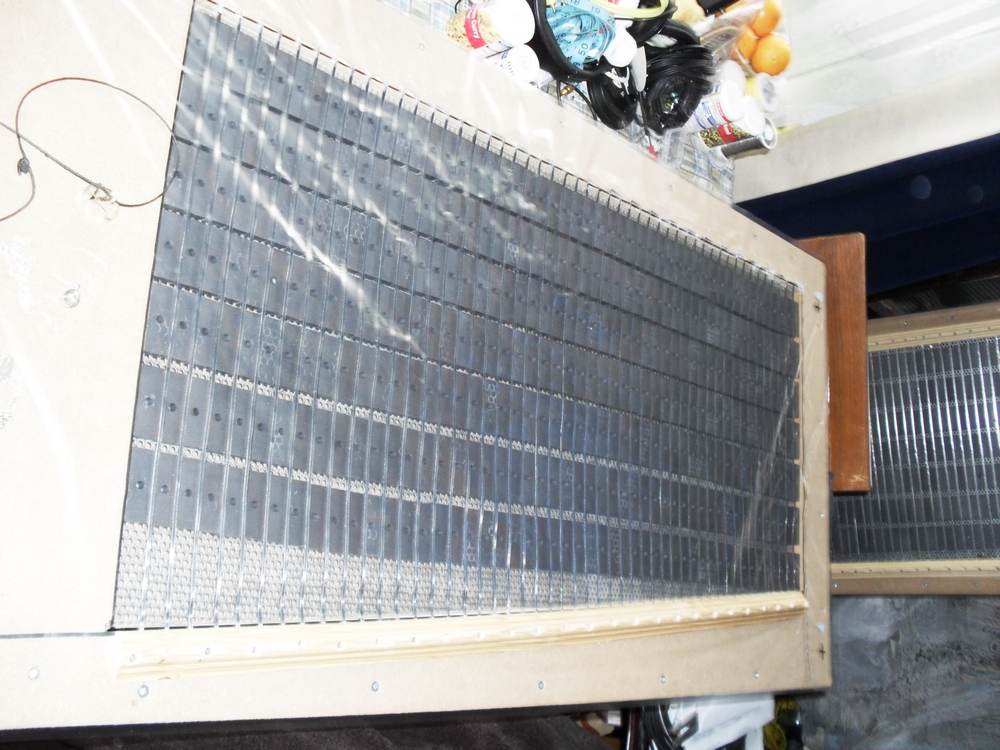

some more pics of layouts etc. Giving an idea of what I mean about marking the diaphragms so I can put the alu tape in the right position, accuracy is all important and you can see the +'s I use on some of the diaphragms.

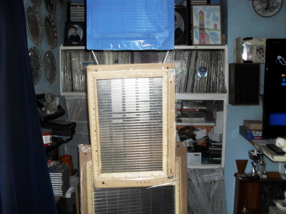

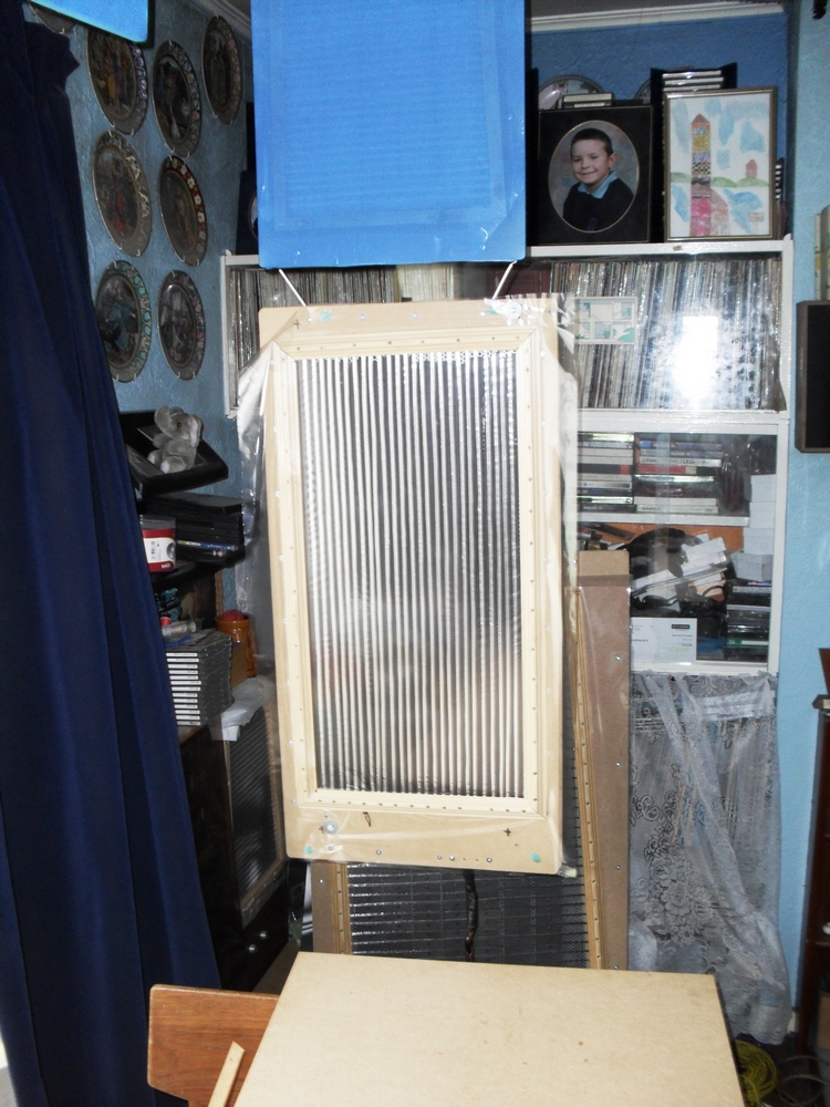

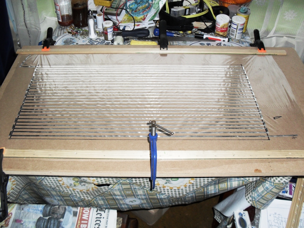

some more pics.
Some more pics of my own designs of full range planars. I hope these pics help to explain my offer.

Art, by failure I mean the time wasted on cutting the foil circuit and having it tear and start all over again, exacto knives and round cutters are not the answer, that's why I want to machine a template, be perfect everytime, the other thing now is getting hold of kapton, Dupont won't set up for a small amount.I'm out of kapton myself, got 3 panels out of a 100' roll, should have done 15 miniumn, thats why I looking at mylar now. Al
...I mean the time wasted on cutting the foil circuit and having it tear and start all over again, exacto knives and round cutters are not the answer...
Have you considered etching the unwanted aluminum away after it's bonded to Kapton? I did a quick search for lithographic techniques that started to lead me in the right direction. With some additional research there ought to be an answer out there somewhere. It also appears that Kapton films are available with an aluminum coating, either laminated or vapor deposited. I didn't check on available widths and thicknesses yet though. Just another avenue to consider. I'd go with Kapton because it is dimensionally stable and far more heat resistant than Mylar.
Brian, I gave that an attempt with acid in a pen plotter, but the trace width varied to much and gave up, a waste of more kapton 🙂 . Let us know what you find out in your research, I wonder if 1 mil kapton would be to thick. I think the Scintilla used 1/2 mil if I remember correctly. Al
