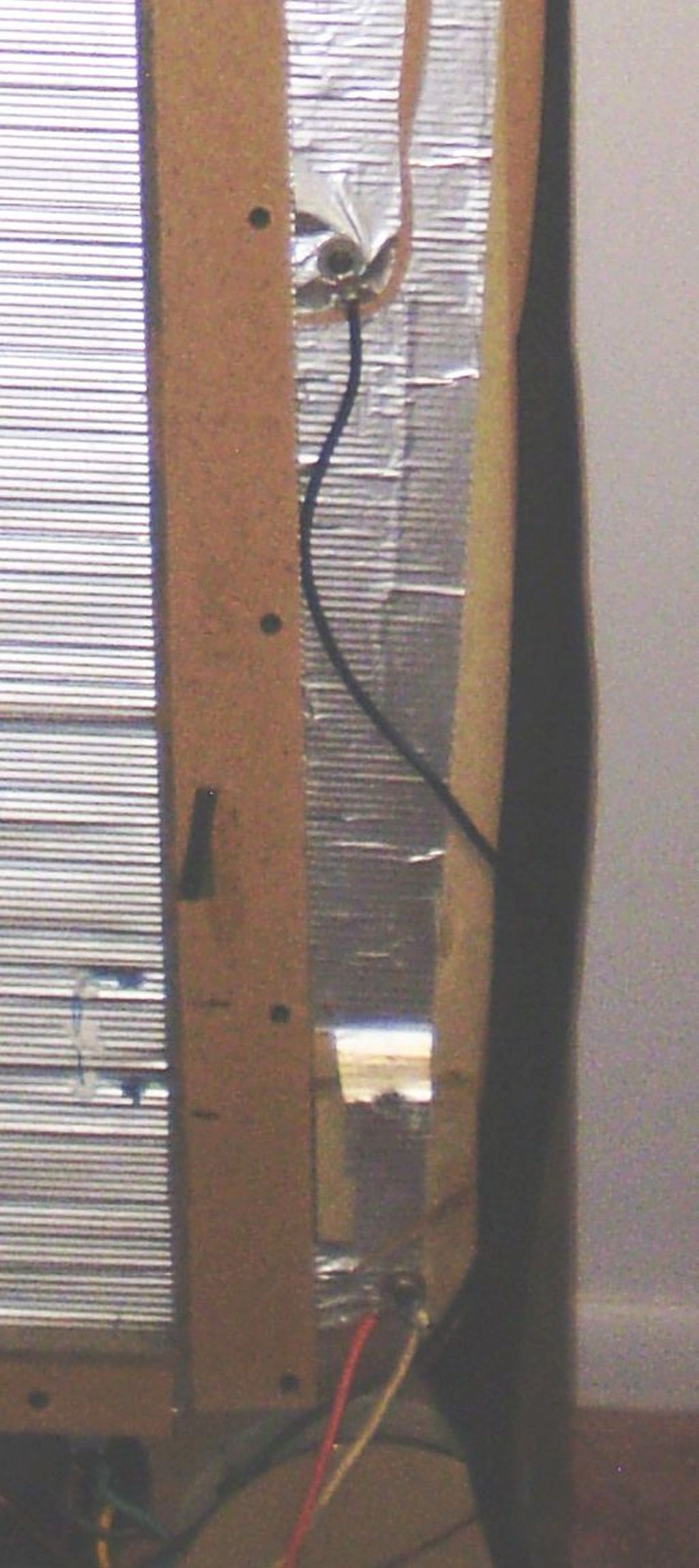

I don't have any breaks where the foil moves, just under the frame board. I seems odd that there's no schematic for the foil after all these years.

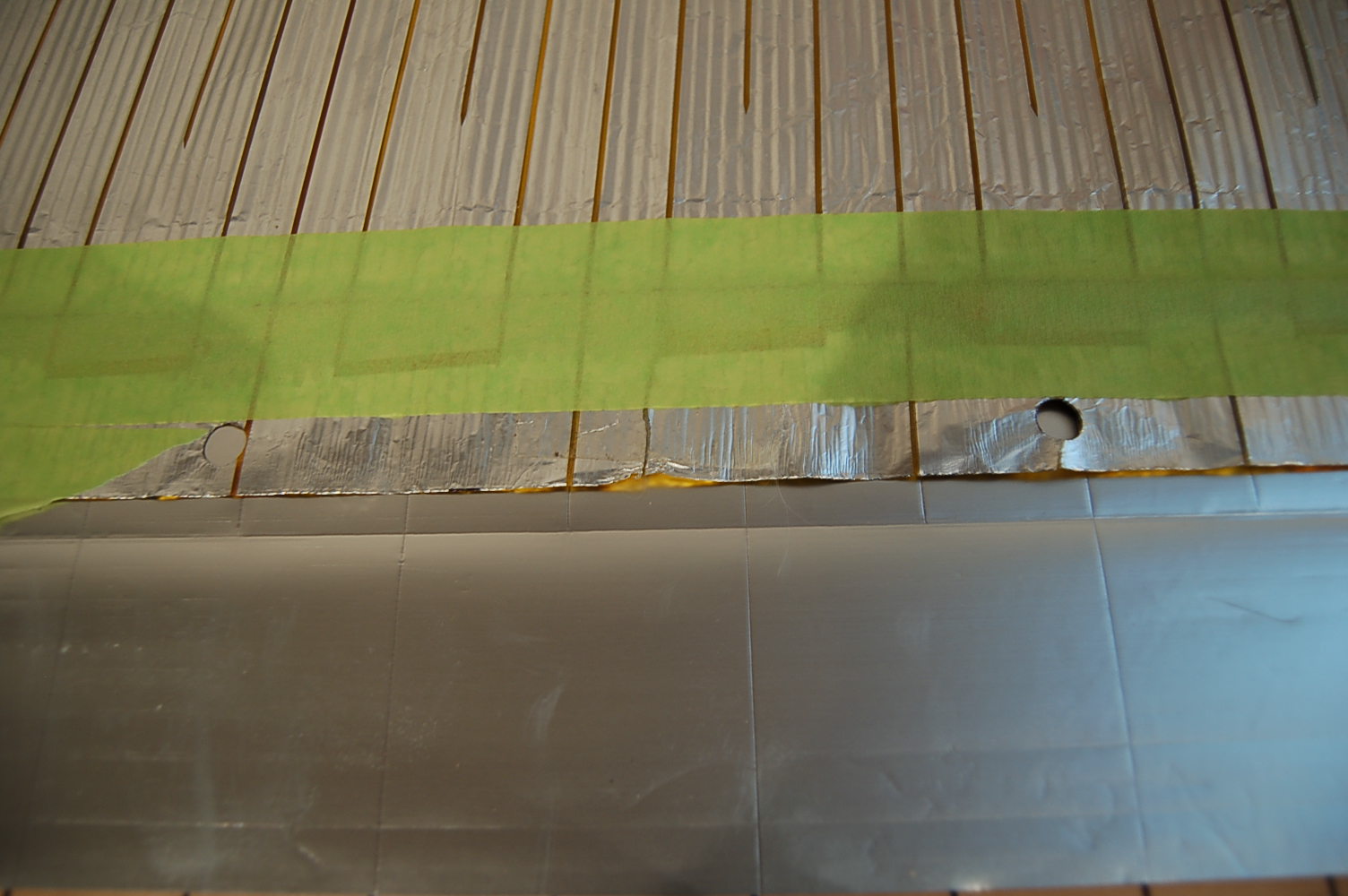

I assume you're not talking about the crossover "schematics", but rather the cut pattern in the woofer membrane?
There is little information/photographs of this scheme since it requires removing the side clamps to visualize the circuitous route the signal takes. There used to be some photographs on the Apogee site, but those seem to have been taken down or "lost." 🙂
Your speakers appear to have damage on the bottom trace (one of your photo's is very blurry) and the previous owner has bypassed the break with a copper shorting piece that disabled a small portion of the woofer. (A fairly effective, simple field repair it seems.)

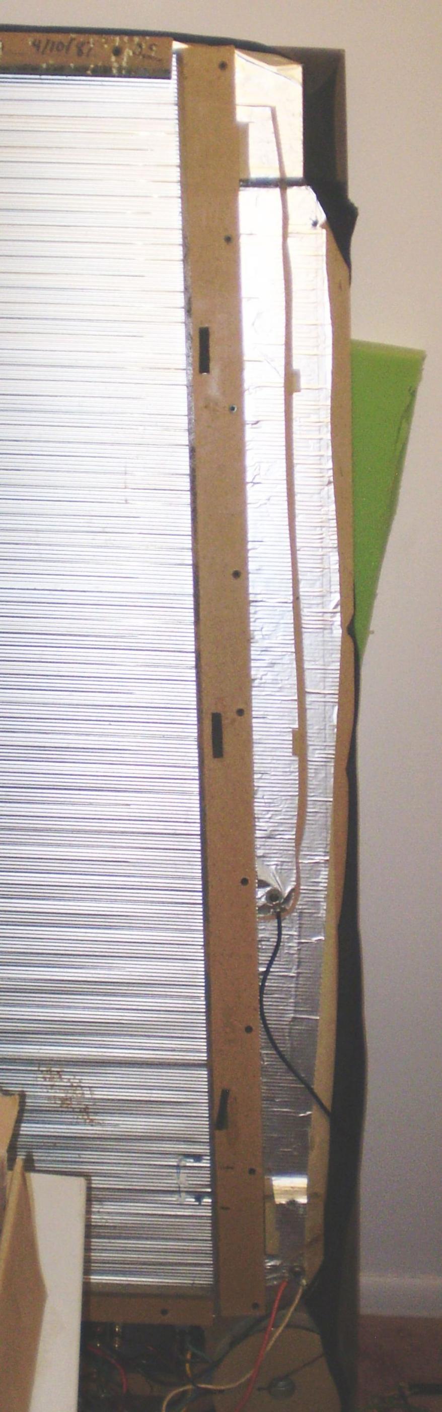

Your speakers also show what appears to be a loss of tension in one area of the membrane. (The "diagonal" creases in the membrane.)
unfortunately, it appears your speakers are not usable at this time, but if you really have the DIY spirit then have some fun and see if you can re-tension the membrane without doing damage. The appropriate frequencies for each area of the membrane are in the speaker test procedure document.

The copper shorting strips in one of your photos is completely bypassing one of two voice coils on the bass panel.
If you take them off you may find that a section is open and is probably why they are there.
The LaFoiia Project V.C. is exactly the same.
On my panel, the narrow width foils on the top and bottom going in to the diaphragm is one V.C. and the other two wide ones is the other V.C..
They are in series by the wide outside strip that runs continuously from top to bottom.
The black wire is ground and is connecting to the bottom tab on the top.
The orange and white positive wires are the same connecting to the bottom tab on the bottom.

With the jumper installed he's measuring 3.1 ohms DC. That's right in the nominal range for the Caliper woofer. That would indicate the majority of the woofer transducer is active and clearly not bypassing (completely) one of the voice coils. If they're in series and he jumpered one of them out he should measure approximately 1.5 ohms, no?
Some further detective work to be done here I guess.

P.S. I didn't see the picture of the bottom set of jumpers until now.
If they were Duette's than they would appear to be in parallel.
And by judging that if the pattern is the same then they very well may be in parallel as well.
Again I only have experience with the Duette's.

Oh hell, here is what I would do... if your up for it, do the following. Be very careful, as you should have no issues selling them as is... and look through the posting I had showing all the pics.
The sides, top and bottom wooden clamps... my guess is that they are all loose, but only the top and bottom clamps should only be slightly loose (the top and bottom clamps are supposed to be snug, but not tight, while the sides should be relatively tight. - got this info from Graz). If your side clamps are not loose, do not proceed...
With the top and bottom clamps removed (DO NOT ATTEMPT TO TAKE OFF THE SIDE CLAMPS - THE DIAPHRAGM MAY BE GLUED TO THE SIDE CLAMPS), you will see the top ribbon/kapton diaphragm on both sides as they go underneath the side clamps.
What I see happening in the side wooden clams are way too loose (you can check - are they loose / do they wiggle? They should not). Apparently the clamps are loose, and diaphragm is sagging. From my previous link (german) you will see pics of what screws are used to tighten the clamps,and which screws are to tension the moveable clamp. At this point, don't screw with the tension screws. See if you can pull taught the diaphram under loose clamps, and then tighten the clamps to hold them in.
Pull up on the diaphram near the side clamps.the wrinkles should flatten. You can further loosen the side clamp screws, but be gentle on pulling up...Do the same on the other side. Be careful, you do not want to make more tears in the diaphragm. Once wrinkles are flattened, tighten the side clamps. Make sure they are relatively tight, so the diaphram cannot droop. Now put on the top and bottom clamp. These are to be slightly loose, and according to Graz, keeps the diaphragm from "bagging" on the bottom. It is the side clamps that hold the diaphragm in place.

I have those very same sags but only at the bottom 12" of both of my the panels.
I will be moving my recording equipment out next week to a new location for a recording job and this will give me the room to lay one down and take a closer look at it.
jer 🙂
jer 🙂
Looking at the above photo with jumper, looks like the break may be on other side of that trace,perhaps under foam area or clamp area itself
That is correct, my Canadian friend. I have removed the original jumper and transferred it to the opposite side, which is where the break occurred, under the the right clamp, as you suspected. I must have a few more of these, as a few bands are still getting no current.
