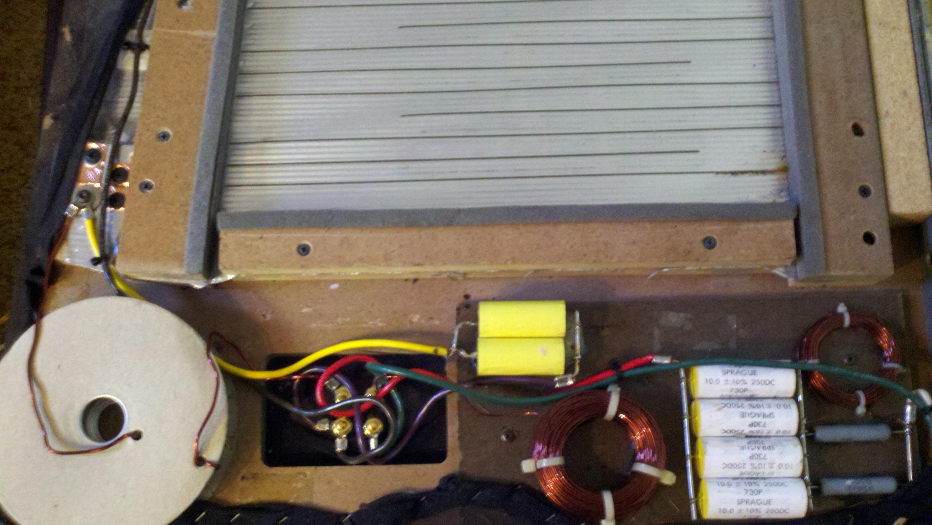

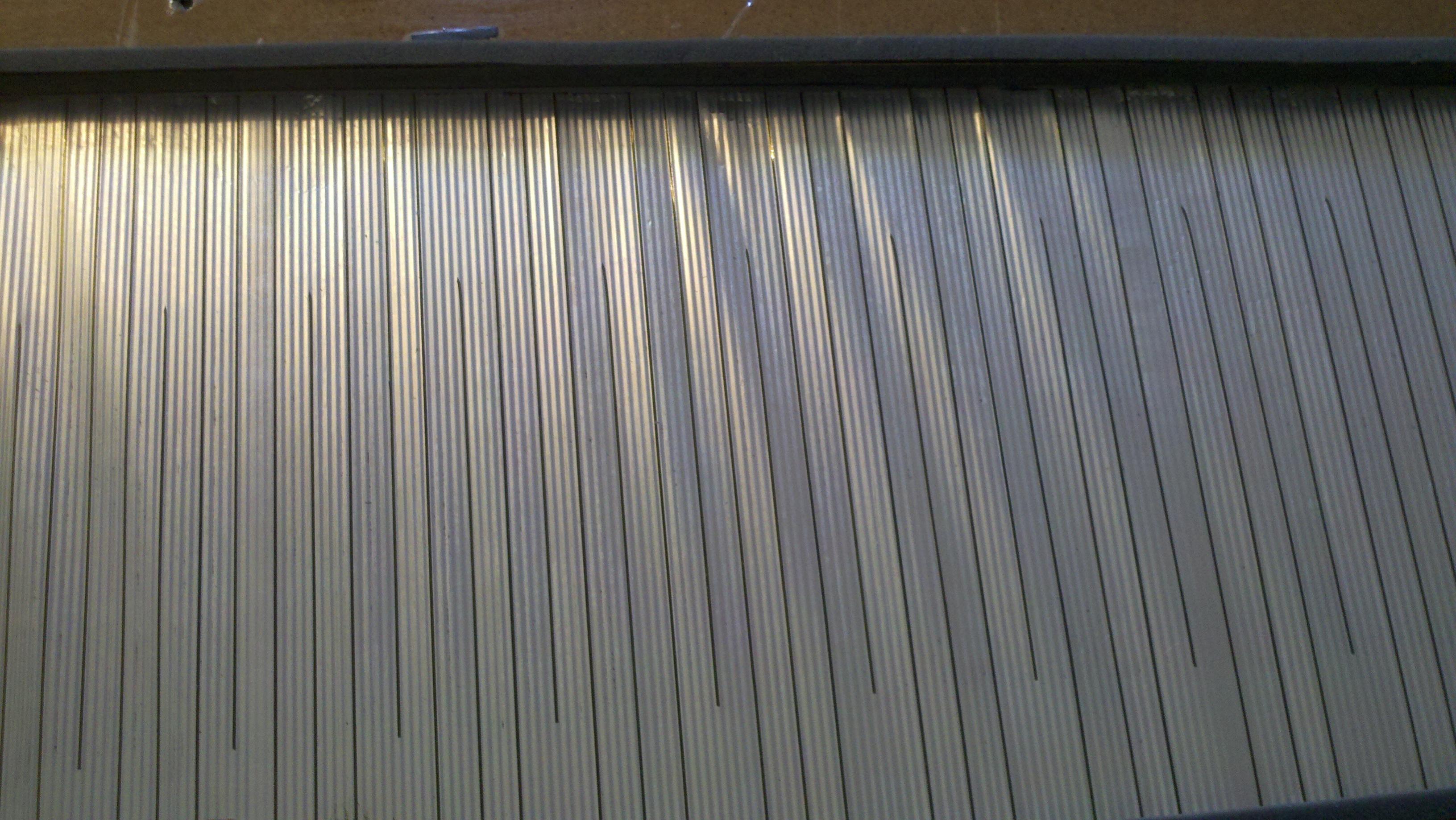

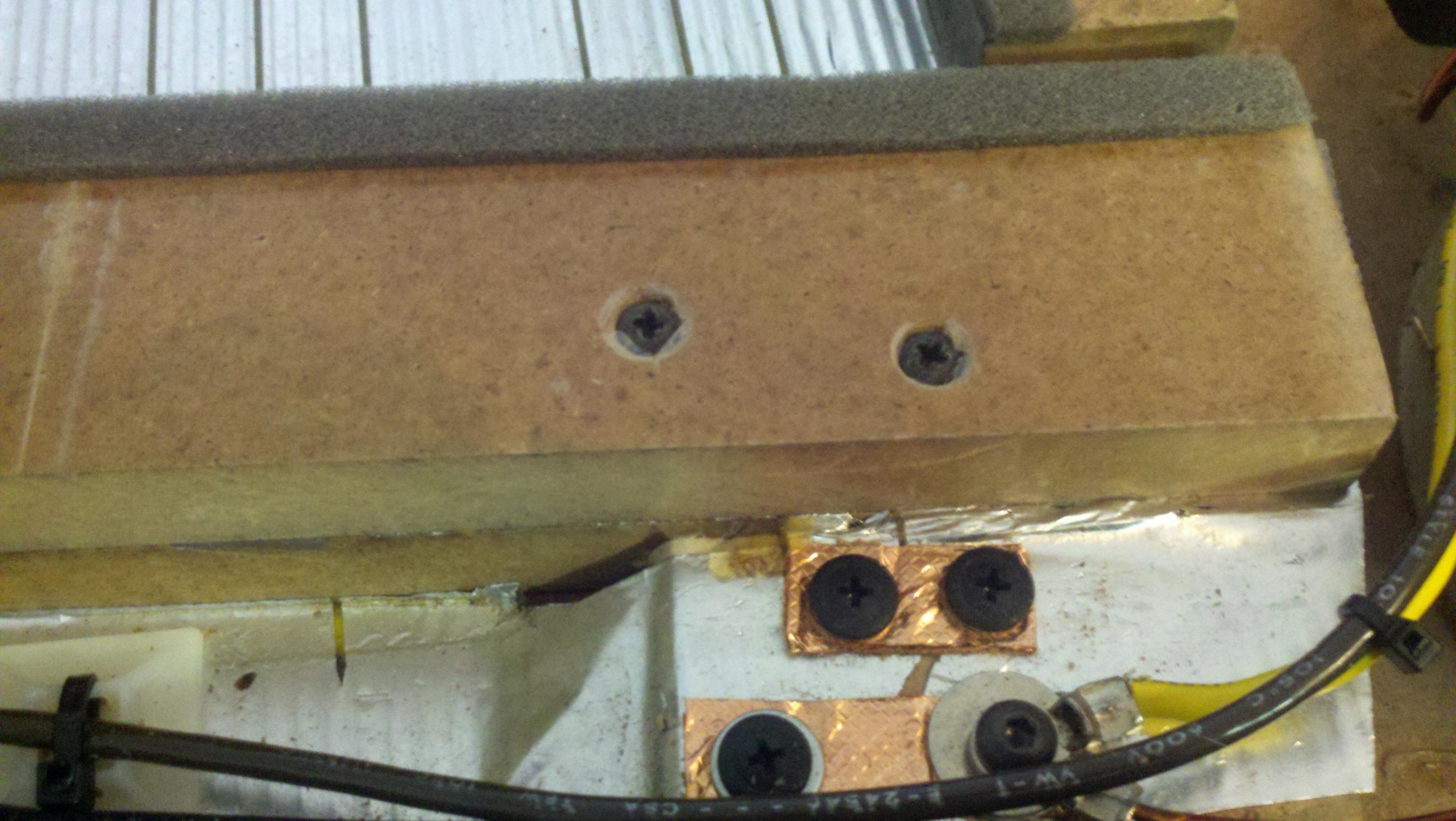

Here is what my bad Caliper bass panel looks like. It works but makes horrible noises. It seems retensioning to the original spec should solve my problems. Also, if someone could post a link to a service manual or at least a schematic of the foil layout on the Caliper, unless they're all the same and then a generic foil layout would be nice.
As to the who, I have no idea, I just took the covers off a few minutes ago. I'm guessing it was a repair done by a previous owner. Are those two bottom strips supposed to connected?
No, they are not.
The circuit is supposed to make a double run with the aluminum.
Or else You will have half the resistance of the woofer and will make the filter cross over wrongly.
Check the resistance of the woofer panel. I think it should be around 3.1 - 3.4 ohms. If is is incorrectly jumpered, it will read less.
I disconnected the jumper and resistance went to open so I re-jumpered the bottom stipe to the second from the bottom strip on the straight side and now bass panel resistance is 3.1 ohms. Some parts of the panel seem much more active than others. Is it or is it not possible to re-tension this driver?

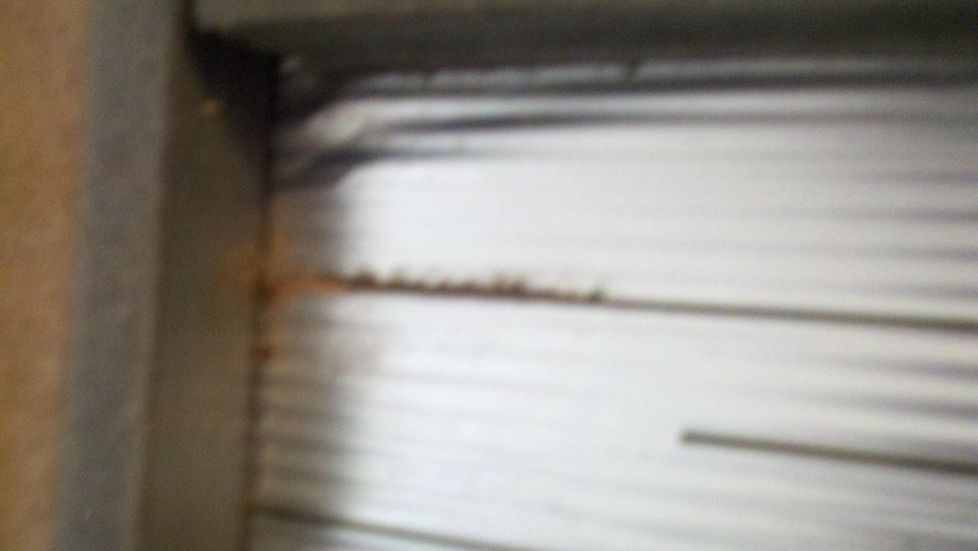

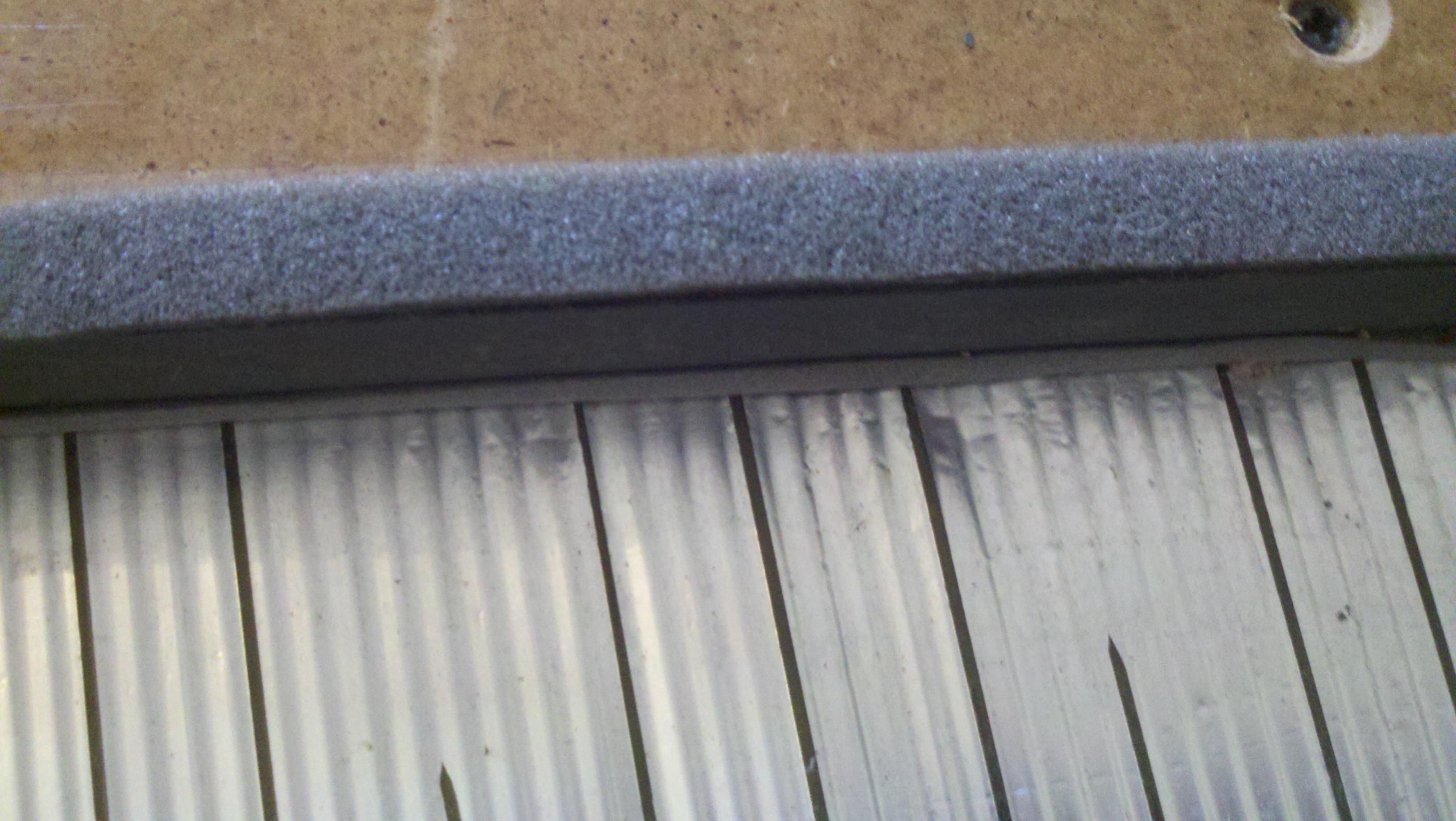

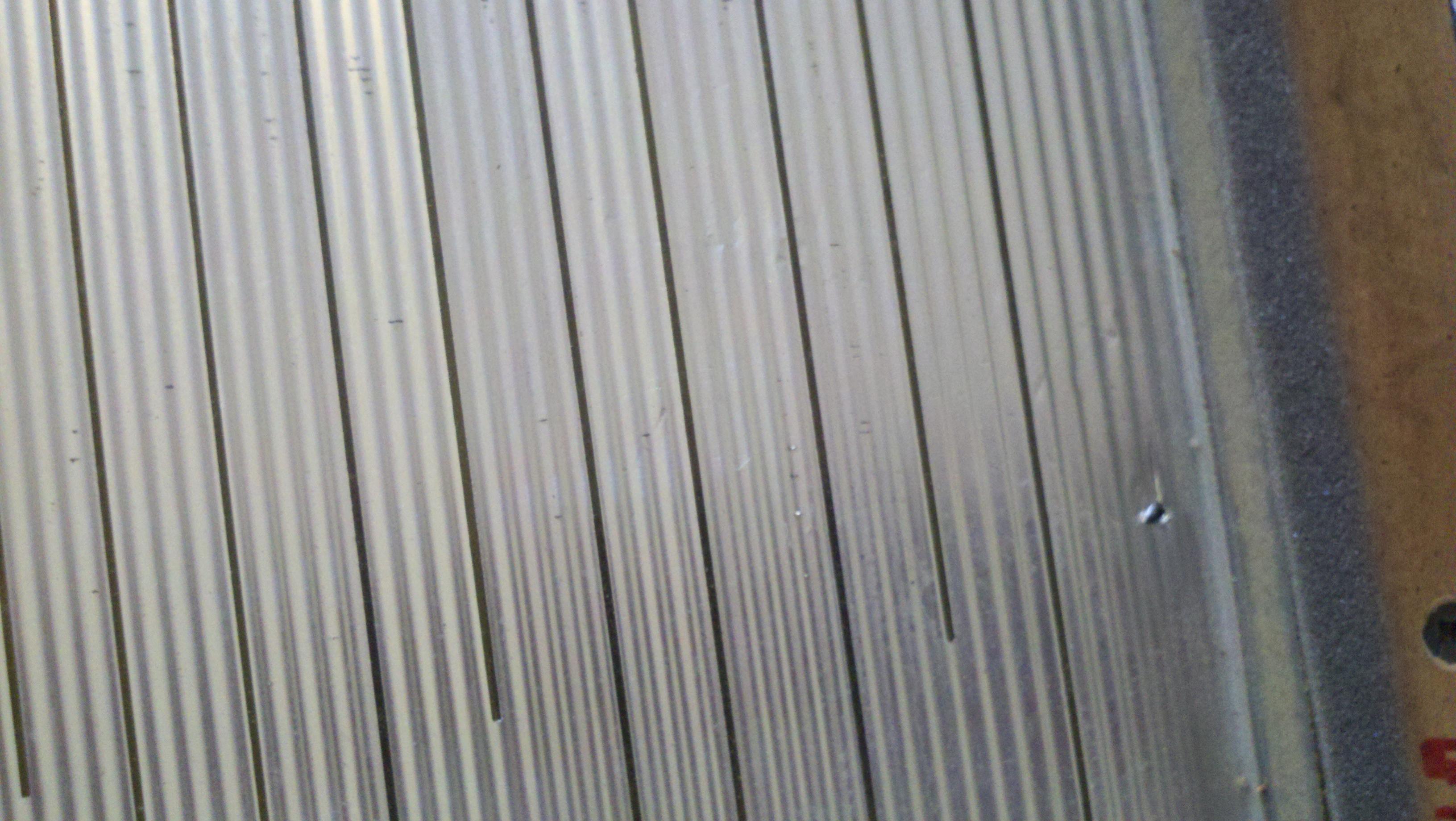

I guess your foil has a break in the circuit somewhere, look under the horizontal bars on top and bottom for a small crack in the foil.
Sorry, in my opinion you have to put new foil in your speakers.
Retensioning won't do it.
Beside the crack, the foil is very uneven, plus I suppose you've got the buzz.
