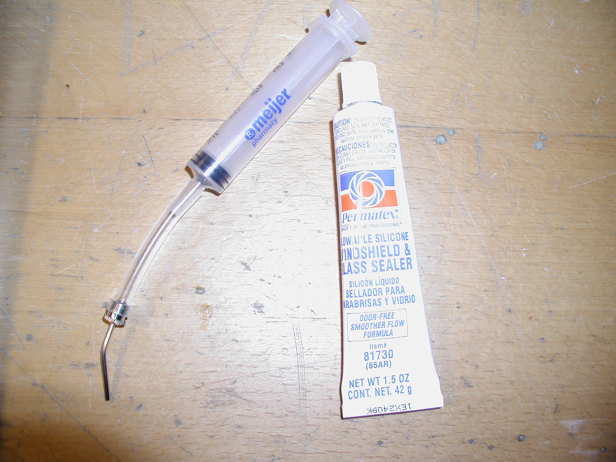

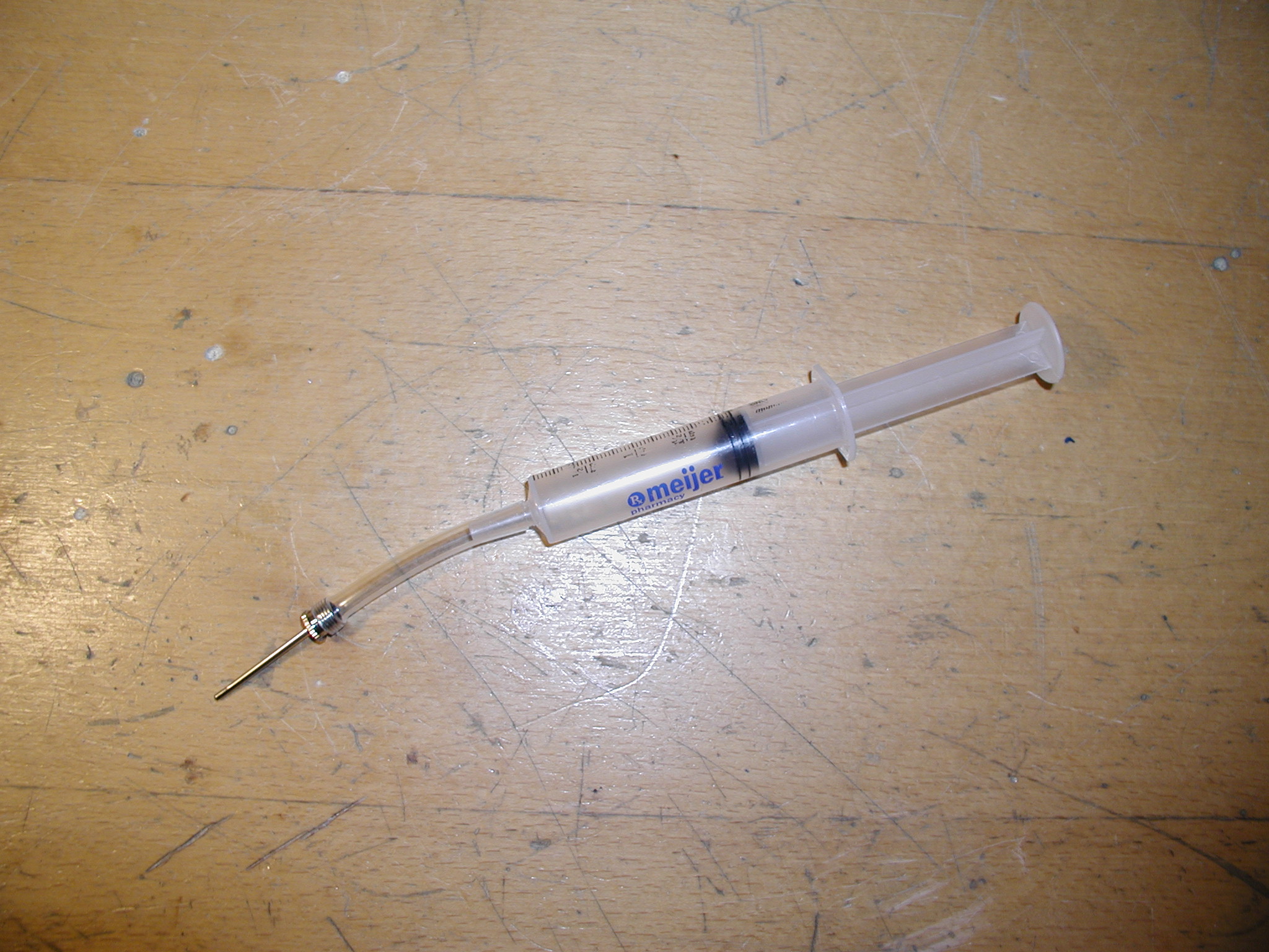

Hey, just made this contraption to get the fluid into the crevice between the diaphragm and the wooden clamp...
A basketball needle with tube and syringe...I knew I became a mechanical engineer for something...
Also bought some flowable silicone for windshield sealant, and while I was there, picked up some liquid electrical tape...looks like they may work?
Maybe I will see if I can bend the needle about 60 degrees to better get into those spots...Bingo, now bent at a 60 degree angle...good thing its stainless. Now to find out if the silicone will flow through it...

Just opened the tube of windsheild sealant. flows pretty nicely. Good sign.
Maybe after getting the easy side, and after drying, the diaphragm will stick to the silicone and stay put and not need the injection on the dificult side??

John, your tip is very solid, you should take care not to damage the corrugation of the foil.
With soft silicone tubes, the Chance Tod damage something is less given. Being careful, your tip oft course also is useable.
I used zermack HT 33. One point important: Once dried, it should be very soft, so the foil experiences less stress when playing music.

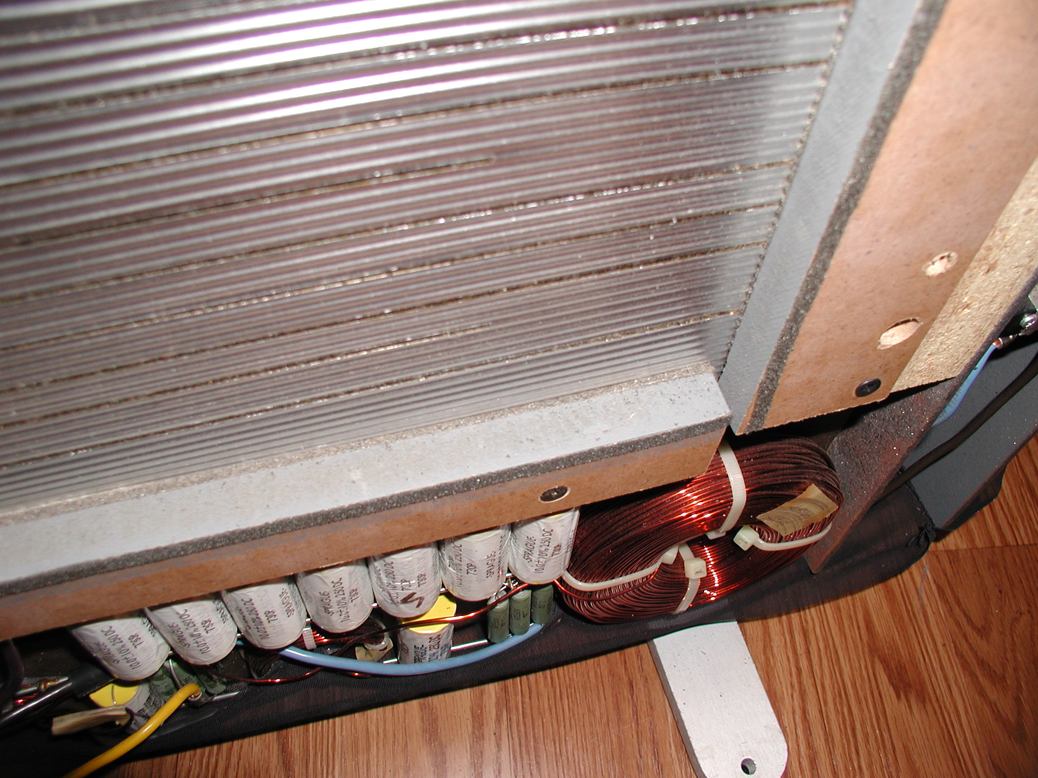

The top and bottom horizontal clamps (wooden block) are not siliconed, only the vertical sides are treated (in the Front and backsides of the speakers).

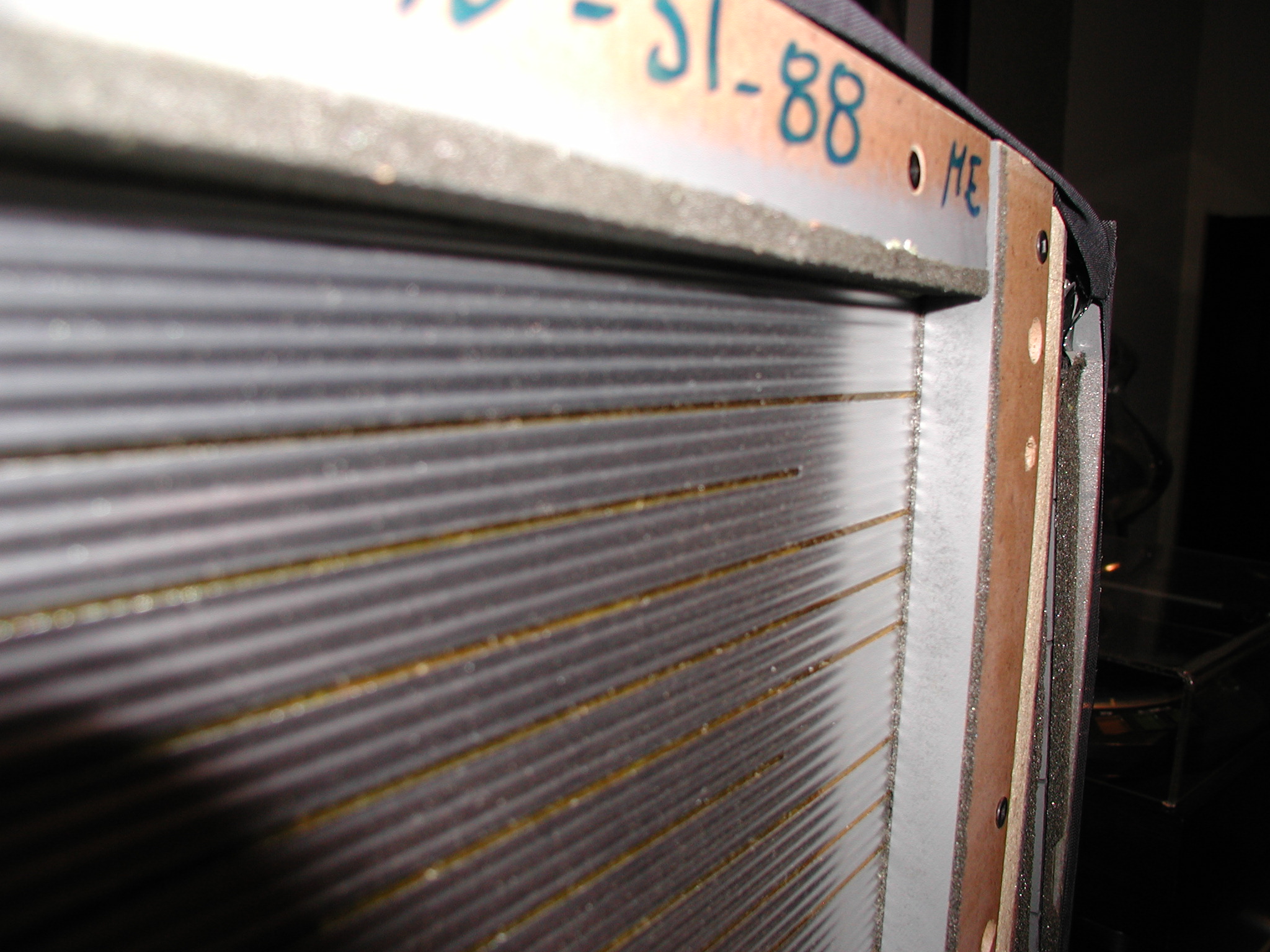

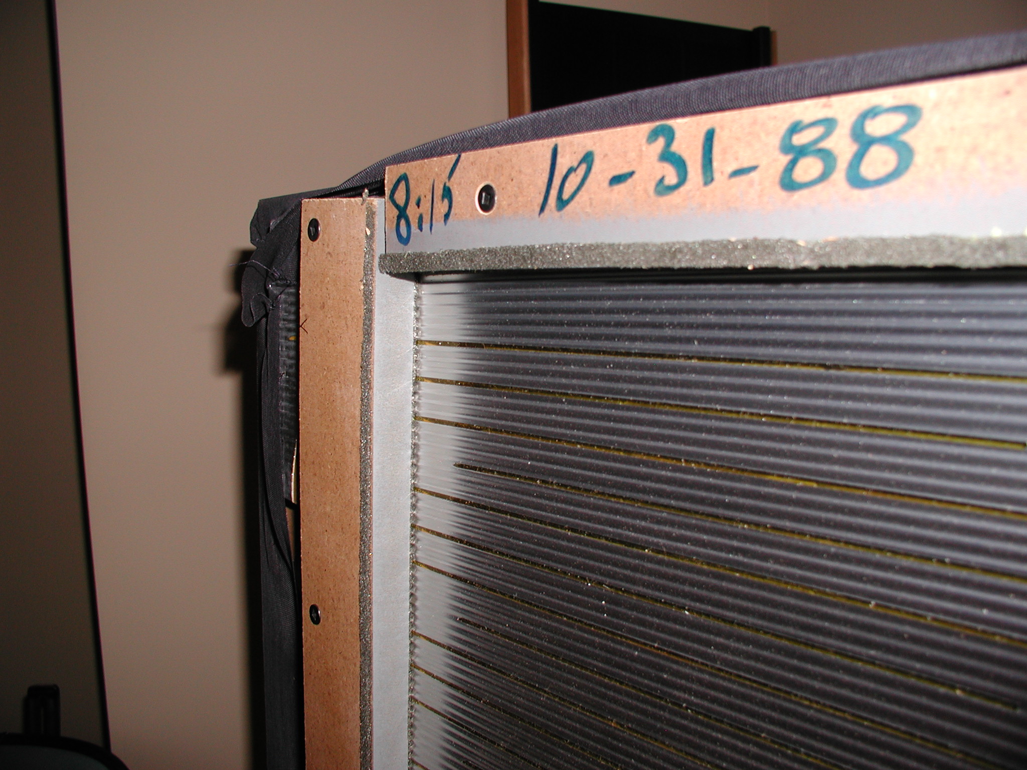

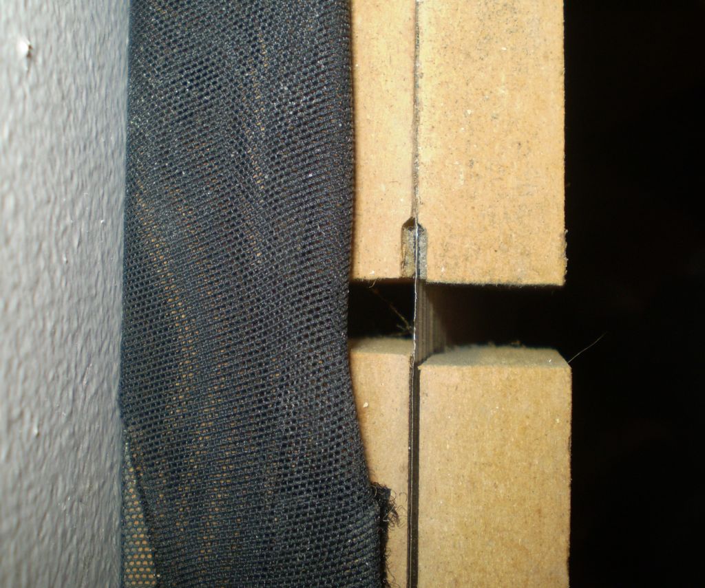

OK, removed the cover to get some good shots...I can see some voids in the gap...does anyone know how deep the recess is? Guessing 1/4"?

John, I bet your windshield sealer will get too hard once dried.
To put less stress to the foil, it's important to use something very soft.
My suggestion is working perfectly.
About doing only one side (the front); I think it's not enough if you play music a little bit louder, it will still buzz.
But try it and decide for yourself.
Applying the stuff to the back sides is not so complicated: Gravity and the flowing silicone is your friend 🙂
You have to "pour" the silicone from the top, and place the Apogee, so that gravity will guide the flow downward in the gap. The tilt of the speaker should be low, so that it'll flow slowly.
You can see the backward gap looking onto the top of the speaker (with removed cover), like on Geralds Pic.
