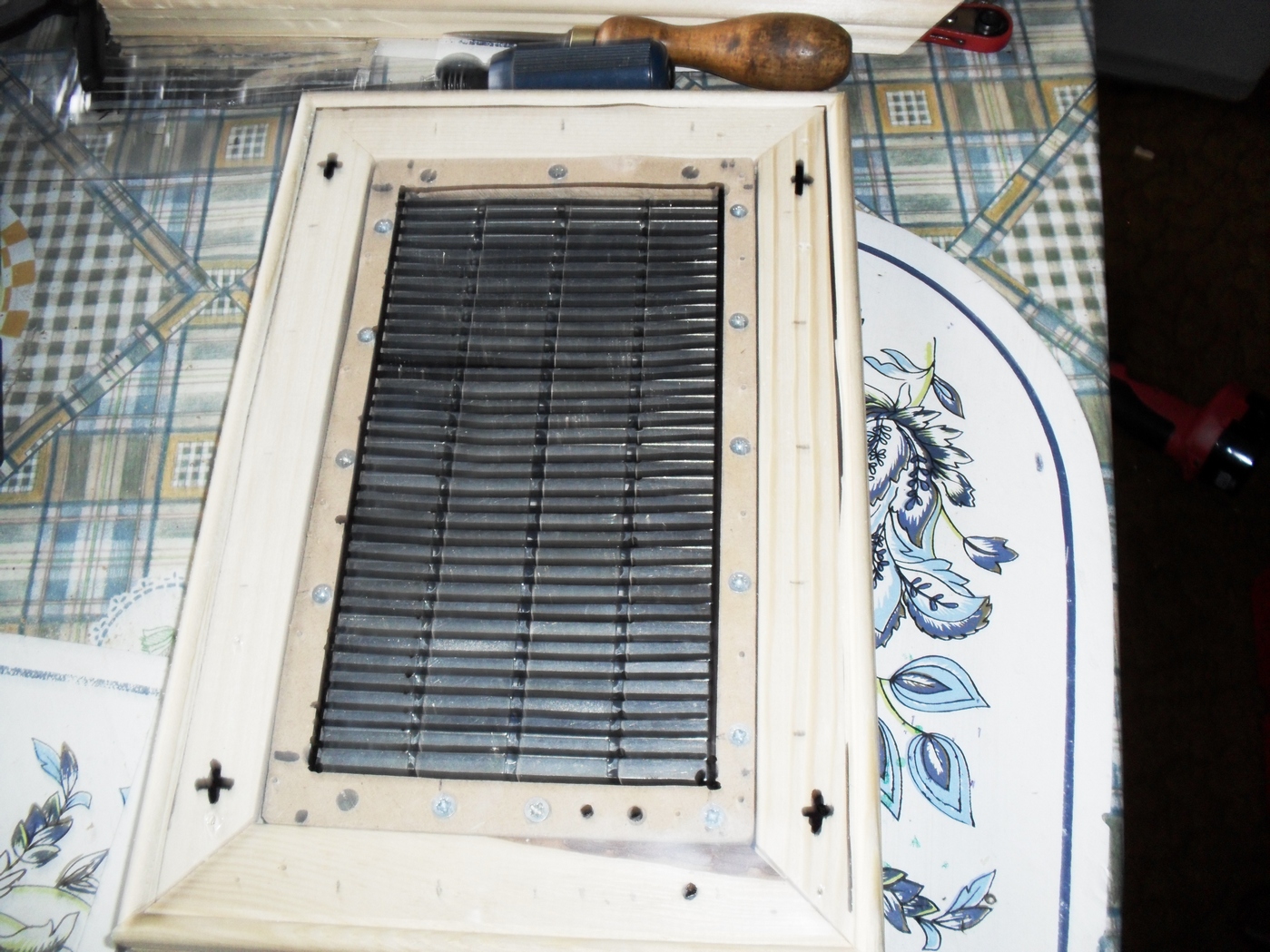

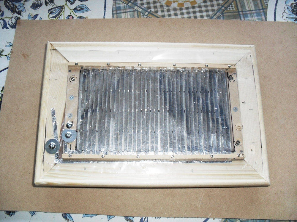

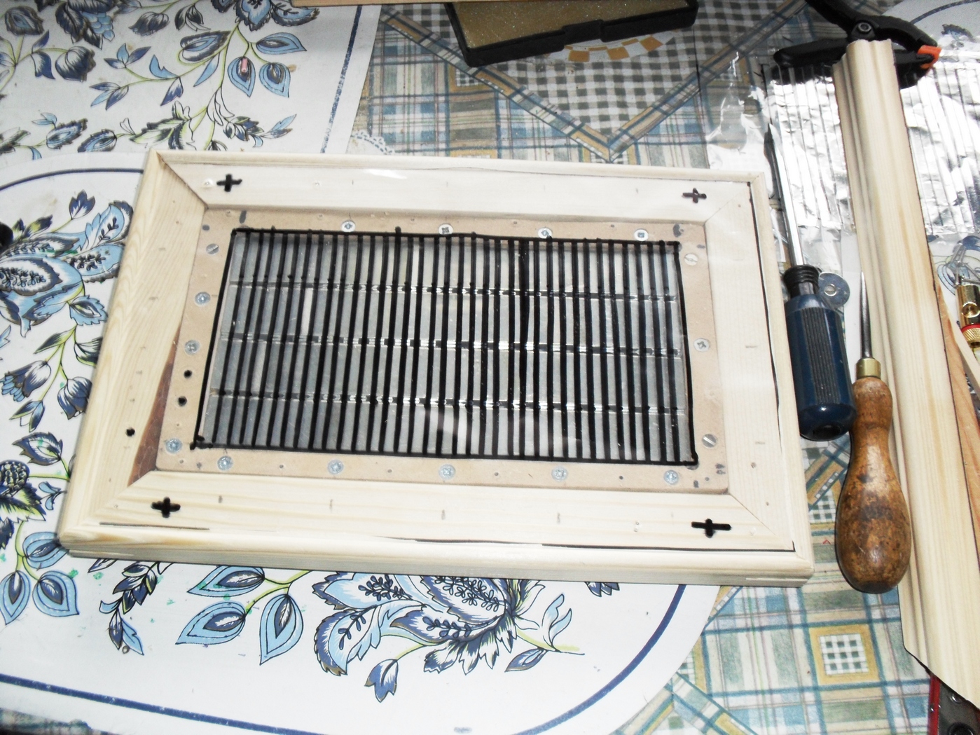

All the pics of the diaphragm are not very revealing on the actual layout of the aluminium vis a vis the magnets. It is easier to see this relationship on the epsilon which gave me the inspiration to change it for various magnet layouts on my latest designs. Which are much more sensitive than my older ones. I will be rebuilding all my older designs about 30 altogether. Have to buy some more MDF. I already have the magnets in abundance, and I won't be using superglue or any other type, as I might have to do more rebuilds who knows?All the best Jer.
Yes it is hard to tell because it is hidden by the frame.

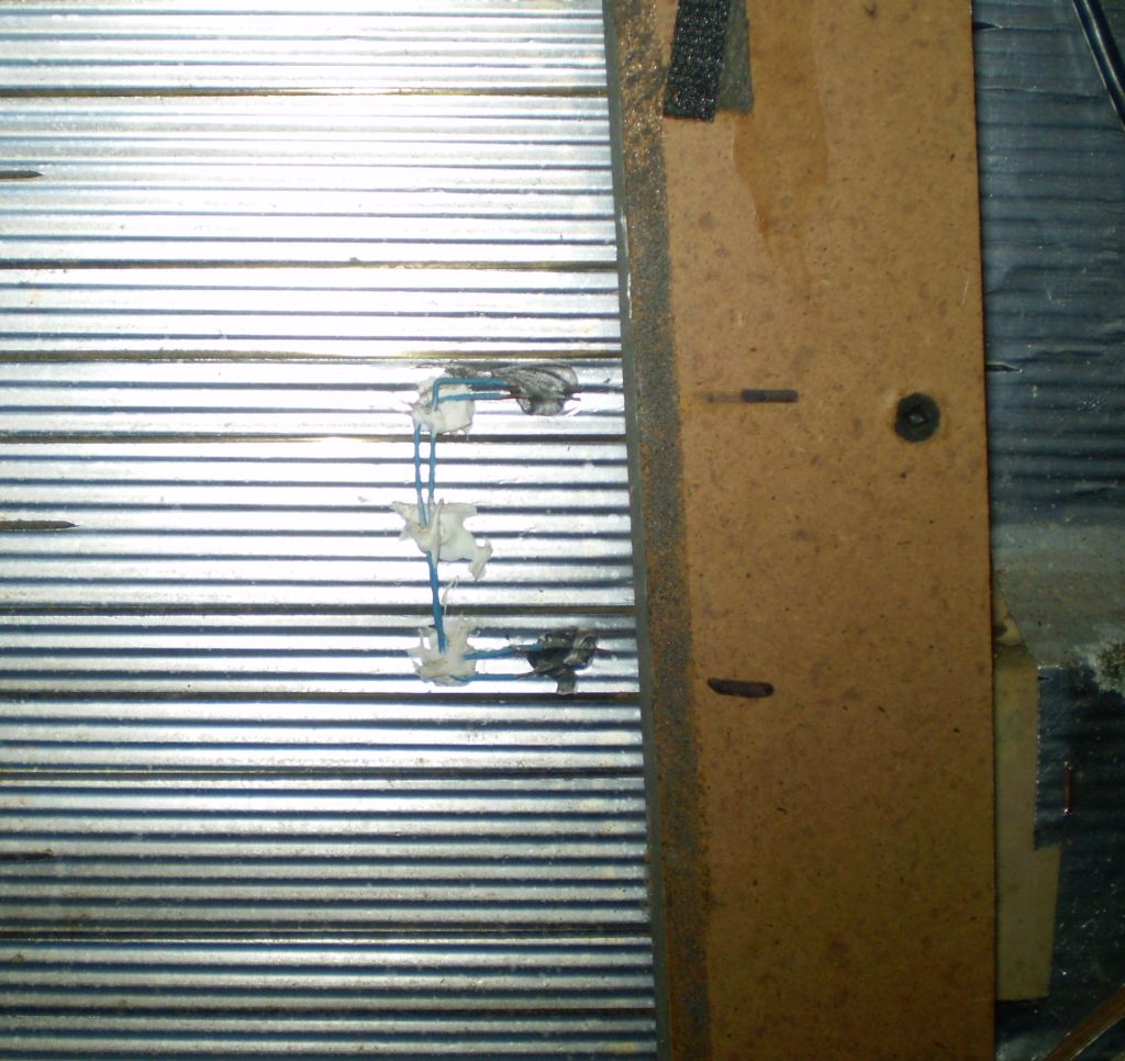

I have had to repair one of those loops that had opened up and rendered the bottom half completely dead, one time.

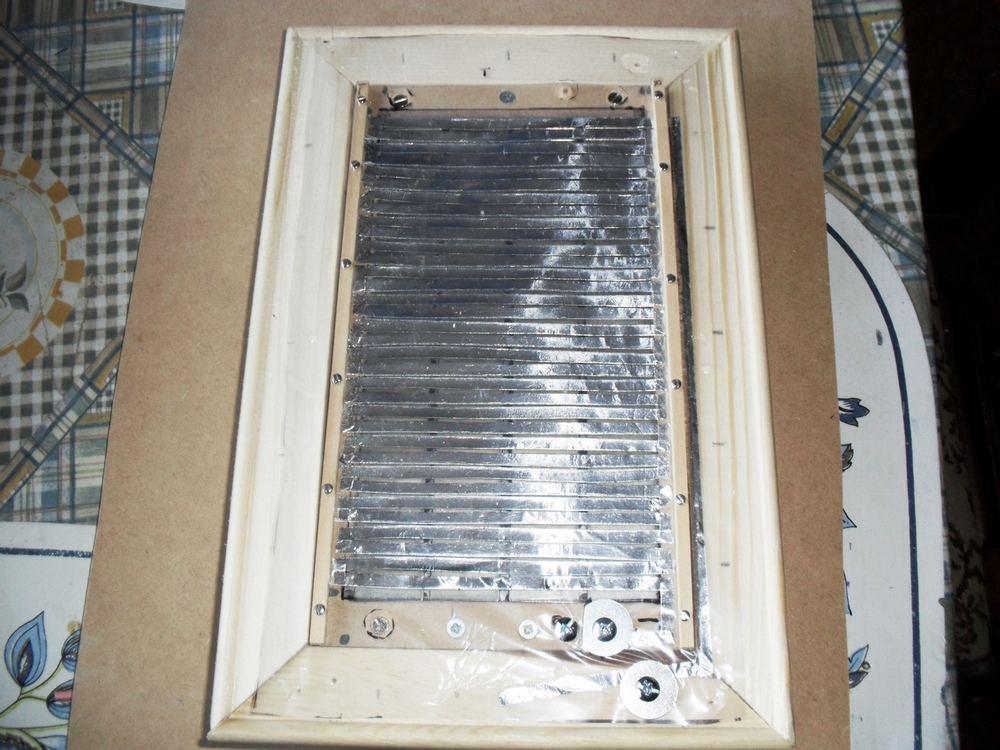

Hey Jer, just got a pair of Duetta Sigs...the bass panels sounds OK and no rattles, so I guess I really lucked out!!
From the pics, it looks like you were able to remove the speaker assembly from the frame? I would not mind taking the frames and painting them piano black (frames are the worst part of the entire speaker).

That is Great !!!!
The ribbons should be very easy to replace as they are just sandwich between a couple of blocks held in place with threaded holes and machine screws.
I never took them off so I don't know if there will be any glue involved making it difficult to take them apart and release the ribbon.
The Covers are held on by two screws at the bottom and the top is secured by a couple of Velcro strips.
So you must lay them down first in order to get the screws out and then it should lift right off starting from the bottom and then the velcros will peel off releasing the top.
On mine there is only two of them at the very top a little off from the center on each side.
If you need I can get some more pictures.

So far so good. I will be removing the frames to refinish them in the not too distant future...thinking piano black...

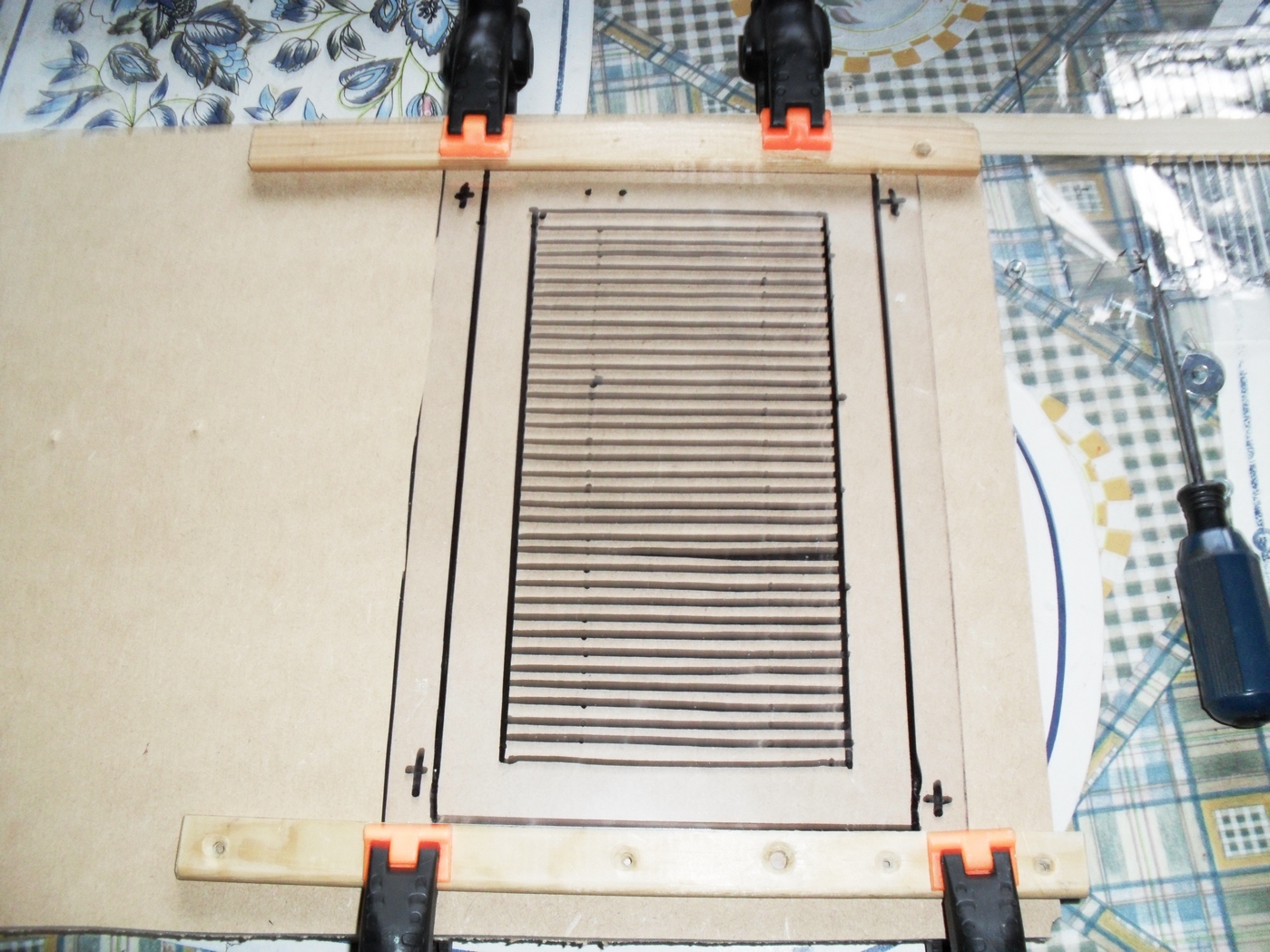

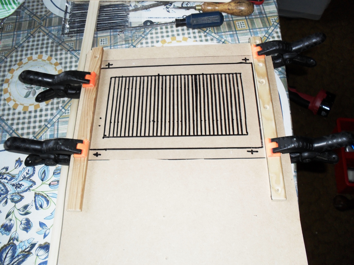

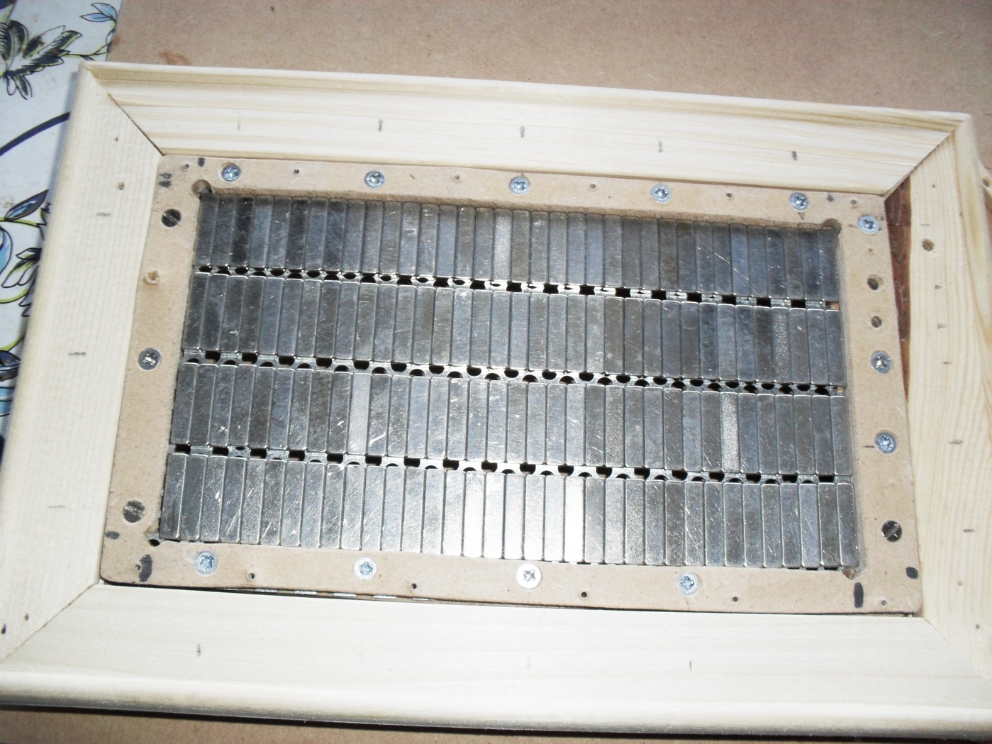

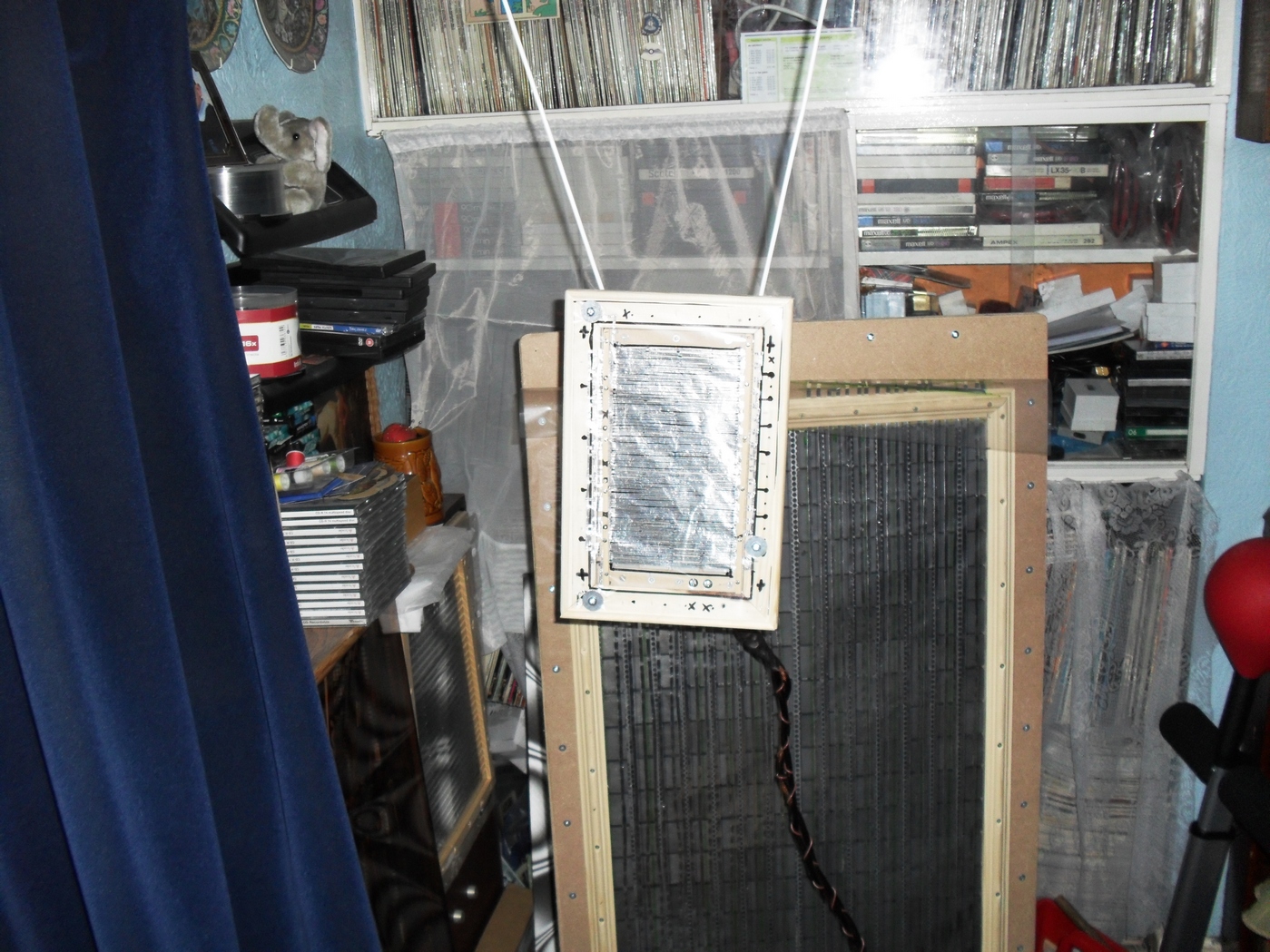

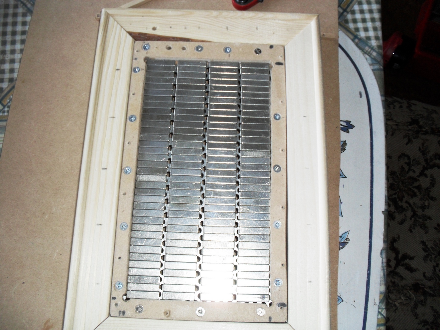

I have built an A4 design using 25 x 6 x 3 mm neos quite pleased with the outcome.Yes it is hard to tell because it is hidden by the frame.

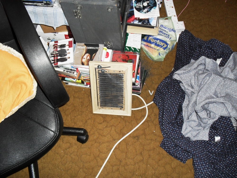

some more pics.
Have posted more pics on my own thread planars using neos.Vary cool...Henry...thanks for the piX

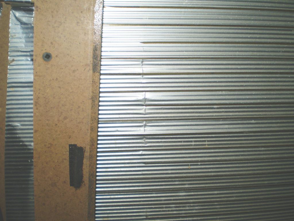

I just got to the other panel it is open to !!! 🙁
The tweeter ribbon is down 1 ohm or so and reading about 1.9 Ohms by my meter.
All of my readings include the .3ohm offset of my probe resistance.
I don't know why this is, except that there are two aluminium strips on top of each other that complete the series loop of the three sections of the ribbon, and these two may be shorted together as there is no extra insulation to separate them.
Now for the woofer panels,
It appears the two sections are in series.
I got 2.9 ohms for the top section on one panel.
And 2.6 ohms for the bottom section on the other panel.
Also the lager air core inductor for the cross over is about .5 ohm.
Therefore the total resistance should be about 2.6+2.3+.5=5.4 ohms plus a little bit for the rest of the traces connections and wiring.
Both of the sections go the entire length of the panel and it may very well be possible that one of your sections is open and had been rewired for use of just one of the sections working.
Thus the reason for your 3 ohm measurement.
Back in 2000 I had to repair the one panel by using some wire warp wire glued on to the the diaphragm with some silicone and circuit works conductive silver paint.
And I guess I am going to have to do this again for the other section.
The other panel is going to be a bit more involved as it has a line of micro cracks in the aluminium voice coil all of the way down the panel on both sides were it was slapping against the edge of the magnets that are in the back of the diaphragm.
I was crankin' on them pretty hard that day as they were trying to keep up with my 4 X 10's and 4 X 12's woofer system.
They made for a very nice and clean midrange system that day for a little while!! he,he,he,he
Luckily I wasn't using the ribbons then!!
But at least they are repairable though.
I will try to get to them maybe this summer once I get some room made to properly set them up again.
jer 🙂
