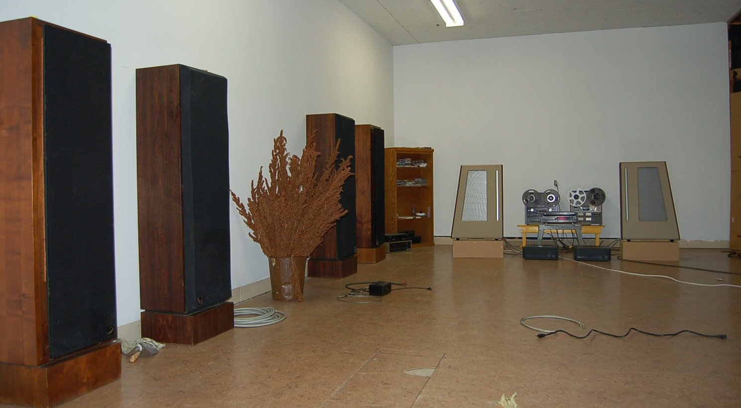

When I opened up my Stages to clean out the dust; I wondered has anyone ever replaced the internal wiring which isn't particularly 'audiophile' with something of higher quality, considering how much money people are willing to spend on the cable between the amp and speaker.
I know a lot of people dismiss the audibility of wire as 'hype', but when you add up all the small things...
If you have, what speaker cables have you found that works best for the MT and are you using something different for the Bass panel; also, did you use the same wire between the speaker and amp?
Opinions would be appreciated as there are a lot of cables out there, and it would take a lifetime to hear them all as well as make me bankrupt.

Well i never cut the old soild wire out...i just bend it out of the way.....May be tape it....
.What i have found Wire wise... Silver cotted copper with Teflon cotting for the inside of the staged..thats bass an M-T....20ga work an gives a better sound all around.... just the right mix.....
But if you go biger like 18-16ga...it pushs the bass out an sound get darker sounding.....
then use what ever as speaker wire you like... to the speakers..........
An for sure... i get rit of crimp stell type ends that Apogee uses on there wire ends... one stock i do not keep....i pull then off...thay can them self be lose an buzz....i did this on every pr i had....Even Apogees solid wire can an well buzz...
Do this even if you keep stock solid wire.....just slip the barwire under the screw.....work an sounds better.....
All just one mans finding...............

My Stages were factory wired with Symo, according to Jason bloom to sound better than some exotic priced wire on the market, The latter production also used kapton for thier ribbons than the earlier mylar models, mine are the later when Short worked for them on thier engineering team. It was also stated that the sprage and asc caps, still had better sonics, than a lot of modern caps of today. I read this awhile back somewhere, and have to somewhat agree with it.
My Frist Krell KSA100 was wired with Symo... hehe.........I had Symo 10' bi-wire pr of Speaker wire for my for frist pr of Duettas....
Symo never worket for me.....Jason liket it a lot...
An as for the caps.....I have never found any better in the Apogees.... than the Stock caps.....but i Did all the cap changes in the 90s....the new telflon wire in my Stages give me a taller image.....
For the mylar M-T .... i alway tried to hear the two sided ones....Never did...
Samppo Stages were madein 90...An i think his are capton backet ...all mine were captone backet........i Know some of the frist Rave review were with the Mylar M-T...
I have always felt you would get a taller image out of the Stages when sat on the floor...the stans were a after thought...or made becase of the capton back M-T did not give as tall a image....the Stages Sound more Bal on the Floor.....well to me...
I bet you get great sound out of Mylar with foil on the back side .....but could fail if driven buy a 1000 watt Krell..

tyu I have my Stages in a 17x33' area, I found they sound better up 10" from floor than on floor, also 4.5' from back wall, they stand just about straight up and down, tied them down on back side so they can't fall over, solved alot of over bass problems in mid bass, also the midrange and high freq is much better, but I think room is just s tad big for them.
Yes pro an con hight off the floor....i have hard wood stands 8"...... Big Room....my room is 18'X40'X13" all open....with a 7' movabel wall ....so to day my Audio room 18'X30'....90 degrees....yes an no...it dose change the sound......
I have toyed with Makeing new feet for the stages like the Duettas....but taller that would put the Stages at 8-10" off the floor......hehe time well tell

Hi Everyone.
Many thanks for the all the info on Silicone treatment and longevity of the stuff. More than 10 years...super !!!
I will order the Silicone shortly and keep you updated
...and Tyu, you are completely right about putting glue in the coil is a One-Way solution. Unfortunately, I don't think it would have worked just to tighten the wires with plastic strips or something. I couldn't make the buzzing sound disappear completely by pressing on the coil. It seemed to originate from deep inside the coil.

look i am a give me diy.....are death....But out of all the Speaker i have had...these littel Stages Have the Magic.. but hell get some coils that wont make noise....i think jason like the sound of loos hand made coils..i know i do...jut a littel blu-tak well stop ther talking...hehe
.Sure in a day are two i go to my Acoustats...or My ML.......or even the Magnepans.....all these type of speaker can gain from the same modes............I just pull a Res out of the inputs on my Acoustats high frec tran....thats in the C mod....that i thought was the end of the work to get the best sound out of the 121 interfaces..... After got over the Shock on how much better it sounded.....Then i put in my centaur minor....That by the way have the Same M-T as the stages....But are crossover higher than any of the two way M-T than any two
fullgang Apogee....an it has the best top end ever....i pulled the trap out of the stages so that all the M-T see is the sears 70mf...the trap adds a 1.5 ohm res...
an the Stages sound stage ......there a lot more there ...there..hehe....only took over20years to bipass the switch....even though i had read for years that the switchs Apogee used .....were sound killers.....so know there like new speakers...gofig
I well say this Dont miss a pr of Cen Minors.......same old loos coils an same caps..
but the crossover has 30mf an an a smaller trap....were the Stages has the 70mf an a biger trap in the crossover the minor can give Great sound an image....for vary littel $$$ an we all lov that...........................
