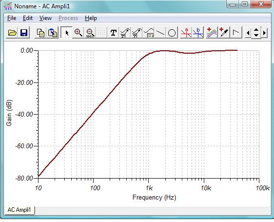

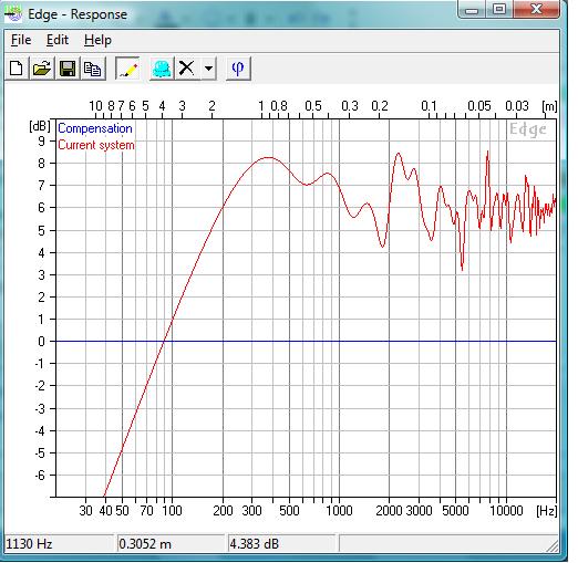

If you download the edge you can simulate it, Tolvan Data. I have been playing with that and now at the ornery question of whether to use the baffle roll off to do a fast type setup, or follow the Linkwitz approach of a 6db shelving response to equalise the bass, then a 120Hz LR2 High pass to get the response. First play attached.
Also been trying to understand one part of the minors high pass filter as there is a small notch. Feeding the values that are flying around the web gives the attached result, which is a very small presence dip. I had to guess the ribbon parameters, so it wont be correct, but makes no sense, which is annoying as I don't know what its correcting for and if I need it. Must have a purpose or they wouldn't have put 3 extra components in.
Might be the stage to fire up a new thread for the minors but have been doing some more simulations whilst waiting for the ribbons to arrive. Interestingly taking the stands out the equation flattens the simulated response nicely. But there is a nasty dip at 1Khz that I need to potentially take into account.
Putting the full (published) crossover into SIM along with the manufacturers figures for the driver suggests that the crossover is in fact at 750Hz not 1KHz. The crossover is asymetric.
Recalculating xmax would indicate that if I x-over to the sub around 140Hz the single 6.5" driver CAN handle it for my design peak SPL in my little room. This just leaves the challenge of whether to add BSC, or to take the fAST approach and use the baffle roll off to my advantage. Might not give me a perfect LR2 slope for the high pass on the woofer, but might be close enough.

Thanks for the link to the baffle simulator.

Based on the Sims the positioning of the second woofer is critical to response. I am intrigued that the stand has such a bad effect on LF performance.
