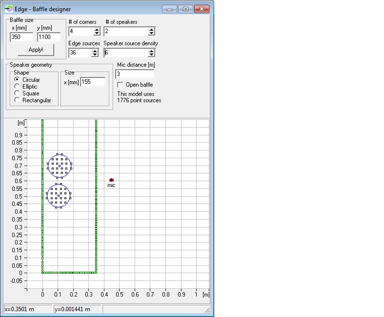

Looking at drive units again the cast frame version of the Vifa P17 that the minor used is available again. Xmax is quoted as +/-7 which isn't shabby. If the calculations show I can live with that then this is a much cheaper phase 1 option for OB operation as only need 2 more drivers not 4....

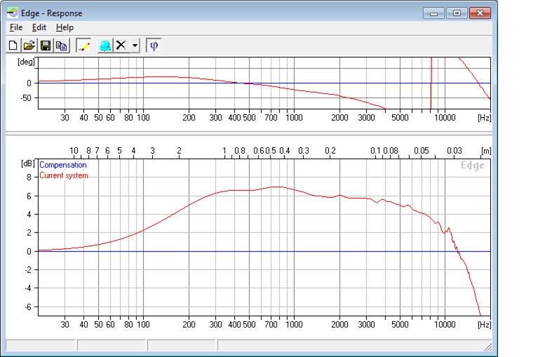

Tonight did the first order xmax calculations looking at SPL. It's clear I will need to fix my sub, and probably crossover around 140Hz. I've set the goal to be able to hit 100dB SPL at 1m to give me the headroom when listening to the few recordings I have with a high dynamic range (telarc 1812 for example). most of the time I don't go much over 80dB.
attached screenshots from first plays with the edge. I need to treat myself to basta over xmas and do some more detailed simulations. Whilst of course chanting the mantra 'trust not thy simulator lest the results beguile thee'

why replace them. Given they are only covering 120-750Hz do I really need anything better? If I could fit 8" in there I would, but I can't.

But there are better midwoofers, especially if they only need to go up to c 500 Hz, and (given the small 14 litre box, shouldn't be asked to perform to do clean bass at 100 dB below about 70 Hz
