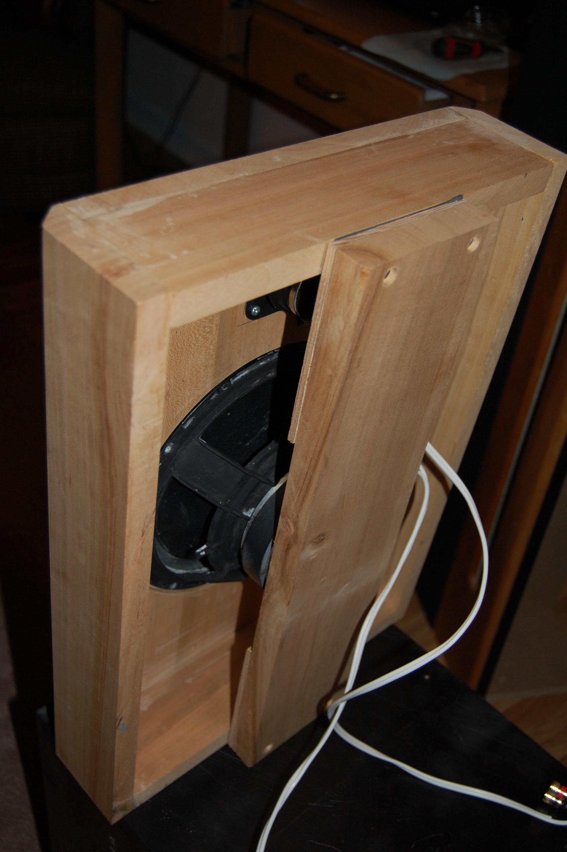

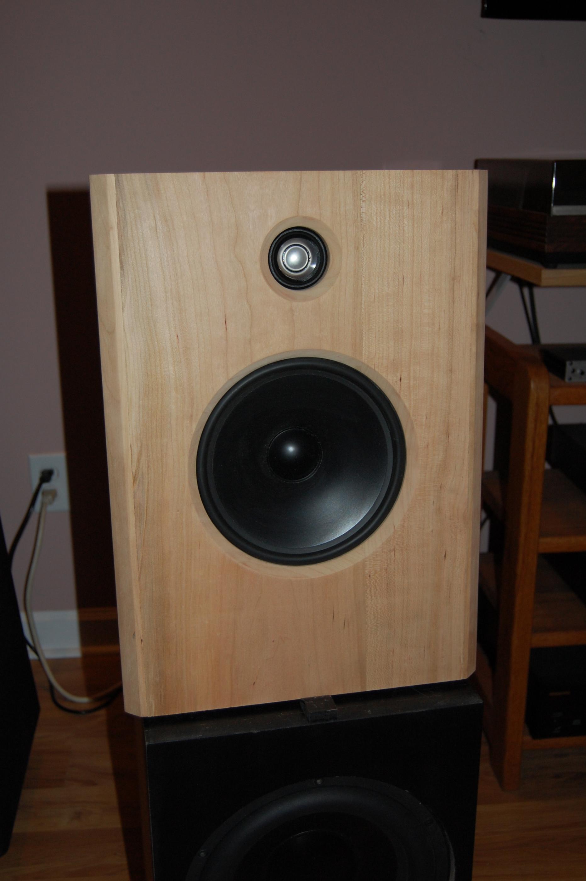

My interest in trying an open baffle woofer to blend with the ribbon was piqued by the earlier posts, so I put together a pair of mini-Orions, since I already had the 8" required Vifa woofers used in the Centaurs. I paired them with a Fountek fr58ex that I have used previously. The idea is to evaluate the 8" woofer as a candidate for duty with the 26" ribbon in a revised open baffle. I had enough cherry boards laying around to knock together the cabinets(?) and didn't want to embark on a major baffle project for the ribbons until I had a certain degree of confidence that the woofers would be satisfactory for the eventual application.
Well, this little combo is quite stunning, crossed at 2k with LR4 slopes and equalized with my minidsp. Excellent extension down to 80Hz. The separate sealed sub takes over from there.
The next step will be to get some mdf and try a 15" wide baffle arrangement per the original Centaur and somehow incorporate a subwoofer without making the whole assembly too large.

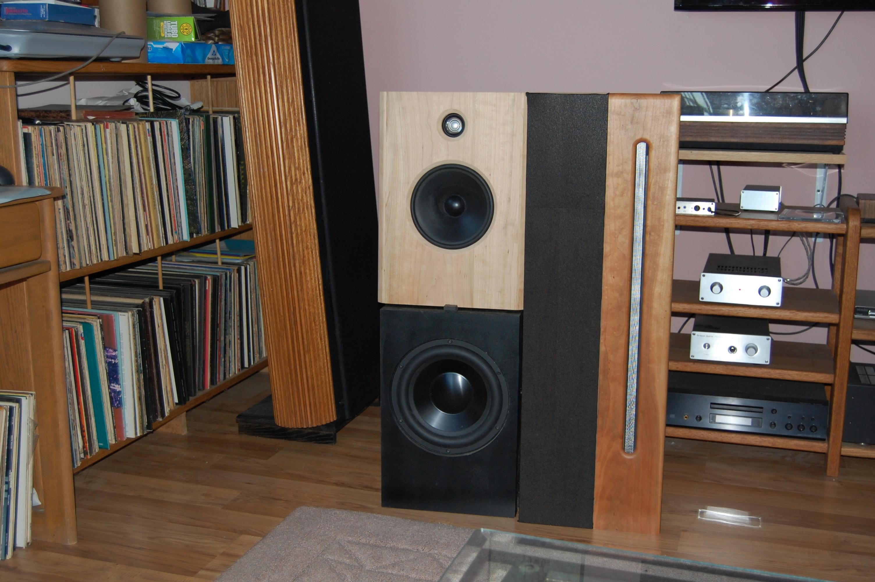

I replaced the Fountek tweeter with the truncated Apogee ribbon baffle and stood the ribbon , 8" woofer baffle and 10" sub in a compact heap. This ribbon beats all I have tried. Crossed the ribbon/woofer at 700Hz. Sub cuts in at about 63Hz.
With a little creativity I could build a Minigrand type assembly, but with the 8" woofer replacing the Stage woofer panel.
Bill...if you have the workshop facilities to make an open baffle arrangement with your ribbon, it would be well worth salvaging.
This performs well in excess of my Fountek tweeter build. The ribbon needs to be elevated though(sit on top of the sub) to maximize the soundstage.
