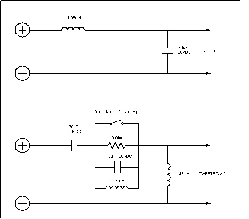

Regarding base-lining of the Minor crossover......I would suggest you make an electrical measurement at the driver terminals for the ribbon. This will properly characterize the notch filter and show any shelving that might be happening. (Since the published schematic is in question.) This will also yield a reference should you want to duplicate it with an active crossover.

Been collecting some more data on crossovers. Now running the published minor crossover (which may not be right) gives a 750Hz crossover point. but the reviews all say 1KHz. Ah well. I am looking going to LR4 active crossover, so thought would be interesting to compare passive LR2 at 1KHz to active LR4 at 750Hz in terms of levels at low frequency.
Frequency LR4 delta (dB)
1Khz +6
750Hz +2
500Hz 0
350Hz -2
250Hz -12
These are give or take as not done calcs yet, just mk1 eyeball. But it is clear that it gives a choice. You can run the crossover to the ribbon lower and still get more protection for the ribbon. So far so obvious.
If you then look at the Fane numbers for power distribution you find that 500Hz is the 60/40 point where 60% of the power goes to the bass, so this is a good point for the ribbon to be on a steep roll off.
But for a laugh I then compared 1Khz LR2 with 500Hz LR4 and at 250Hz they have identical roll off. All text book again, but for a 5% increase in power to the ribbons you get a 500Hz extension in frequency coverage AND better attenuation at the lower frequencies that cause ribbon twisting.
Something else for me to mull over anyway...

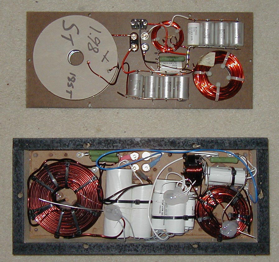

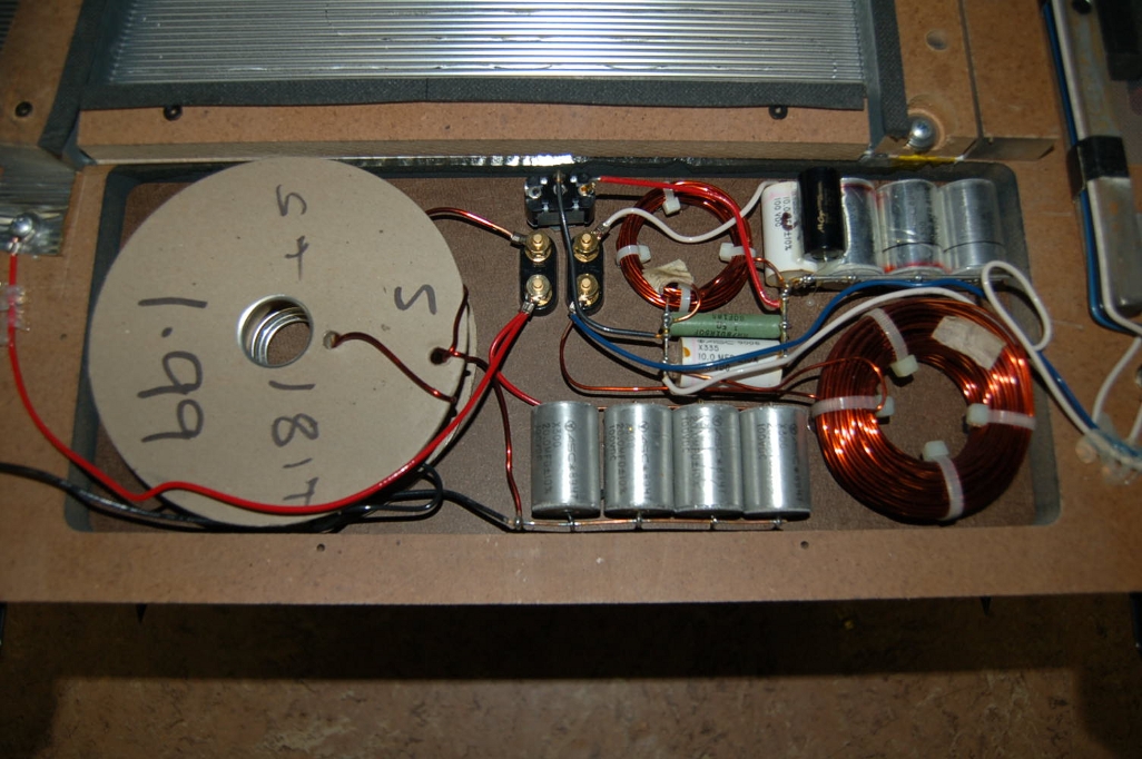

Yes.........All but the black cap...must be a by-pass...what is it a 1mf?

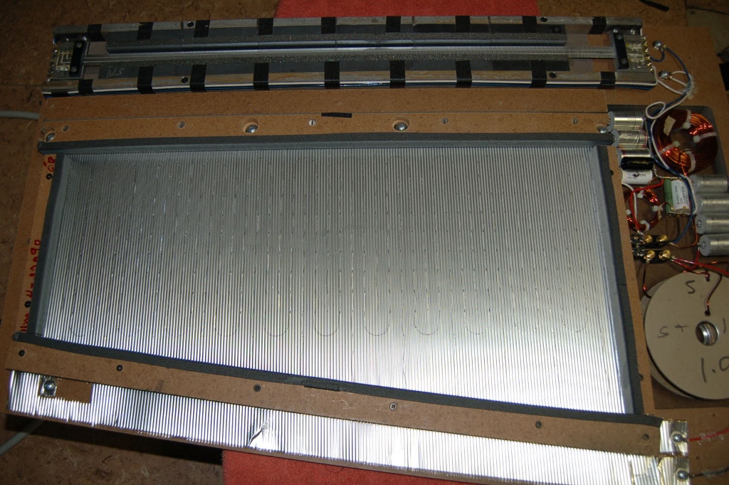

your bass an MT look like new...killer...... if those are your pr.....the MT in your pic still have the space at the top an bottem where the magnets are....it was done that way so when thay move thay would not tair the aluminum...there no mags so there no output there.. ...the later MT had no space more magnets were added but the Suspensions peaces had to be added ..
so those are the frist older MTs
Top in pic is the stock in all 5 pr I have had....bottem is the killer upgreat done by NC....I have put some of his fixs in my lates pr of Stages....big diff in sound... George Short work with Jason...on the stages
