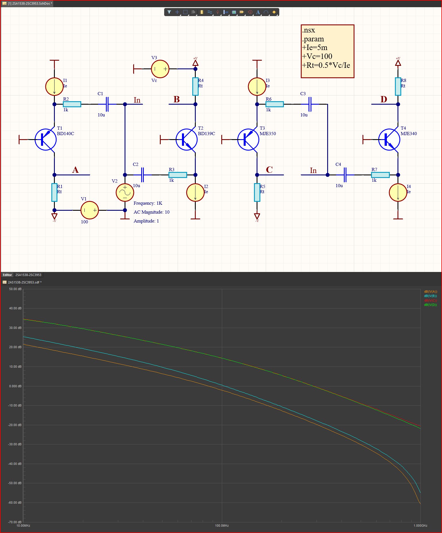

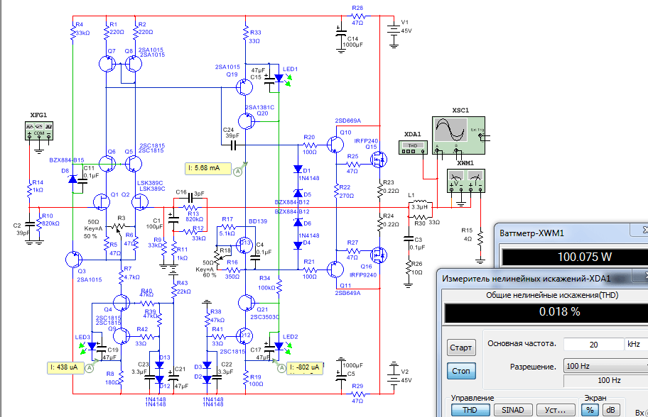

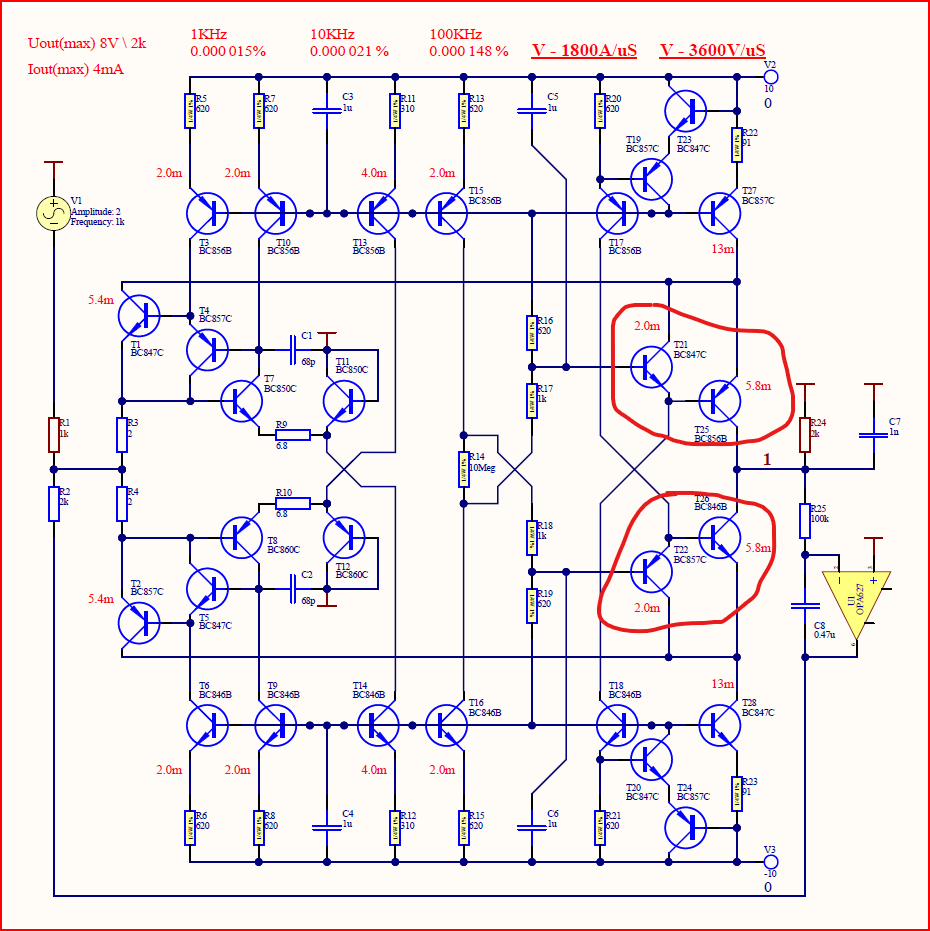

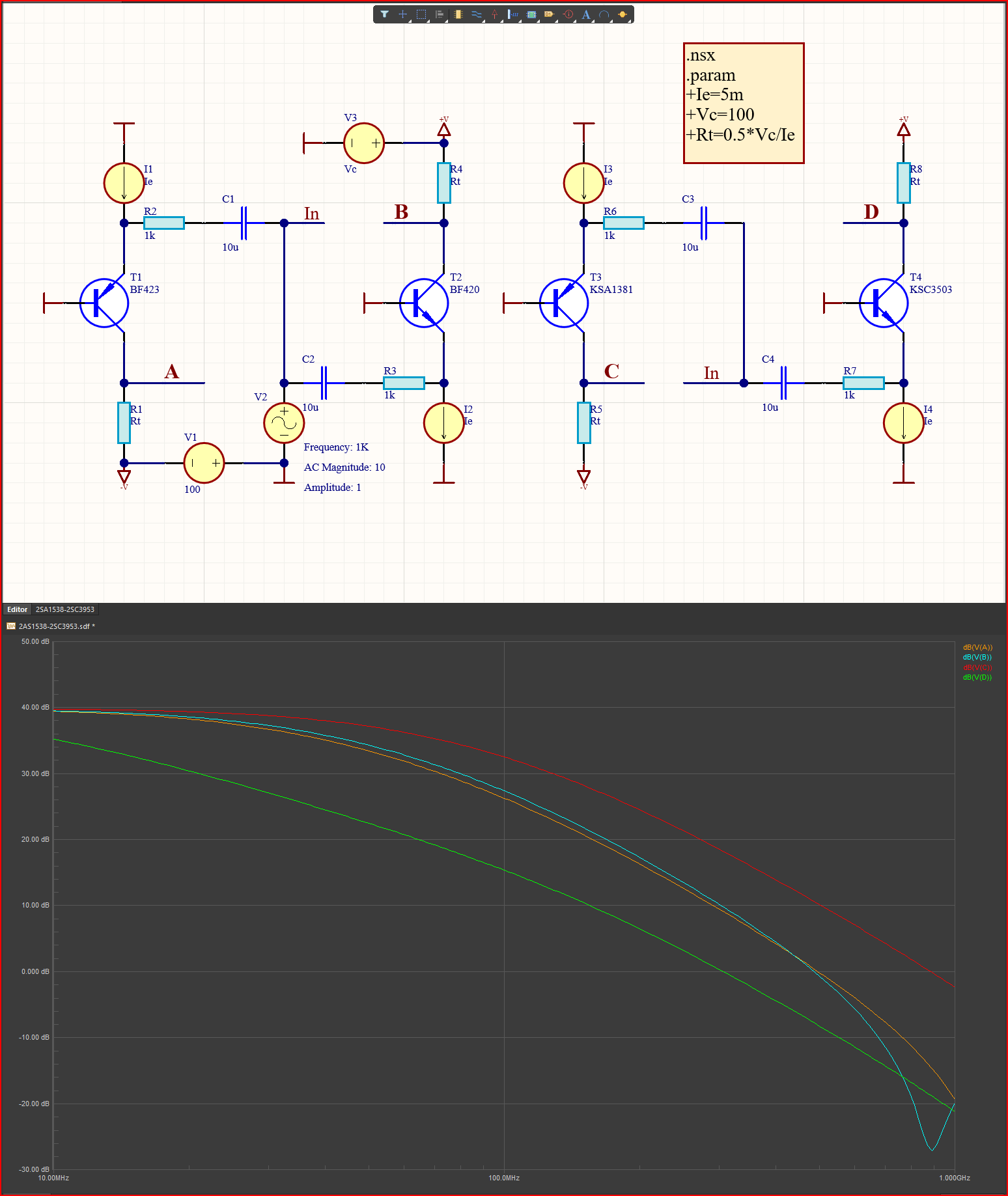

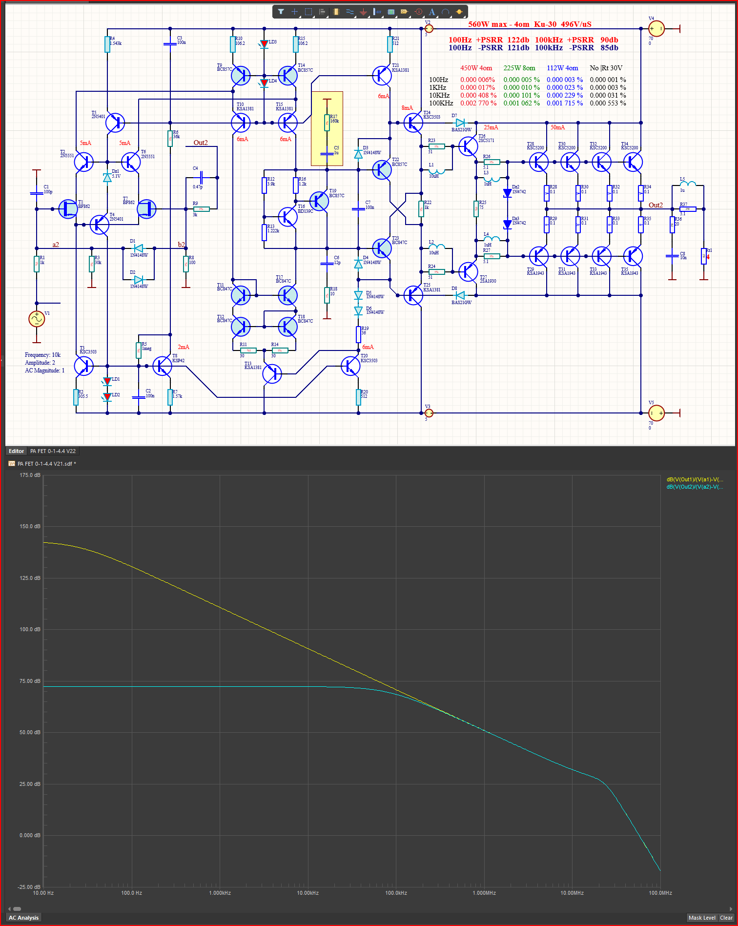

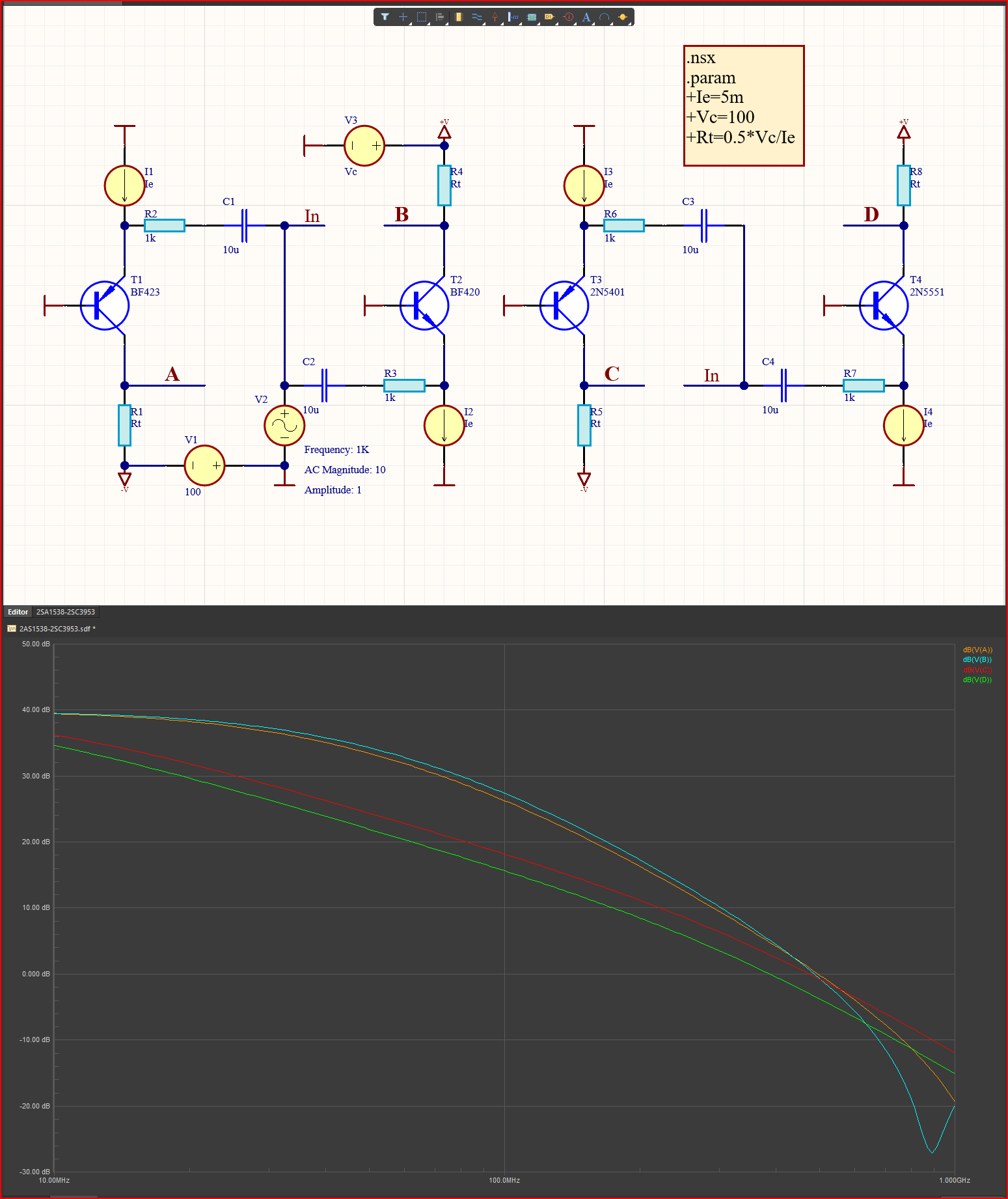

See the differences between transistors suitable for VAS
I use KSA1381/KSC3503 although in practice with BF420/BF423 the results will be better.
Because the purpose of simulations is not to brag, but to understand what how and why!
At lower power supply, 2N5401/2N5551 are good
MJE340/MJE350 are a bad idea.
BD139/BD140 are a particularly bad idea even for a common base circuit like in this example.

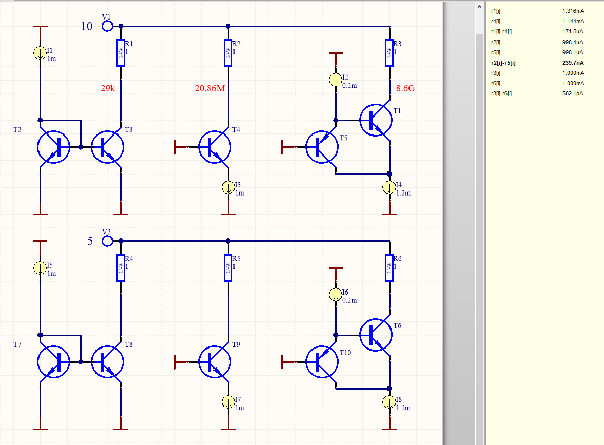

Here, the example simulates a common-base circuit with an input stage with a slope of 10mA/V
For example, a broken cascode.

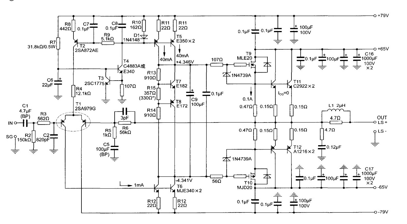

Sandy, you are sure that you are telling the truth, but this does not mean at all that your truth is the ultimate truth.
From the very beginning, I drew your attention to the importance of the frequency of the first pole, which Matti Otala drew attention to 60 years ago, but for you this is nonsense, because in your truth he is just Talib.

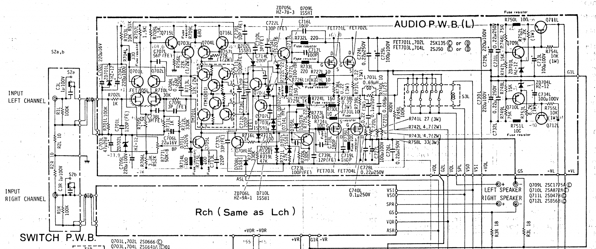

Look at the circuit of the Harman Kardon HK-990 amplifier, its first pole is above 100 kHz, and in your circuits it is below 100 Hz, like in most operational amplifiers that were not designed for audio applications at all. Information for thought.
I cited as an example Rotel amplifiers made according to the simplest circuitry and they do not use output inductances that adversely affect sound quality, but for you this is another stupidity because it does not coincide with your "truth".
By the way, there are no distortions like SID in them, which I tried to pay attention to.

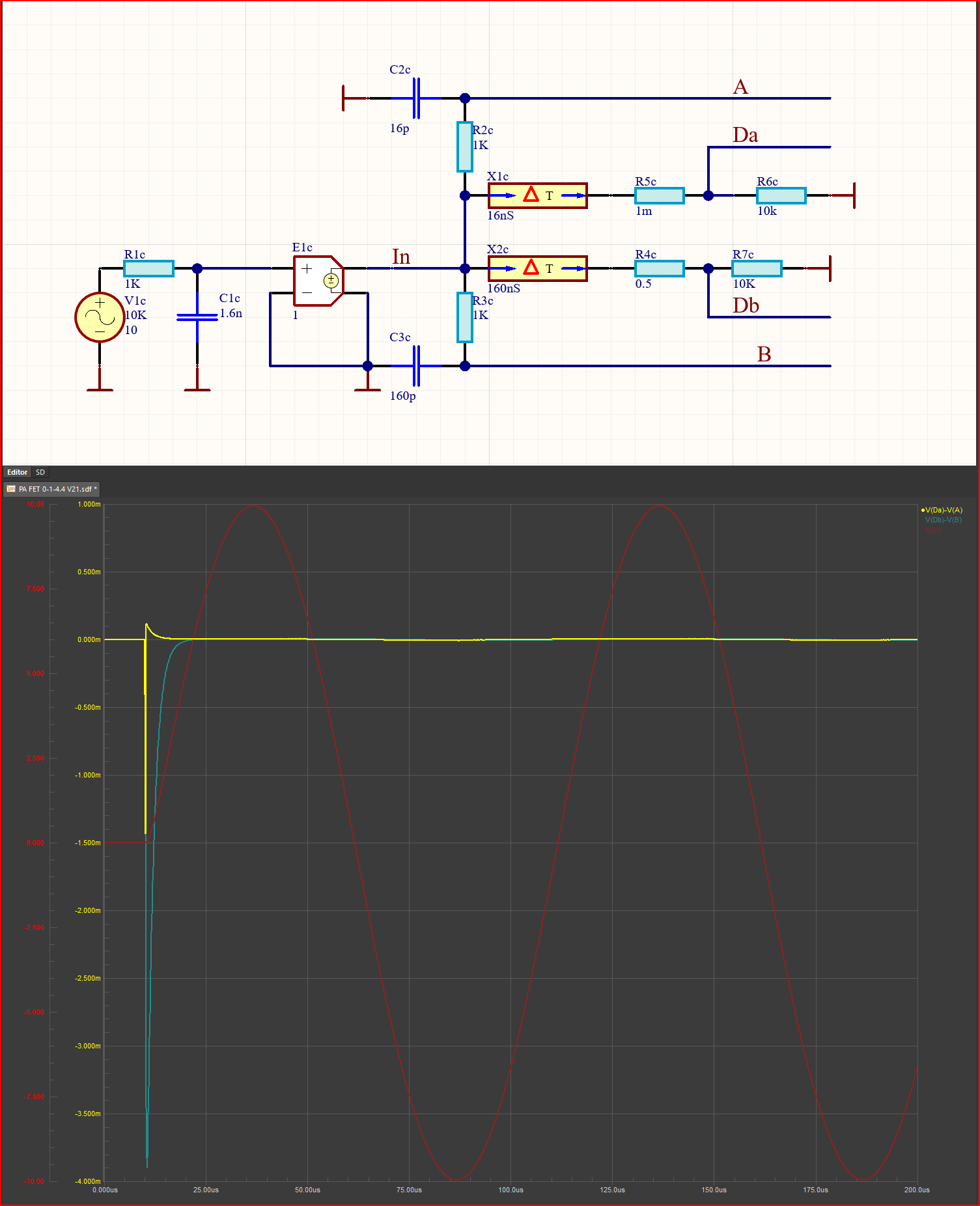

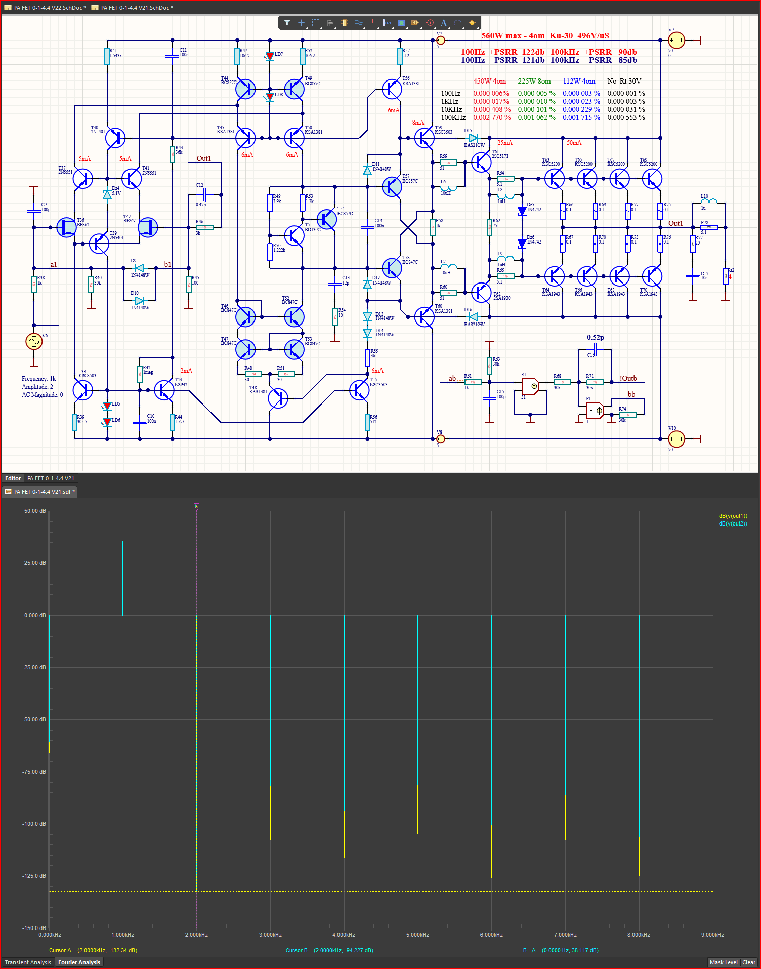

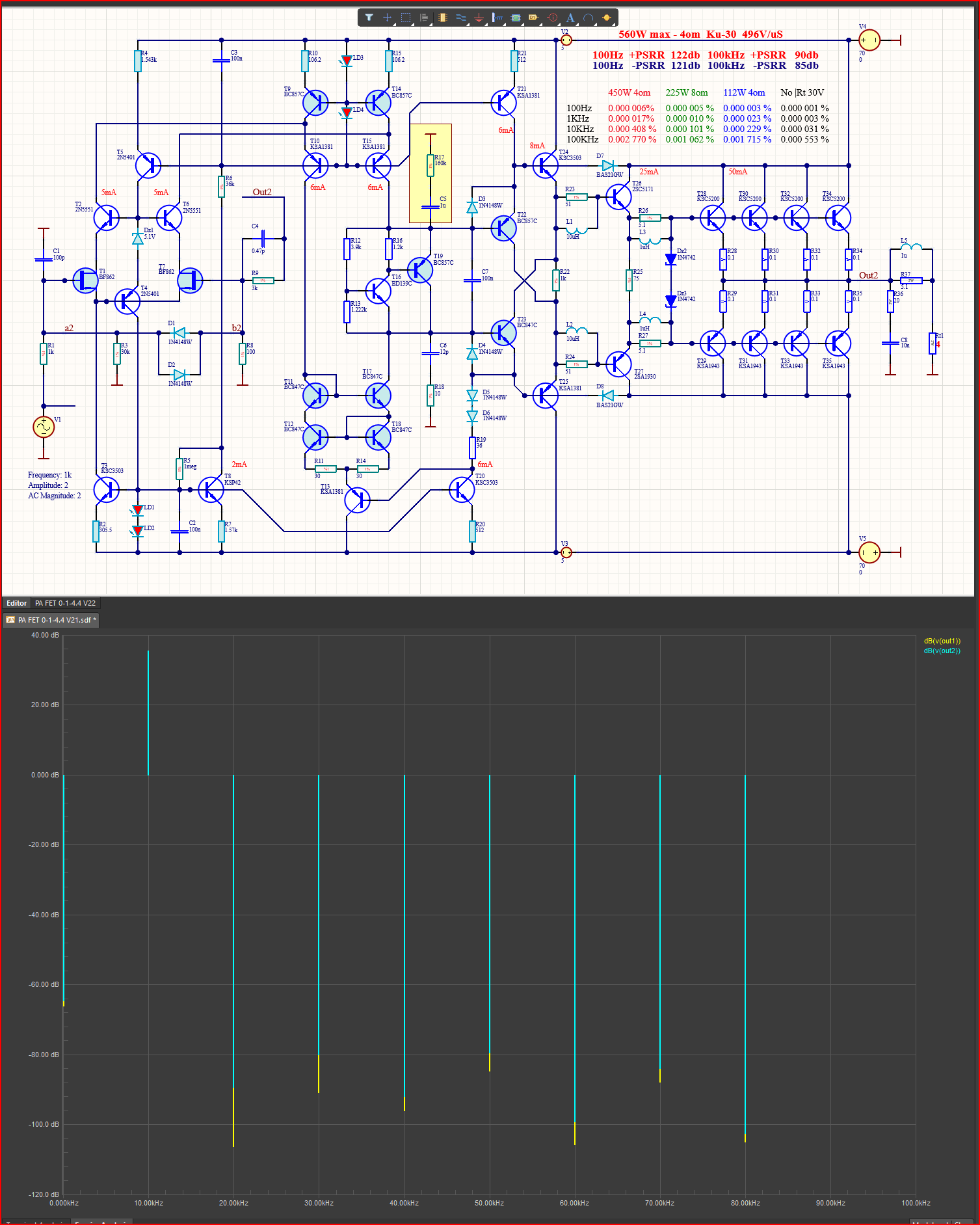

Here are your Speed Distortions without any amplifiers and without any feedback.
One RC circuit emulates a bandwidth amplifier, 1MHZ (1k/160pF)
The other RC circuit mimics a bandwidth amplifier, 10MHZ (1k/16pF)
The result is a misunderstanding of what an RC circuit with its phase shift (delay) is, and what a delay line is.
And here we are not talking about ignorance from an amateur, because from a person who does not know something, finds literature, reads it, understands it, and learns it.
Here the problem is already medical, the inability to understand and learn anything at all, and to simply memorize things and repeat them like a parrot.

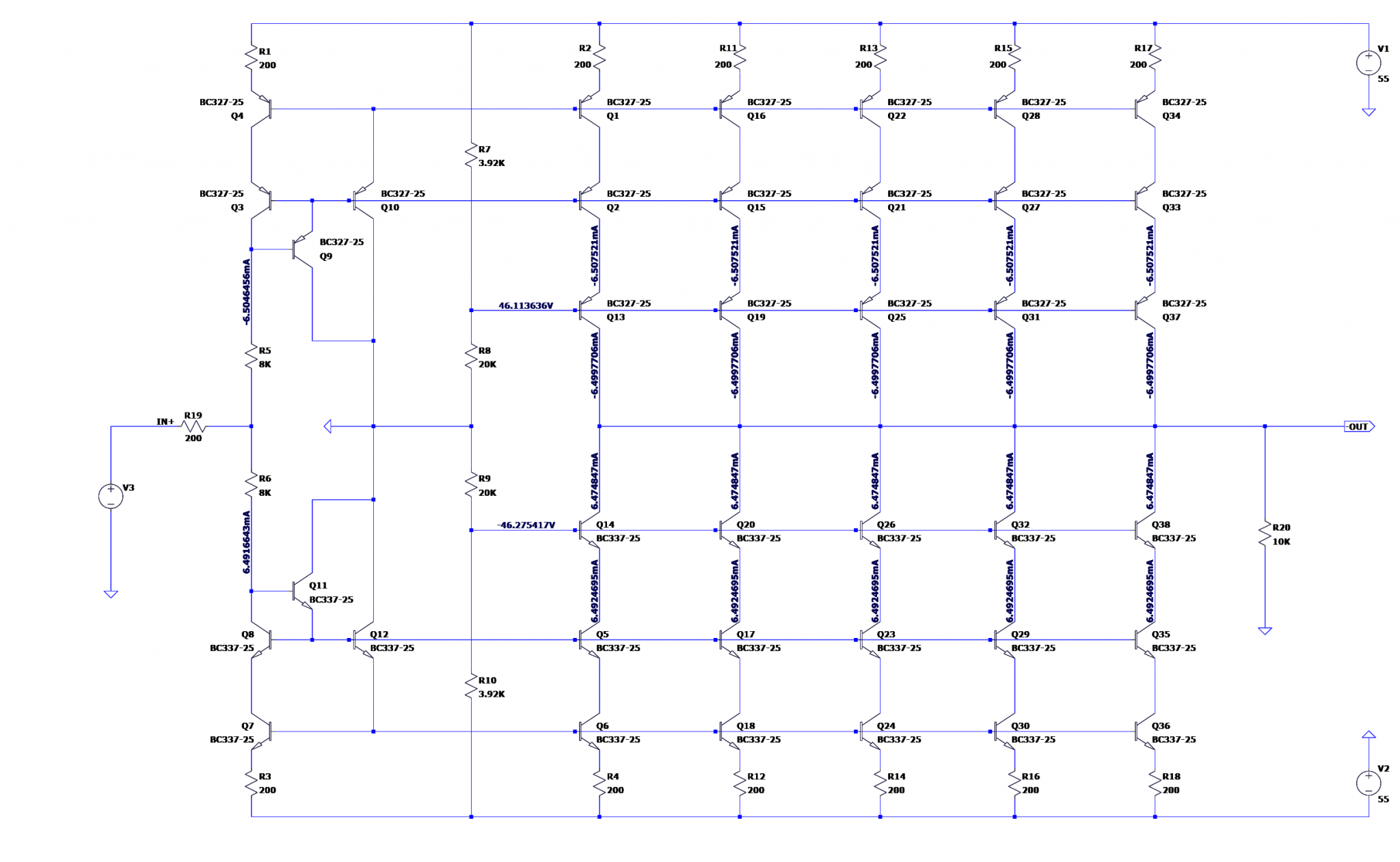

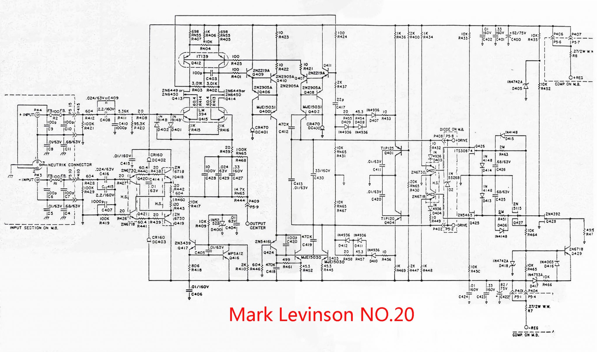

Why do you rely so much on Otala's works, but do not read the works that follow later? Bruno Putzeys in his interview also talked about TIM and his reasons, in addition, there is also a more voluminous article by him "The F-Word or, why there is no such thing as too much feedback". At a minimum, this is alarming selectivity. And I will tell you straight out, as I have always said, you use only those facts that are convenient for you and fit your theory, bypassing the rest like underwater reefs and pretending that they do not exist.From the very beginning, I drew your attention to the importance of the frequency of the first pole, which Matti Otala drew attention to 60 years ago, but for you this is nonsense, because in your truth he is just Talib.
Why did you decide that operational amplifiers are not suitable for audio applications? They are everywhere in audio equipment, including the highest quality, proving the opposite. I am now talking about really high-class professional equipment, and not about Hi-End, shrouded in a veil of esotericism and mysticism.Look at the circuit of the Harman Kardon HK-990 amplifier, its first pole is above 100 kHz, and in your circuits it is below 100 Hz, like in most operational amplifiers that were not designed for audio applications at all. Information for thought.
And here I apparently missed something during the discussion. Where did you show Rotel and what is the scheme there? It's not clear what it's all about...I cited as an example Rotel amplifiers made according to the simplest circuitry and they do not use output inductances that adversely affect sound quality, but for you this is another stupidity because it does not coincide with your "truth".
https://salonzvuka.by/novosti/bowers-wilkins-600-i-rotel-a11-poluchili-nagradu-eisa

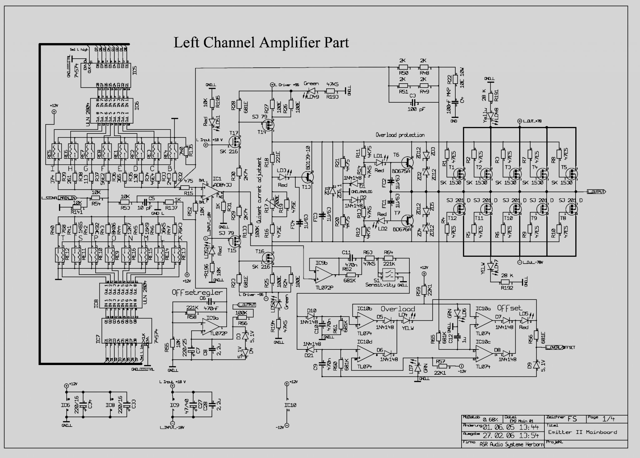

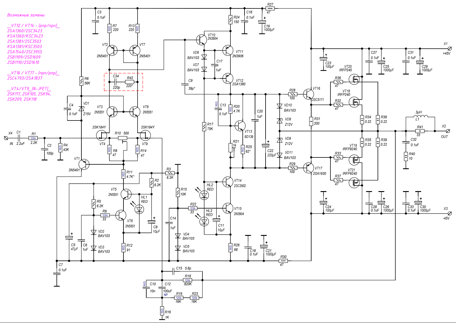

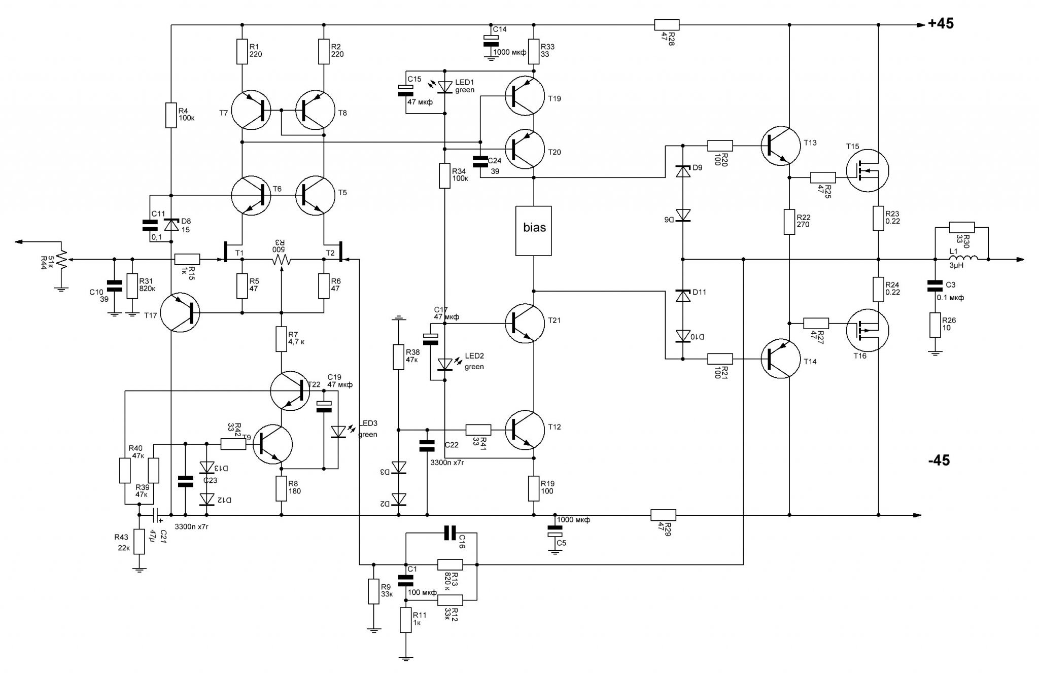

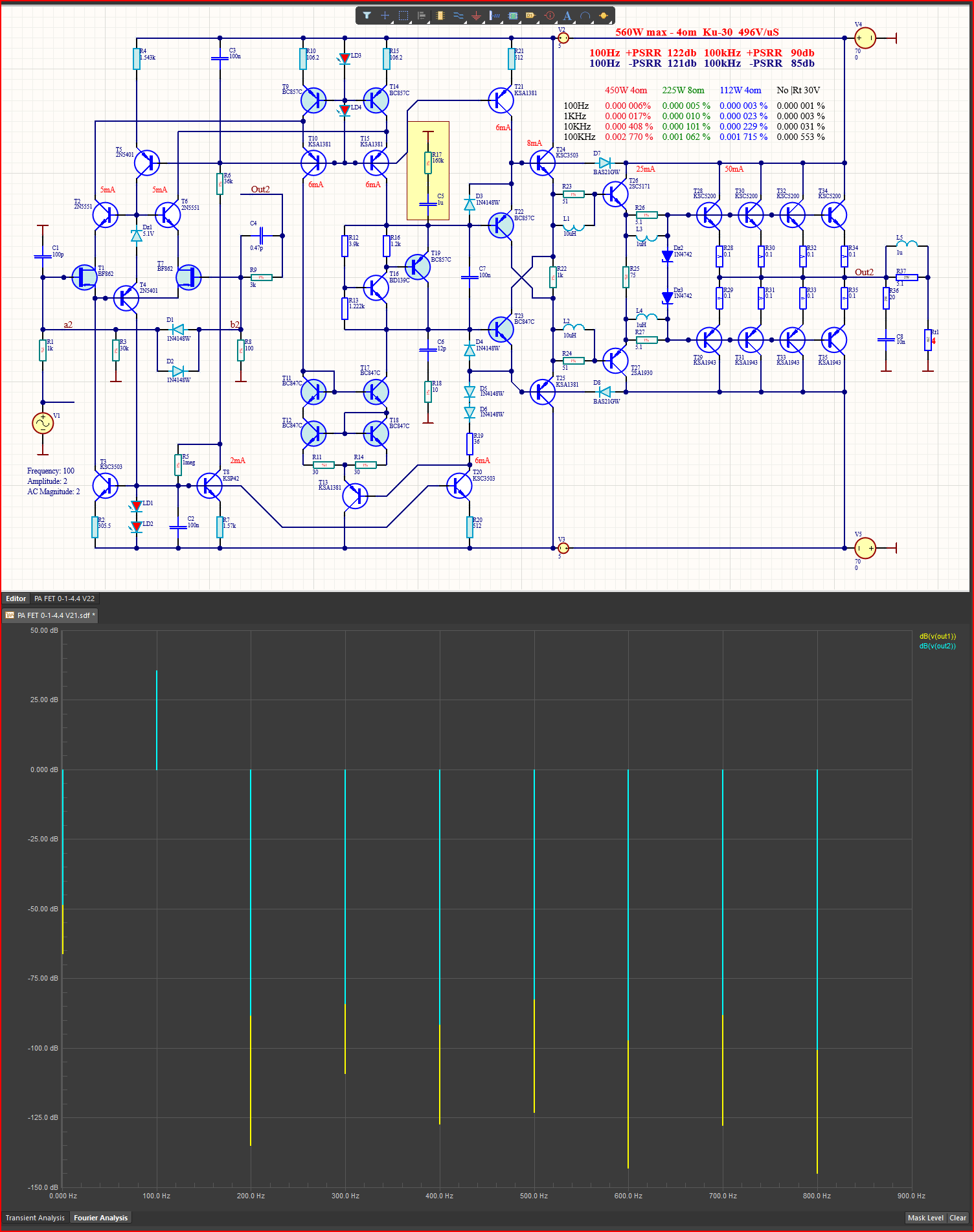

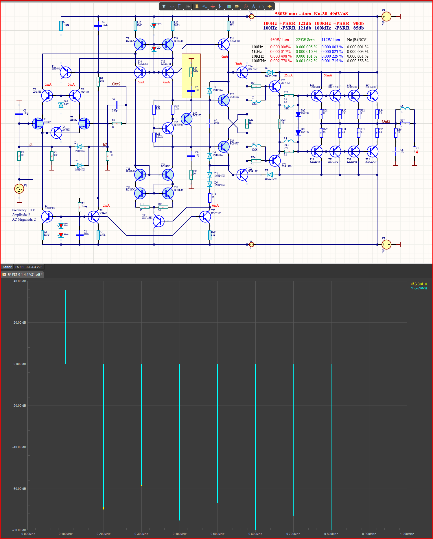

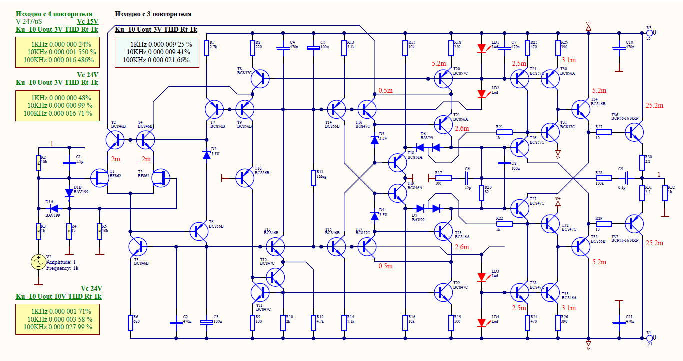

It's not just about displaying images, you have to say what exactly is optimized and by how much.
Putting in a lot of stuff just to make things worse is not optimization.

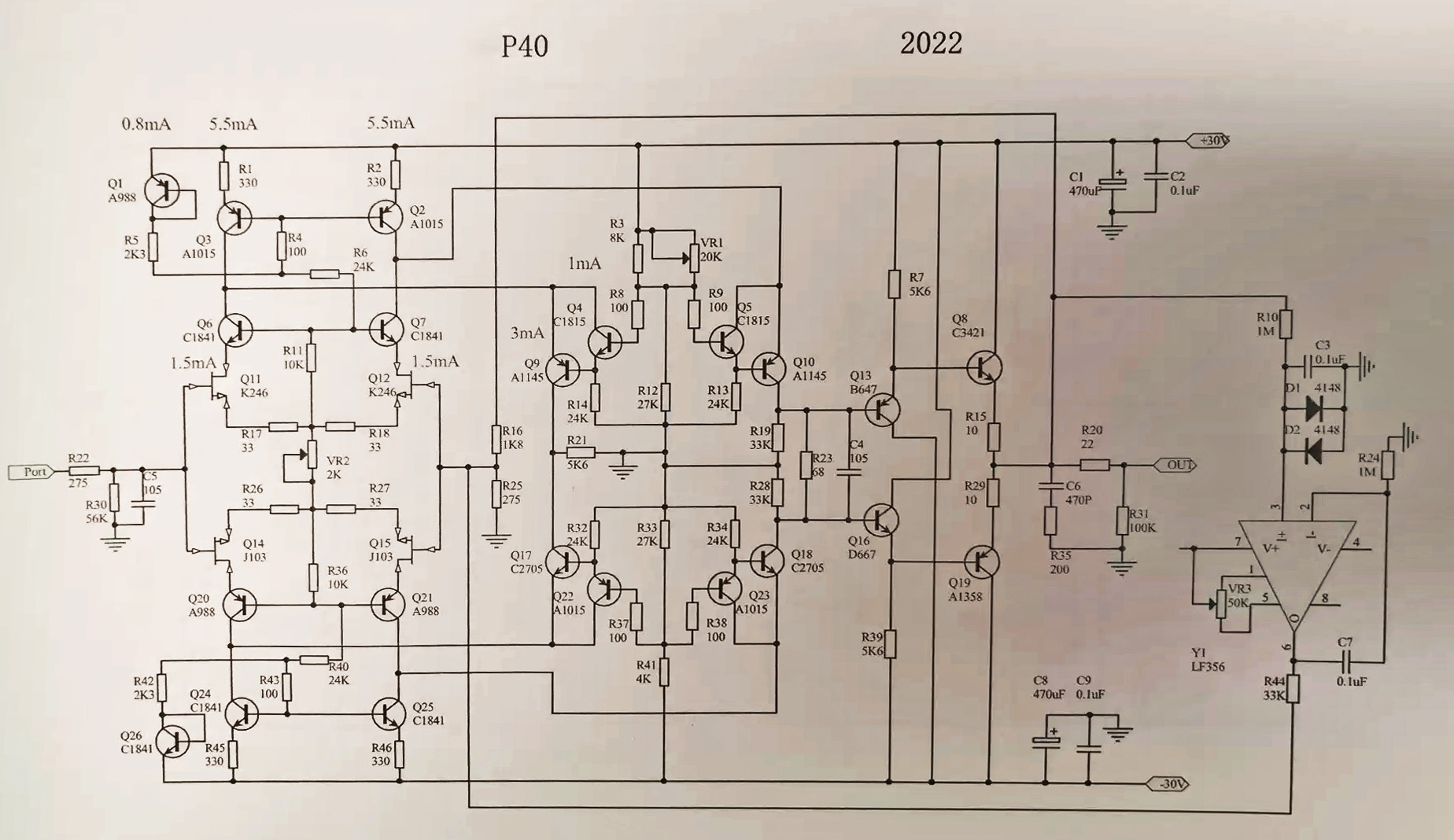

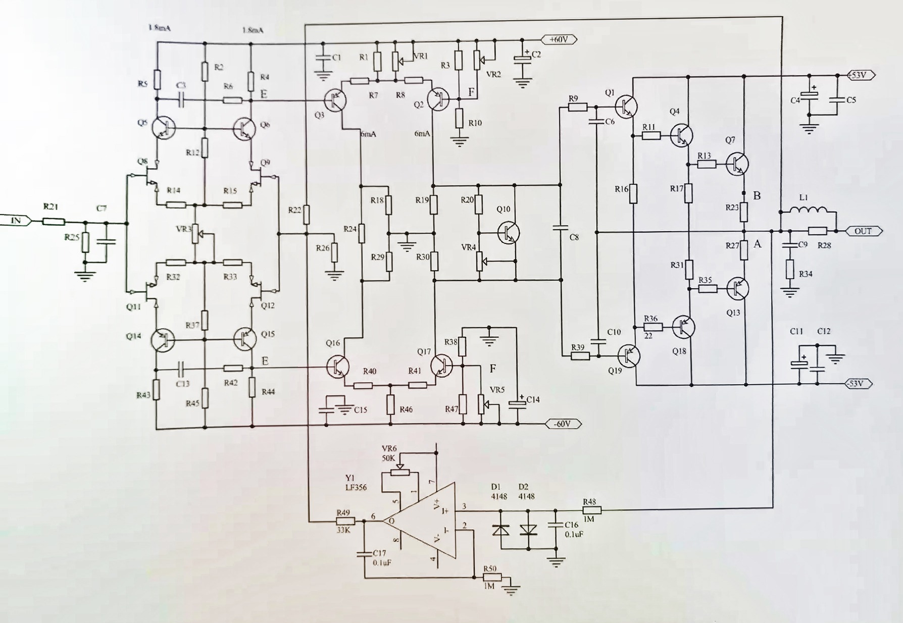

I am talking about schemes P40-2022, P41-2022. Their author does not understand much about electronics.
The WRJ-HT is relatively good, but it needs a makeover to make it better.
Is there any technical data about the THD, PSRR achieved with these schemes...??

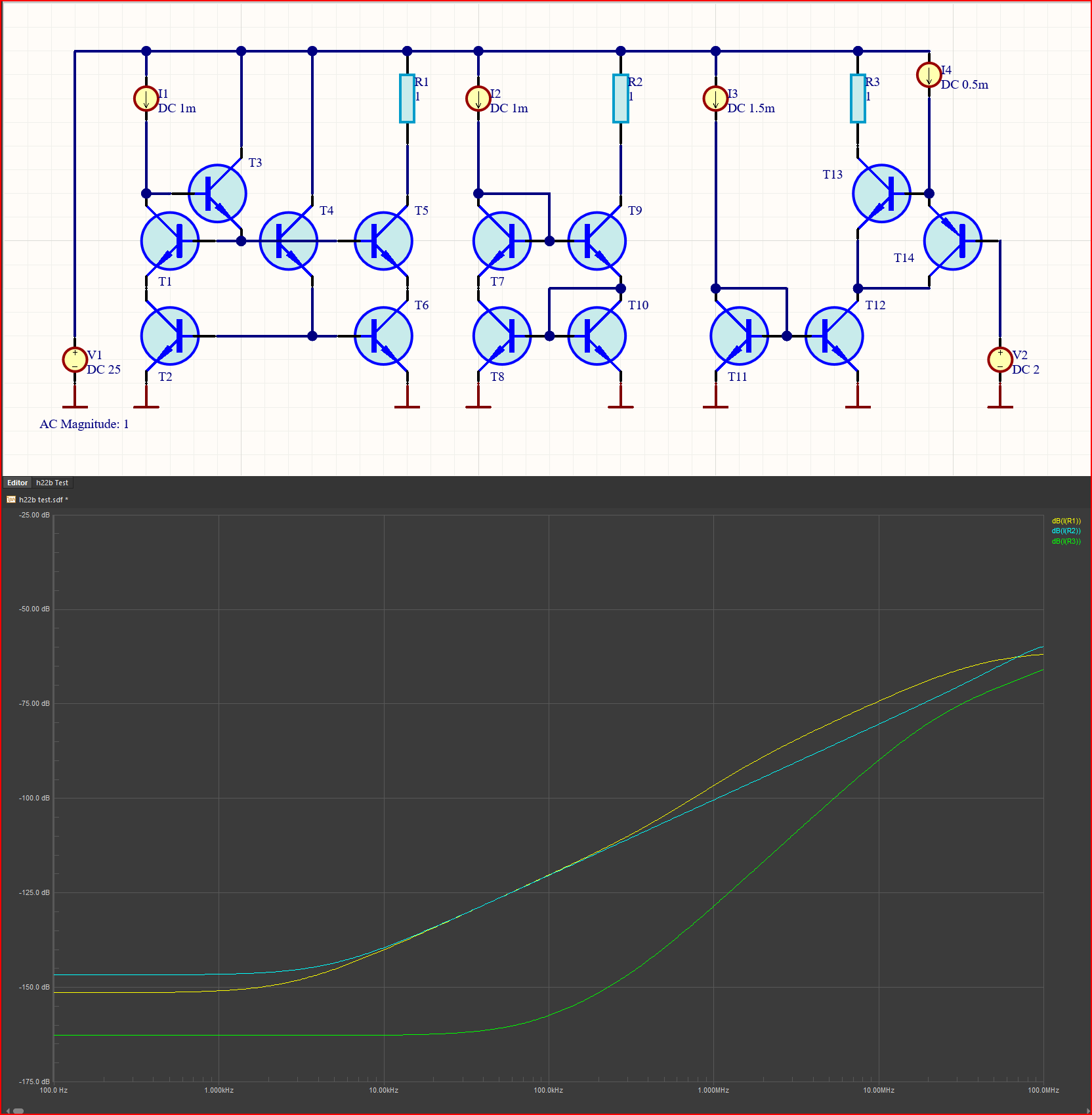

The OP-1000 Sandy 4EP uses the same h22b compensation methods, but they work correctly, unlike the WRH-HT.
And when you show the scheme, show what it can do and what its parameters are.
Here people are mostly amateurs and cannot judge how mediocre a scheme is.

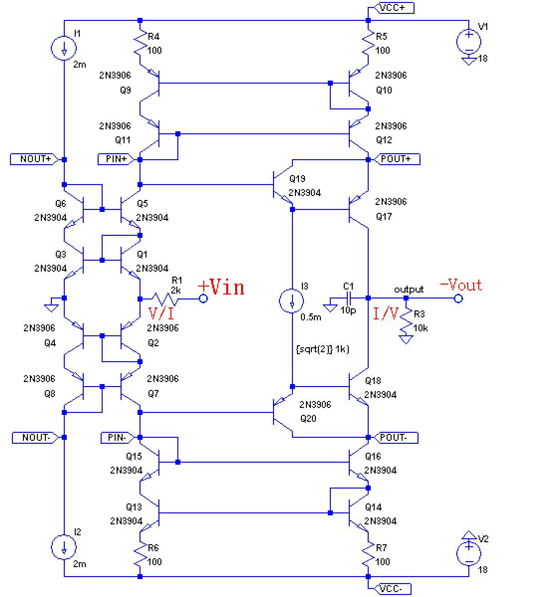

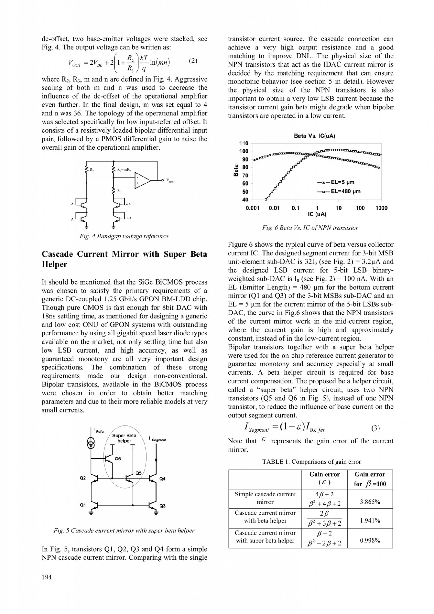

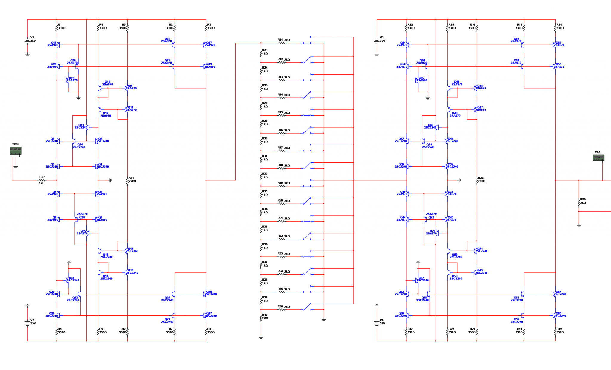

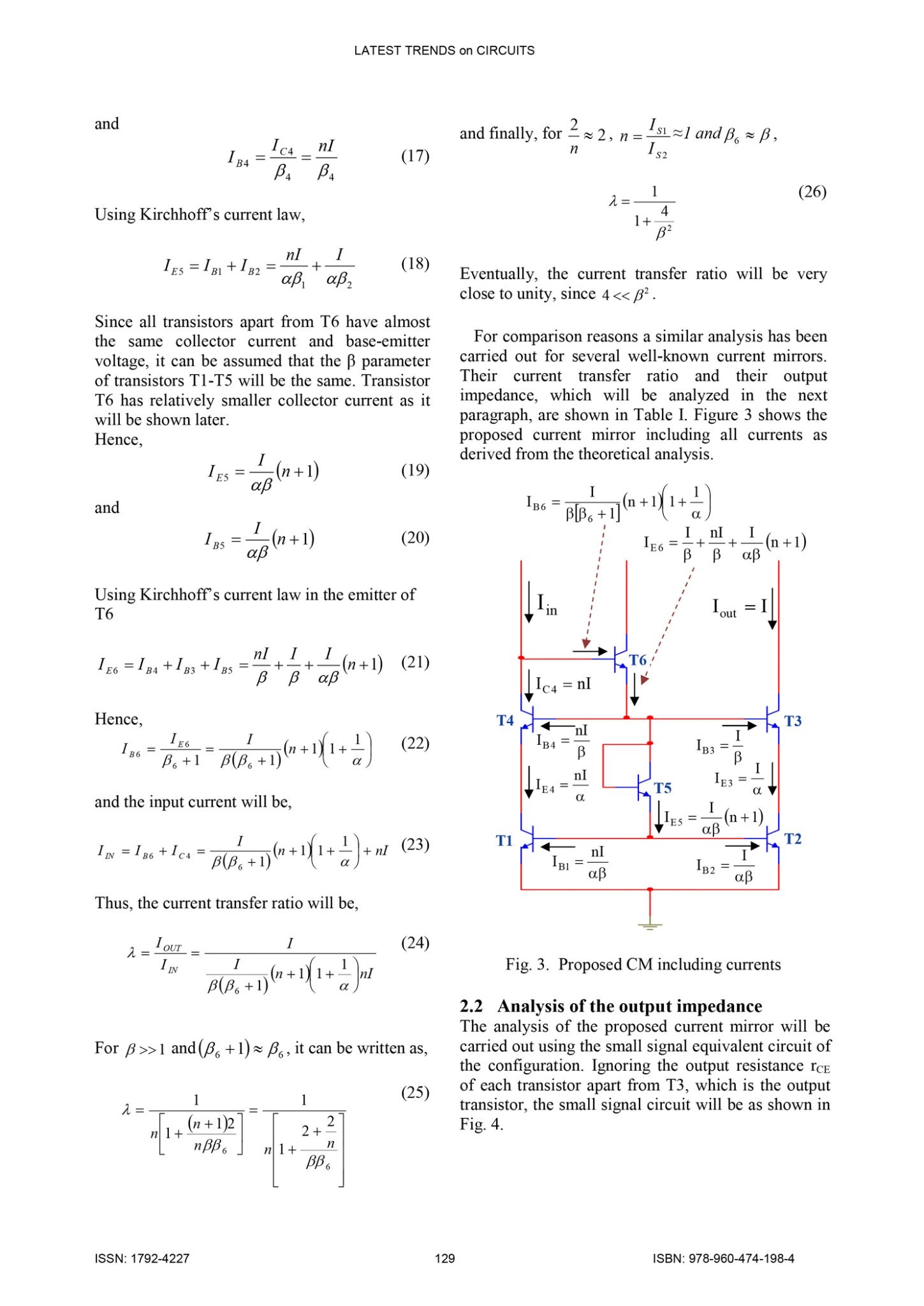

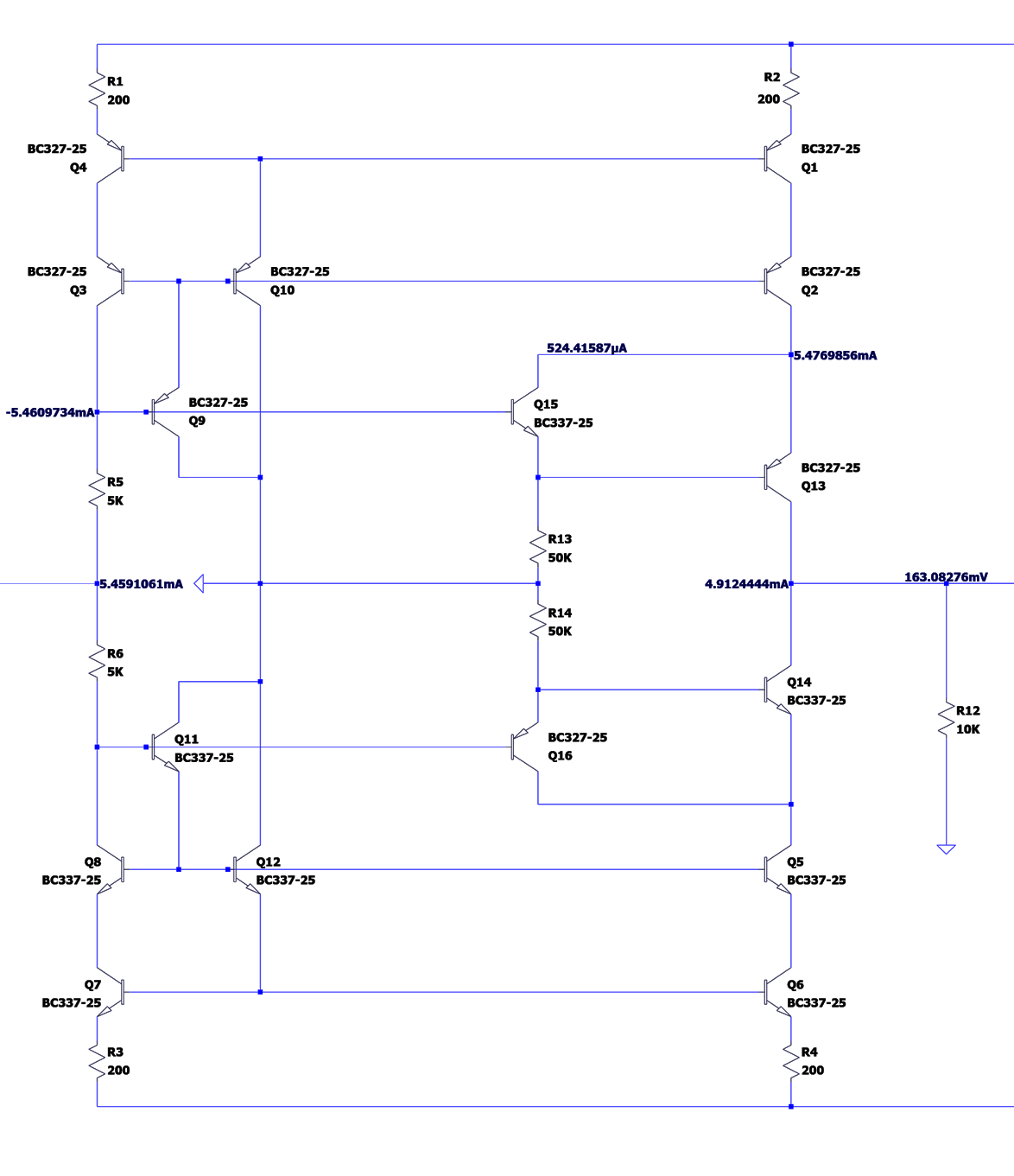

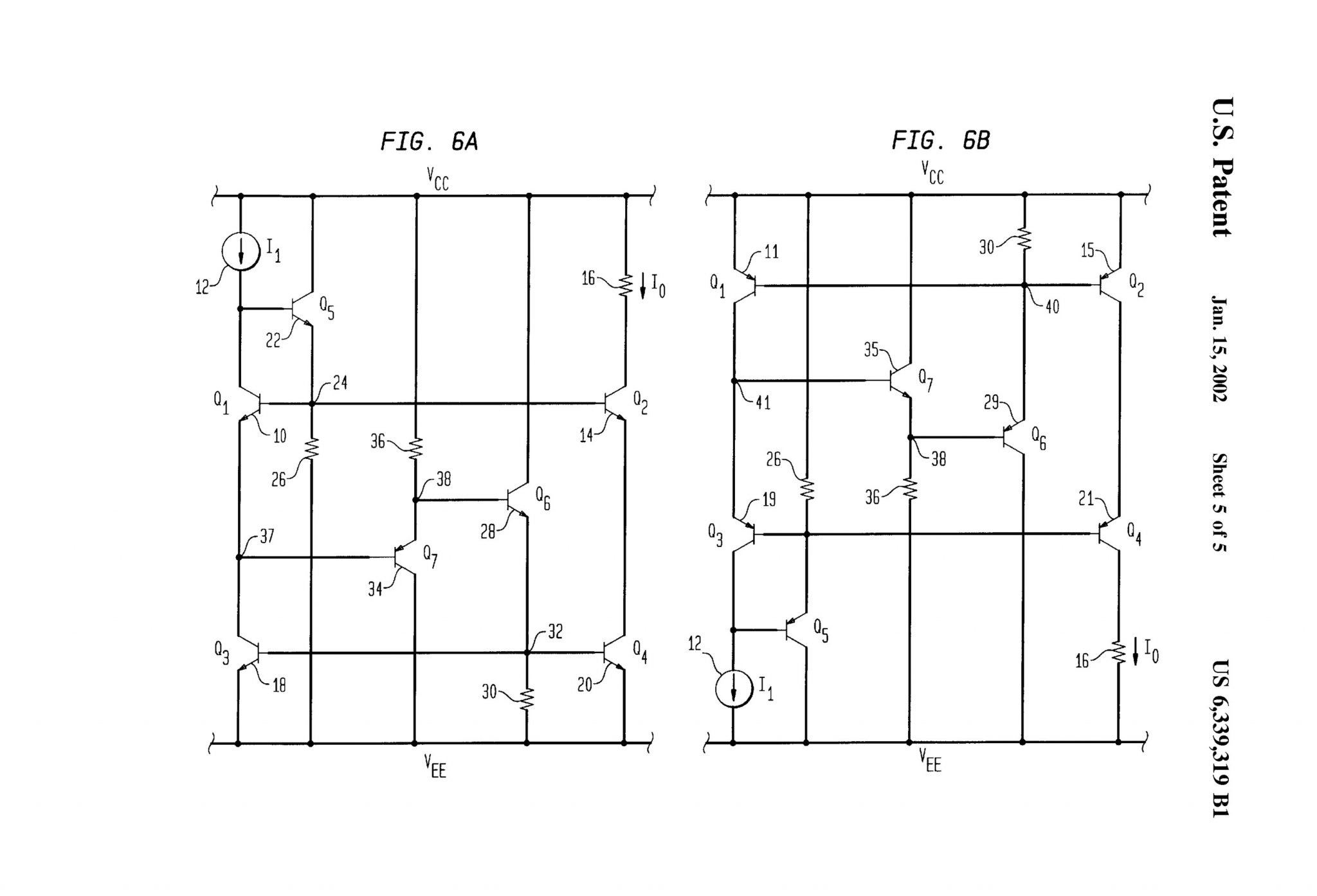

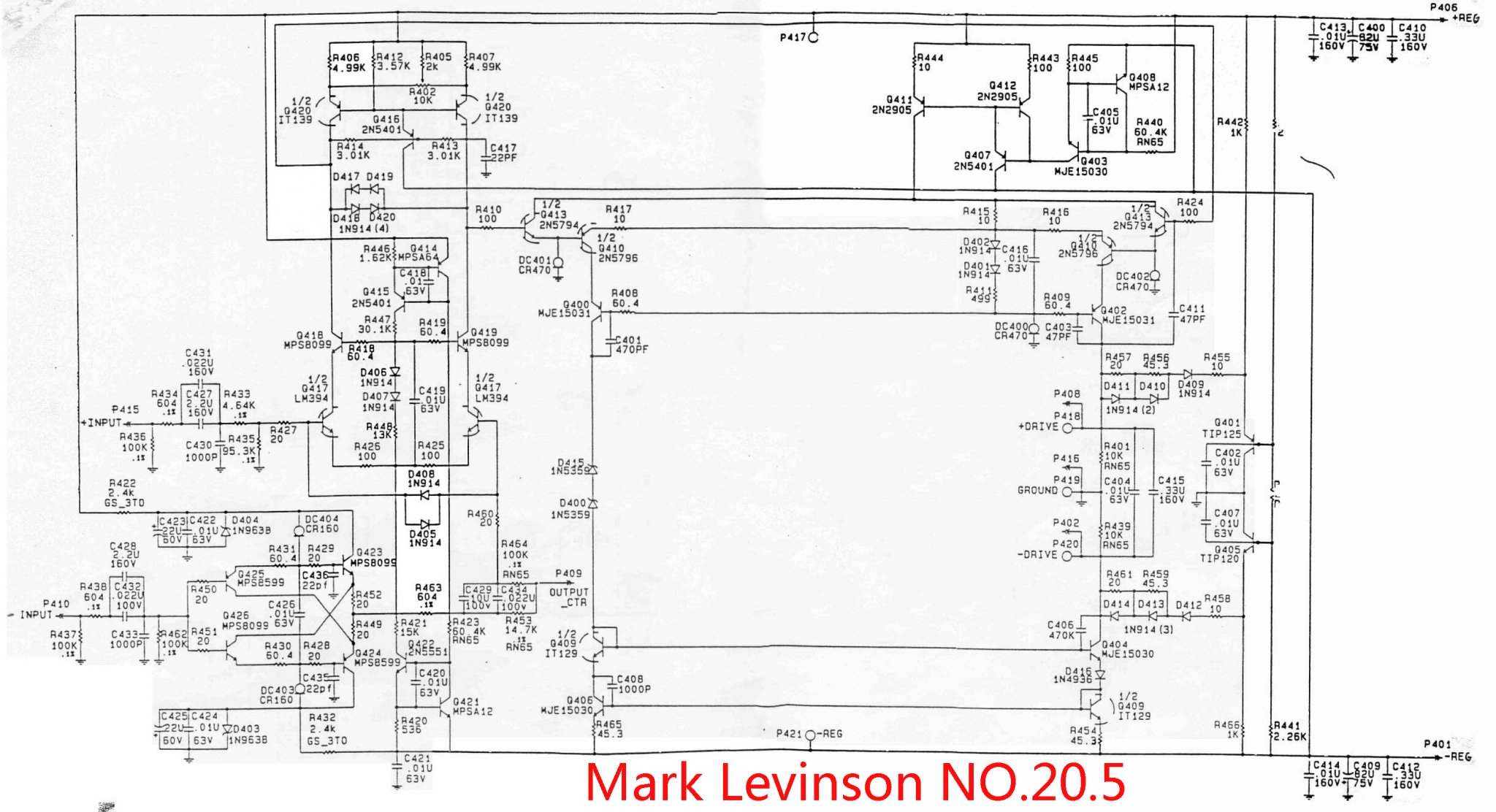

Cascode Current Mirror With Super Beta Helper

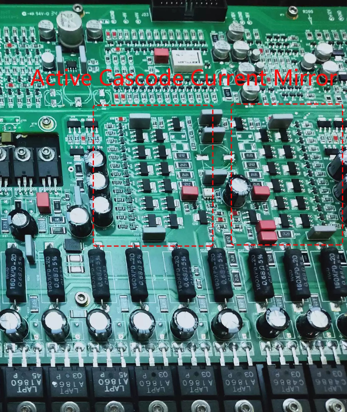

As I see, you have collected various complex schemes that you show here, but you yourself do not understand anything from them, and therefore there is no comment why you show them.
Accurate current mirrors are important for some applications but mostly for DC
But in Audio, this is not important at all!
It is much more important that the current mirror has high output impedance and low capacitance.
Because THD depends on non-linear capacitances. (varicaps)
All the schemes shown by you were made by people who do not understand electronics, but simply collected good ideas in one place, but in the worst way, which is why the result is mediocre.

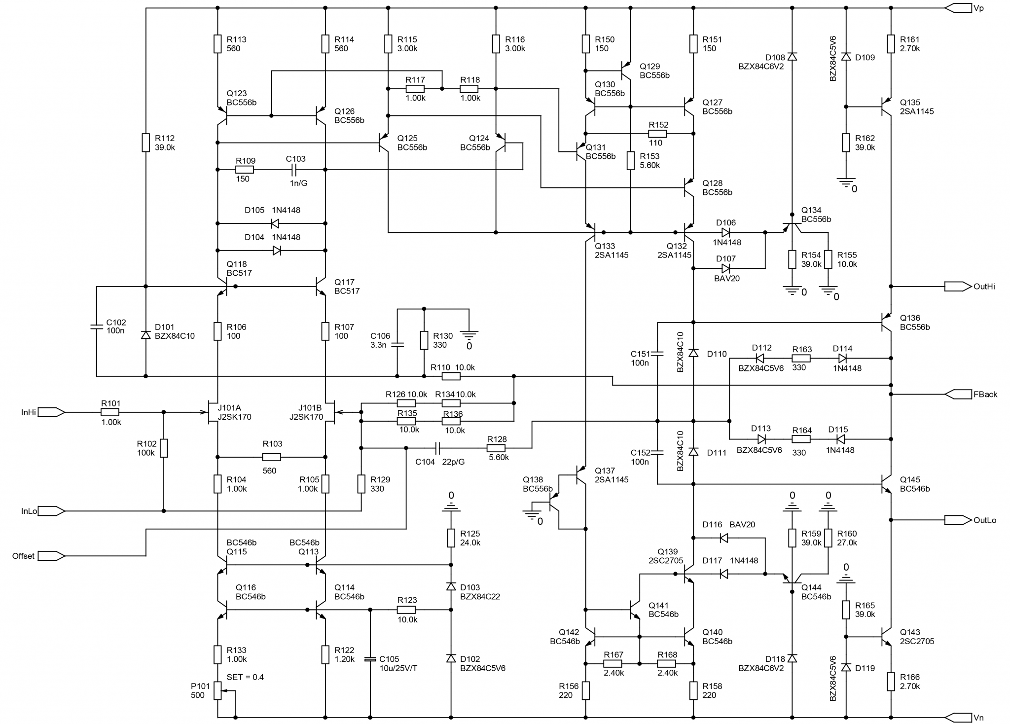

It looks optimistic, but perhaps I do not agree that this is a further optimization, rather it is a retrospective, because. I see solutions in the circuits that were relevant for electronics developers 20-30 years ago, but not now .... and if you look at it, it looks somewhat one-sided, i.e. only minimizing the error of the operating modes of the electronics cascades, this is beyond the sensitivity of an audiophile's hearing.Further Optimization of Circuit
The correlation of the subjective perception of sound and the topological decision of the audio amplifier requires a different approach, especially amplifier correction.
once in an interview, Den himself admitted that the latest developments Krell are inferior in terms of sound comfort to simpler audioamplifiers ...Then why does Krell use high-precision current mirror?

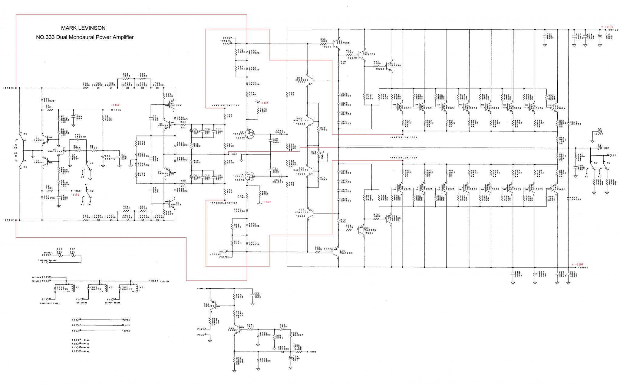

levinson mark,
From what you did not write, I understand that you yourself do not understand anything about electronics.
All the schemes you have shown here are examples of bad use of good ideas with mediocre results.
Uploading hundreds of different foreign schemes that everyone has seen without any comment or at least parameters of these schemes is pointless.

Here is such an I/V converter using the same TIS output circuit, but with 10 times better parameters than the one shown by you.
The input resistance of your I/V is 8.75 ohms and is non-linear, mine is 1 ohm and is a linear active resistance.
Yours uses current mirrors which still distort, although not much.
That's why I don't use current mirrors in my I/V
So if you can't show something new and meaningful, don't clutter the topic with banal nonsense.
