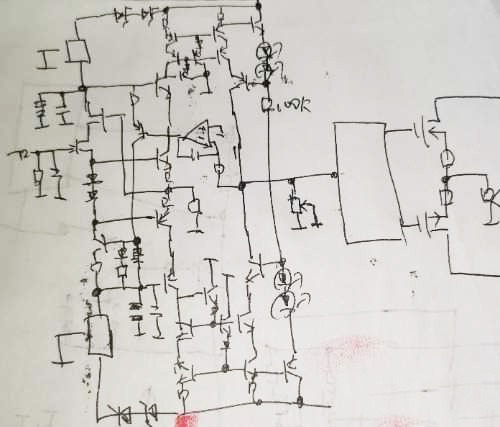

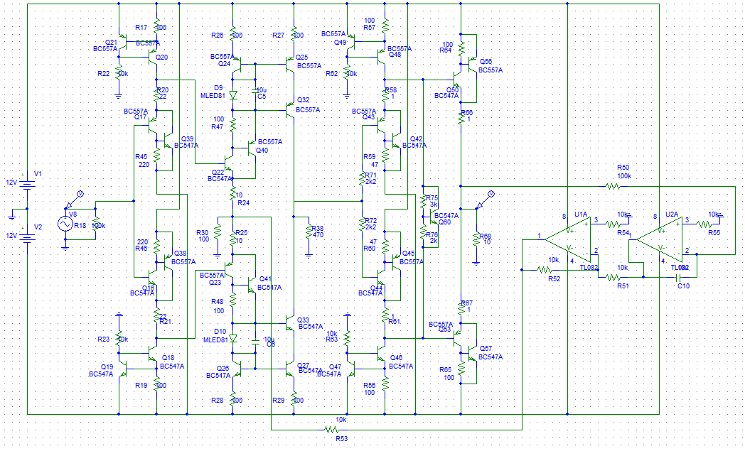

Here, in this topic raised by me, they are talking about completely different things, how to make things good from an engineering point of view, with better parameters.
An equal engineering challenge is how to make something maximally good and achieve it with a minimal amount of parts.
For me, a 1-2% improvement in some parameter but with 25-50% more parts is not an achievement, it's just plain stupid.
The schemes you have shown here fall into this category.
And there are those in which the complicating factor gives a significantly worse result than if it were not there.
But these things naturally cannot be understood by non-specialists who do not understand even the zaokan of Om.
If we are going to make a competition on stupid schematic solutions, I can upload here even more stupid ones than the ones you show.

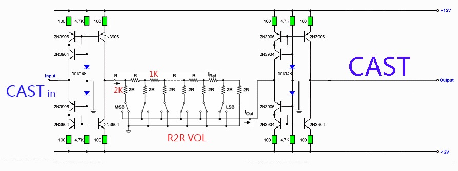

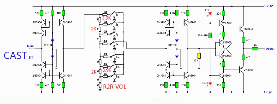

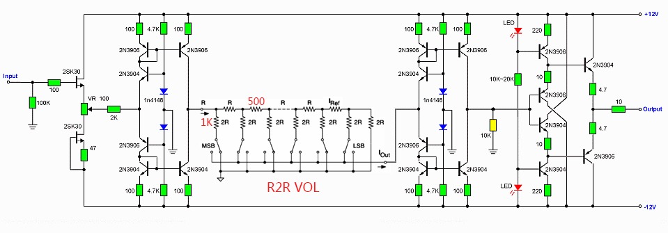

circuits of the level of "transistor acrobatics".The schemes you have shown here fall into this category.
one Miller correction capacitor nullifies the "grape clusters of the transistor vineyard" ...
none of what was shown impressed me at all, and I want to ask: why is all this? where is the sound quality?

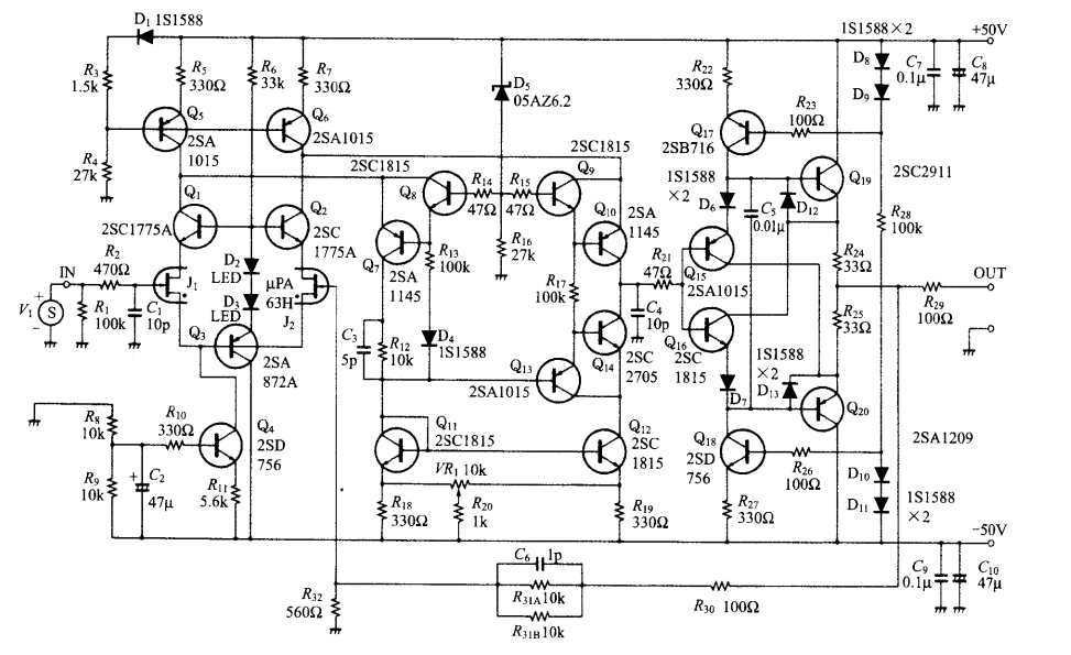

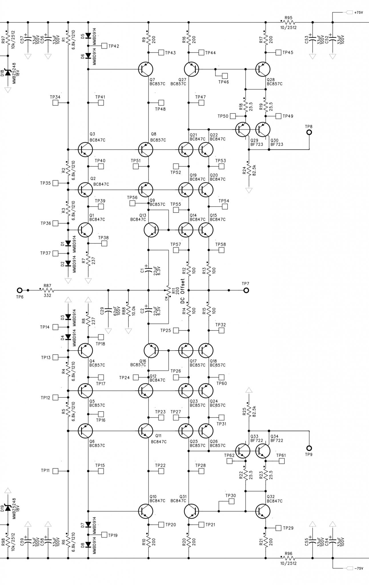

At first I thought it was a computer 1976 года...this is fundaMental thread .. 😀
Yes, in 1976 there were still smart people in the west who knew about electronics.
And from which we learned.
Bob Pease, Jiri Dostal, Bob Widlar, ...... !!
Today there are no people who even understand what they wrote!

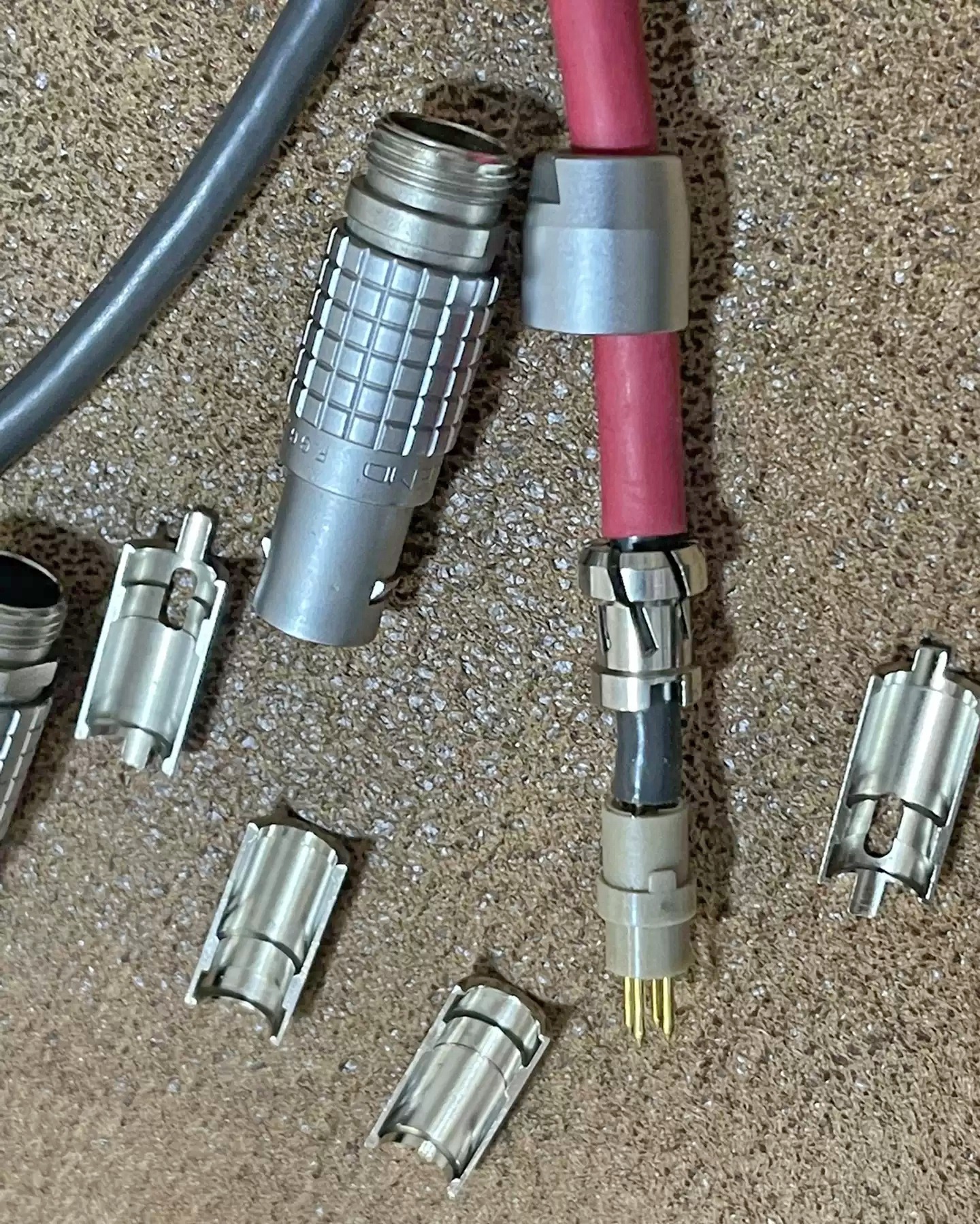

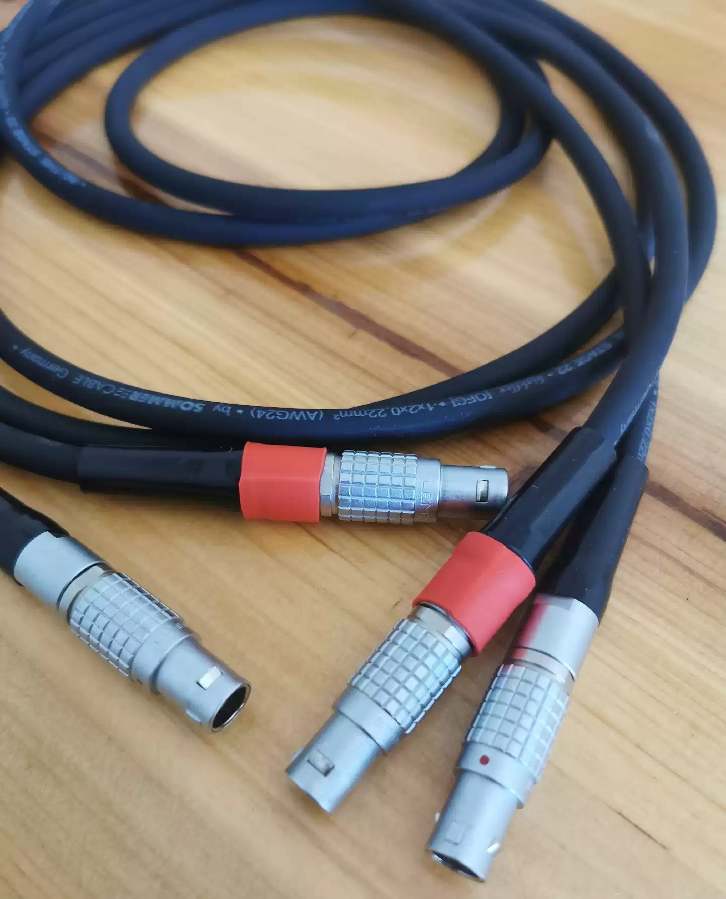

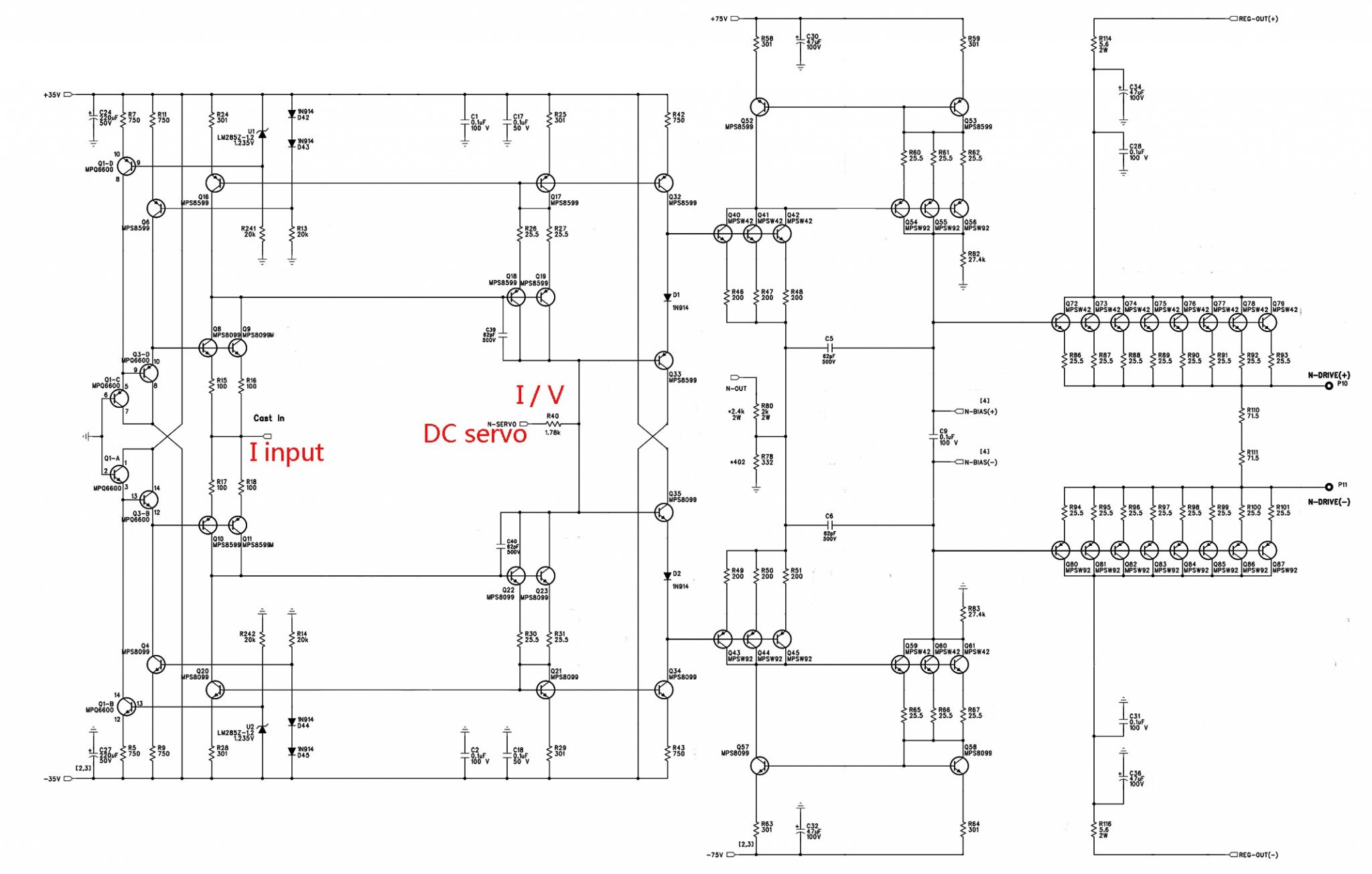

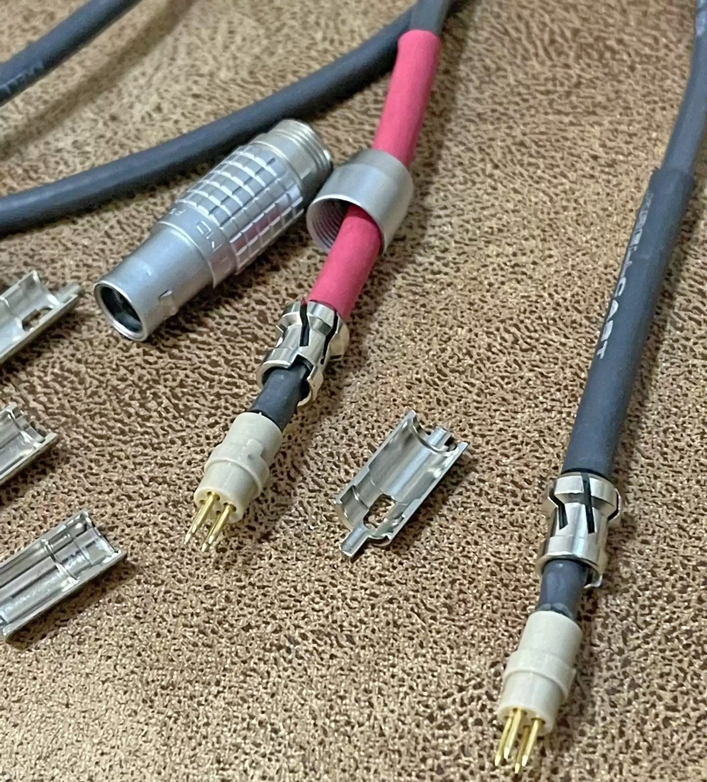

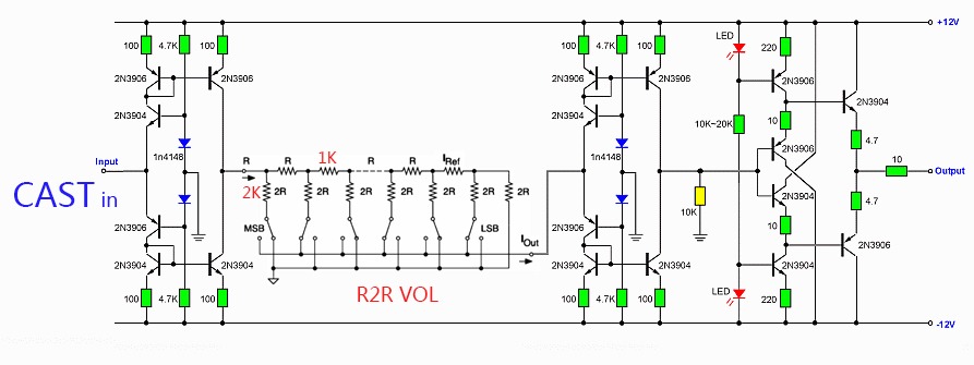

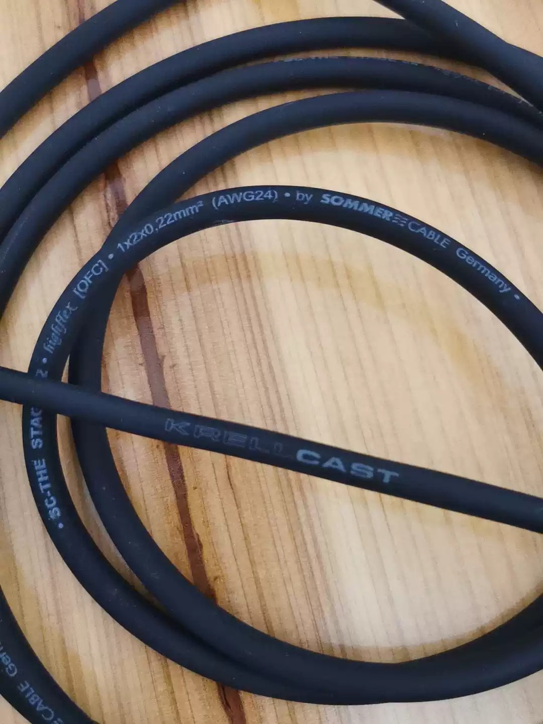

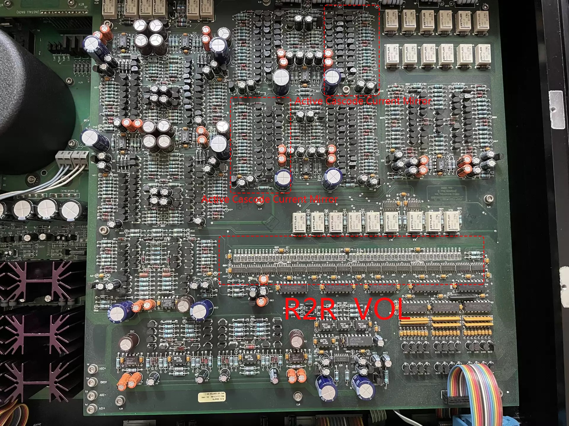

https://sound.zp.ua/brends/krell/cast.htm
Кабели межблочные CAST (Current Audio Signal Transmission) - это запатентованная технология

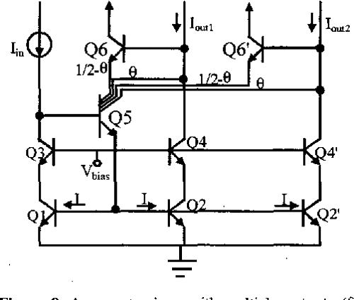

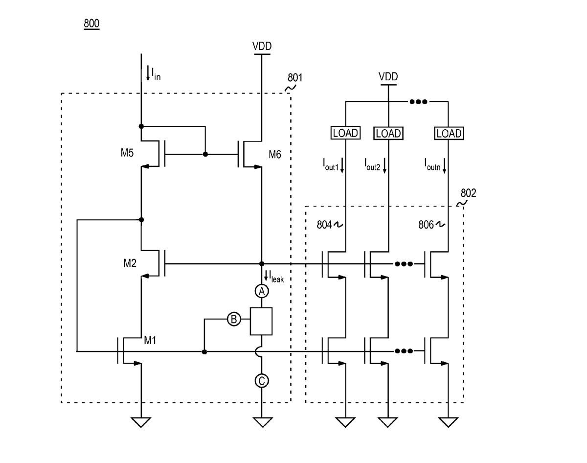

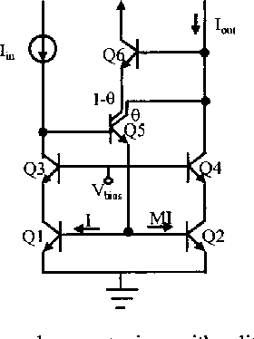

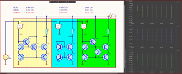

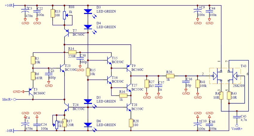

Current mirror research.
levinson mark,

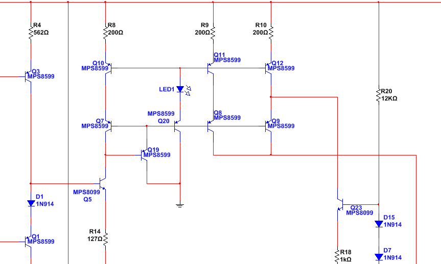

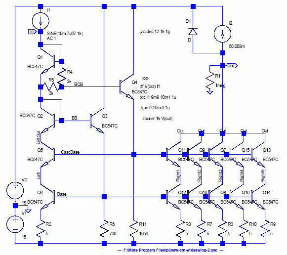

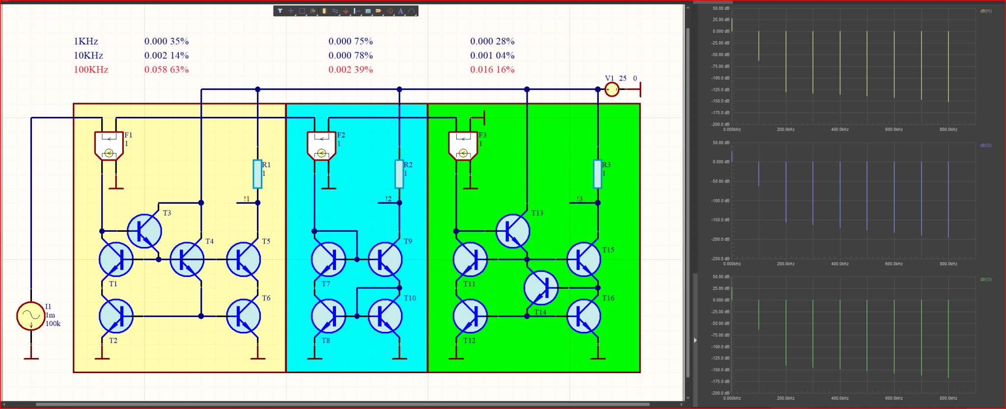

When people lacking analytical thinking try to copy circuit solutions from integrated circuits, the result is usually deplorable.
More parts for worse results.
The problem is that the public accepts such people as specialists.

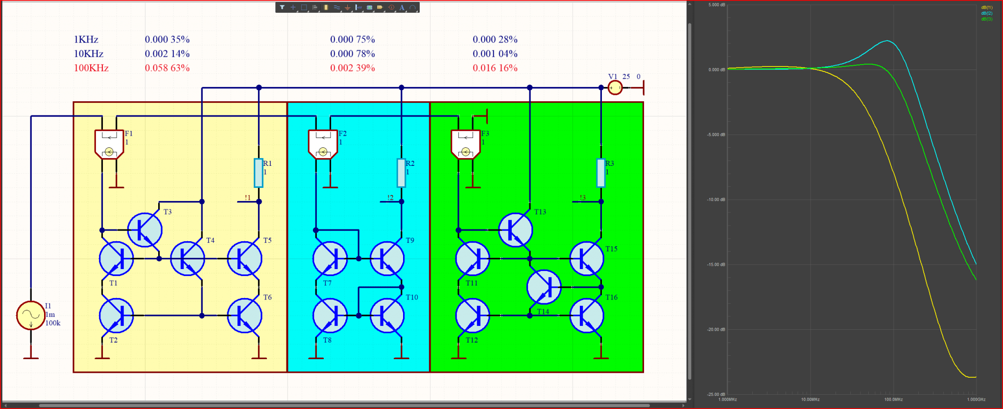

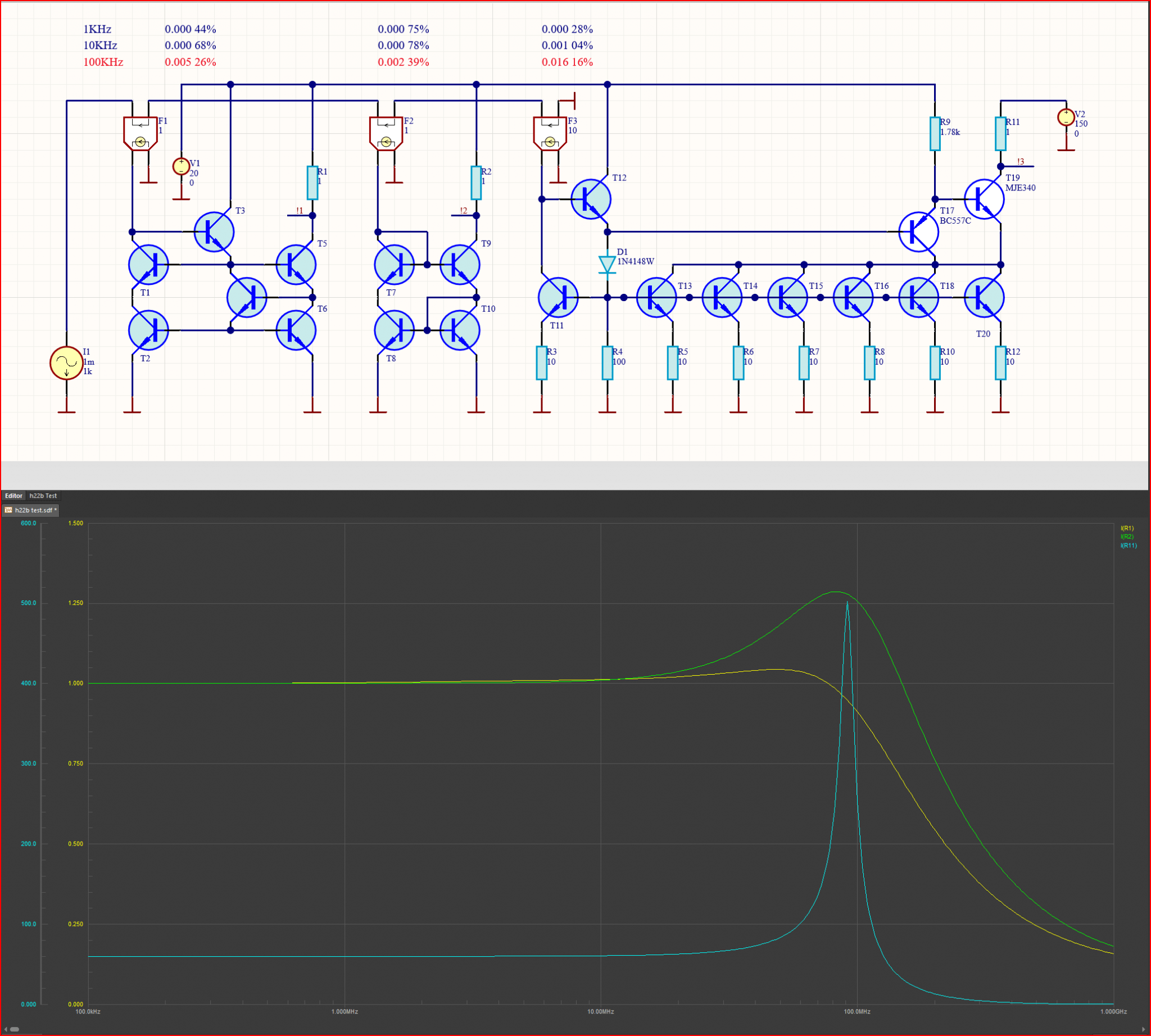

The current mirror on the right (green) is even more accurate when it comes to DC and has a much wider bandwidth.
But when it comes to THD and bandwidth, nothing beats the Wilson Current Mirror.
And with 50% fewer transistors.
And before a person engages in something stupider, he just needs to spend 10 minutes and see the difference in at least one simulator.
But of course this is not within the power of people who do not have some basic minimum of technical knowledge.
2-2.5 times the high THD of the low frequencies will be easily reduced by the feedback because it is deeper there.
But already at 10KHz things are already reversed and at 100KHz the difference is 24 times in favor of the Wilson Current Mirror

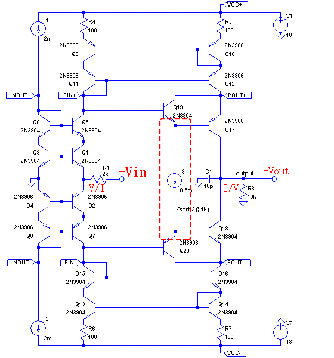

Levinson Mark,
It's best to find a hobby that doesn't require thinking.
It's a little better without the RC but it's still infinitely worse.
Wilson's 28% gain is at a frequency that the output repeaters would cut, so it's not a problem at all.
And there, at the output of the VAS, there is usually a capacity for frequency correction.
But how can a person with superficial knowledge and devoid of logical thinking understand these things.

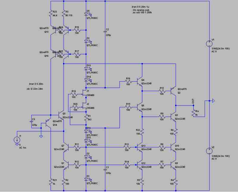

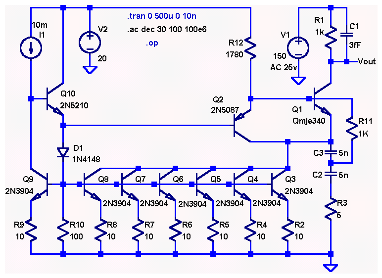

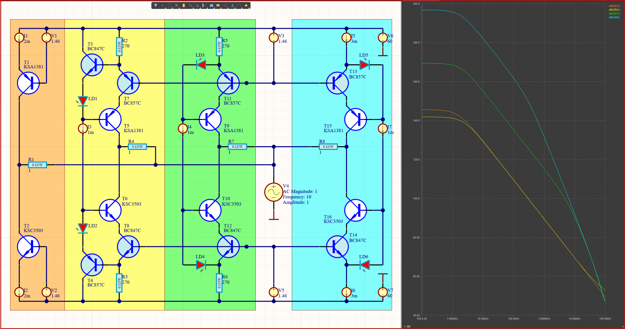

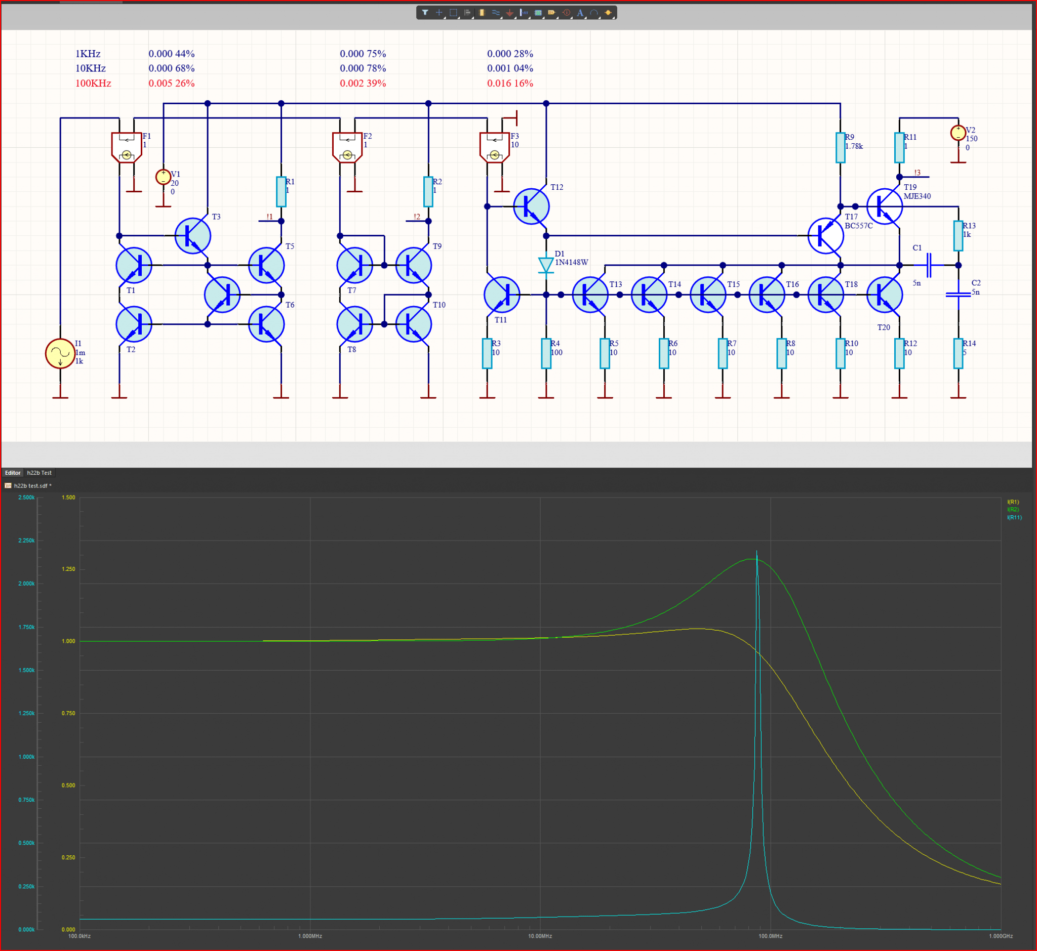

Mark Levinson,
If they gave out Oscars for how to achieve the maximum bad result with the maximum number of transistors, you'd win it.
The yellow is your VAS ideas, is it worth 6 elements more, compared to the simplest common base scheme, for the minimal difference below 1KHz.
The graph shows the output impedance in Db relative to 1 ohm
145.6dB = 19MΩ
169.46dB = 297MΩ
196.77dB = 6.89GΩ
145.6dB = 19MΩ
169.46dB = 297MΩ
196.77dB = 6.89GΩ

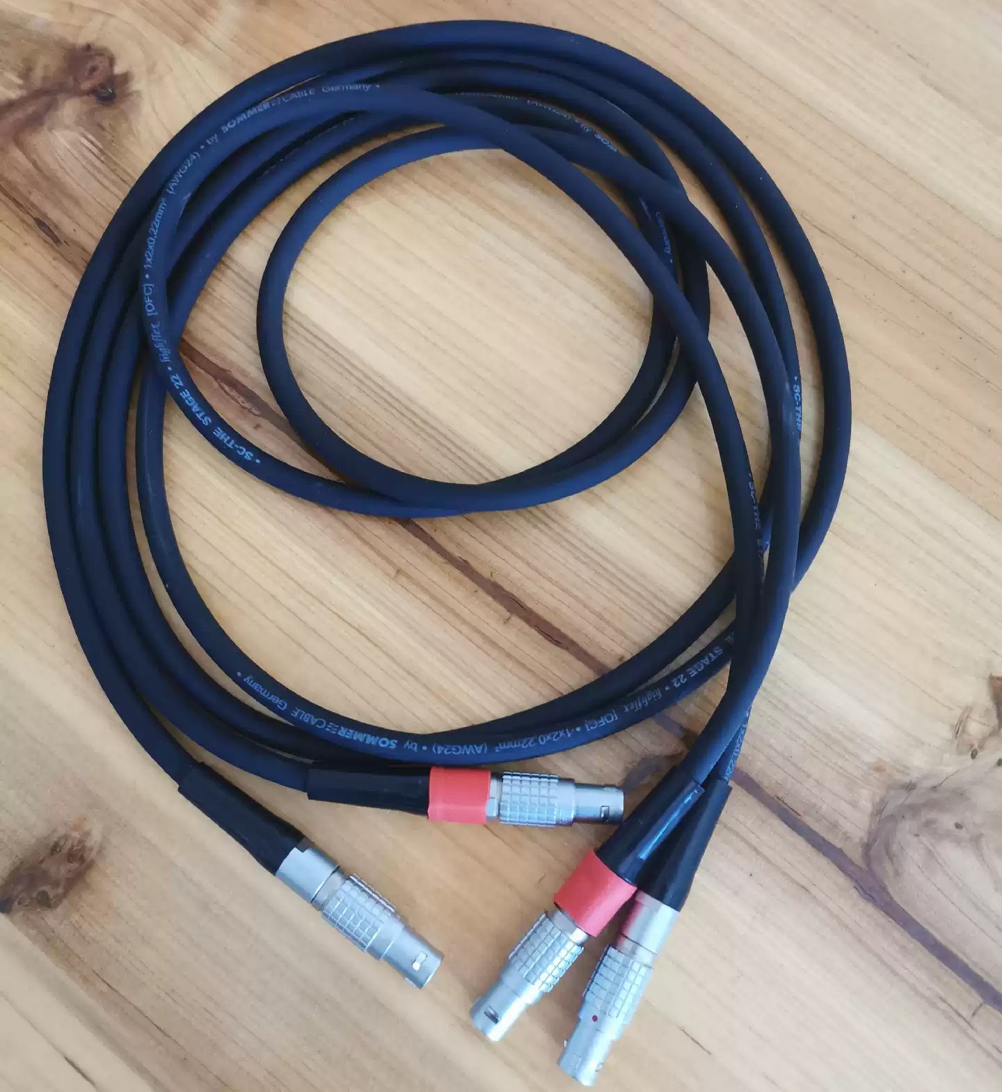

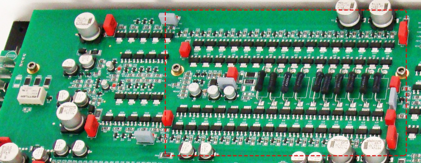

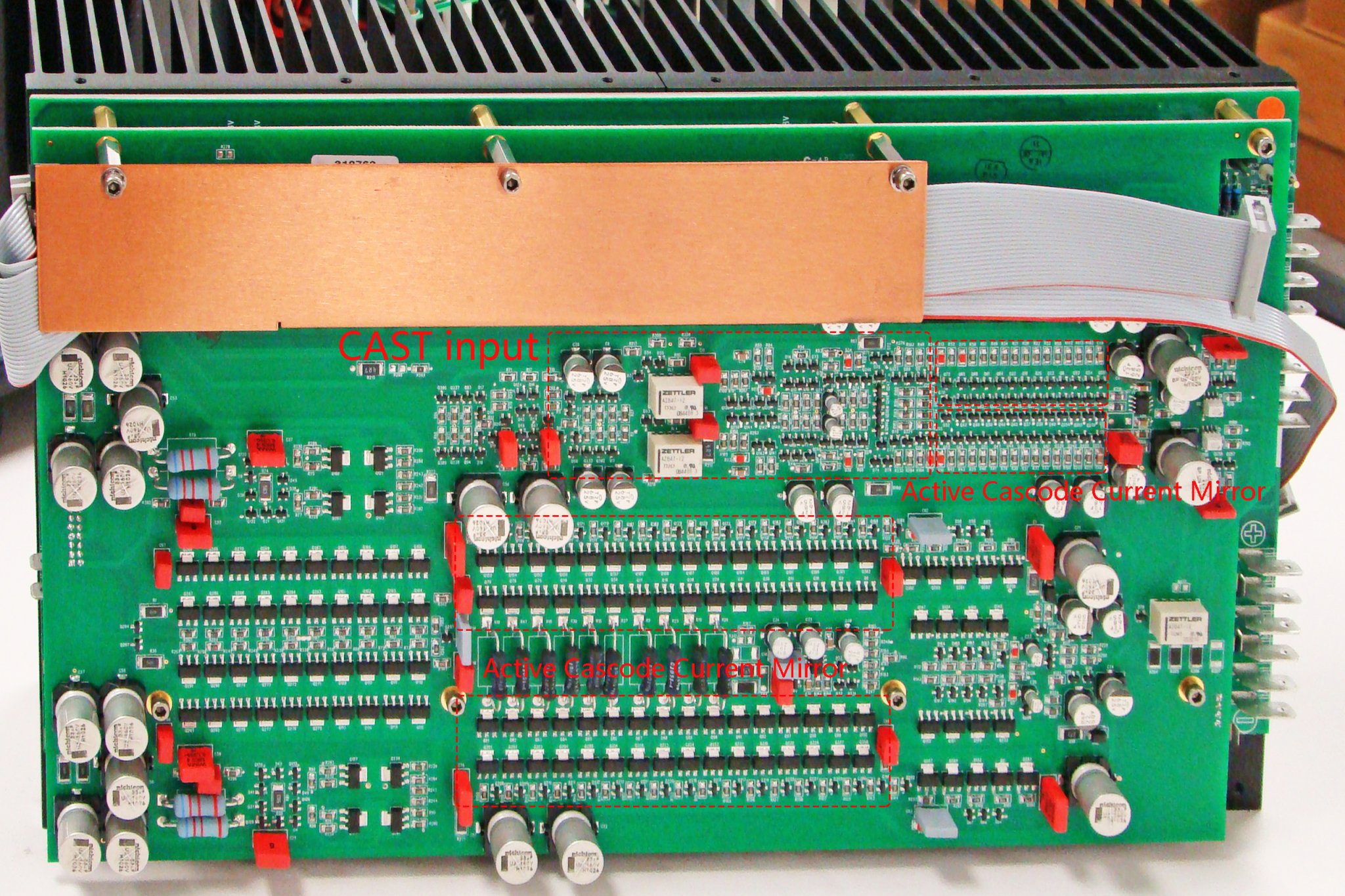

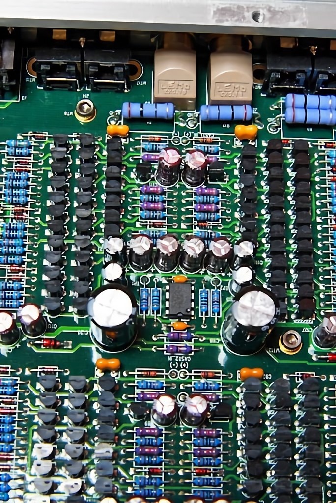

Sorry, you are not simulating the patented current mirror of Krell。Krell did not publish the complete circuit of its patented current mirror.
