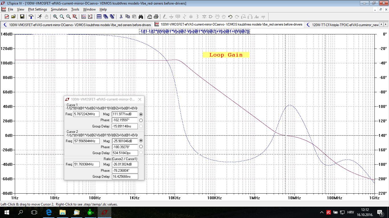

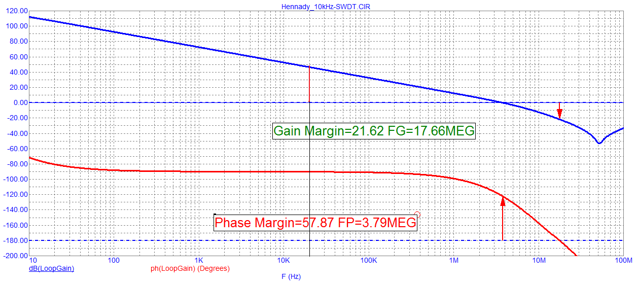

Is this enough loop gain at 20kHz?in fact, many have a different understanding of this very quality. The figure 60dB is not taken from the ceiling, with a single-stage topology, the maximum gain rarely exceeds 90dB, minus the gain of 24-26dB and 4-6dB of losses used for gain linearity, it remains just 60dB, This value can be less if the gain is linear in the audio frequency band up to negative feedback coverage.
With a two-stage topology, it is theoretically possible to obtain a gain of 180 dB, but in fact, it is very difficult to obtain a gain of more than 110 dB without lowering the pole, because the unity gain frequency is already striving to jump beyond the frequency of 10 MHz, i.e. limit of the technological possibility of the radio amateur level.
also with increasing gain, it is necessary to correct with circuits of higher orders, for the first order of correction, which I very often see in your models, you can forget - its problem at a certain depth at a frequency of 20kHz, at which the pole cannot be higher than 20kHz, or it will be an amplifier with very low gain (45-55db) to negative feedback coverage.
super high quality - this is a negative feedback depth of at least 90db at a frequency of 20kHz. Will there be a high quality amplifier with 70dB negative feedback at 20kHz? yes, it will.
Hennady, I have to upset you, here are the distortions introduced by such an amplifier at a frequency of 10 kHzWill there be a high quality amplifier with 70dB negative feedback at 20kHz? yes, it will.
I think you do not read my posts or are not able to understand the meaning, since you do not see the difference between the accuracy of the calculation and a fundamental error in the presentation of the material and the derivation of formulas. I will refuse your offer to do calculations, because it will not lead to any result anyway, except for the useless waste of my time. In total, I will not tell you anything more on this issue, do as you see fit, and other participants will see my information and will be able to evaluate it themselves.fagos, well, calculate with cosmic accuracy according to the refined formulas what it (tPD) should be (262)
Regarding the composite amplifier by Yewen - where the input function breaks - there are your mythical "speed distortions". Nothing new, you can just as well give a rectangular signal and use it to predict the sound quality "according to Petrov's criteria"
...and other participants will see my information and will be able to evaluate it themselves.

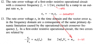

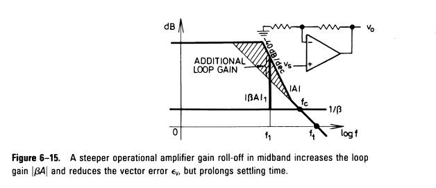

If you have seen your version of the formula in the book Jiri Dostal, then give the number of the formula or page, I did not find it.

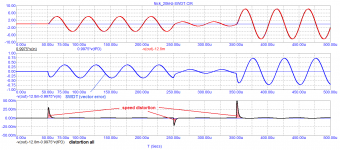

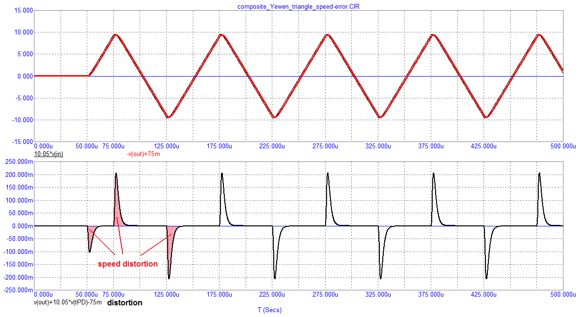

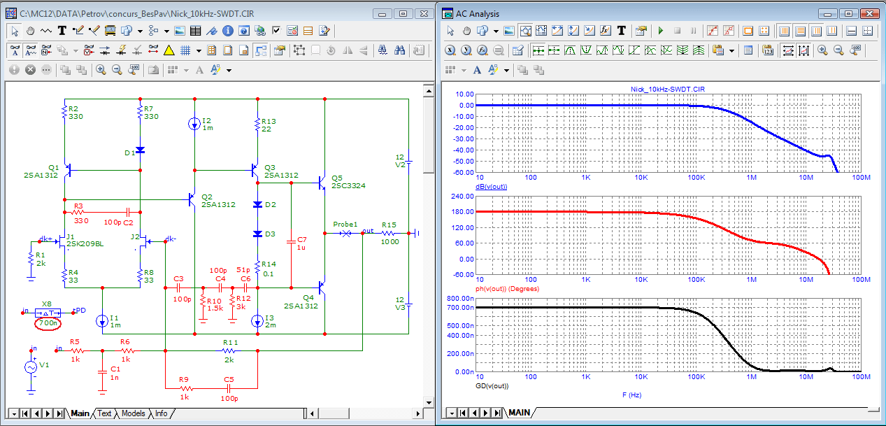

As a separate question, I can cite a curious drawing from the book that I would like to show you and ask for a comment on this. As you understand, in the context of your theory, I got the statements in the caption to the drawing. Since the drawing is from the Russian-language version (fig.3), then for the English-speaking audience I bring in addition the same one from the English-language edition (fig.4).
I will explain why I ask the question - the vector error at the F1 frequency will decrease, but petr-2009 shows us on the contrary an increase in the vector error with an increase in the depth of feedback. Got's statements correspond to the classical theory, and petr_2009, referring to him, contradicts him. It turns out some kind of incident that requires resolution and clarification.

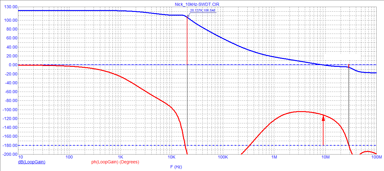

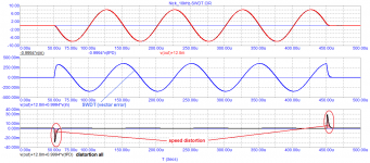

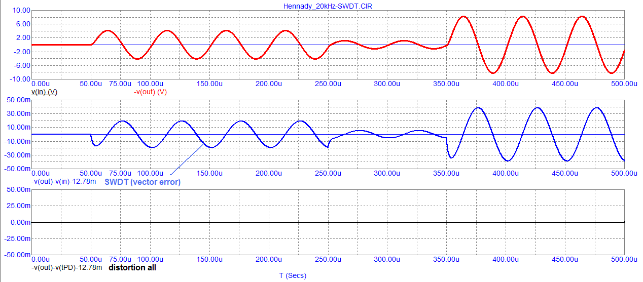

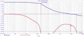

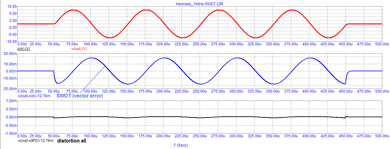

Here are the arguments:

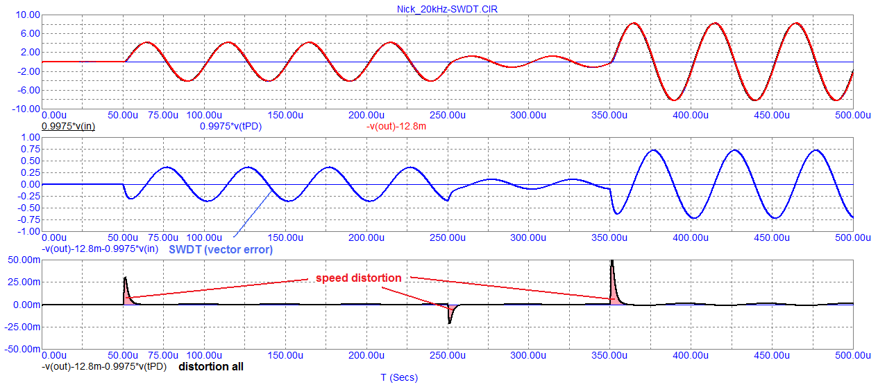

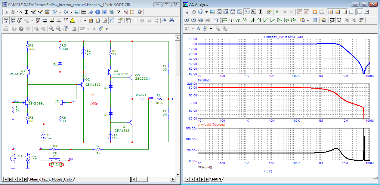

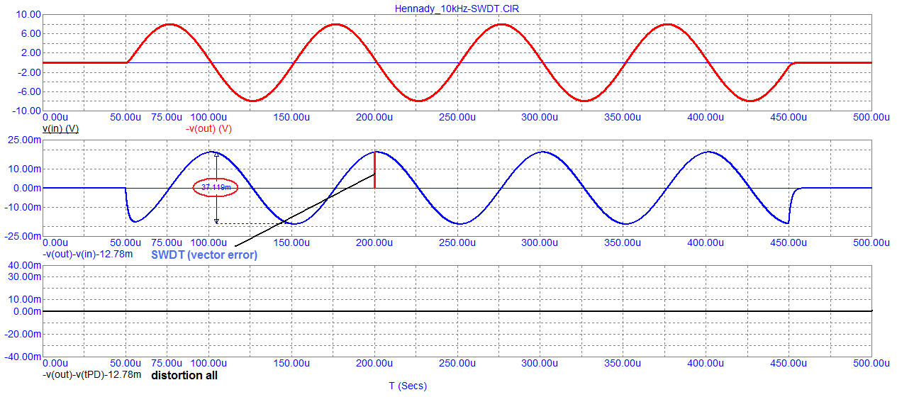

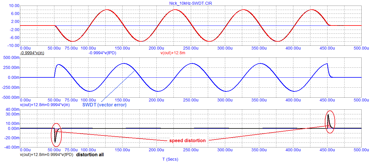

I explain on a specific example of an amplifier from a competition in which about 10 contestants took part. I took only two versions of the amplifier correction.
In one case, the simplest single-pole correction was applied, while the group delay time is only 37 ns and there are no high-speed distortions from the word at all.
In the second case, a multi-pole equalization was applied, which increased the loop gain by almost 60 dB! As you can see, the group delay time of the signal has increased to 700 ns (almost 20 times).
Learn formulas!

And about the formulas... your fragment does not contradict my formula in any way and does not prove you right, so save the pathos for someone else.

This is my first time encountering a professional troll. He really looks at the moon, but he sees only a finger.

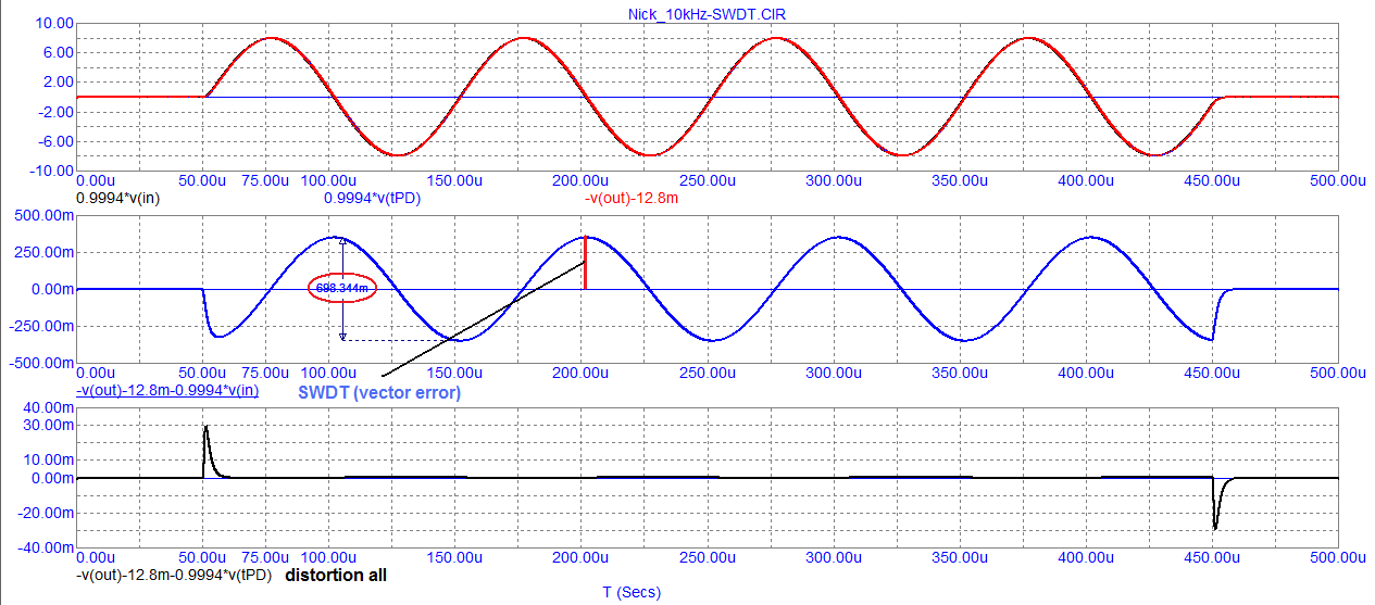

In the first case, the amplifier is broadband, the phase and group delay of the signal are linear up to almost 1 MHz, the gain at the testing frequency is 1, there is no amplitude distortion!
In the second case, the amplifier is less broadband and already at a testing frequency of 10 kHz has amplitude distortion. Therefore, in order to equalize the voltages during subtraction, it was necessary to apply a multiplier of 0.9994 instead of 1 for the input signal. The amplitude error is 0.06%.
In accordance with Jiri Dostal's calculations, in order to obtain an amplitude error of 0.01%, the bandwidth should be 71f = 710 kHz.
So that you do not see any irregularities there, I present graphs on the same scale.

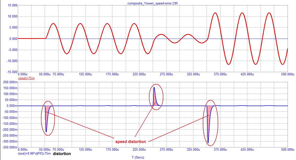

So what level of distortion introduced by the amplifier is sufficient so that the distortion is not felt by a person? Let's say the distortion introduced by the acoustic system is 2%. Then the amplifier is required that its distortion does not exceed 0.2%. This is exactly what reference tube amplifiers and solid state amplifiers without negative feedback prove.
Amplifiers with deep NFB most often sound lifeless, kill microdynamics. The level of high-speed distortion just characterizes the loss of microdynamics.
At a frequency of 20 kHz in an amplifier with multi-pole correction, the situation is even worse - the amplitude error is already 0.25%! the vector errors also increased by a factor of 2.

you asked me about the value of feedback, and my answer is true, the fact that you put other parameters only says that the quality is determined by a set of parameters.Hennady, I have to upset you, here are the distortions introduced by such an amplifier at a frequency of 10 kHz
your understanding of high-speed distortion is another nonsense that has a very indirect relation to the required value of the feedback depth in a power amplifier ...
not all amplifier topologies can make the function group delay GD minimal, but this does not mean that such amplifiers will sound.
An example of a high-order correction by guru Nick is another confirmation of this - I would not recommend such a correction topology to anyone. The order of correction is determined by the number of highohms points in the topology of the amplifier, hence we proceed, i.e. the order of correction is determined by the sum of the chains of the first and zero orders, as in systems of variable states, and not as in sound correctors like Nick.

About your comparison of Hennady and Nick frequency compensation methods... You forget that the purpose of this competition was educational and laboratory - to adjust with maximum preservation of gain at 10 kHz. Not to build the best amplifier, but to perform the action according to the task.
In addition, your graphs cannot be checked, but at the same time any error in compensation will give a sinusoidal difference wave. Since we do not see what happens during the storm in detail, there is nothing to discuss here.

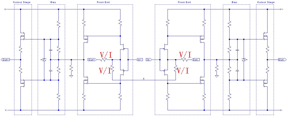

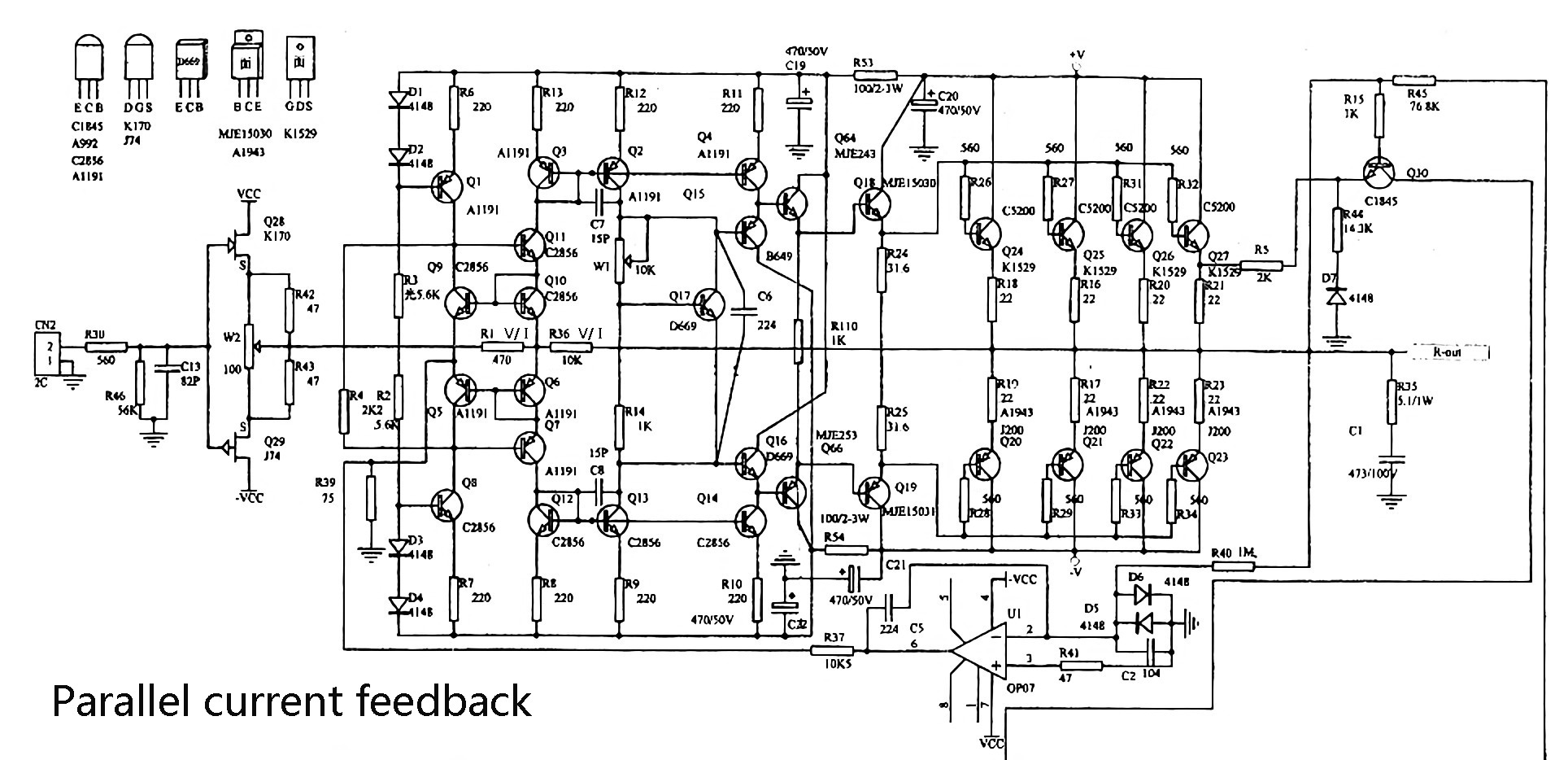

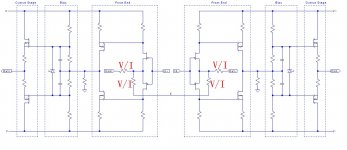

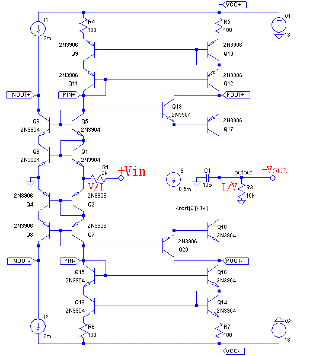

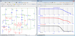

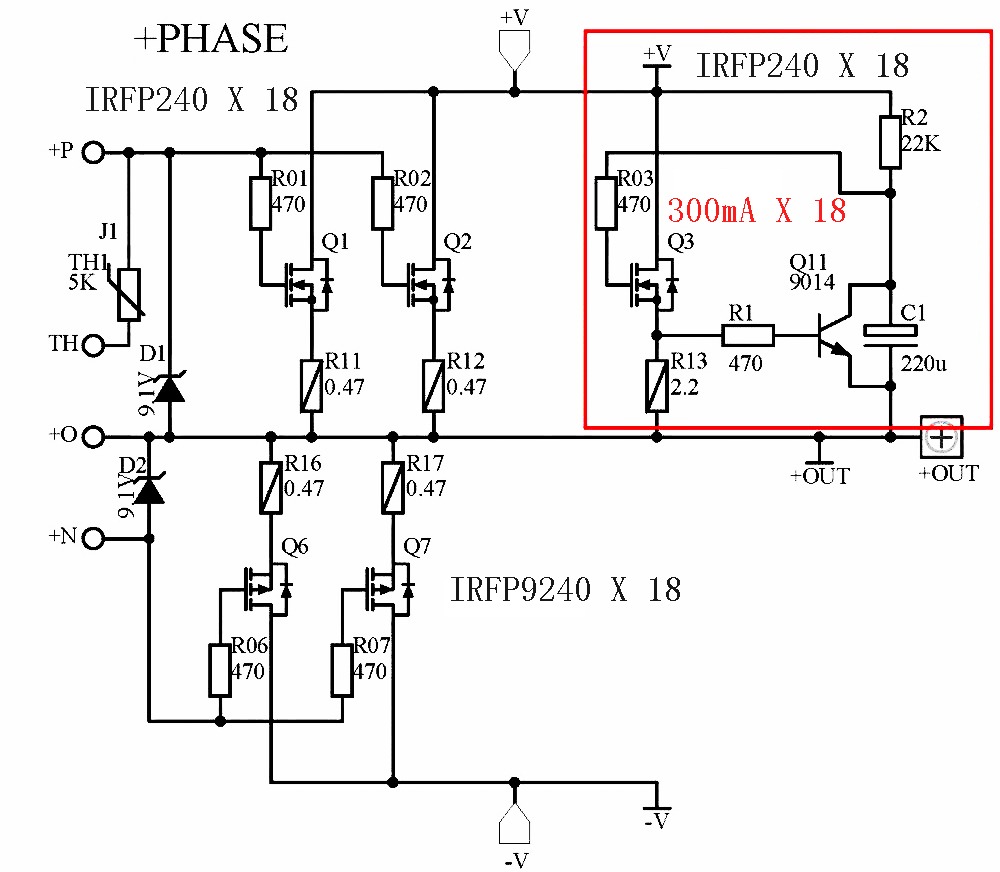

Parallel current feedback circuit

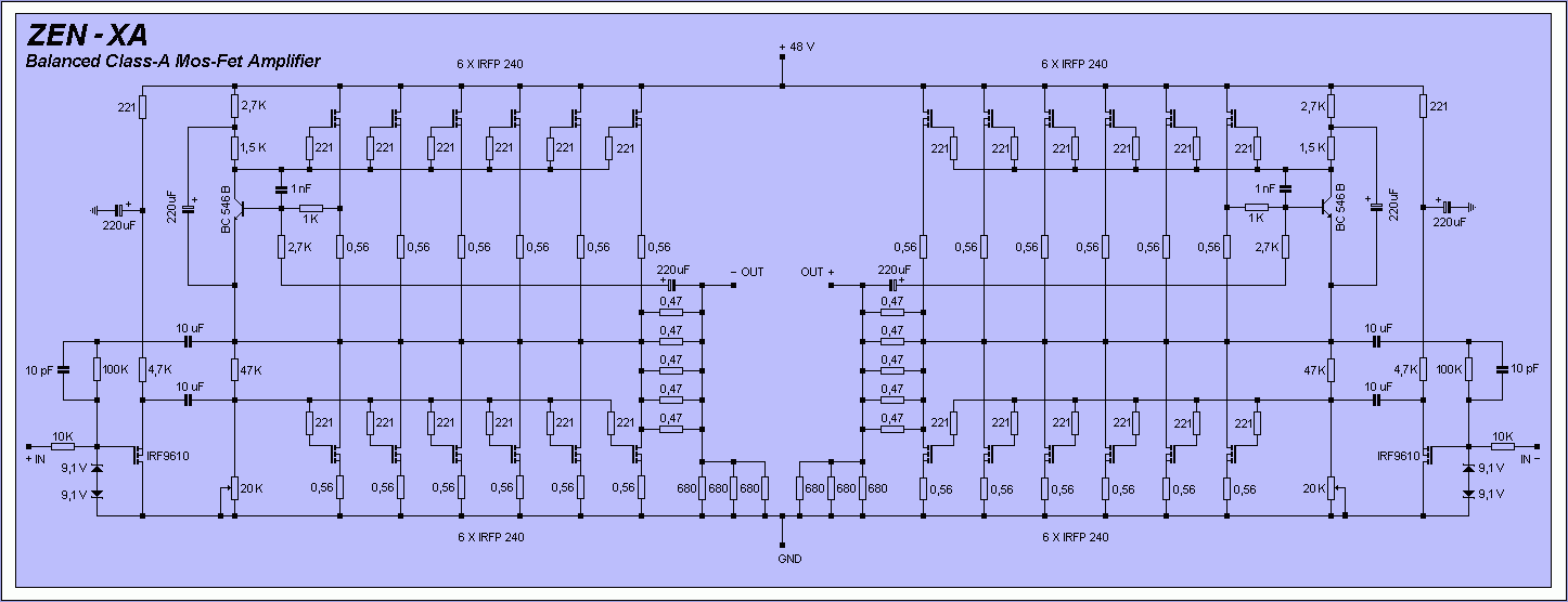

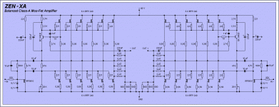

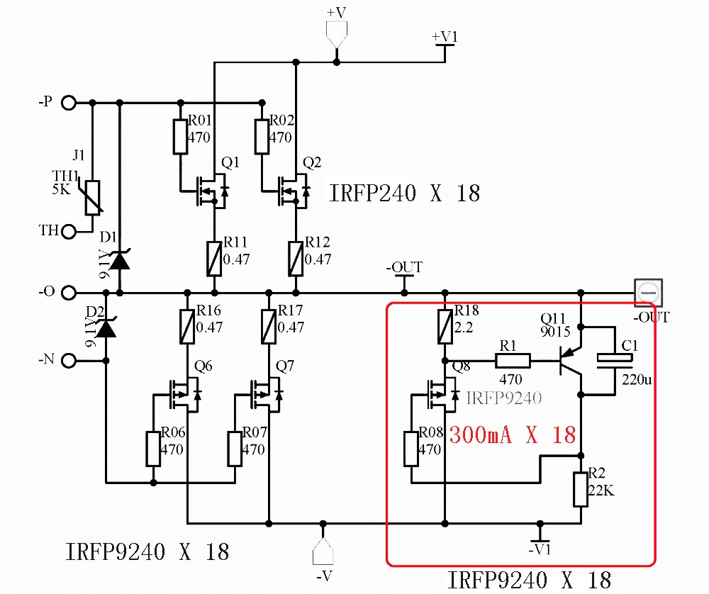

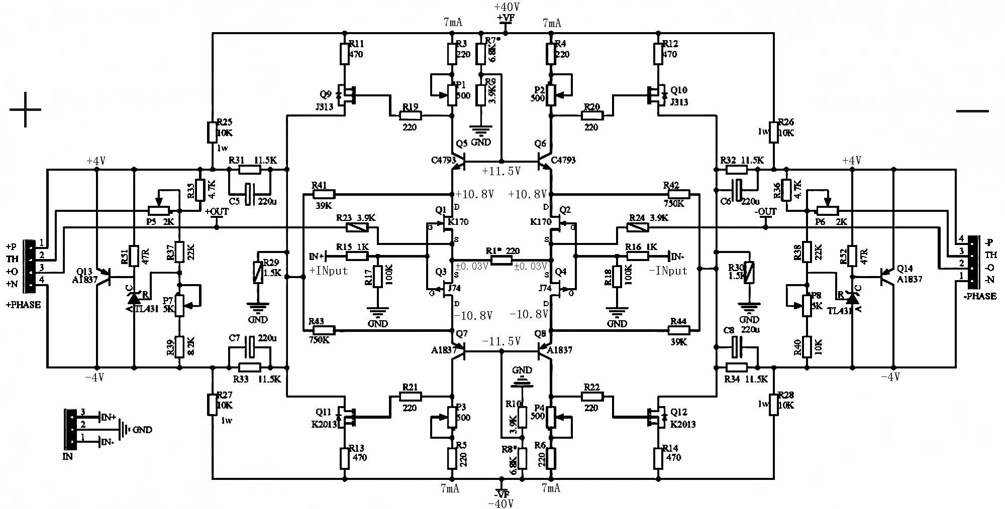

Can you tell me what is wrong with this amp? If yes, in what?

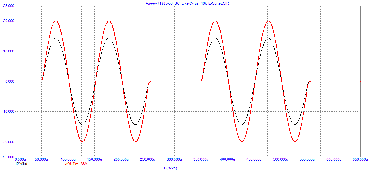

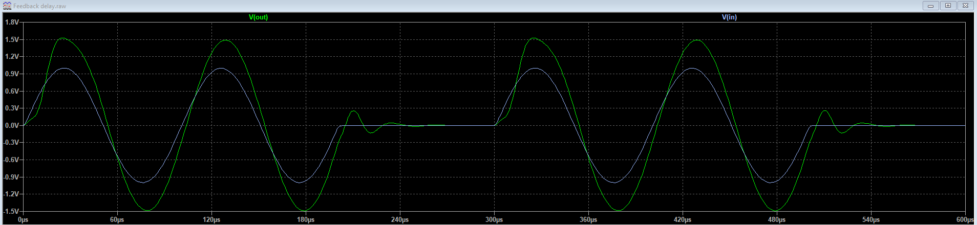

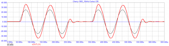

What about the question about the Cortez test?
What do you think is the reason for such a work of the amplifier? And what do you think, is such work on acoustics acceptable?

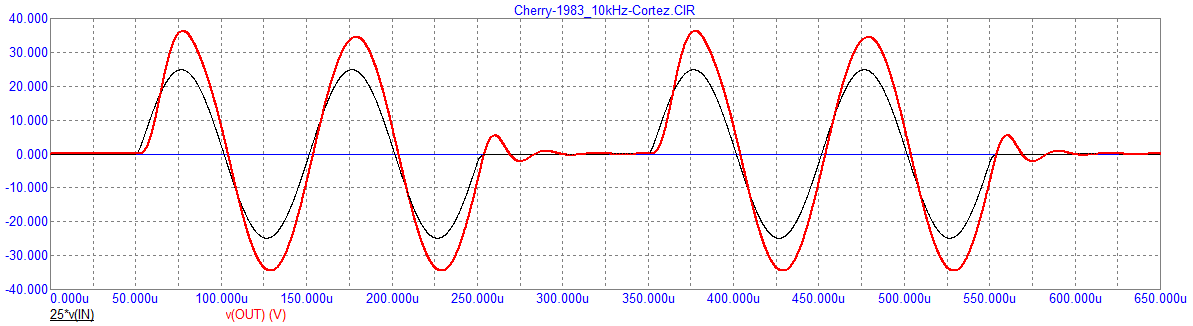

More than 15 years ago, Graham Maynard raised the issue of the correlation of first period distortion (FCD) with sound quality. This issue was discussed in two threads (maybe somewhere else, I don't know) and his attempts to prove anything were powerless. Theorists translated everything into distortions of the first period of RC elements, which Sandy also tried to do. Moreover, Graham tried to prove the detrimental effect of inductance at the amplifier output. Of all the colleagues participating in the discussion of the problems, only the esteemed John Curl supported Graham: “stay the course, Graham!”
It is felt that Cortez is related to the development of audio amplifiers and understands what he is talking about:
«I'd say transient distortion is a one that's not continuous/periodic and is only present right at the beginning (or at the end) of the change.
I know these are extreme cases but besides that they represent that there is some "special" error at every "new" signal change which cease after a few periods.»
I have repeatedly pointed out that this kind of distortion occurs whenever the signal deviates from the steady state: when the signal amplitude or frequency changes.
Let's perform a Cortez test with the first model that caught our eye containing an inductance at the output, for example, on the Cherry amplifier model
Isn't it true, the result is almost one to one.
