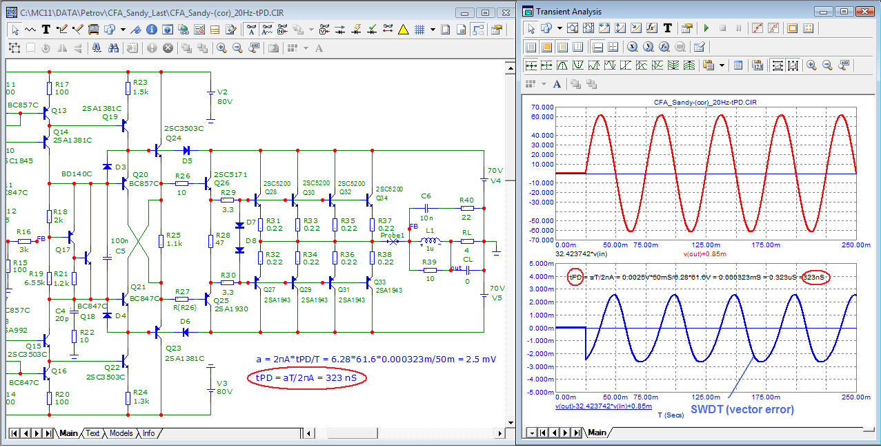

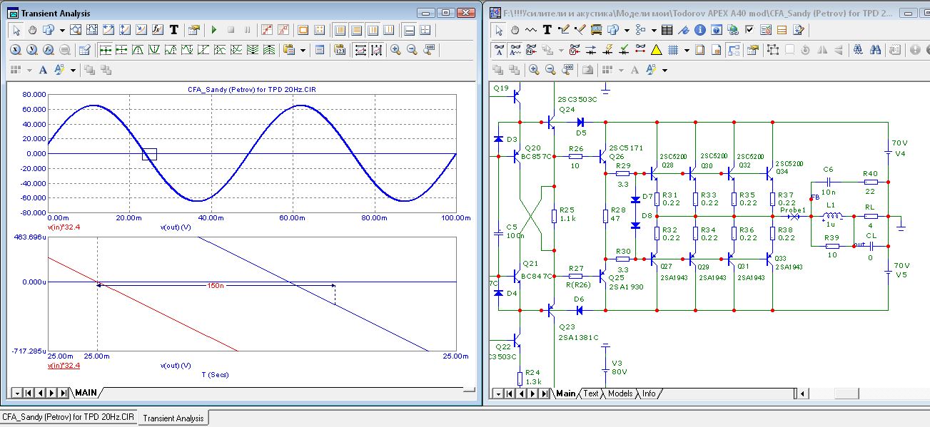

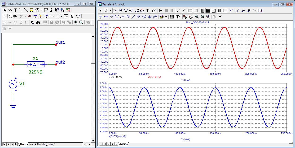

A phase shift of 45 degrees for a frequency of 1KHz equals a delay of 1mS/8= 125uS.
And only idiots don't understand that it's the same thing measured by different units of measurement
In some calculations it is more convenient to work with angles, in others with times.

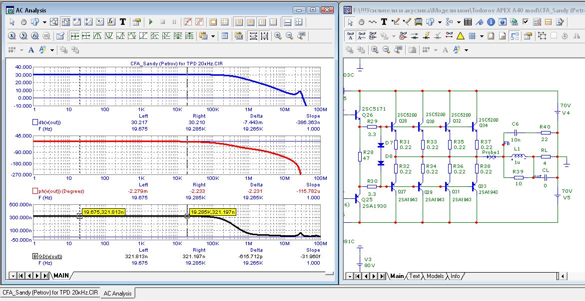

Well, your group delay time is shown in an even larger range of 10Hz-10MHz
And you can see for yourself in the picture how much it is at 20Hz and at 20KHz
If you can write, even if it's just nonsense, then you're not blind.
Sandy, you're avoiding a straight answer again.
I ask you to give only 4 numbers with an accuracy of up to a nanosecond (+ -2%).
Or do you lack the intelligence (as you always say to me) to make elementary measurements?
This is equivalent to if I asked you to measure the distance to the moon, and you tell me that you do not have enough tape measure.
A simulator in the hands of people without logical thinking is as useful as a grenade is in the hands of a monkey.

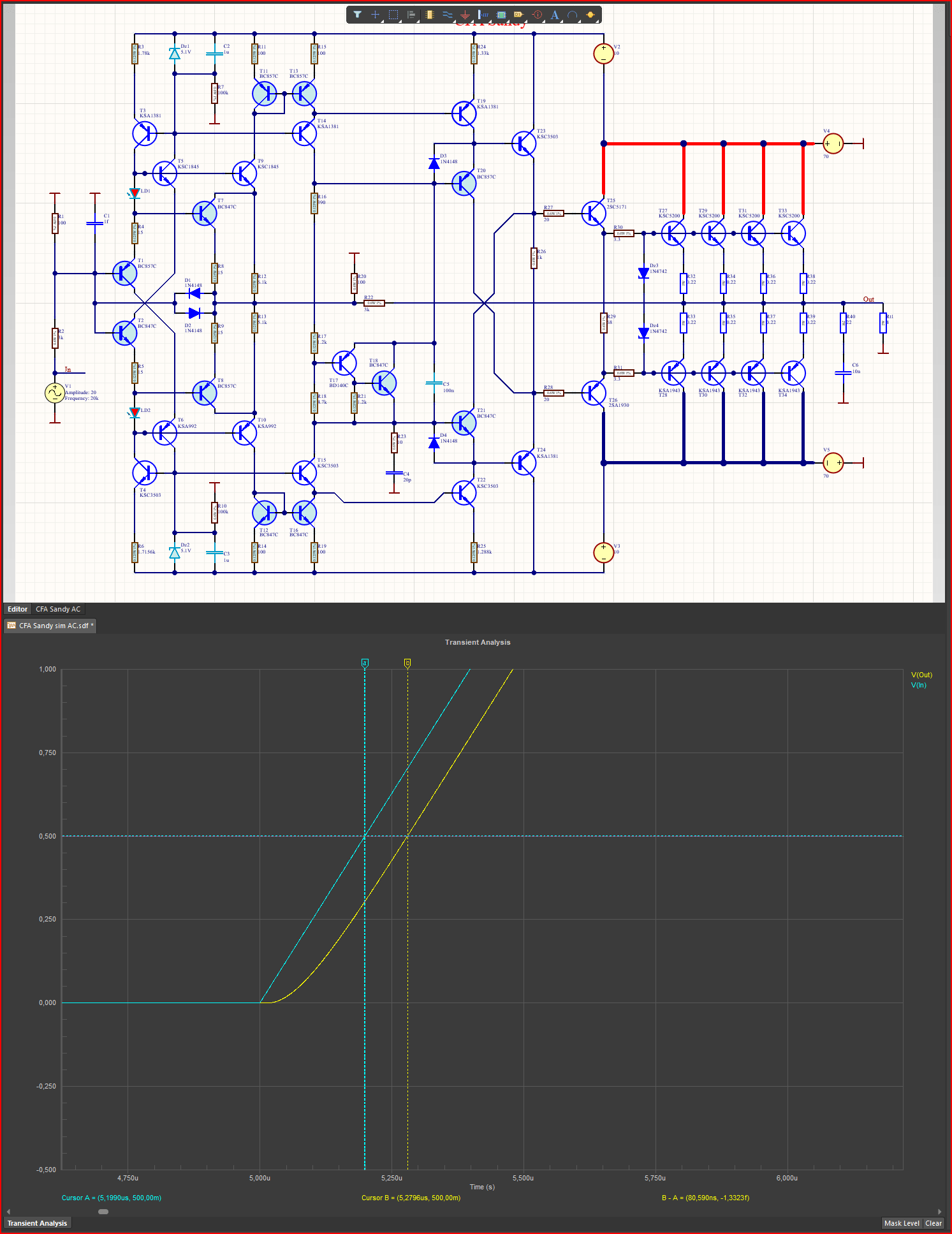

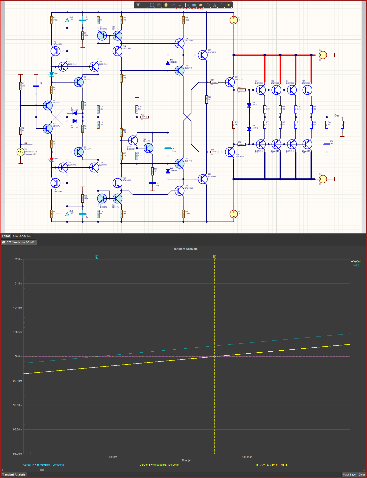

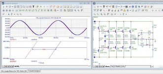

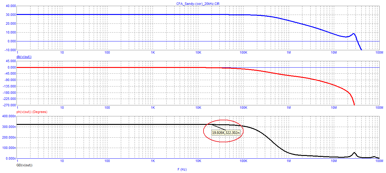

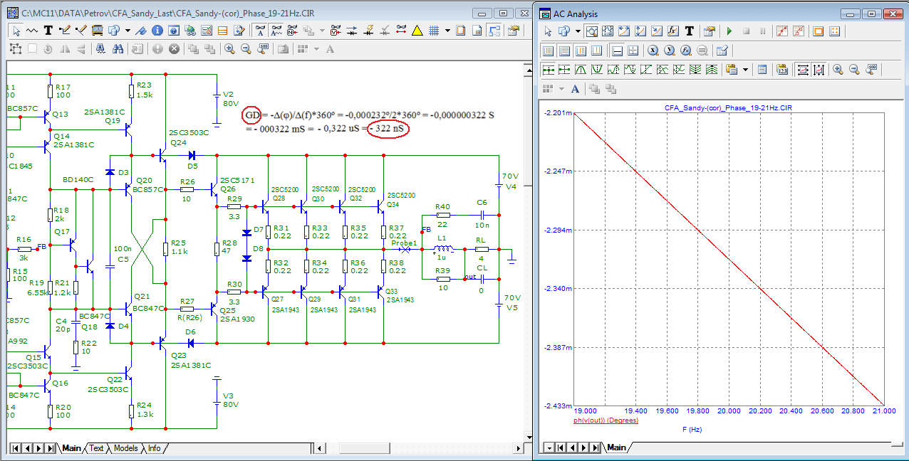

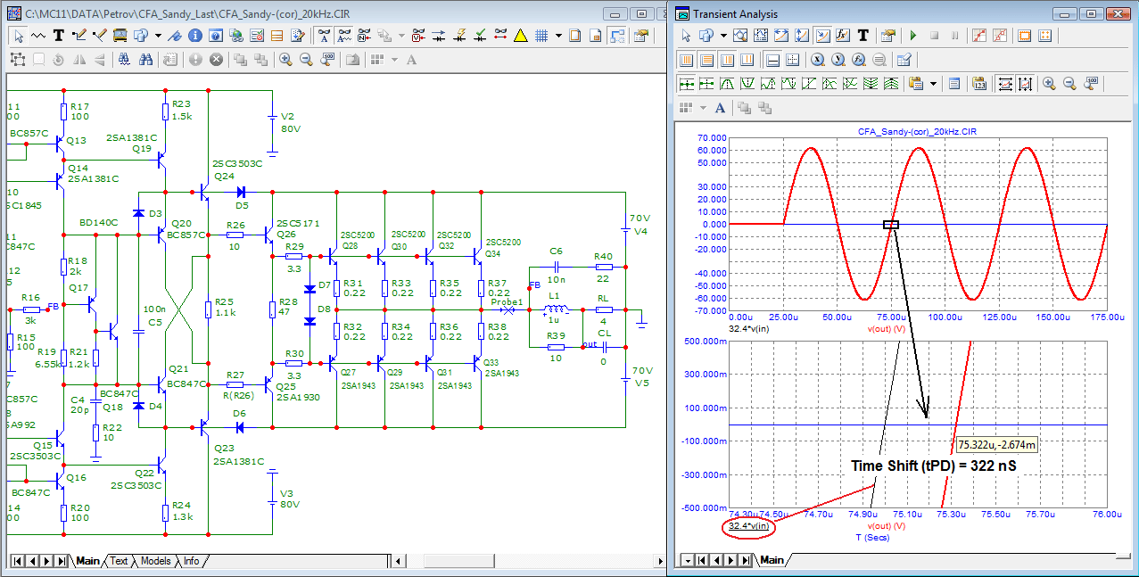

Sandy, here's a help (prompt) for you.
This is how monkeys or the Taliban do it with a grenade at 20 kHz
And endure your move (step) - show the result of measurements at a frequency of 20 Hz
as you can see in both cases 322 ns
The monkeys would have known what it was all about long ago.
Let's not insult them by comparing them to audiophiles.

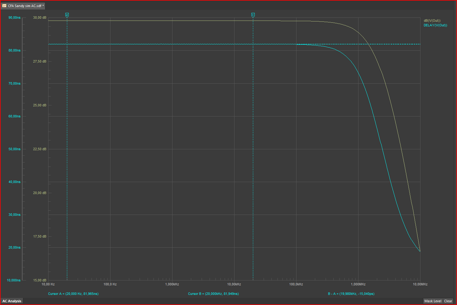

Here are the numbers if your intellect doesn't allow you to see them on the graph yourself
20Hz = 81.965nS
20KHz = 81.949nS

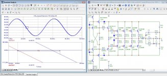

Here comes tPD
20Hz tPD=84.356nS
20KHz tPD=80.59nS
Naturally only 4 times better than your current amplifier. 😢😉

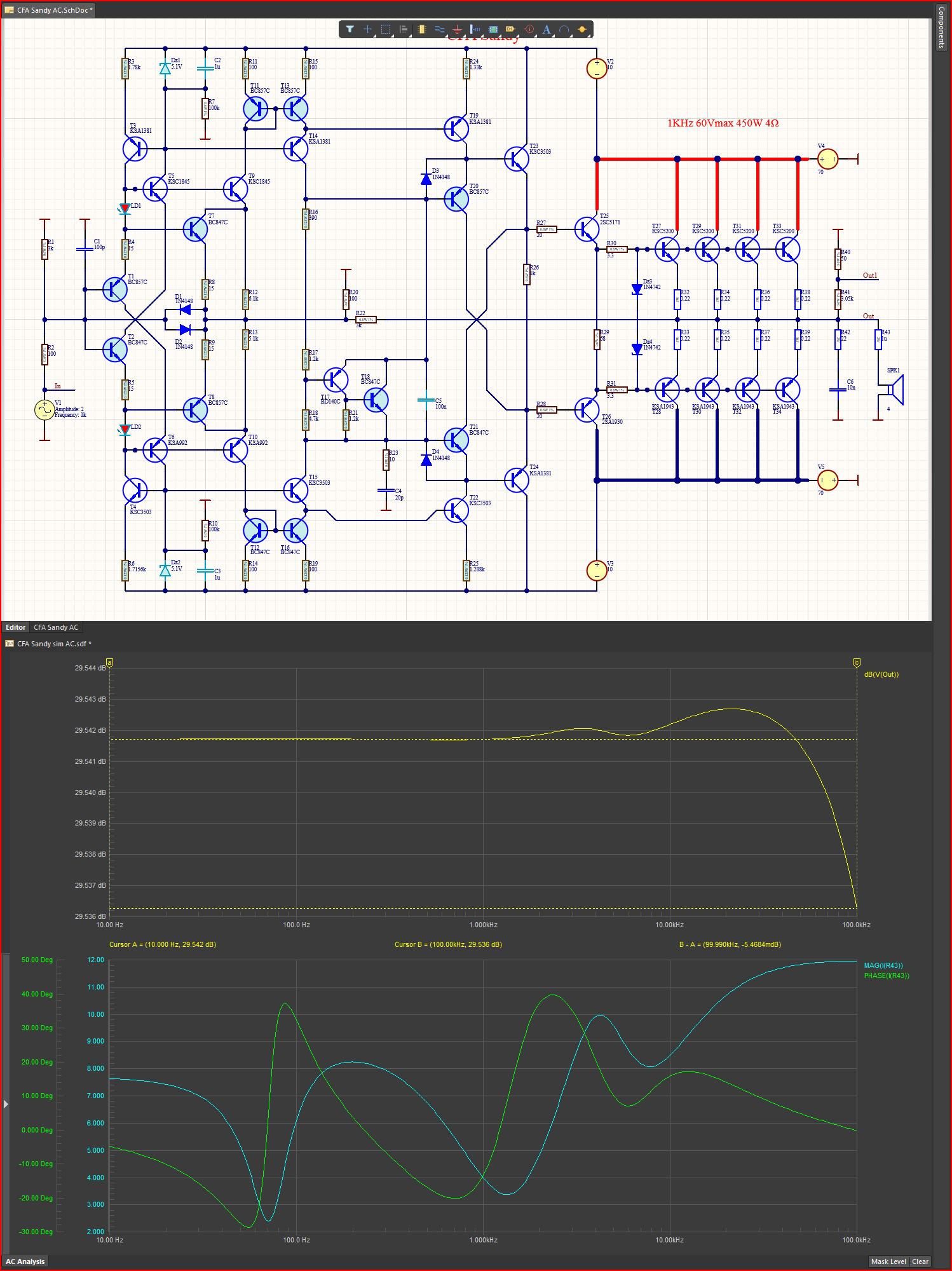

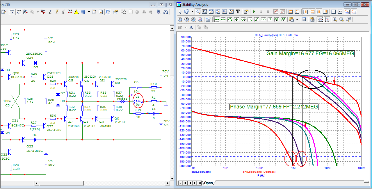

1.Sandy, you have removed the output inductance, but your amplifier model is inoperable without it (I suspect that you do not know how it is determined, see the figure).
2. You argued with me for a long time that the group delay and the signal delay time have nothing in common. But even with crooked measurements, it can be seen that the values are close. Why? I already explained to you in the telegram channel. Let me remind you: in areas where the frequency response and phase response are linear.
3. In my measurements with a 1 uH inductance, all four numbers match to within 1 ns!

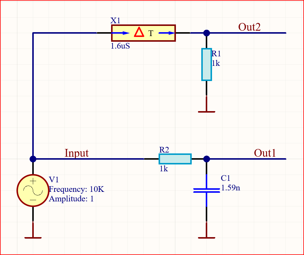

Do you distinguish between a delay caused by an RC circuit and a delay caused by a delay line.
Apparently you do not make such a distinction, which shows total technical illiteracy on the subject.

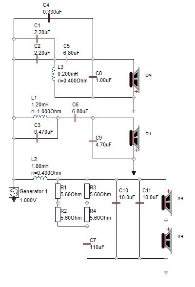

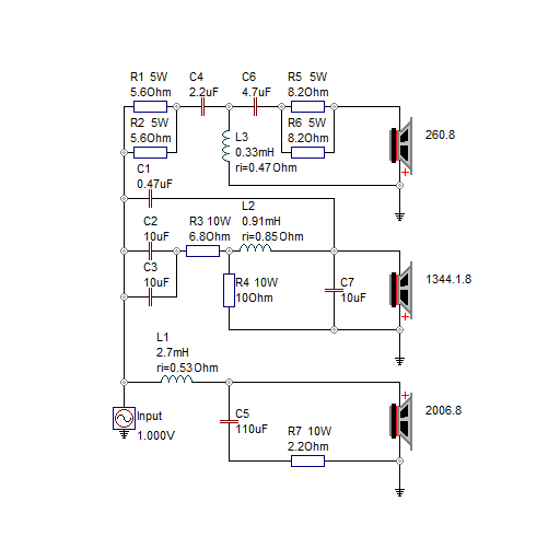

In fairness, it is worth noting that a capacitive load can still occur in real life. I saw one such example (I would not like to name the author) and was shocked. I can say that this product is amateur, but it is possible to find similar examples in a professional environment if you search. In the end, I would still not throw out the output filter😉
If you look at the circuits, you can see the paths of current flowing through the capacitances to the ground. It's certainly not 8uF, but it's still significant.
The problems come from the fact that people with little experience and even negative technical knowledge try to make filters not by knowledge but by guesswork.
And the results are usually deplorable.
Capacitance that can lead to self-excitation is mostly on the long cable to the column.
And the RL circuit at the output of the amplifier is enough to solve the problem.
The problem with stupidly made filters in the column itself is already on the conscience of the authors.

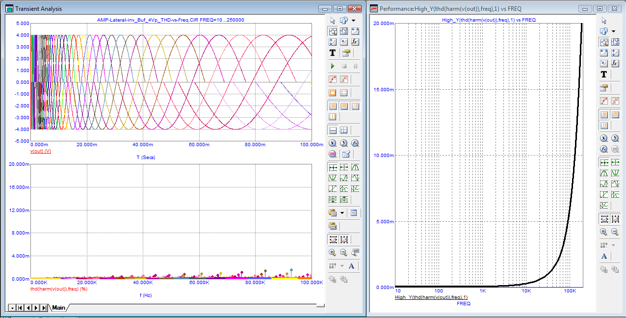

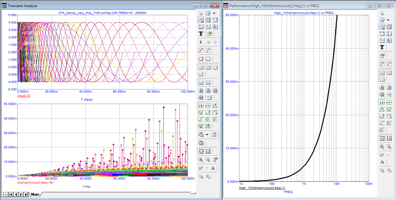

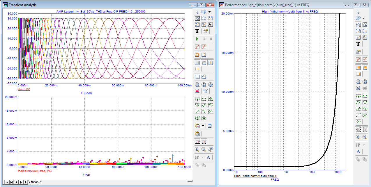

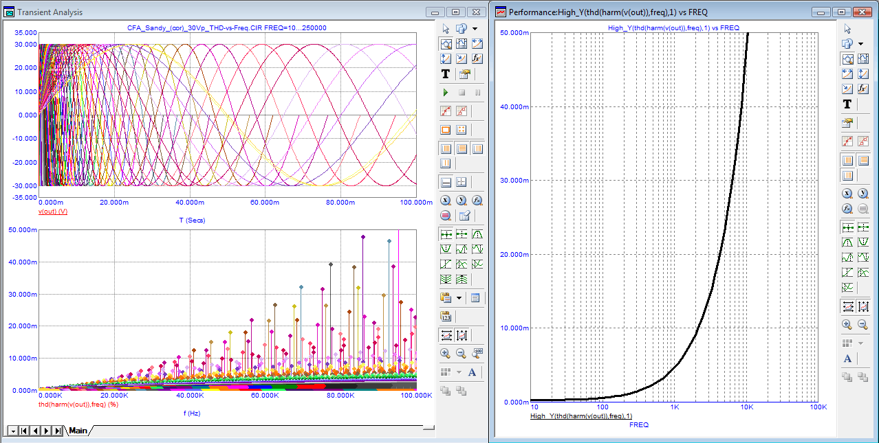

Tech-illiterate audio-Talibans like you and Otala are flying in the clouds of audiophile insanity.
And he doesn't know what feedback is and how it works.
Audio-Talib Otala came to the conclusion that the frequency of the first pole should be above the audio range. Unlike you, Otala perfectly understood that the loop gain drops above the frequency of the first pole, the loop gain is phase-shifted up to 90 degrees, which contributes to the growth of not only non-linear distortions, but also temporary ones.

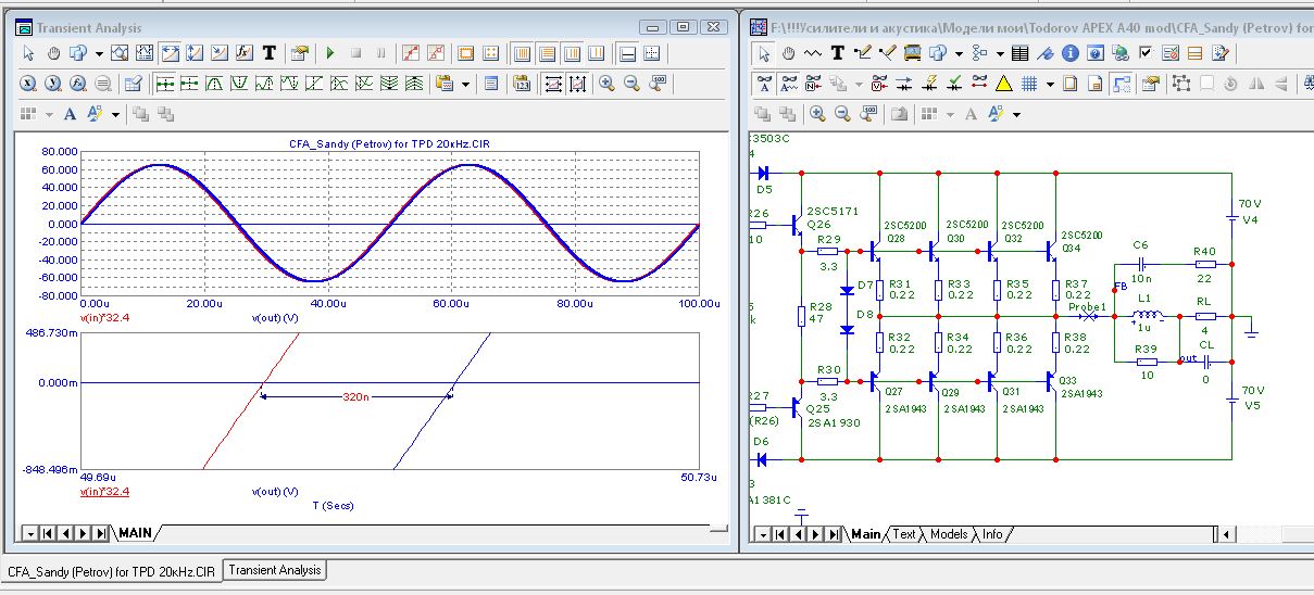

Sandy, take into account how to measure tPD using Jiri Dostal's formulas so as not to apply a voltage of 20 V to the input of the amplifier! And at the same time have large measurement errors.
As you can see, the measurement error is within 1 ns.
To accurately measure all types of distortions by the compensation method, it is sometimes necessary to measure tPD with an accuracy of fractions of a ns.

I am still waiting for an answer to the question Is Out1 Out2 the same????

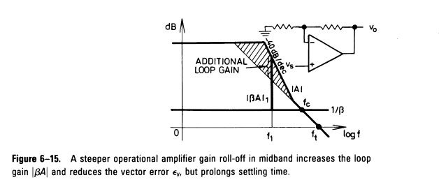

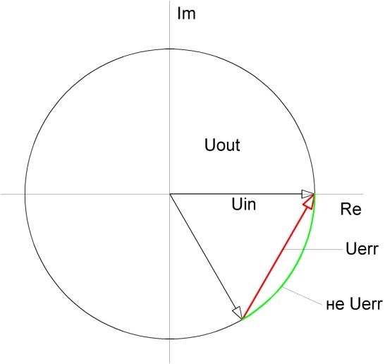

And besides, even despite my repeated indications that the formula is incorrect, it is still not fixed. The formula petr_2009 with an increase in the phase deviation gives an increasing calculation error, but it is still persistently used and given as a reference material. Where is the logic here?
fagos, prove that the formula is wrong. It is taken from the book Dostal
It's not worth redirecting arrows to him, trying to slip through on his authority - this is not his mistake, but yours. Here is a link to your drawing with the calculation formula:
https://www.diyaudio.com/community/attachments/cfa_sandy-cor-_20hz_tpd-png.1101830/
And now look at Figure 1 in the attachment, which illustrates what the error is. You determine the length of the circle sector between the input and output voltage vectors, but the difference is equal to the vector, not the circle sector. Therefore, the correct calculation formula (the chords of the circle in this case) is shown in Figure 2.
If you have seen your version of the formula in the book Jiri Dostal, then give the number of the formula or page, I did not find it.

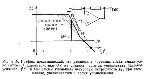

As a separate question, I can cite a curious drawing from the book that I would like to show you and ask for a comment on this. As you understand, in the context of your theory, I got the statements in the caption to the drawing. Since the drawing is from the Russian-language version (fig.3), then for the English-speaking audience I bring in addition the same one from the English-language edition (fig.4).
I will explain why I ask the question - the vector error at the F1 frequency will decrease, but petr-2009 shows us on the contrary an increase in the vector error with an increase in the depth of feedback. Got's statements correspond to the classical theory, and petr_2009, referring to him, contradicts him. It turns out some kind of incident that requires resolution and clarification.
