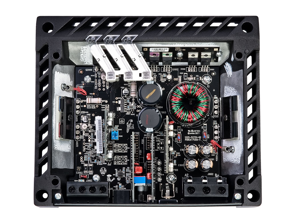

good morning just to check if I understand how these amps work
Practically their internal power supply is made up of a dc-dc converter that takes the 12VDC input and generates the dual voltage necessary to make the amp work?
so with some modifications they could also be fed directly with a dual voltage like a normal home amp?

You can feed some of them with external supplies but most complicate things with regulated ±15v power supplies, protection and muting circuits.
Not all output stages in amps work from split rails. Some class D have a single positive rail for the output stage and use a split supply for the preamp section.

Hi ! i hope in the weekend to start with some tests ... i see a trimmer for fine regulation of the Vout ... maybe some 13.5V are possible i have to check
However these amps are Ampere suckers ... i have seen some measurements on youtube ... they seem welders 😱

The current draw is relative to the output power to the speaker. As an example, a 1000w amplifier may draw 150+ amps at full power but at lower volume, it may not draw more than 5-10 amps.

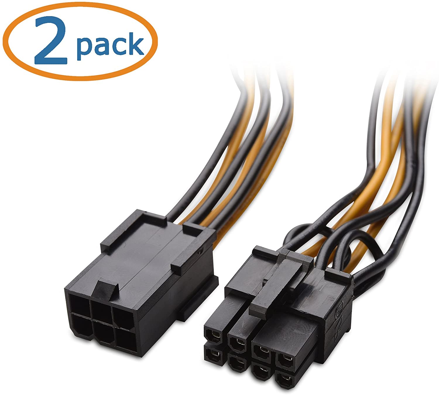

i am thinking about buying these
Cable Matters Pacco da 2 Adattatore PCIe 6 Pin a 8 Pin – 4 Pollici: Amazon.it: Elettronica
they should simplify things ?
