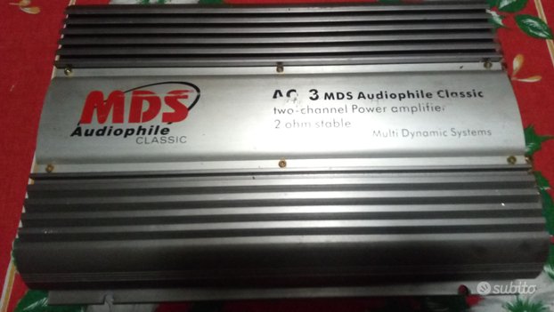

And what about the amp in the attachments ? i should have said that i need little power ... i am using quite efficient speakers and the idea is to go with high efficiency ones So the sound can be low in power but quite clean because high efficiency speakers expose everything

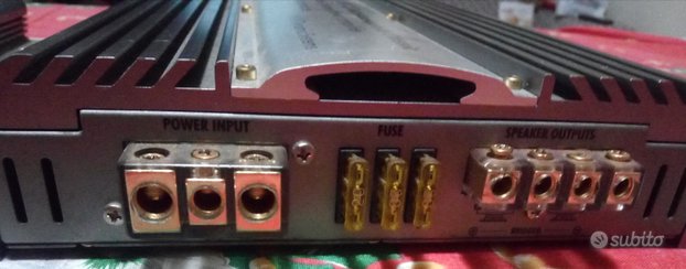

I am negotiating for the amp. I like its connections so much ... that is how they should be made ... i think

A small note of caution from bitter experience, try and find an amp with D.C. offset protection on the speakers as not all do and can damage speakers in the event of a fault.

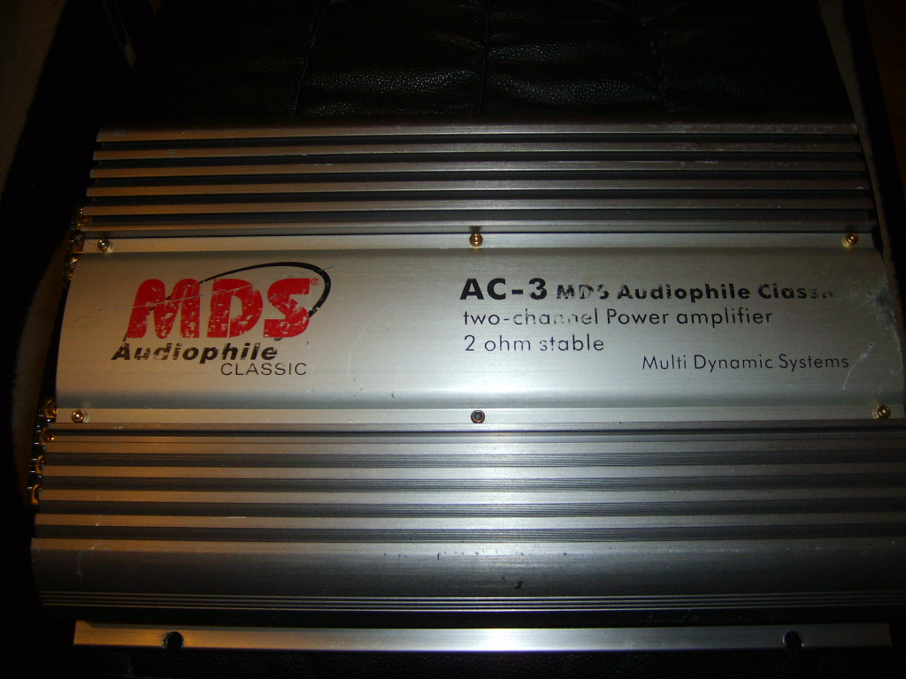

Hi ! thanks a lot for the very useful advice. I would check in the datasheet if i could find it. I have bought this one attached, currently waiting to receive it. Very cheap but working. As i said above i need very little power ... i am switching to high efficiency speakers
And about load tolerance i see written on top 2 ohm stable ... a comforting statement

Congrats I hope and think its as good and probably even better than my GP4.
