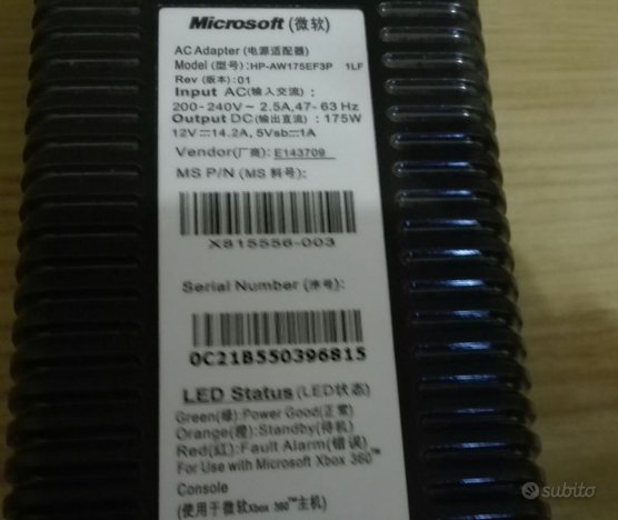

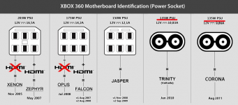

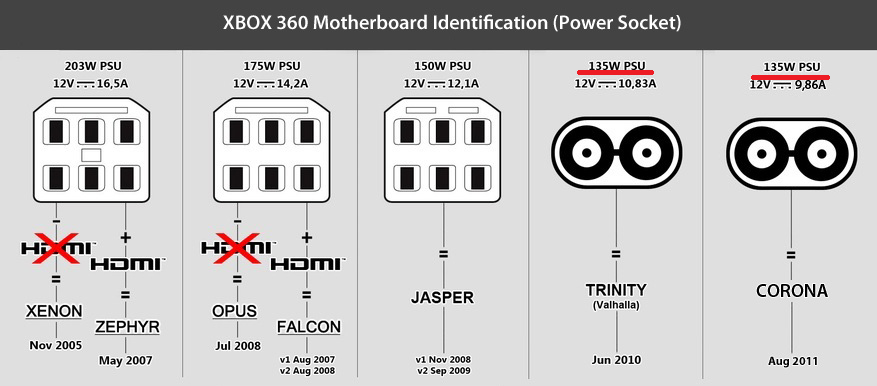

Hi ! sorry it's me again. I have got the Xbox psu ... the model is the one in the attached pics. I have the 175W model. i am already looking for the 203W model :eek:
I have not cut the plug yet .... i wonder hot to connect the wires to get the +12V and ground. The wires with the same colour can be connected together ? thanks a lot

A 12v DC power supply will have two output terminals. One is positive and one is negative. The negative (may or may not be connected to the mains ground) will go the ground terminal of the amp. You don't need any other ground for the amp.
In the US (since others may be interested in this information)...
Most of the plastic cased power supplies have a floating secondary (no connection to the mains).
Most power supplies in a metal case and with a 3-prong mains plug have the ground terminal on the 12v side directly connected to the mains ground.
If I'm not mistaken, when a 3-prong mains plug is used and the power supply has a metal casing, the supply case will be connected to the mains ground for safety, regardless where it's to be used.
