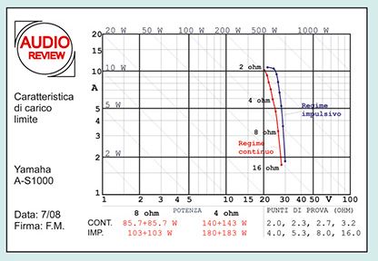

Speaking of the amperes the max current delivered by an amp is very important because it tells about its driving ability of difficult loads
For instance two amps can have the same power on 8 ohm load ... but passing to 4 ohm load one can have more or less the same power and another one can double it. Usually the second one sounds more powerful in the bass. 🙂
It can deliver more current on a 4 ohm load while showing the same power on 8 ohm
This is the reason why some less powerful amps can sound more powerful that amps with higher wattage on 8 ohm ... because their current do not sag
Usually this is the result of some kind of current limiting circuit. They limit the current to limit the heatsink needs ... the parts grade ... i do not know why

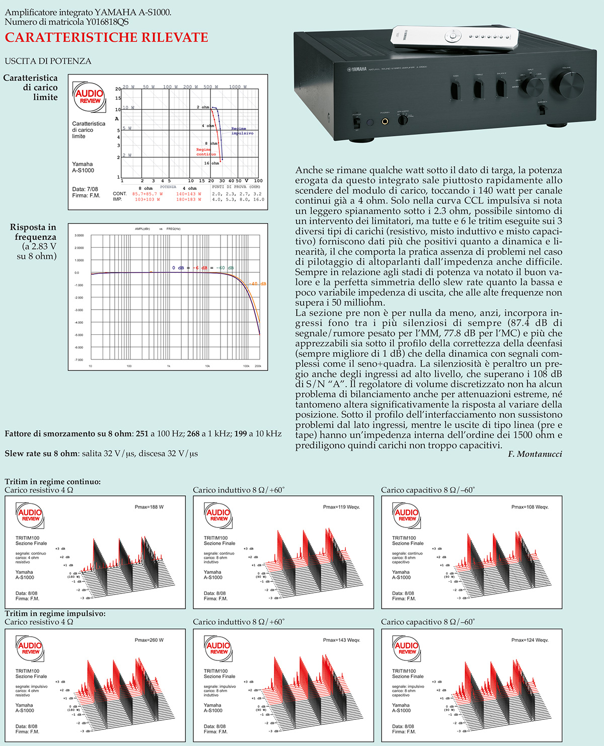

There is an italian magazine doing this kind of test ( i am attaching a lab report)

You're mixing two things (at least). The ability of an amp to double the power in 1/2 the load isn't generally about the current capacity but the regulation of the rail voltage. The downside of this is that you limit the power into the higher impedance load to double the power. More snake oil.
You were talking about testing THD+noise. That's FAR different than testing for power. Power testing is relatively simple. You'll need a dummy load and a scope. THD+noise, you typically need a computer with a high-end sound card or a standalone piece of test equipment.
You're mixing two things (at least). The ability of an amp to double the power in 1/2 the load isn't generally about the current capacity but the regulation of the rail voltage ...

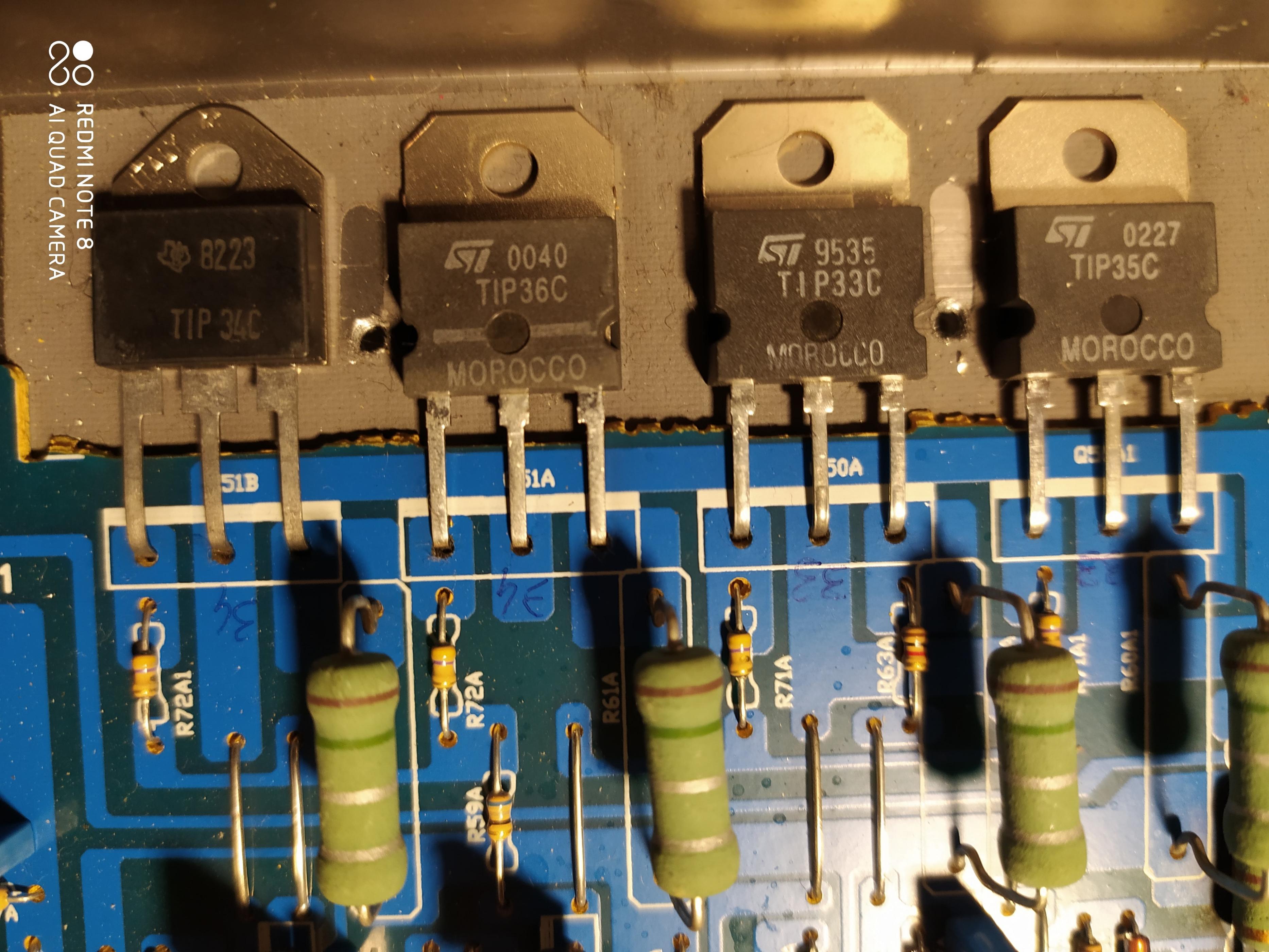

The photos he posted were of a 2 channel amp that used two transistors per phase (high-side/low-side) per channel. I've never seen an amp that would mix a TIP33 and a TIP35 for a single phase. Mismatching parallel transistors is going to decrease reliability.

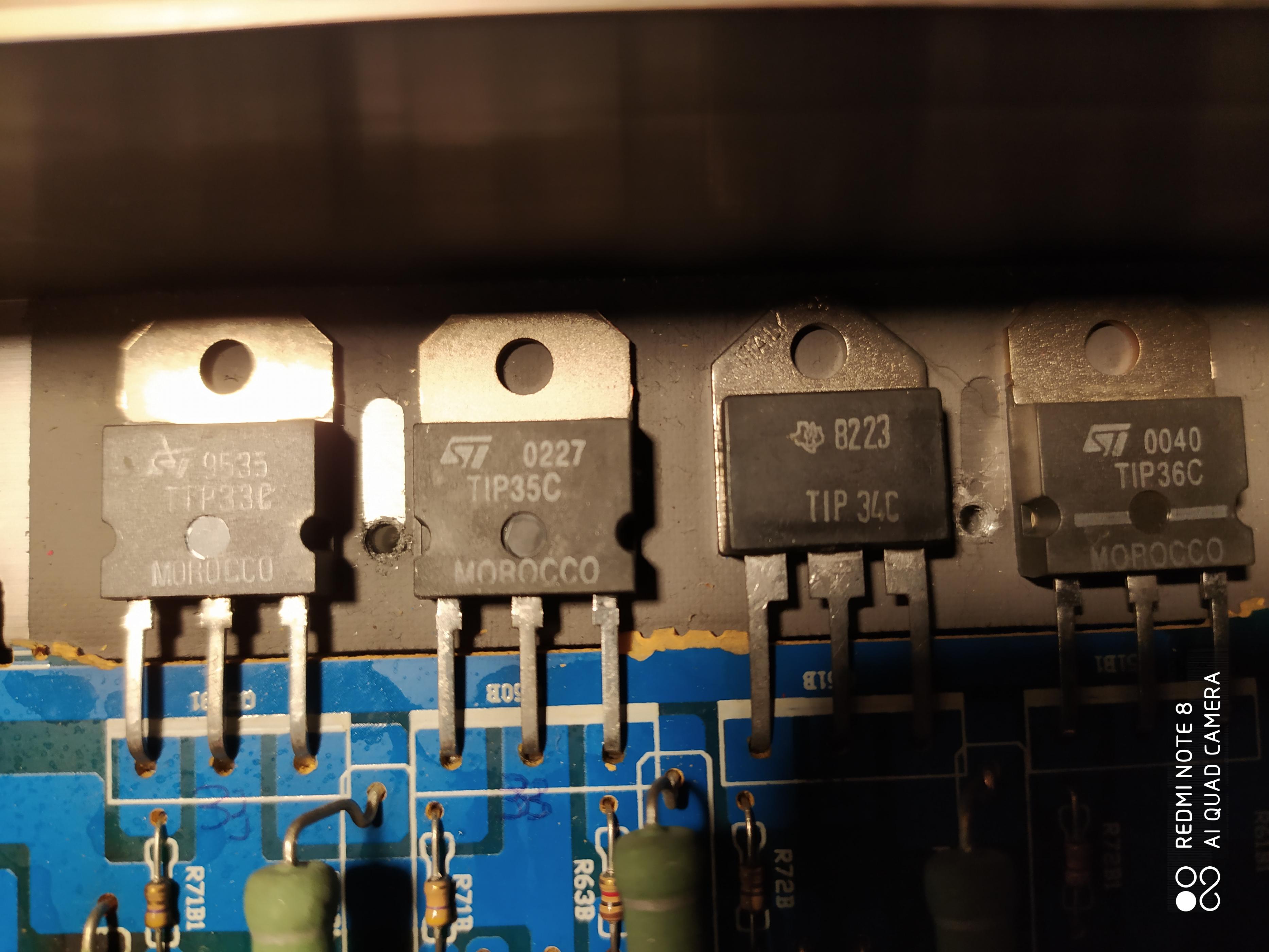

Hi ! sorry for the slow replies ... i have issue with my job 😱
anyway ... i am attaching the pics of the output stages I was surprised to see different bjts 😱😕
in the meantime i have bought 5 pairs of tip35c and tip36c with the intention of replacing the ones in the amp
Is this stupid ? at least they will be identical
In my mind the output stage is 2 pairs paralleled ... am i wrong ?
