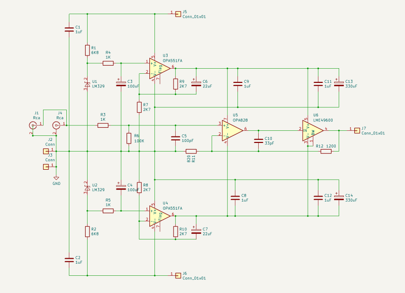

My project reached measurement and evaluation phase. This composite amplifier is different from the all available so far as it has super regulators on board, separate for each channel. That way, simple dual rail PS from +- 18V to +- 60V can be used. Intended use is as input buffer in power amplifiers, for driving line transformer VAS instead of usual puny JFET buffer.
As regulators are used OPA551 operational amplifiers. They provide wide supply power bandwidth and excellent transient response up to 270 mA, where current limiting kicks in.

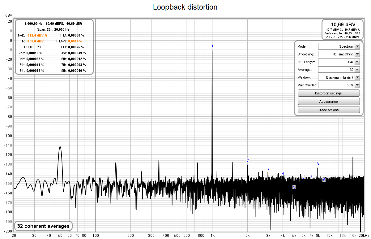

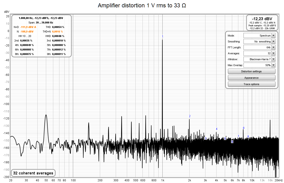

Distortion is very low and on verge of my equipment (Focusrite Solo gen. 3). Equipment introduced distortion is 0.0003 % (loopback measurement). So, amplifier distortion at 1 V rms output to 32 Ω load is 0.00024. It is nice that only H2 distortion was added.

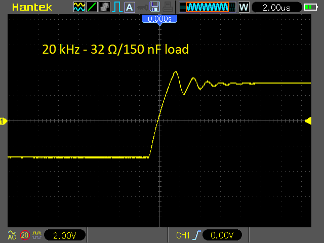

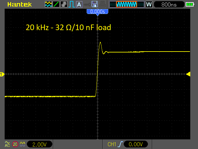

Stability with capacitive loads is very good.

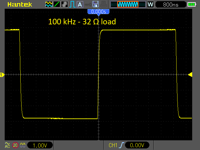

With no C5, F3 frequency is exactly 2.5 MHz. Square wave response at 100 kHz is perfect. Desired frequency response can be adjusted with R1-C5 RC filter.

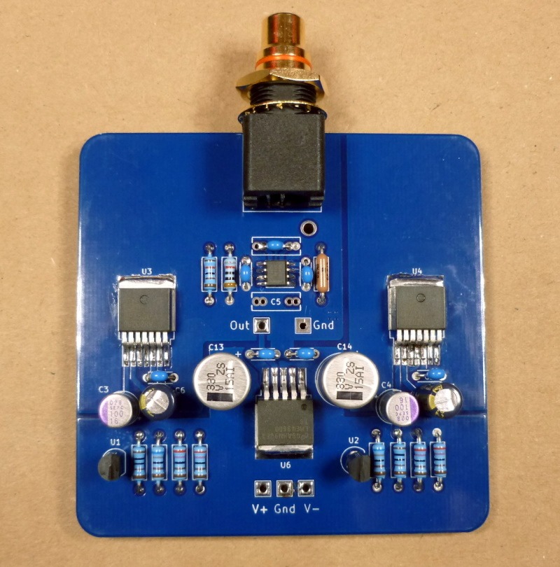

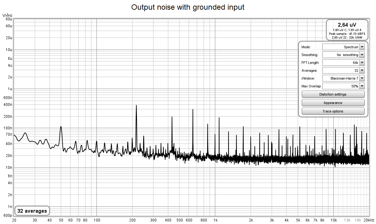

If someone wants to build this, I can provide gerbers for modified PCB with fastening holes, so it can be mounted in proximity of input potentiometer. PCB has 4 layers because it was necessary to provide clean and continuous copper areas as heatsinks. One layer was used as Zero Signal Plane and input tracks are in sandwich between two ground planes. Attached measurements were done on the open bench, 20 cm apart from bulky unshielded transformers of old linear PS. On output noise measurement, 50 Hz EMI is et very low level.

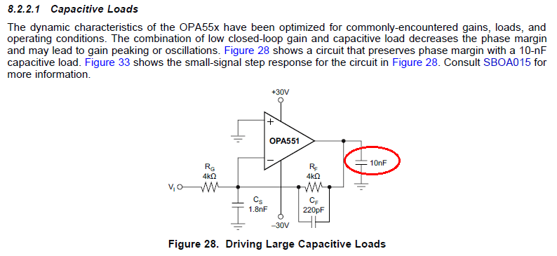

The OPA551 datasheet suggests a way to keep the opamp stable when driving 0.01 microfarad loads. But your OPA551 drives thirty thousand times larger capacitance than that; how does it remain stable?

It’s stable because it provides DC output. It couldn’t drive large capacity with AC signal.
Transient loads up to internal current limiting are not an issue.
edit: Just remembered that OPA551 regulators were tested with 1000 uF organic polymer capacitors at output as well. Everything was perfect with dynamic loading.
Loop stability could be an issue though. Regular opamps cannot realistically cope with almost pure capacitive loads (there are some exceptions, but they are rare).
It would be a good idea to sim the circuit if a good OPA model is available. Otherwise, a real-world test is not difficult to setup: a function generator, a 100ohm limiting resistor and a 100µF DC-blocking capacitor.
You just have to sweep the frequency from a few Hz to 2MHz or so to detect any peak in the supply impedance caused by a resonance. Damping the capacitor(s) with a small series resistor would then be the cure
Regulators were tested with my “usual method”. Varying frequency square wave load with 1 us rise time, up to triggering internal current limiting and observing transient response. There is direct relation between transient response and phase margin. Paper is attached. According to this method, regulators were very stable.
Actual complete circuit measurements provides no trace of any instability. Frequency response was measured with 2.83 V rms in to 32 Ω load, observing output sine wave with oscilloscope. No trace of any harmonic or oscillation.

Gain 2,4x and I see you used the 33pF compensation (C10) and in high bandwith mode with no osillation.
PCB with 4 layers while some do it with only 1.
Just finished mine , pretty amateuristic on 2 layers milled PCB . haven't connected it yet , waiting for the heatsink for the 2 LME's .

Nothing wrong with only 1 layer PCB. I had to use 4 layers because of using both front and back copper areas as heatsinks.
It is a valid method, and if it does not show anomalies, the opamps see enough damping to be stable, in the esr of the capacitors or elsewhere.
Somewhat unexpected though.
