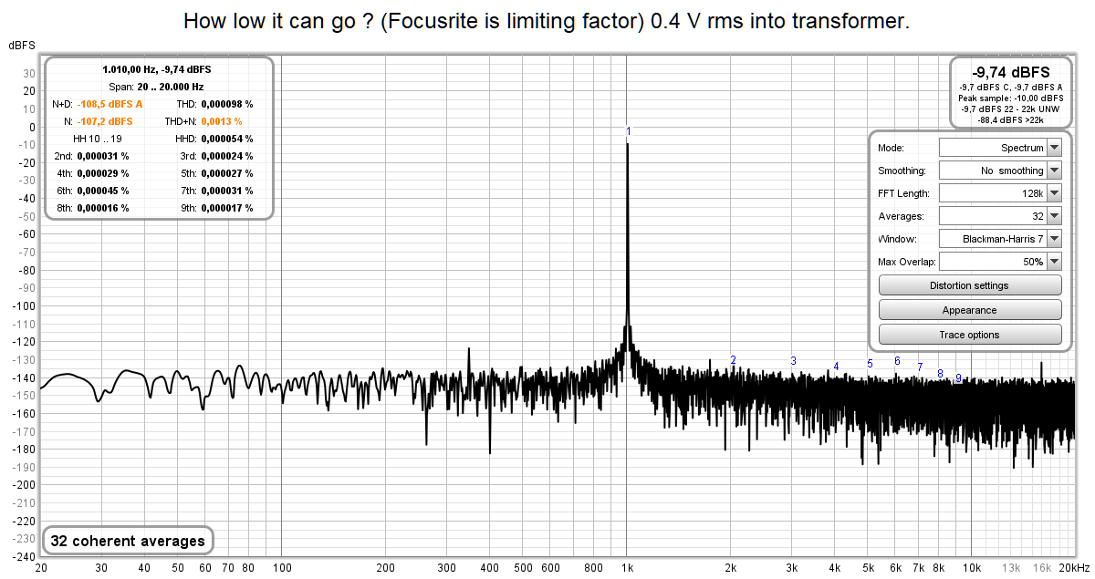

For distortion measurements I use basic level equipment: REW + Focusrite Solo gen. 3.
With Focusrite, there is not to wide window of output/input signal levels where its distortion is at minimum.
0,0003 % is that minimum.

BTW, based on latest buffer measurement driving line transformer in the amplifier, I’m confident that it delivers IRL, datasheet declared performance of 0.00003 %. Distortion present is almost completely Focusrite internal distortion.
