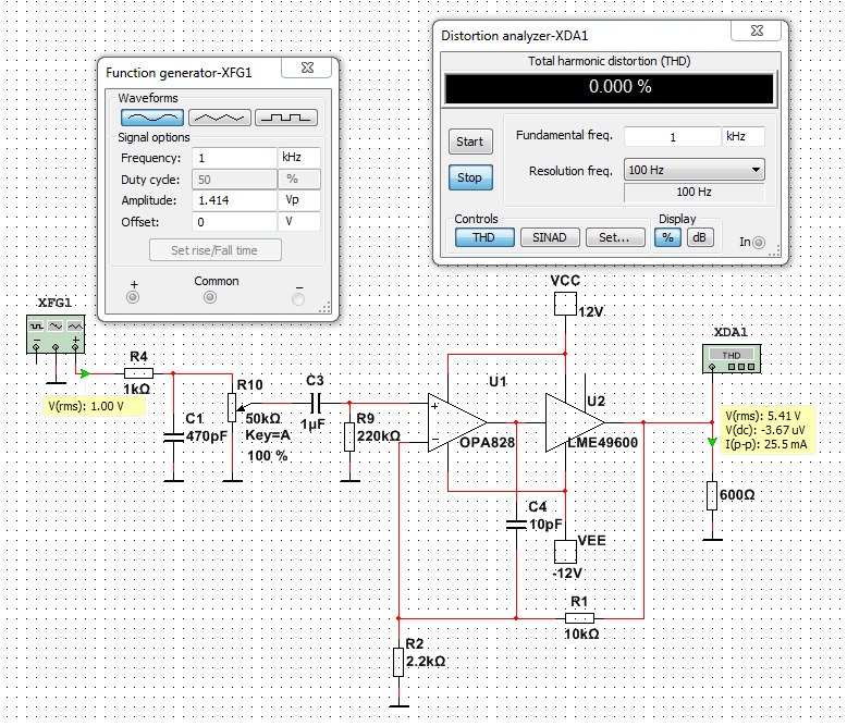

Anyone make OPA828 - LME49600 combination
Here is a variant with gain more than x5.
It is suitable for 600 Ohm headphones.
Supply is 2x12VDC.

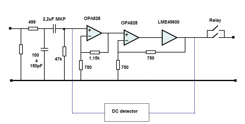

If Douglas Self does this and in Elektor some others , it is good enough for me. I think it is better to spread the gain between 2 opamps.
The second has to control the LME beast .
2 Opamps = more noise , but if like you who uses 10k as feedback resistor , what's a little more noise ?

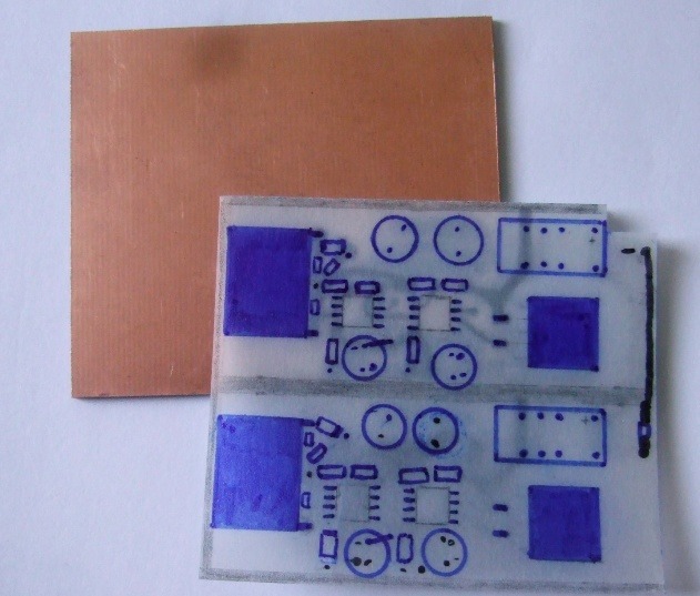

I'll try first with only the passive components and 0,1uF ceramics , but with 100uF 's E-caps over them I'm breaking Elvee's Law : ratio between the 2 should be between 30 and 100 . It's not easy. 😕
Meanwhile no responce about supply tracks and ground planes under signal tracks and I'm so ready to get started on the epoxy PCB.

s it ok to have : * supply tracks
* ground lines for decouple caps
* groundplanes that conduct return currents
* and groundplanes that only shield on the other side of the PCB under the opamps .
under the opamp inputs or the feedback (gain) resistors ?
It is OK, with some caveats. If the supply lines are noisy (ripple, etc) they can capacitively pollute high sensitivity/high impedance lines.
If the inverting input is high impedance, parasitic capacitance to GND (that includes any AC GND like supply lines) can alter the closed-eloop response.
And finally, tracks part of the output loop (supplies) carry class B currents and can induce distortion into tracks that are parallel for a significant distance, just like in a class B power amp
I know crossing signal tracks with supply tracks is better than paralleling them .
When an input is connected to the low impedance of an opamp output , does it
matter that there is potential supply line noise on the other side of the PCB ?
What if I elevated the power tracks ( and even ground current tracks) so that it is more than the thickness of the 1,5 mm epoxy PCB , like with a wire bridge or in places where they come close , use a piece of PCB on top ( even with a 3rd layer in between connected to the ground to shield ) , so that they are 3 mm apart ?
You should avoid that kind of complication, unless it is proven necessary in a real test

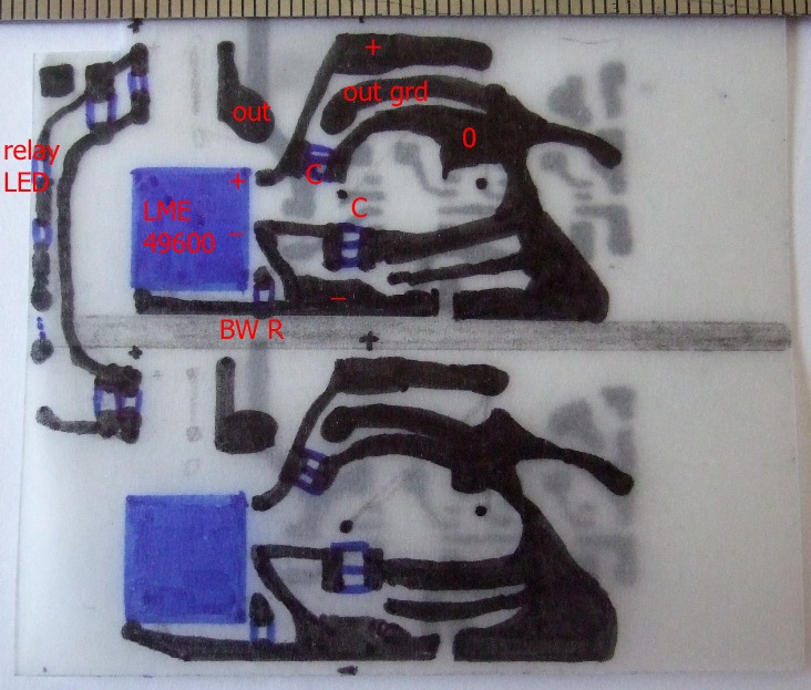

On T.I's SLOA068 pg 11 about decoupling high speed opamps , it shows that a 0,4 mm via through a 1,5 mm PCB has an inductance of 1,1nH . My via's are much wider , and longer if I use 2 x 1,5mm PBC , which boosts the nH's .
At what number of nH does that start playing a role in audio circuits , or can it make high speed opamps less stable when decoupling through such via's .
Now I'm using 1mm copper rods , about 3 -4 cm long from the regulator to the opamps/LME.
For 4 cm , that would be about 48,6 nH .
A few nH is not going to bother a regular opamp, even a very fast one. 50nH could begin to upset some opamps, but it very much depends on the actual situation.
In most of the cases, you'll be able to get away with it, but you might sometimes find yourself in troubles
