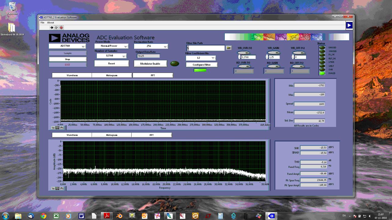

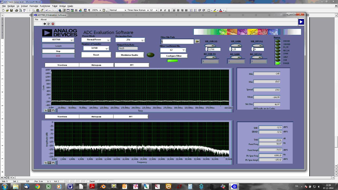

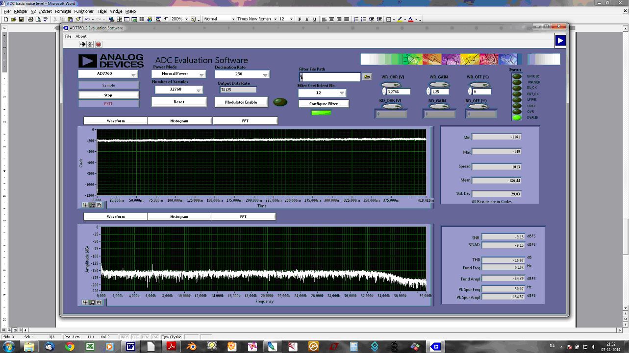

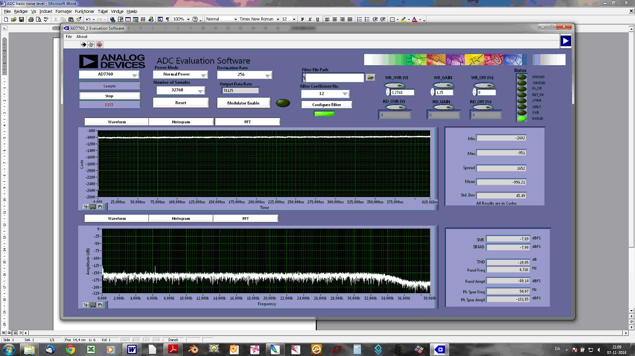

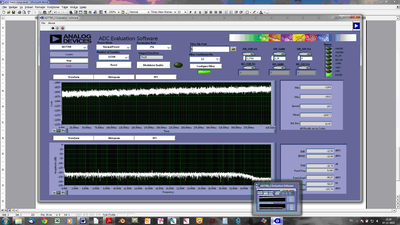

Over the weekend I decided to do some noise measurements on the batteries I have (A123Systems 2.4 AH & SLA 12V/4 AH). I did the measurements using an AD7760 evaluation board - its basic noise level with the input shorted at the point where the batteries were connected is shown in the first attachment.
The AD7760 is mounted in a sealed steel cabinet which is immediately adjacent to another sealed steel cabinet in which the batteries were placed. Different resistors connected across the battery poles allowed for different current draws from the batteries. To protect the AD7760 from excessive voltage a couple of capacitors (series) and 1N914s (parallel) were placed inbetween the batteries and the AD7760 (-3 dB point 0.3 Hz).
I did the measurements at various currents from 10 mA to ~0.8 A, however, have only shown a couple of measurements as the results were virtually identical (i.e. essentially no change to the AD7760s noise floor).
Comments to the measurements:
- Given that both here in these forums (and elsewhere?) I've noticed that batteries are considered noisy the results made me check my setup so as to verify that there was not an error somewhere. And there should not be (tested with "finger touching" and an oscillator and the setup seems to work).
However, I noticed some very low frequency (VLF) fluctuations (~ 0-10 Hz that I couldn't find out where came from. They were present both with the batteries connected and the inputs to the ADC shorted where the batteries were connected. In the measurements they show up e.g. as VLF noise in the SLA 120 mA measurement. But had I made a screendump just a bit later it would not have been there (e.g. also not present in the 0.8 A SLA measurement). But I would say that it means that the VLF figures in absolute terms are indicative though the results were identical both for the ADC alone and the batteries.
