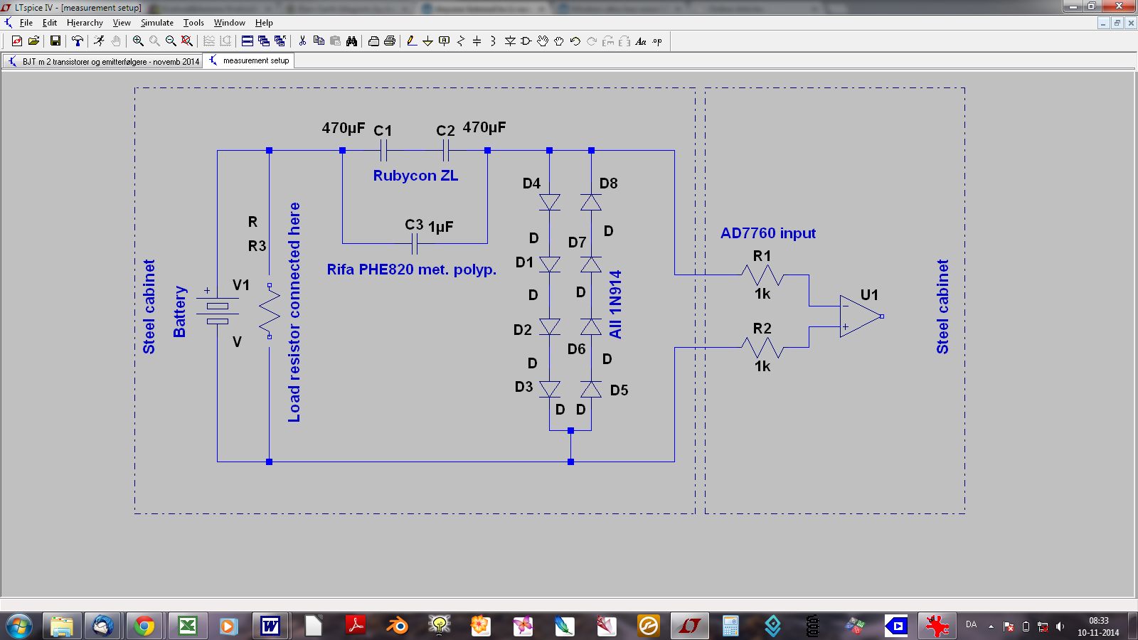

So are you saying there is only noise floor? I think a schematic of the actual test setup would be de rigour.

Hi - thanks for your question & I agree: I've attached a schematic of the test setup. I decided to not include any active circuitry in the setup so as to get as low a measurement noise level as possible (i.e. I could think of).
Best regards,
Jesper
P.S.: The AD7760's input is slightly different as it also includes a built-in opamp, however, in noise terms I believe this is what is relevant (?)
... If you hover the mouse above the images attached you may see a text string indicating the various currents measured. From "low" (10 mA) to 0.8 A (the SLA).This report varied battery current.
Best regards,
Jesper

I think you are trying to measure below the input noise floor. This link will show just how hard it is to reliably measure battery noise: http://tf.nist.gov/general/pdf/1133.pdf You could measure an alkaline battery and see if you get similar results.
You need a really low noise preamp to start with. I used a transformer coupled preamp to get the self noise below 1 nV/rtHz. Even with that there are noise mechanisms in coupling caps etc. that are not easy to verify. What NIST did requires two preamps and some software that will do cross correlation (HPWworks HpW-Works does have this, none of the other audio software I know of has it).
Its important to be sure your looking at the right issue when testing. Is it isolation or supply impedance? Is the noise or the internal dynamics the key aspect that's influencing the performance. Batteries are not necessarily linear. They react in nonlinear ways to high and low current and to current in vs. current out.

@1audio &jackinnj:
Hi & thanks for commenting & suggesting once more 🙂
My main intention in this was to find out whether eligible batteries were actually noisy. From reading around this forum (and to my memory, also elsewhere) "batteries" often are considered noisy, something which - based on my subjective listening - is not what I have observed. I've always found that batteries that were sensibly dimensioned to the circuitry in question contributed with "room for" silence, spatiality, nuance, detail etc. on many levels.
That said I've also found that the various battery types - as well as different manufacturers' apparently similar chemistries - may sound differently. So quite likely they are not linear and also respond differently to discharge and charging conditions, load and more.
However, with my objective in mind - finding out if batteries could be considered noisy compared e.g. with a superb regulator - I would say that I have clarified this to the extent that I hoped for. So I'll leave investigating this further for now, yet keep in mind your & jackinnj's suggestions should the future bring me back in this direction.
Cheers - & thanks again to both of you ;-)
Jesper
