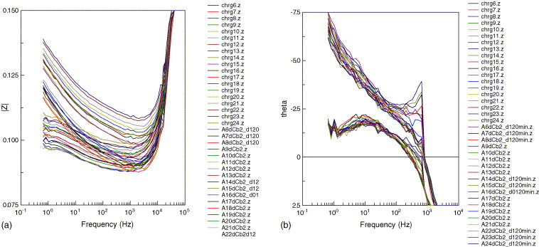

Impedance curve of various NiMH cells. It's from a paper that I'd have to pay for to read, but basically they used some kind of fuzzy logic technique to determine these and other qualities of NiMH cells.
More, from another site:
There are three frequency regimes to consider when dealing with batteries:
1. Ultra low frequencies. These are frequencies measured in inverse hours or days. In this regime the battery acts like you would expect it to. At low frequency a battery will act like a current source plus resistance. All of the energy transfer will be due to ion movement through the electrolyte and none will be due to surface charge or capacitive storage.
2. Medium frequencies, 1kHz to 1 Hz you are dealing in the regime of ion movement. If you are trying to pull a 10 mSec pulse out of a battery you will be accessing surface charge and capacitive storage, but also charge due to charges moving across the electrolyte. By the induced charge theorem a charged particle doesn’t need to move all the way across from one electrode to another to realize this energy, an ion with a charge of one unit will induce a charge on the anode of 1/10 of a unit as it moves 1/10th of the distance from the cathode to the anode. But these ions move slowly compared to the electrons in a wire, and this shows up as an increased resistance. The shorter the pulse and the higher current drawn the more the internal resistance of the cell will show itself.
3. High frequencies for batteries are above 1kHz. In this regime impedance is a better term than resistance because capacitance and inductance come to play. Many types of batteries are spiral wound, which introduces more inductance than flat plates would, and of course all batteries are capacitors, having parallel plates separated by a distance. If the current is drawn from the battery in a series of short pulses at high frequency strange things can happen. For example you can get crazy oscillations in a feedback situation such as a switching power supply. In these kind of applications a capacitor across the battery lets the battery move into a lower frequency regime.

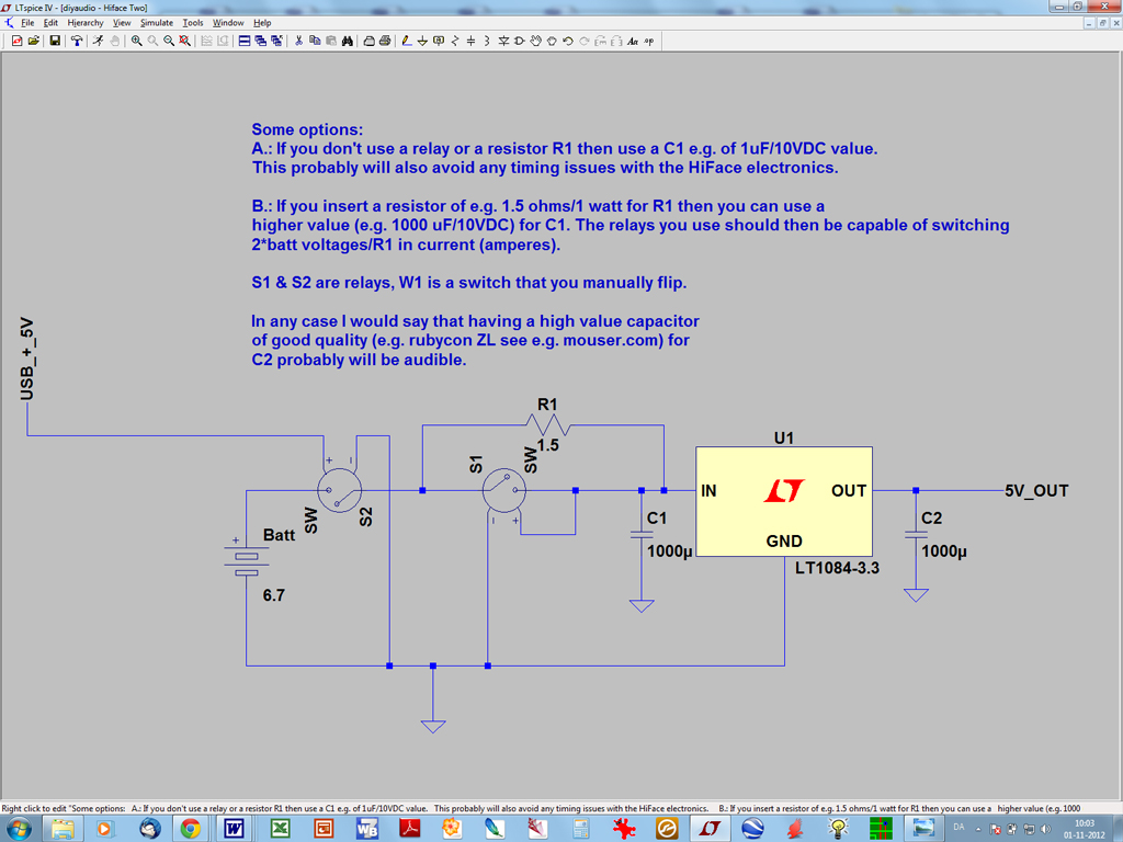

I'm looking to make up a 5 volt battery supply for a Hiface Two using LiFeP04 batteries.
Will the following work OK?
(using a LM2937ET-5.0 LM2937 Low Dropout Voltage Regulator)

Hi Nuuk,
No I'm not - actually, I can see that I didn't read your post in detail and so missed the link to the charger you were linking to. My apology for this - & for causing your confusion 😱
As it is your schematic may be ok. However, there might be some timing issues with the hiface electronics - i.e. that the voltage to the HiFace electronics must be present a certain time after the USB connection is established. I don't know since I am not familiar with the specifics for the HiFace Two.
Another issue could be that if you use a high value capacitor on the input of the regulator the switch you use would need to accept (very) high currents.
Thinking a bit more about it I've drawn up a circuit that might inspire you, (however, no guarantee it'll work as I don't know what's inside the Hiface, see above). I know there are also other ways of doing this but this is my suggestion as I reckon that you have a somewhat basic knowledge of electronics ... right?
First off - you might consider making the charger switch disconnect both the positive & ground wires - or disconnect the charger from the mains outlet when listening to your music.
Second - to make any charger circuit work you will need to disconnect the + 5VDC that the HiFace receives from the USB connection.
Then to the circuit: In this way the battery is only connected to the HiFace when the USB connection is also there. The first relay, S2, ensures this since it draws its current from the USB connection.
The simplest version is made of S2, a low value C1 (1uF), and a high value C2 (e.g. 1000 uF).
I took out the W1 switch but forgot to change the text - so please don't take notice.
The full version allows for a higher value of C1, which may/might improve sound (my guess would be that it does). C2 needs to be close to both the regulator and the HiFace.
If this is interesting to you I personally - before starting - would ask someone who knows about this if the HiFace electronics will accept a USB datasignal before the supply voltages are at their full value (& survive!). Both relays and capacitors have delays so I would make sure this is the case.
Good luck with your endeavors 😉
Best regards,
Jesper
